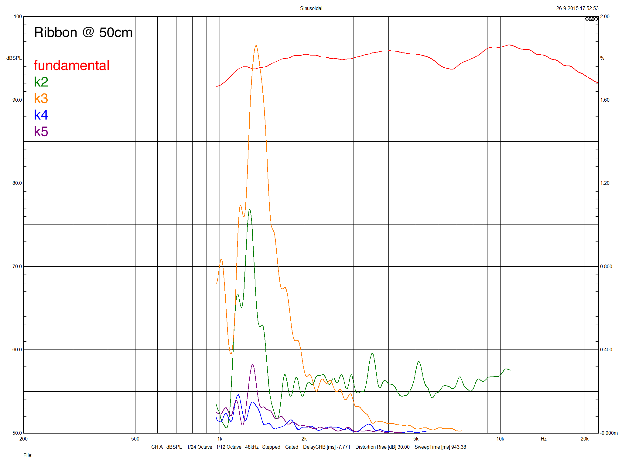

Digging through the measurement archive I compiled this comparison showing the harmonics for three flat ribbons and a corrugated ribbon
Were all these measurements with your spaced-magnet geometry?
Do you have a feel for how much the spaced-magnets reduce distortion?

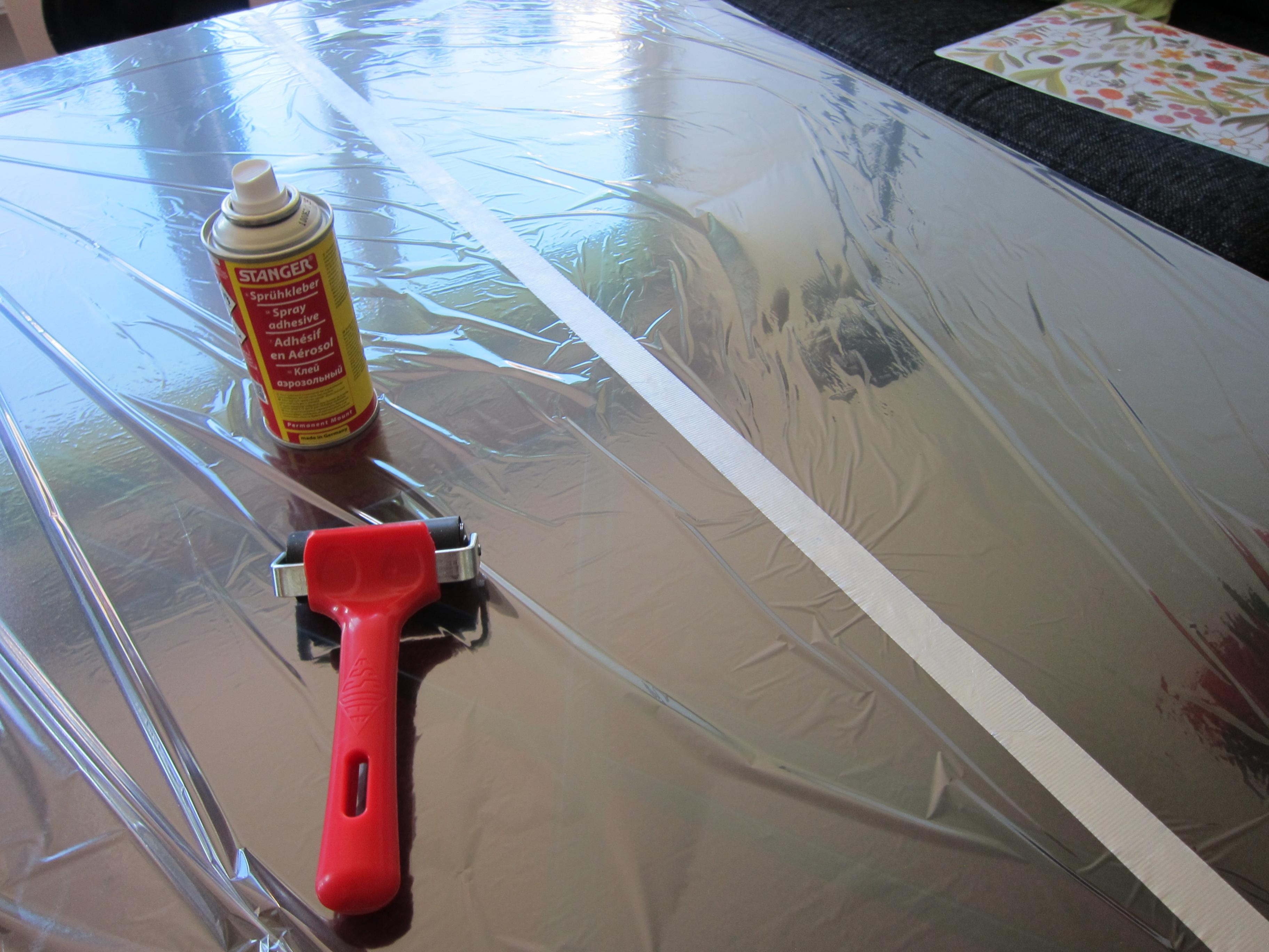

While in a local hobby store over the weekend, I noticed that they sell aluminum leaf for rather cheap prices.
25 sheets of < 1µm aluminum for $8. I couldn't resist picking some up to try.
Can't get much closer to "essentially" massless than that.

Yes, all with the spaced magnet motor. This comparison was to show why corrugation (or some other pattern) is necessary to reduce higher order distortion and why kitchen foil is not recommended.
I'm currently building another steels frame ribbon with the spaced magnet motor design, this will allow a comparison between the two motor designs. I hope this new design will have significantly lower distortion which will allow for a lower crossover. We shall see.:)

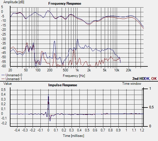

Just wanna show the difference between 10u alu ribbon with 4 uM mylar backing (red trace) and without mylar(blue trace).
2nd harmonics is shown...-60dB equals 0.1%.
Gerrits Ribbon Cable Corrugator is used in both cases...
The difference is very audible!

Very interesting!
How did you glue the foil to the mylar and what mylar did you use?

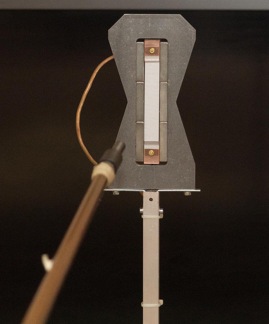

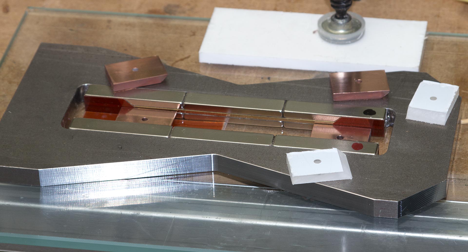

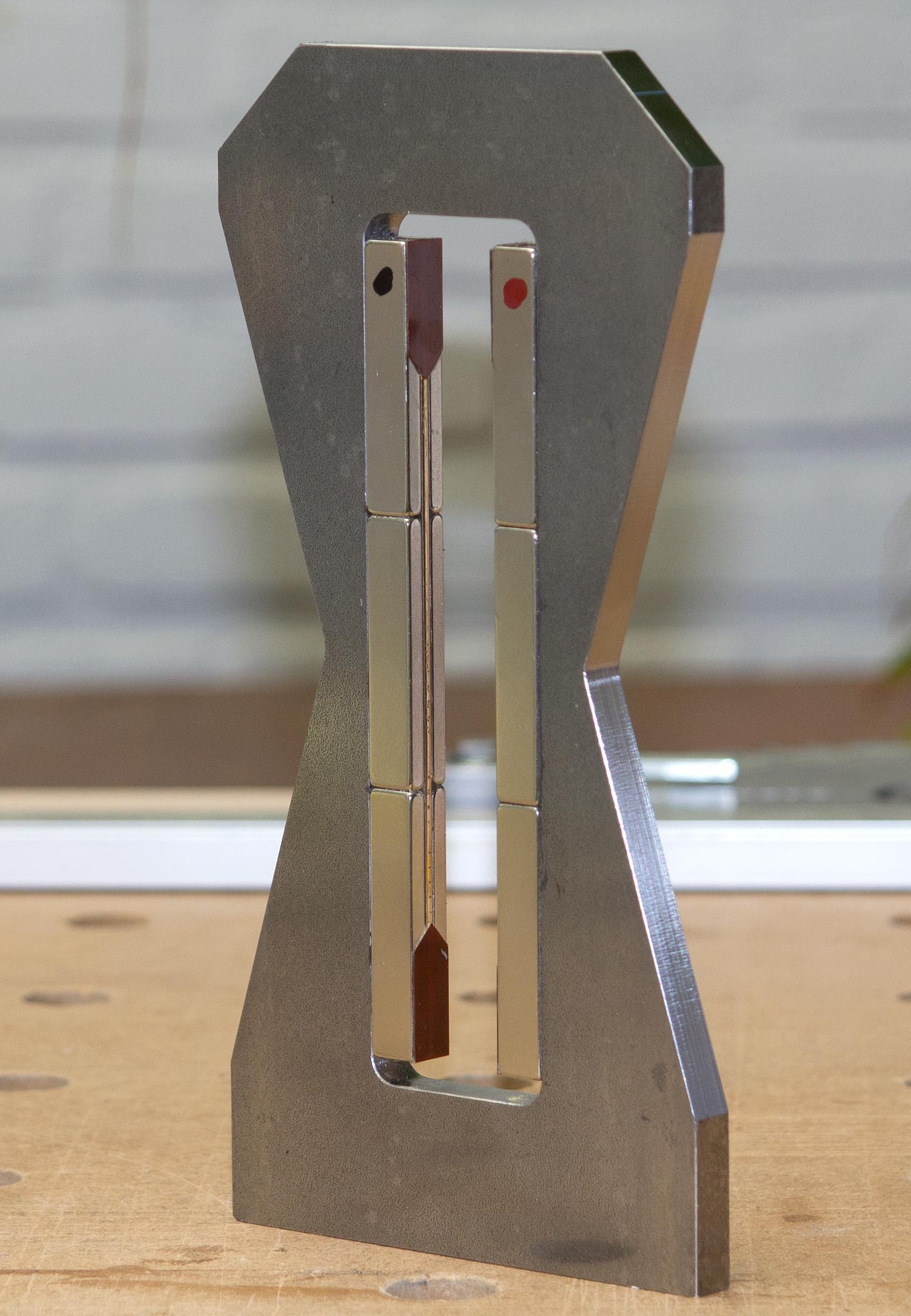

My new steel frame ribbons with the spaced magnet motor are nearly finished:
Testing will start tomorrow.

I bought it here : Products
and I used diluted water based contact glue Casco Contact 3880
Shall be interesting to see how your new ribbons are working, maybe with or without mylar?
Actually I would have thought it weird if the mylar laminated version did NOT have lower distortion. As Jonas suggested, the mylar and glue should damp resonances in the ribbon and help it vibrate more simply (pistonically) in the same way that corrugation helps prevent break-up modes in the ribbon and reduces the "prizzel and prazzel" noises. The extra weight of the mylar and glue will reduce the sensitivity but if the mylar backing makes it possible to run multiple lengths of the conductor in the magnetic field then you can regain some of the sensitivity that was lost.

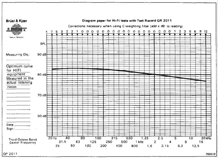

The increase in weight is about 15%, but it also increases the mechanical strength 500% making it possible to use the speaker outdoors!
It also has the benefit that the frequency curve gets more of the Bruel & Kjaer look..
I drive my ribbons directly via 6 Ohm and 22uF in series, so I have plenty of headroom to manipulate sensitivity of the ribbon....

@ Gerrit Boers: New steel frame ribbon structure is looking very nice! Based on your previous experience, how much sensitivity do you expect to pick up?
I located my old Neo8 magnet test structure last night stuck to the back leg of my work bench in the garage...totally do not remember putting it there. I hope to get some measurements with the aluminum leaf this weekend. I did measure the thickness using a few different methods and multiple layers. On average it is 0.65µm thick. :eek:

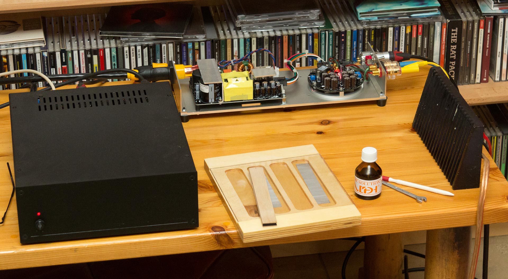

The first results are in. The ribbon:
The filter, amp, series resistors, spare ribbons and tools:

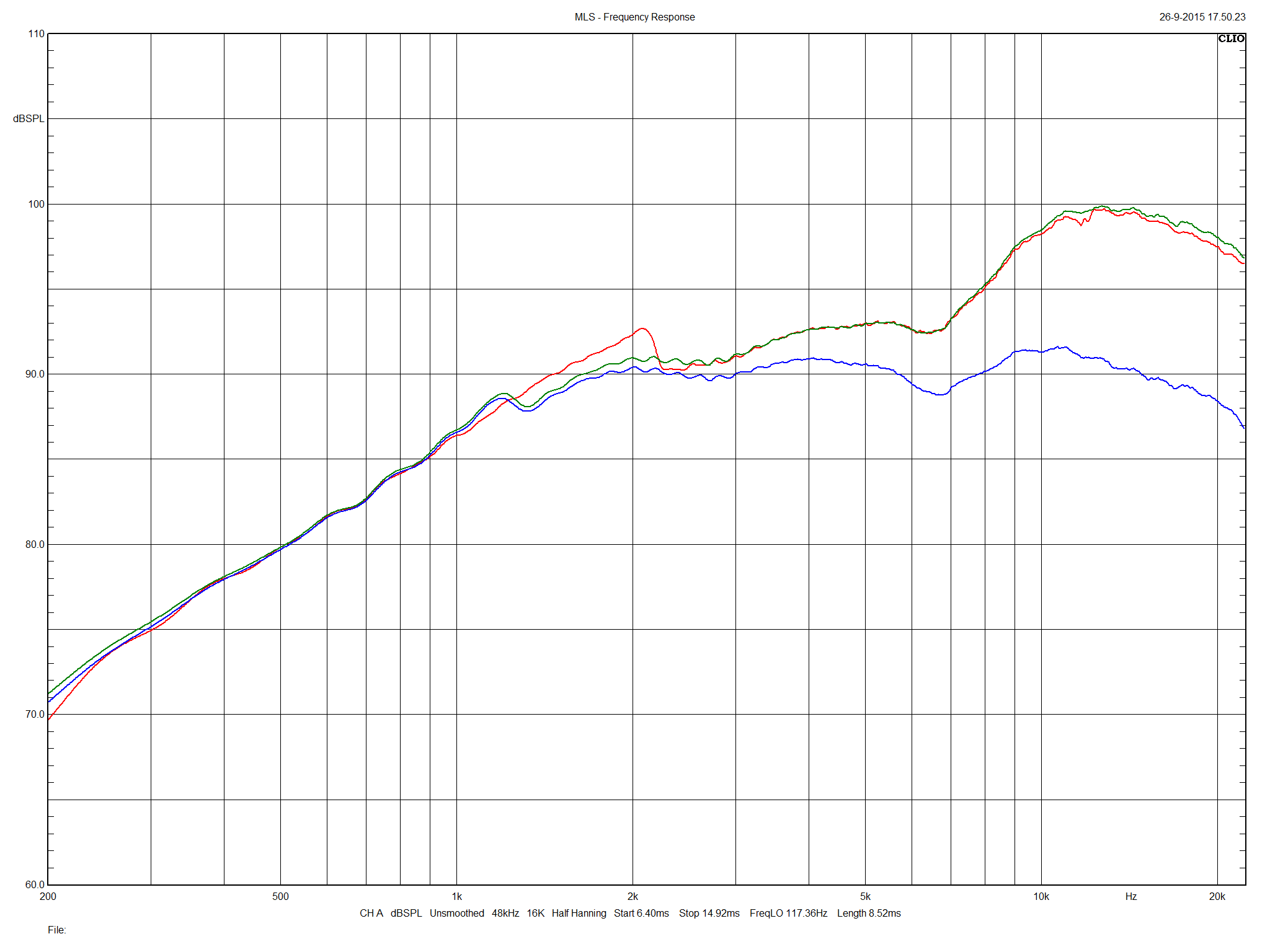

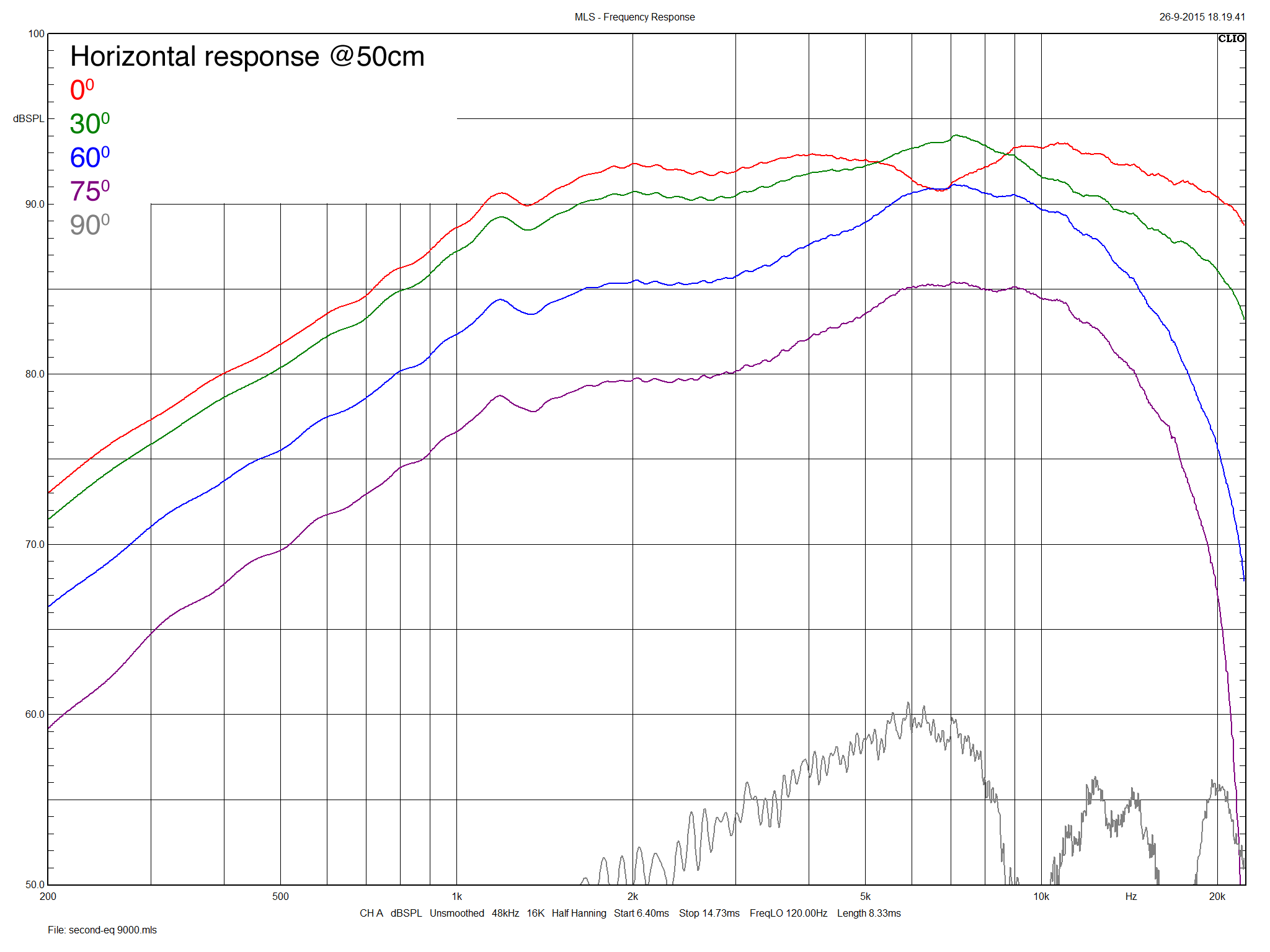

The first ribbon (red) had a serious resonance, the second (green) significantly less so I applied some filtering to this one to smoothen the response (blue):

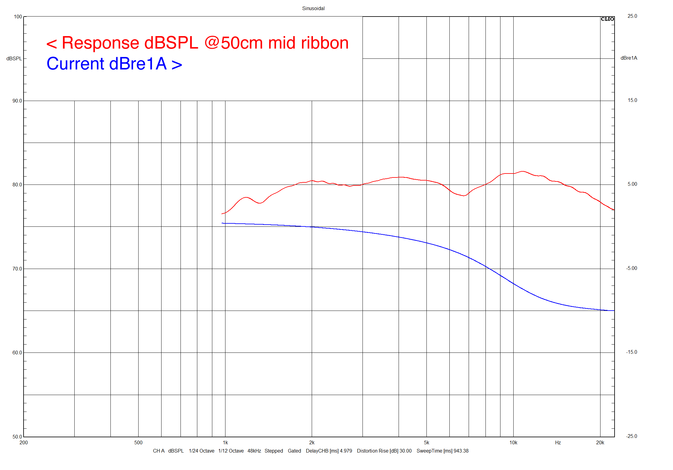

This graph shows the response and current:
At 2kHz 1A results in 81dBSPL, this is 6 dB more than the minimal ribbon.

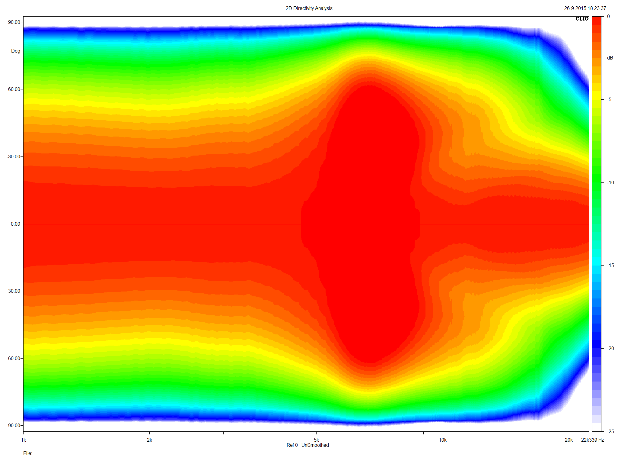

The response for several angles:
The normalised directivity:
Not bad, not bad at all :)

The harmonics:
Fundamental in dBSPL, scale on the left. Harmonics in %, scale on the right. Apart from the peaks at 1.5kHz it's pretty good.

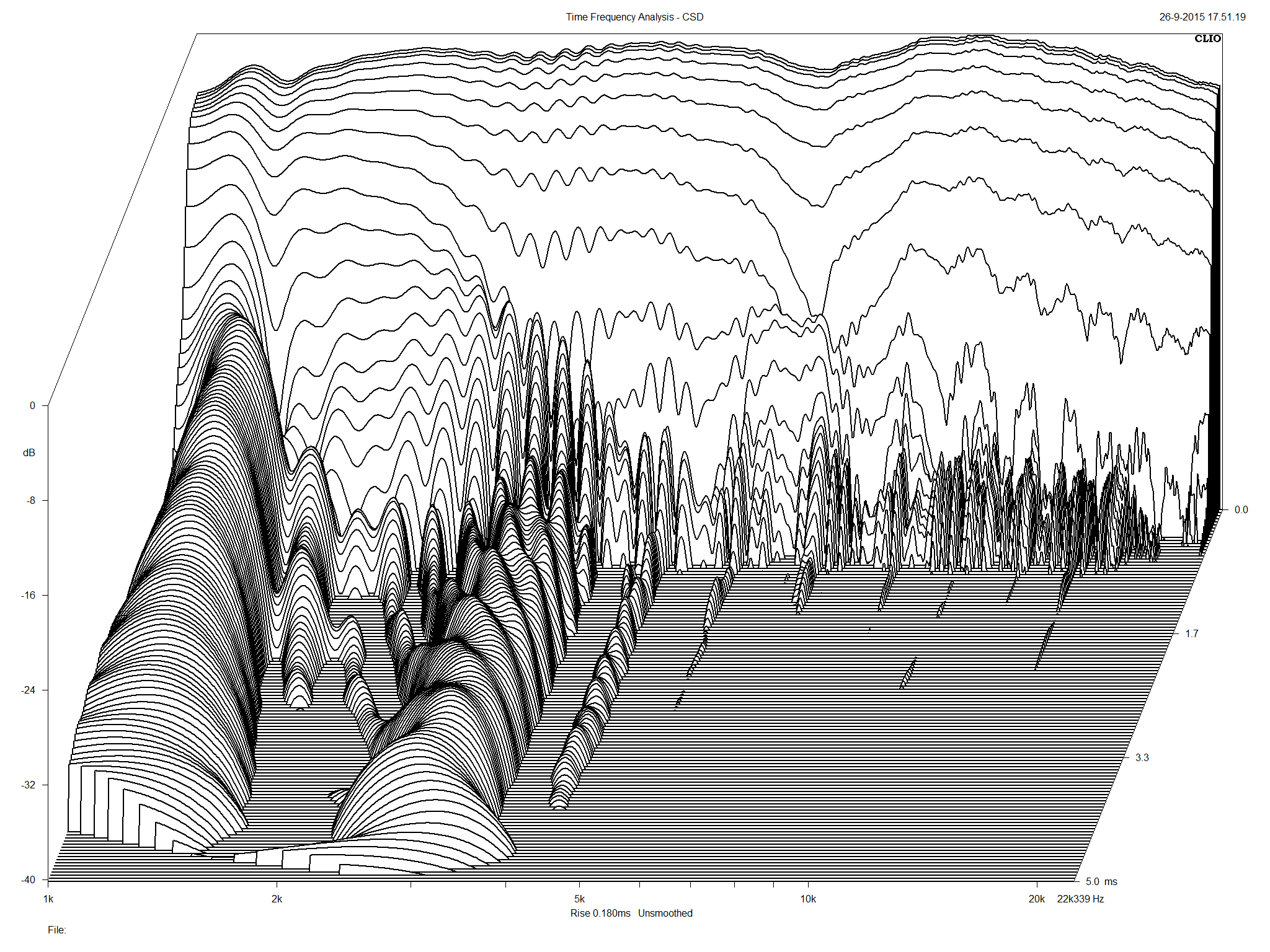

The spectral decay:
Still some resonance issues but the rest is very clean. It will be interesting to try Jonas' recipe with the mylar to see if this will get rid of the resonance while simultaneously reducing the distortion.
