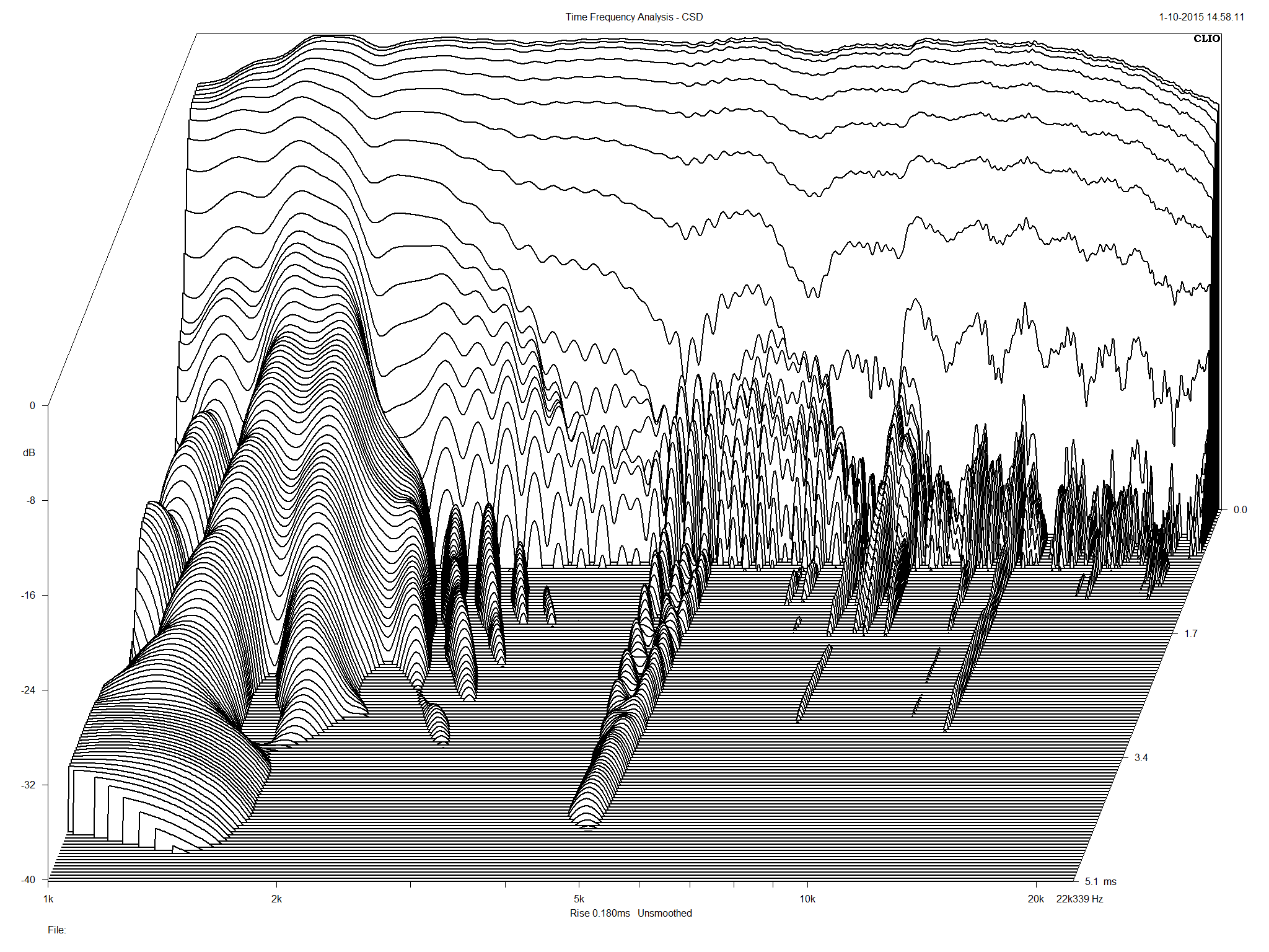

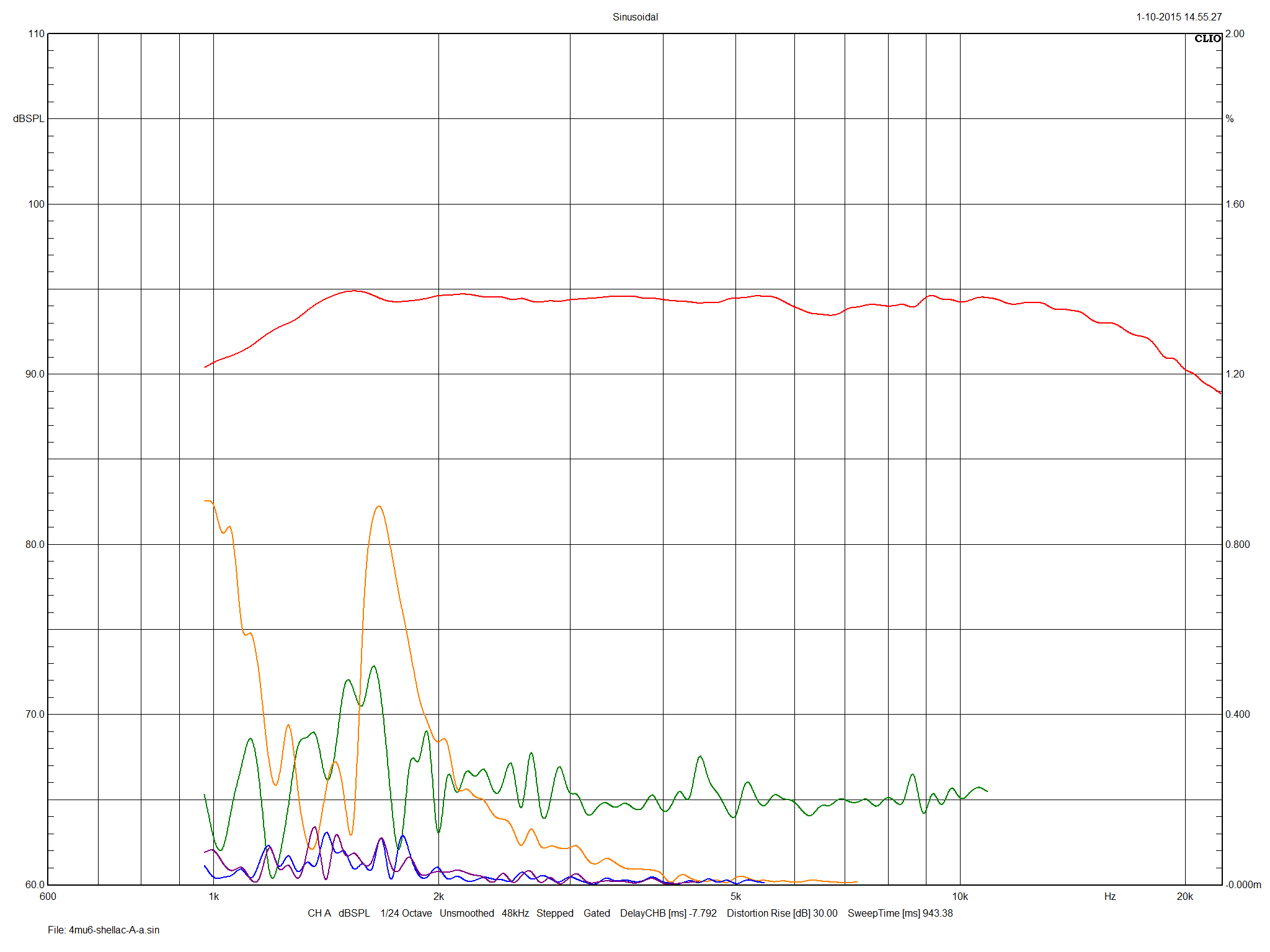

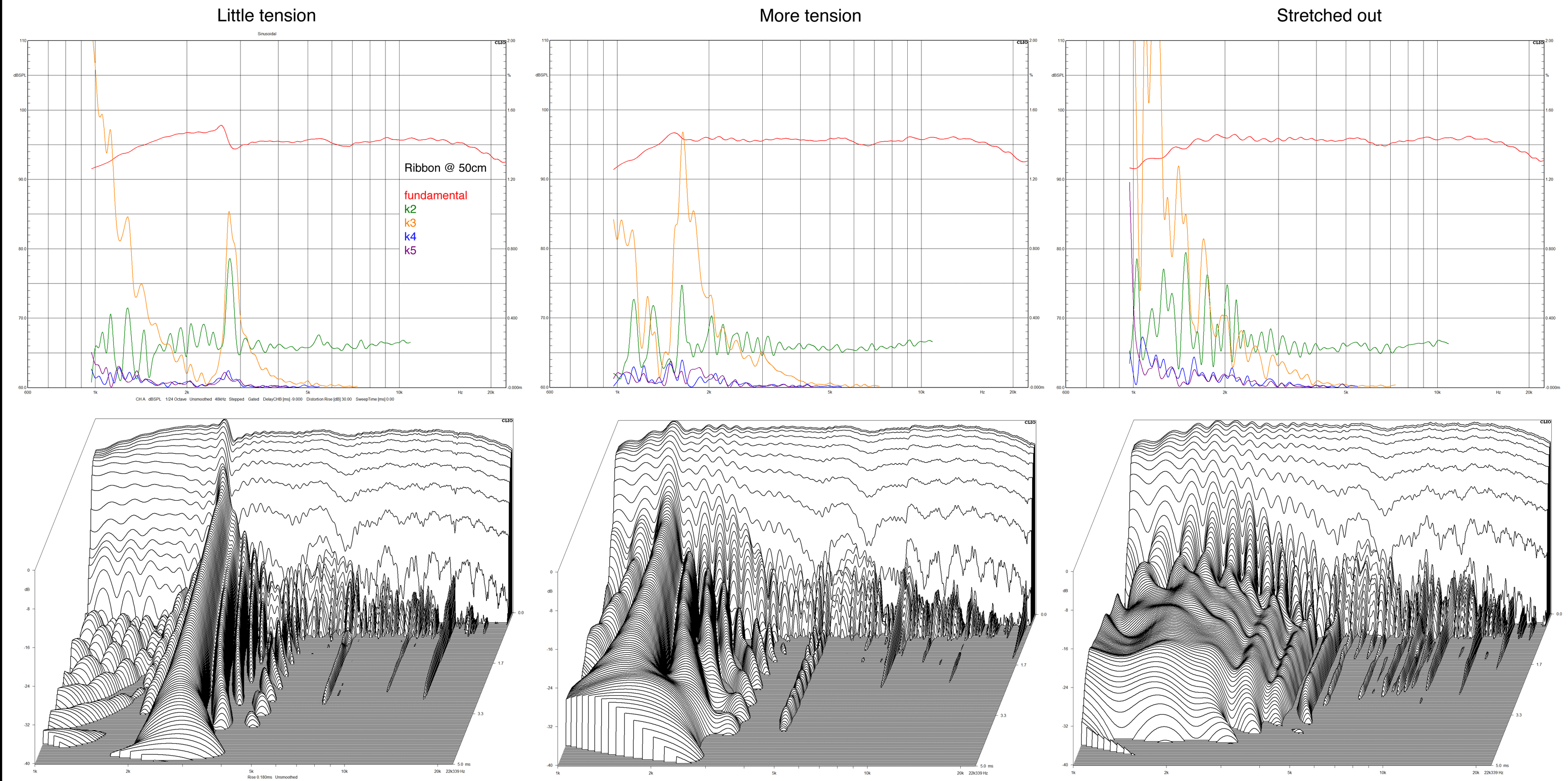

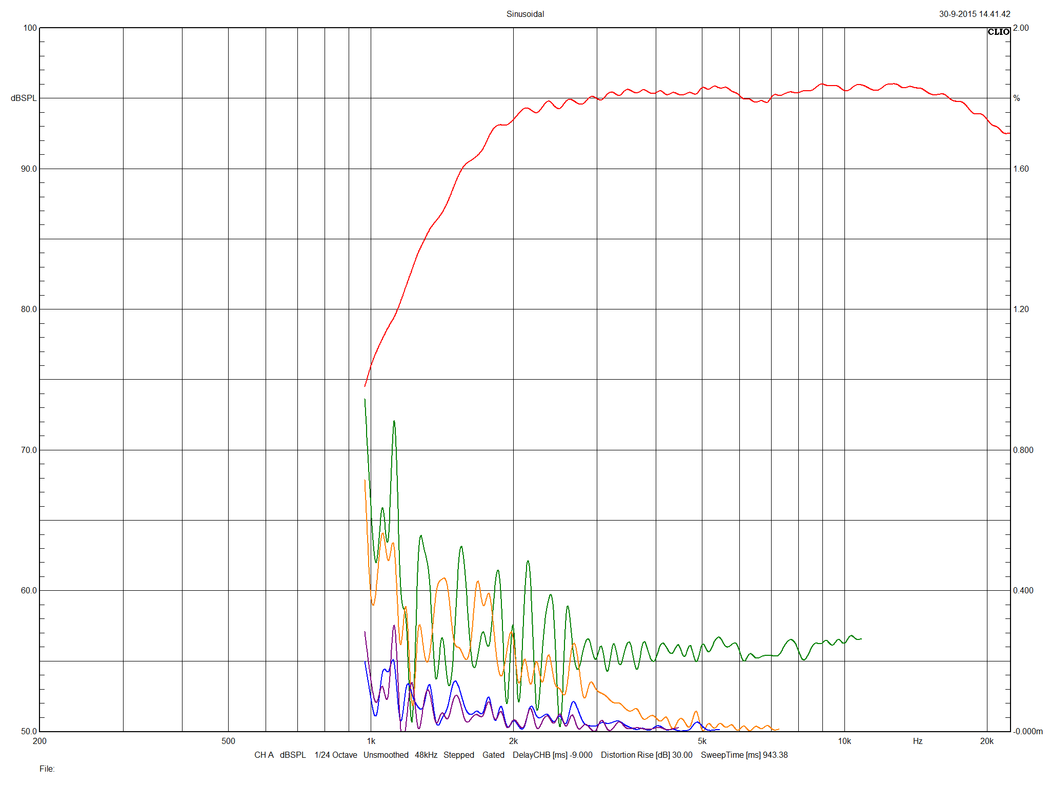

Some more test results. A 6µm ribbon with corrugation with just enough tension to flatten the ribbon in the gap, with a little more tension and essentially stretched out. Harmonics and spectral decay are shown:
I'm still not clear on what is causing the resonance. If it was a motion like in a guitar string one would expect the frequency to go up with tension, but the frequency goes down. I was thinking it could be a AMT like motion in the corrugation.
The increase of the third harmonic towards 1kHz is expected, the magnetic flux density is not constant but the deviation is symmetric so odd harmonics are to be expected as the excursion increases. A little more tension decreases the amplitude of the corrugation and thus the ribbon occupies a smaller area of the gap, this results in less distortion at 1kHz. The distortion increases for the stretched ribbon probably because there is to little freedom of movement for the ribbon.
The harmonics for the stretched ribbon with 24dB/oct LR high pass at 1.5kHz:
The high-pass filter significantly reduces the third harmonic and fifth, notice how the even harmonic are very much less affected by the filter.

...I'm still not clear on what is causing the resonance. If it was a motion like in a guitar string one would expect the frequency to go up with tension, but the frequency goes down.
This really is puzzling behavior isn't it? :scratch:
Did you happen to look/listen while playing low level sine signal to see what the motion of the ribbon is when frequency is swept or held around the resonance frequencies?
Puzzling indeed. No I didn't look closely but that's a good idea. I ordered some mylar foil and are waiting for it to arrive, then I will do some more testing.
regards,
Gerrit
I don't know the cause of this behavior, but maybe you can think of it like this:
If the phenomena was due to a strings behavior, the resonance would go up in frequency with increased tension, we all agree.
In the case of a corrugated alu ribbon, we have a small spring action and the resonance point depends on the ribbons spring constant and tension.
The spring action of aluminium is very fragile, and when we increase the tension, the spring action behavior is destroyed, thus lowering the resonance frequency.....
If this reasoning is correct, it means that we shall not pull the ribbon at all, when mounting it...
When the ribbon is stretched a little it is still elastic and will bounce back so to speak but the resonance frequency drops. The stretched out ribbon is indeed no longer elastic.

Thank you :)
Flat ribbons do not have resonance issues but the distortion is intolerable. I also tried the embossing method bolserst used but there was still to much distortion. I also tried embossed ribbons with 1cm corrugation at the ends, didn't help either. The best result so far was with a 4.6µm ribbon with a thin shellac coating on one side:
Not that much resonance with a 3rd harmonic peak of 0.9%. The spectral decay is also pretty clean:
The resonance is not very pronounced but because it is in the range where our hearing is very sensitive I would like to get rid of it completely. I'm anxious to try Jonas' method with the mylar, I ordered 2µm and 1µm mylar so I can try different combinations of ribbon thickness and mylar. The goal is to come up with a simple recipe that gives repeatable results.

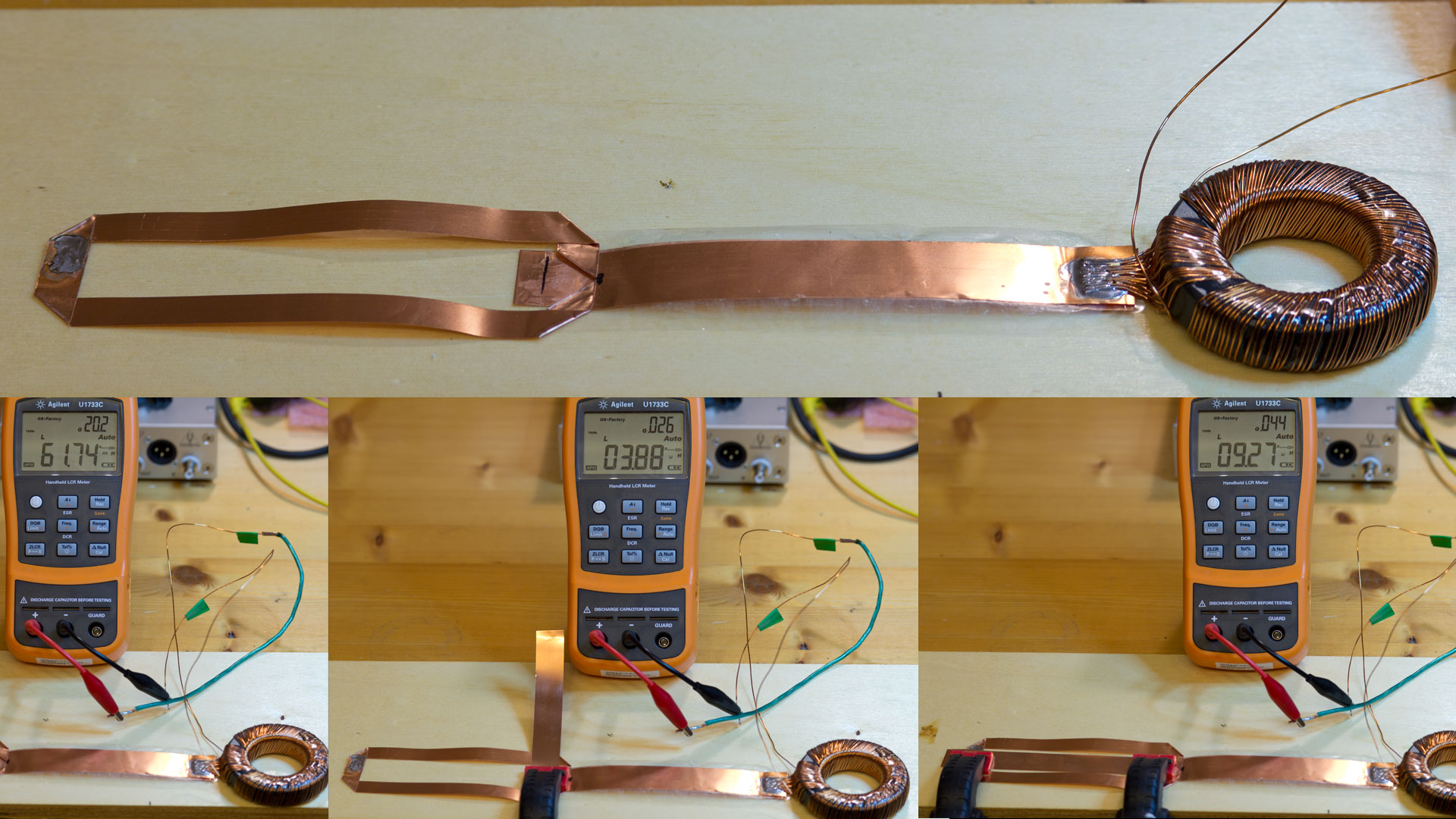

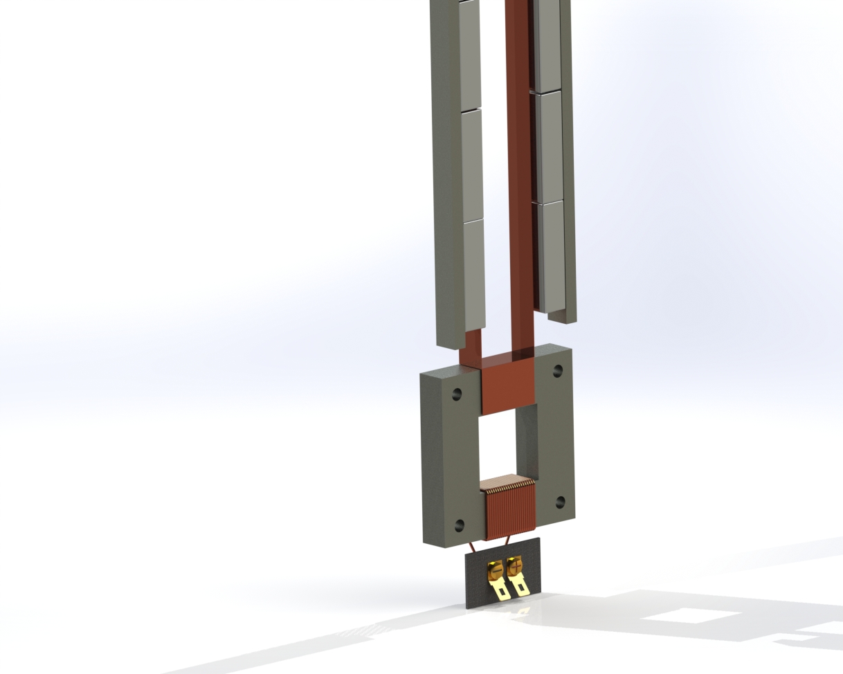

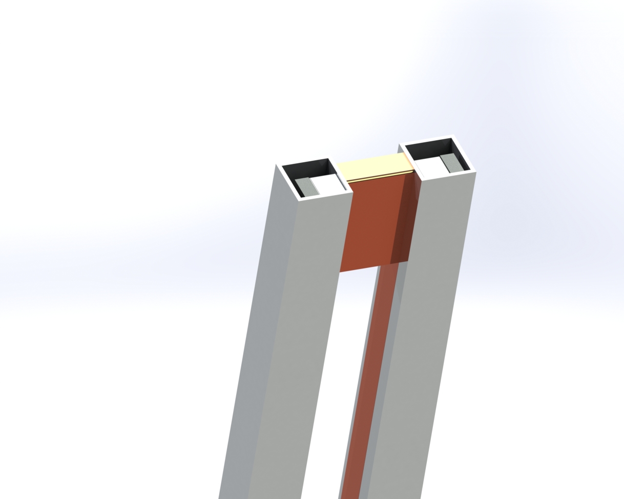

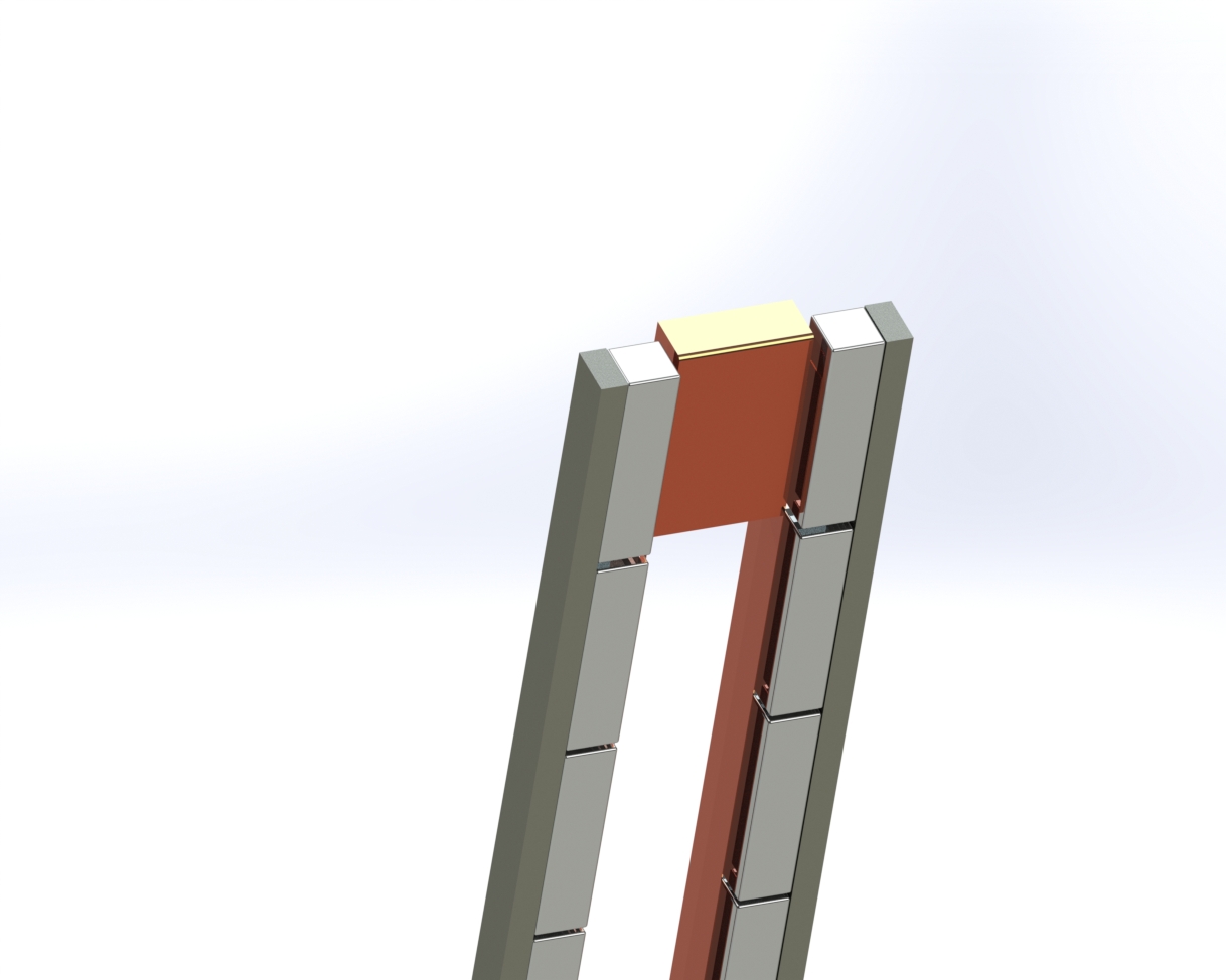

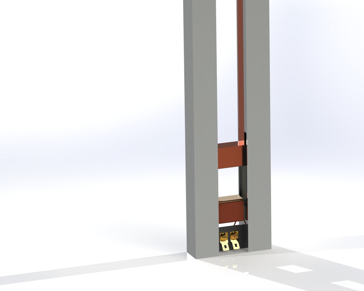

Sitting here thinking, on how to integrate a drive transformer in my alu tube ribbons..tell me if I'm hijacking.
What, a drive transformer?:confused:
Well, it has some positive sides to it, the ribbon becomes very easy to drive (SE tube Amp), smaller value of crossover caps and some other things, like making a transformer (which is very fun.....)
The pictures shows the speaker without a ribbon mounted for making things clearer.
The ribbon itself is used as a transformer winding(!), so one mylar backed ribbon end is attached to the lower copperplate and wound 4 (in my case) times around the transformer core/contact area.
The other end is attached (without pulling) over the upper copper contact, and a metal clip holds it in place.
The lower winding has (in my case) 80 turns which means that the resulting impedance becomes (80/4)x(80/4) times ribbon resistance = 40 Ohm...
The steel frame ribbon will be driven with a transformer, the NCore with the series resistor is for testing. I fooled around building a transformer myself until somebody showed me how it's done (thank you again for that Peter).
The primary inductance is 62mH and the leakage inductance is just under 4µH yielding a coupling factor of 0.99994. This is achieved by a perfect interleaving of primary (single 66 turns) and secondary ( 11 x 6 turns) windings.
The design in your sketch will not have a sufficiently low leakage inductance which will affect the high frequency response. The inductance in the secondary circuit has to be very low. In the picture the copper foil is separated by thin polyester foil, increasing the distance between the copper foils by just 1mm decreases the high frequency roll-off by 30%!.
Another issue when using a transformer is that the contact resistance has to be very constant, especially when using a tube amp, because changes in the secondary circuit resistance will be reflected to the primary.
My surround speakers use a Hypex AS2.100 plate amp and in this case a transformer is required, this might change in the future but for now it works very fine this way.

…In the case of a corrugated alu ribbon, we have a small spring action and the resonance point depends on the ribbons spring constant and tension. The spring action of aluminium is very fragile, and when we increase the tension, the spring action behavior is destroyed, thus lowering the resonance frequency...
ooooOOOOoooh! This makes perfect sense. :up:
Basically trying to add tension reduces the spring constant of the fragile aluminum corrugated spring.
With mass and airload remaining the same, if you reduce the spring constant:
- resonance frequency will go down
- damping ratio will go up (ie Q of resonance reduced)
This is exactly what the measurements show.
