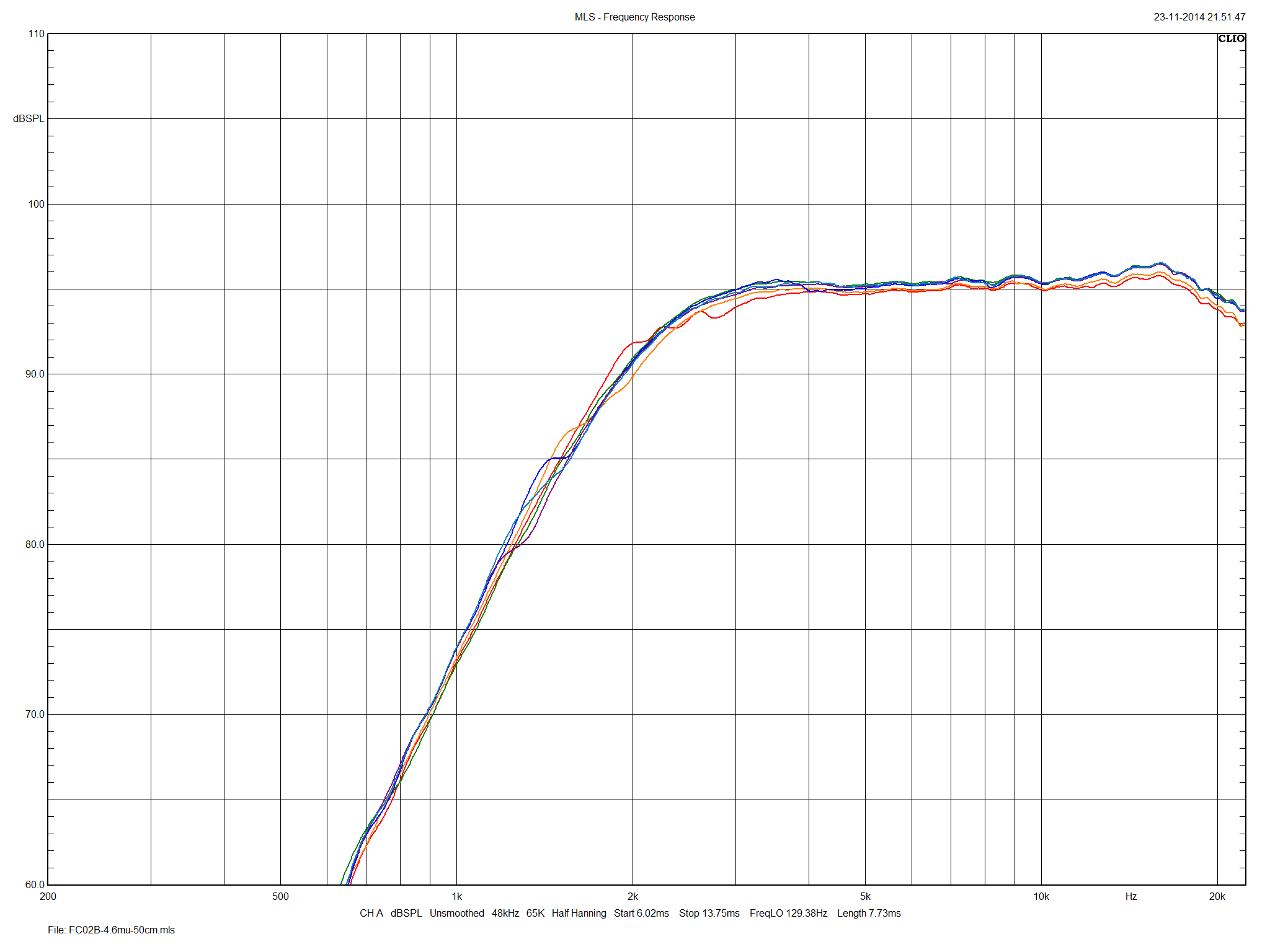

As far as the frequency response is concerned the repeatability is excellent:
The graph shows the response for six different ribbons, the red and orange lines are for slightly thicker ribbons (6µm vs 4.6µm).

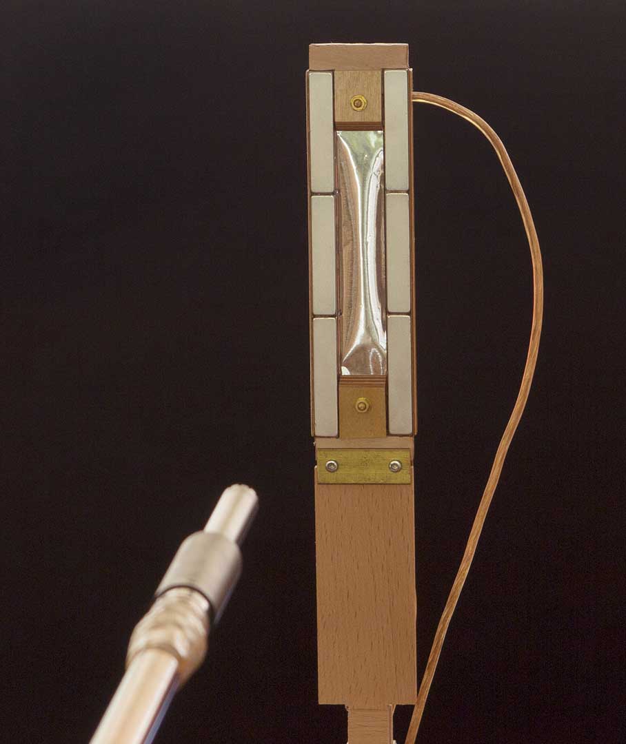

According to the spec sheet they use a sandwich ribbon, probably as an alternative to corrugation. The average gap flux is 0.4 Telsa (sic) average, it would be interesting to see a graph of the flux density across the gap.
The more uneven the flux density across the gap, the more corrugation is required to prevent flexing of the ribbon.
Here's a picture of a flat ribbon where the flexing is clearly visible:
This is what corrugation is supposed to prevent.

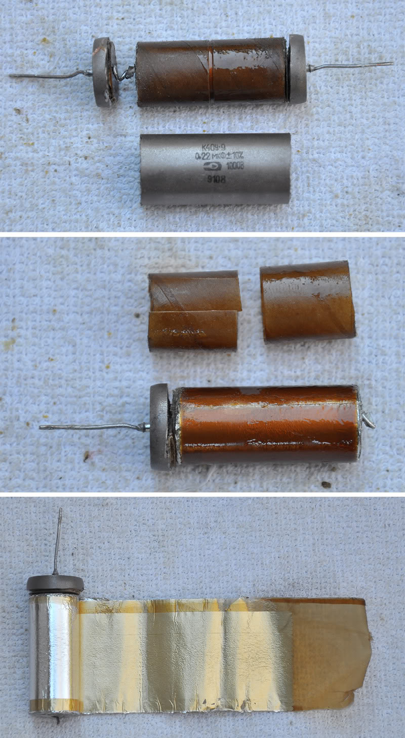

Finally found some old foil capacitor, with what i assume is 6um thick alu foil. The difference between it and kitchen foil is night and day in terms of sound quality. I just quickly built 30x2,5cm ribbon, with steel U profile that holds small 30x10x5mm neo magnets. Efficiency is still small, but sound quality is amazing.
Have to make another quasi ribbons for my 1m tall ribbons, using this thinner foil.
If anyone knows what is good source of thin alu foil, please write. I have hard time finding foil capacitors without metalized polyester (mylar).

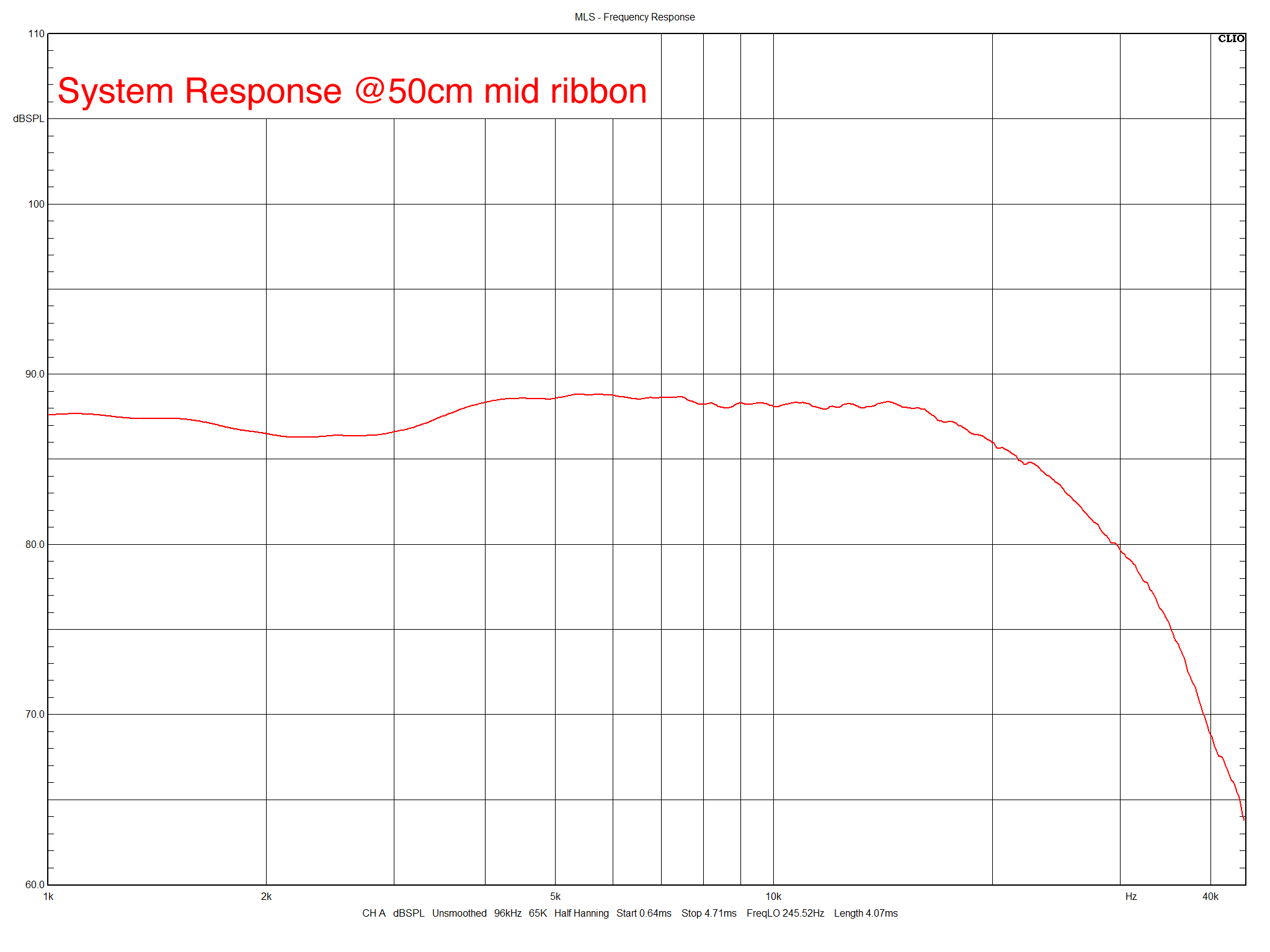

Here's the response of the whole system measured at 50cm mid ribbon with a 96kHz sampling rate.
-3dB at 21kHz and a very nice, clean roll-off without any spikes or resonances.

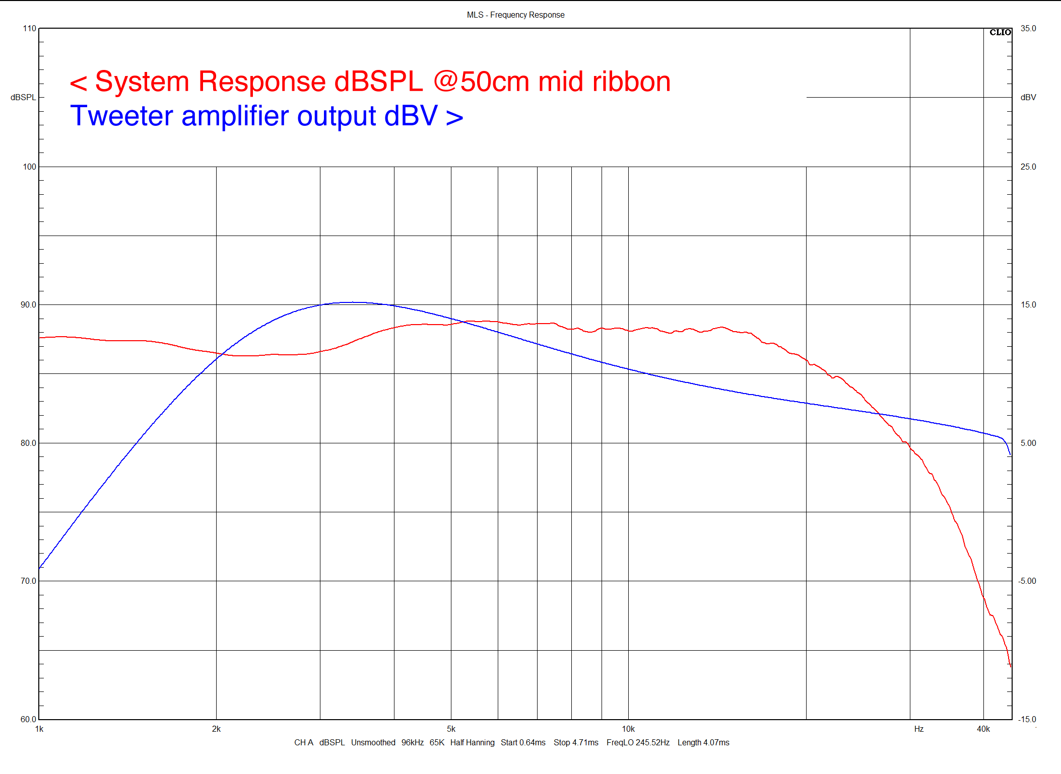

Here's the same measurement with the amplifier output of the tweeter amp pasted in:
The signal was measured at the NCore output as I did not dare to put alligator clips on the brass machine screws on the ribbon, if the clips snap off they will be pulled in the gap and the ribbon will be destroyed.
It's possible that the signal at the ribbon clamps is different, I will have to test this with my prototype ribbon when I have my test amp ready again.

Looks great! Definitely no resonances and very clean roll off. If i didn't know what you were building, I would say that's photoshoped. 🙂
Where is the crossover point, and what type of crossover do you use. (I assume 4th order)

Crossover is at 2.5kHz 24dB/oct LR. The response of the mid is a bit lower because it was measured mid-ribbon, measuring between the two results in a flat response but then there's more drop off at the top.

Russian K40Y-9 could be useful.
