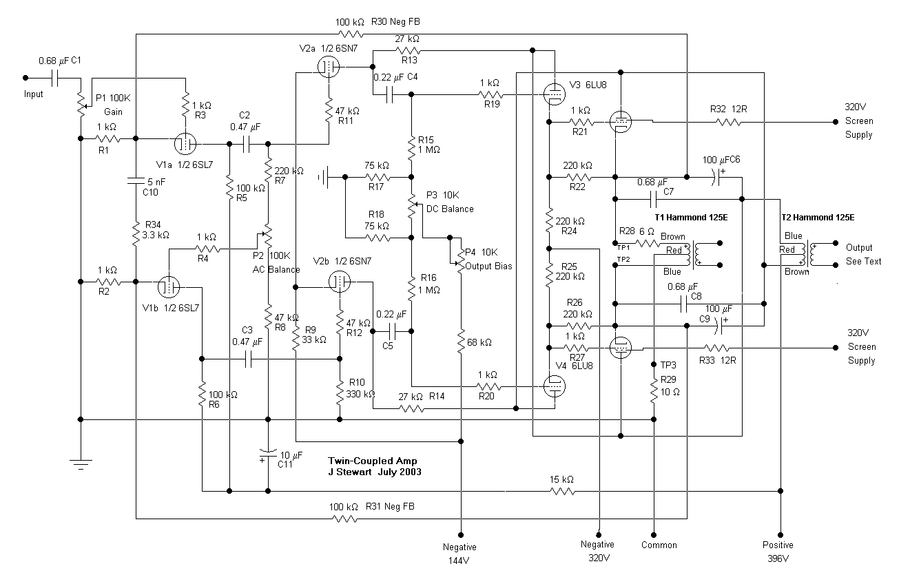

Some Twin Coupled Amps for reference:
1) Norman Crowhurst's 2nd version with EL34
2) J Stewart's Twin Coupled version with 6LU8
3) article on N. Crowhurst Twin Coupled
DIY: EL34 Twin Coupled Stereo Tube Amplifier - Stellar Vintage Electronics of California
