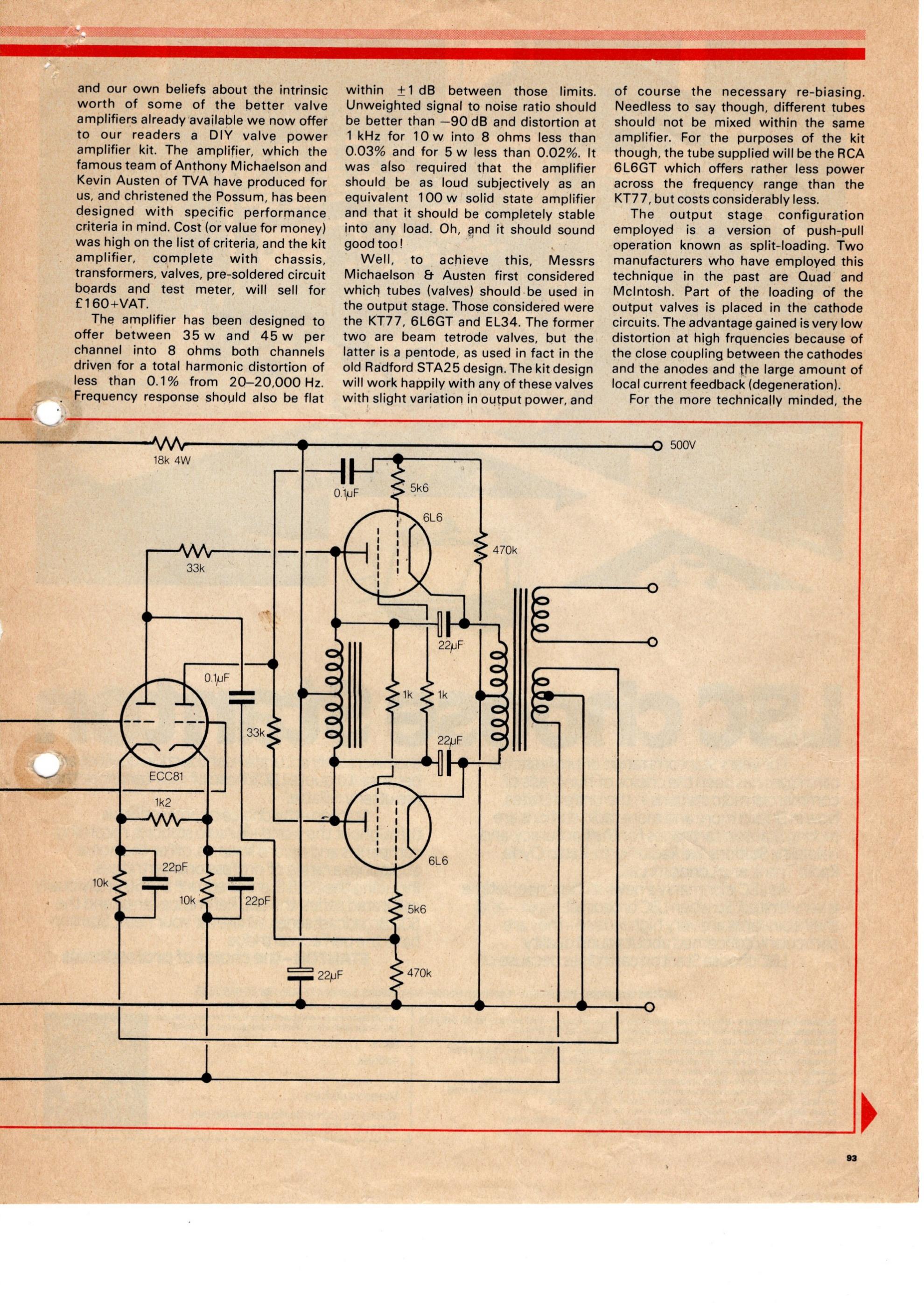

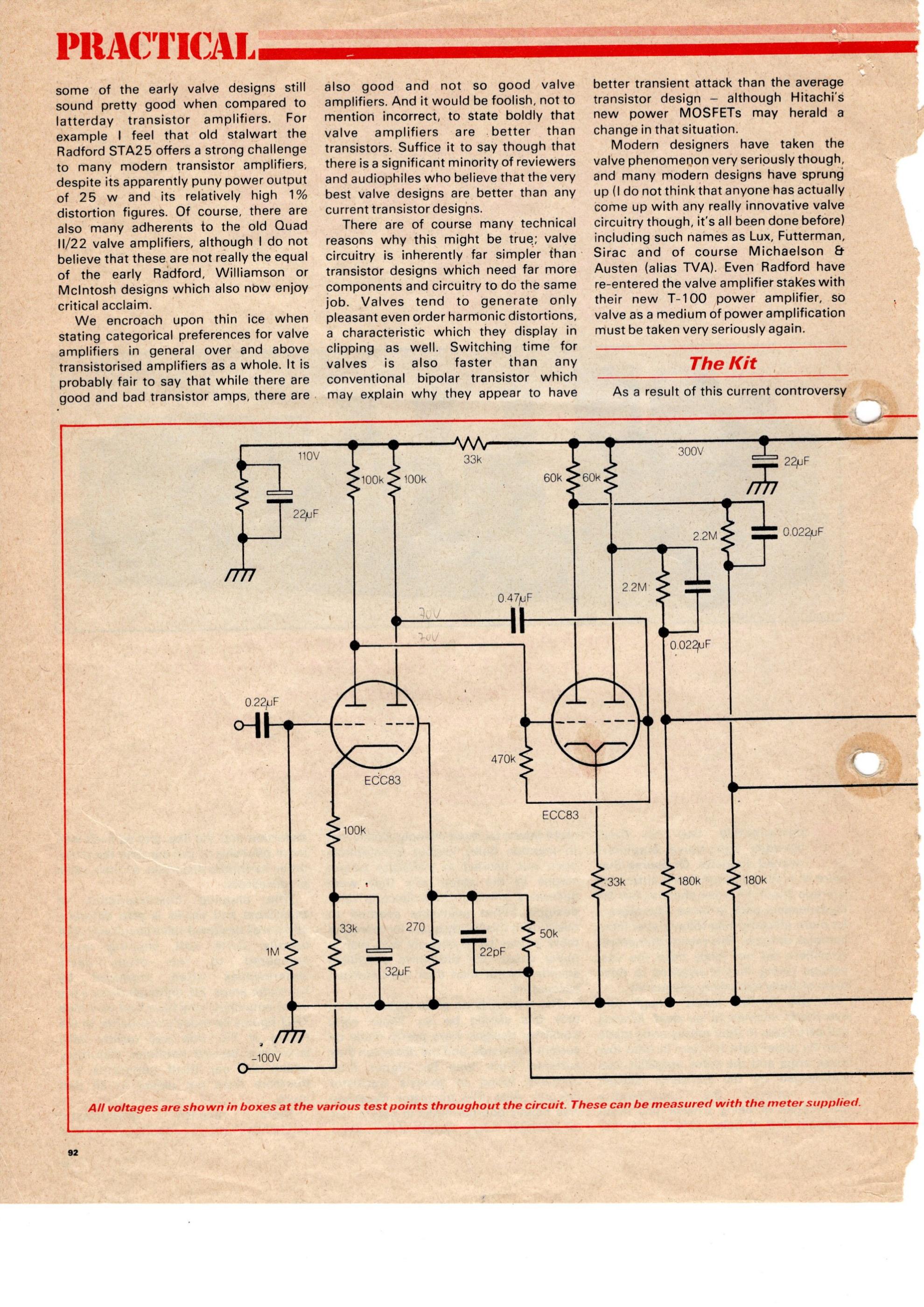

Unity Coupling has even been a subject of DIY, see the attached article that I've found in a British electronics magazine in the late 1970ies. Despite the wording in this article, this »Possum« amplifier apparently has nothing to do with Michaelson & Austin, but was developed by Tim de Paravicini instead. It shares the driver section with his E.A.R. 509 amplifier!
Note the severe drawing flaws in the »Possum« schematics.
Best regards!
Best regards!
Best regards!
Thanks for posting those articles/schematics. Pretty cool. I've thought about adding feedback in my UC amp from the feedback winding to the driver cathodes like this.
However, it did make me want to scream a little bit when the author referred to series applied voltage feedback as current feedback. And then he states that the drive required for the output tube grid is 200Vpk-pk, when it is more like 450Vpk-pk. Makes me wonder how much else he got wrong in there.
