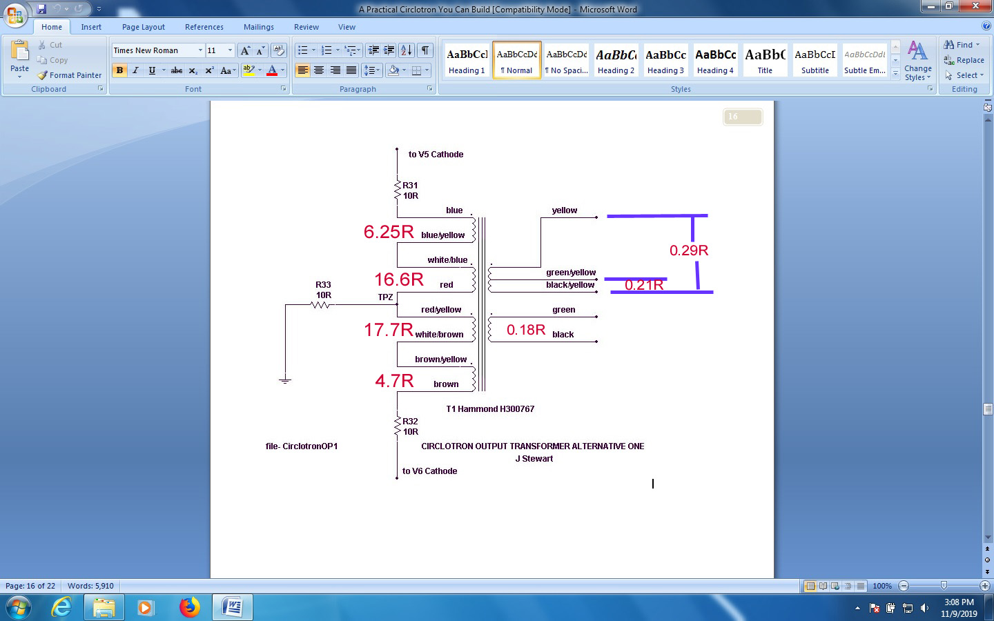

Hammond H300767 Winding DC Resistances
These measurements all done by the 4-Terminal method, eliminate test lead & contact resistance. ALL the leads are brought out, not connected as shewn on the dwg. The results indicate the transformer was wound serially.:)
No attempt to balance the opposite sides of the primary, but no matter the signal is across the ends(bridge output). The CT doesn't matter. it is simply a DC return for some low level circuitry.
Only those with bat's ears could claim they hear a difference. As they often do, without proof!!:D
