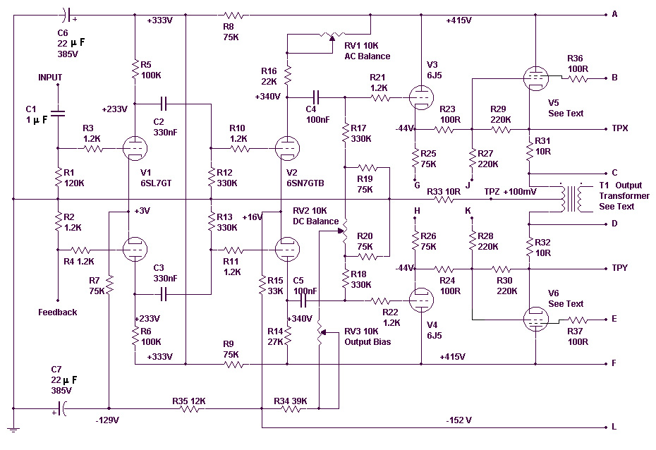

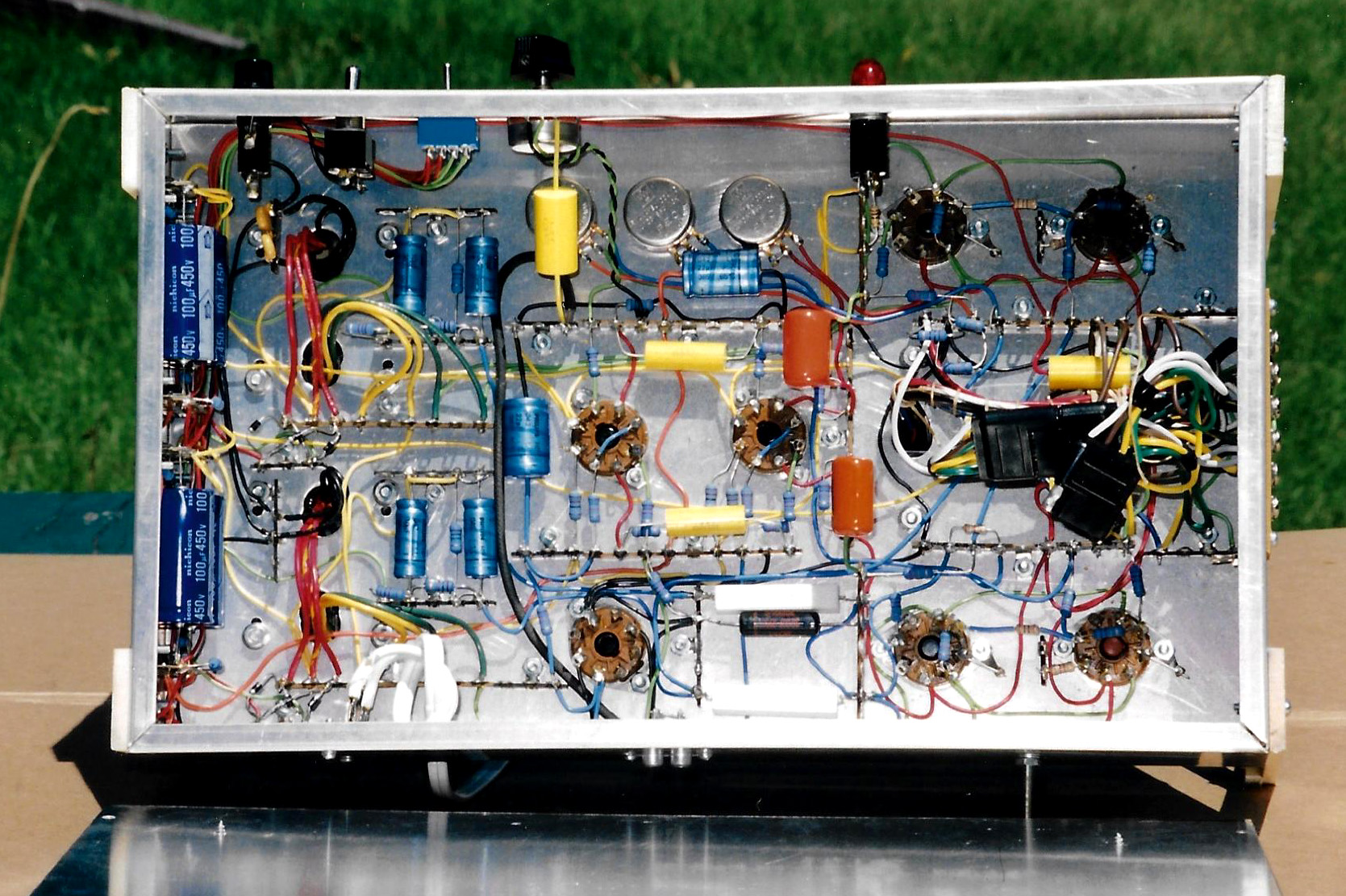

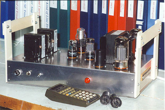

Another Circlotron
I did this one in 2001. 50W+ using 6550 or KT88s.
Its still sitting here on the shelf with several other of my brain storms doing nothing. Lots of measurement data including some running 6L6GCs.
Did a couple of odd OPT hookups, I'll post those later.🙂

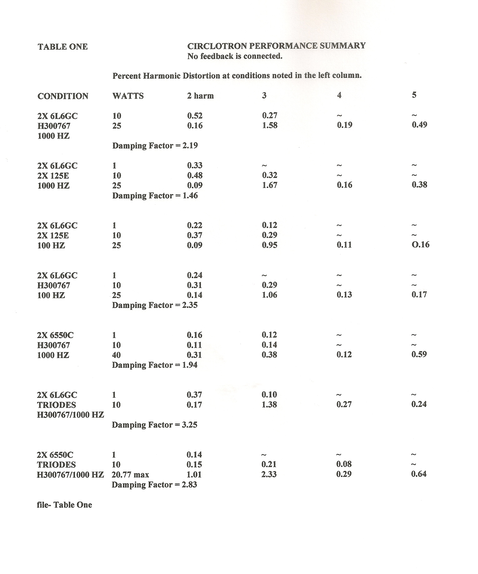

I'm interested in the output transformer details as well. Open-loop DF looks kind of high compared to my UC amp so I'm wondering how much of that is due to the output transformer and how much is due to other factors.

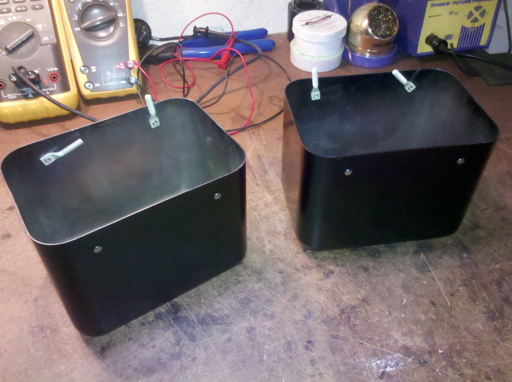

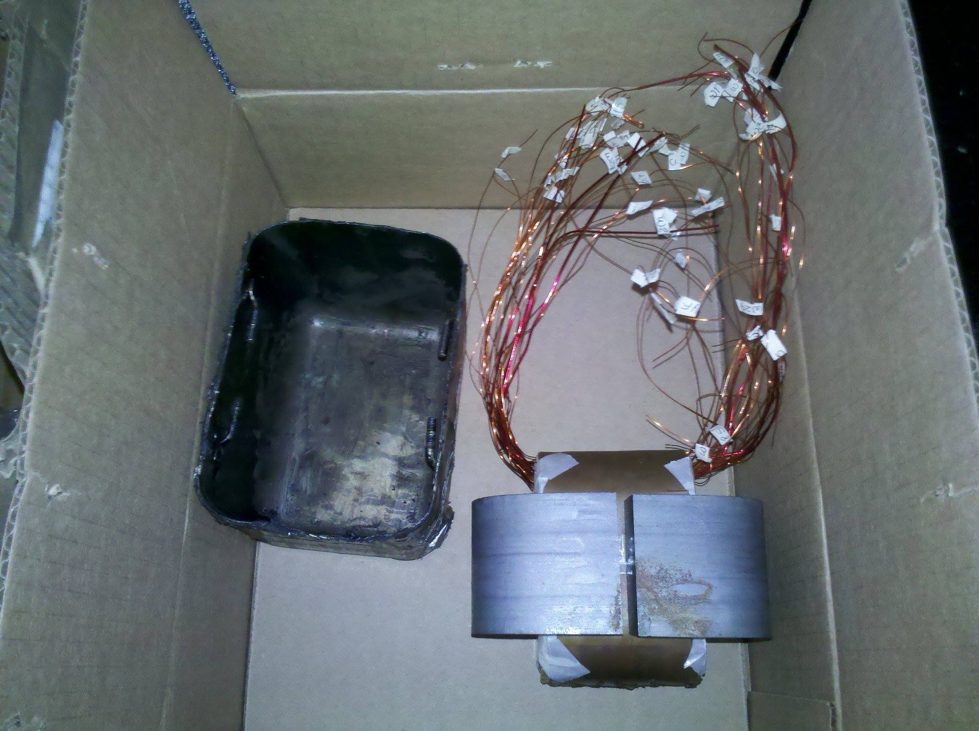

Here are some photos of when I wound McIntosh 75 OT's... I have wound these many times over the last 25 years...and they perform perfectly... Transformer engineering is my career no just a hobby...
Thought these photos would be interesting to see..

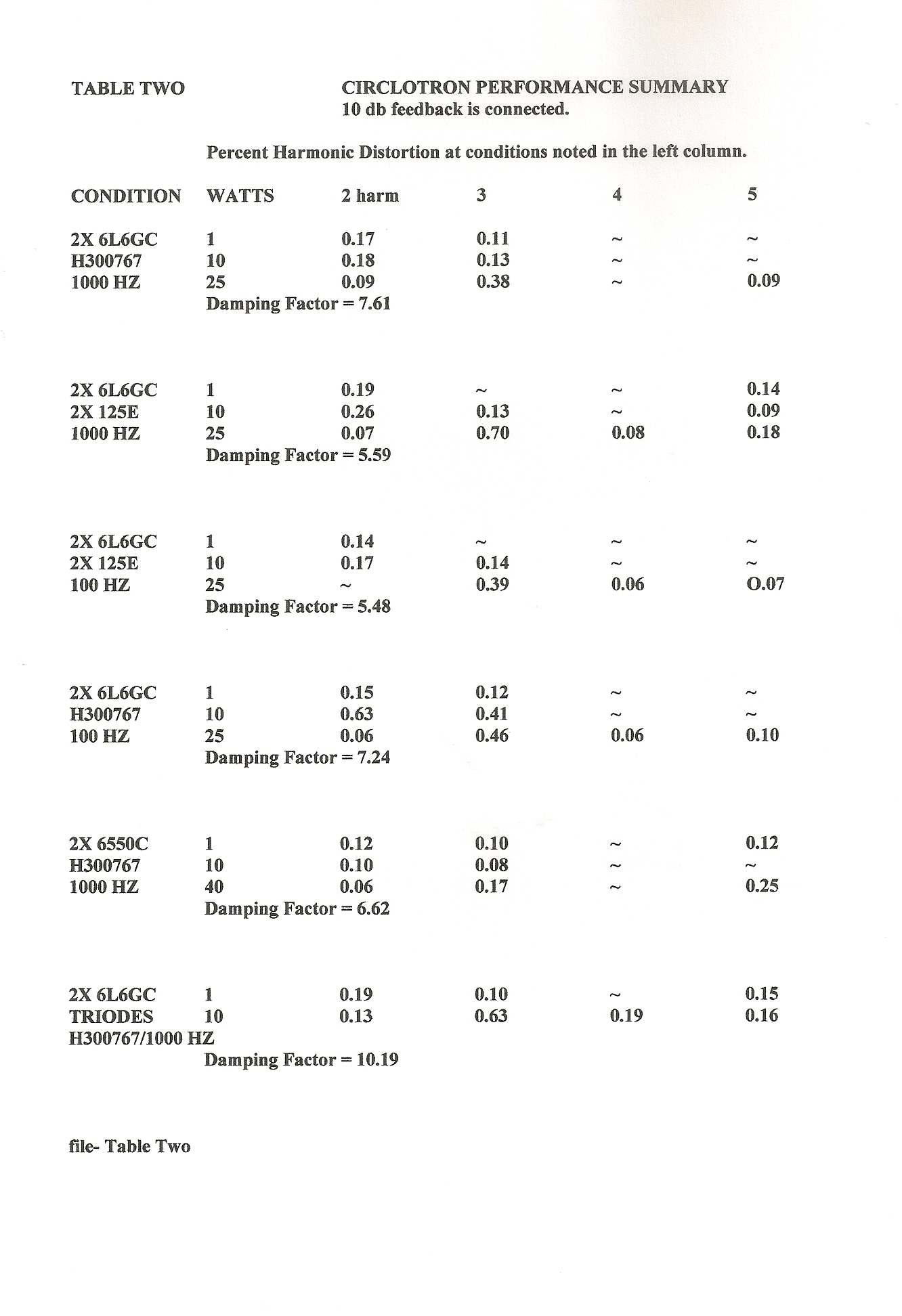

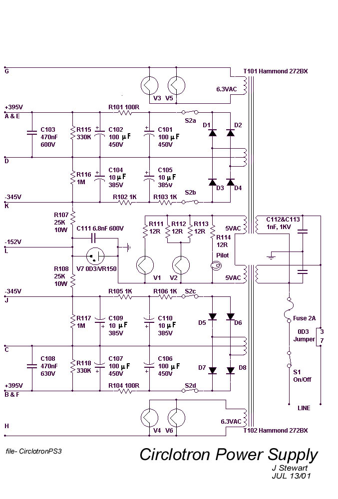

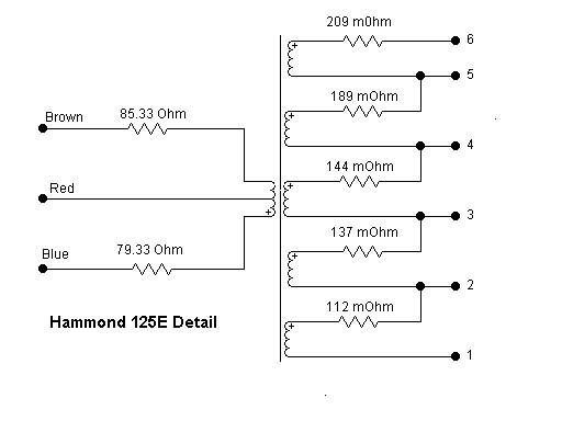

Rather than putting together a new explanation of the OPTs, Etc, I’ve simply copied parts of the original text of the article covering this amplifier. It was published in May 2002 issue of AudioXpress magazine.
DC resistance for the H125E’s was done by the 4-terminal method, driven by a SS CC source.
I don’t have any DC wdg Rs for the H300767 Hammond made for me. It is wound on the same core as an H1650N OPT. The primary is tapped similar to an UL, but set to reflect 1400R from the outer connexions or 800R from the inner pair. That way I could run PP 6550s or PP 6L6GCs. When the weather gets bad I’ll get some DC wdg Rs.
With the exception of the OPT there are no special parts or tube selection. All off the shelf.🙂
Wow, those are impressive. Thanks for posting the pic. Is every tag a separate external connection?
Hey, thanks. My UC transformers have a 6.4k:8 impedance ratio, so when one tube is cut off, the other is working into a 1.6k load, which is twice your 800R. That alone explains a good deal of the difference in DF. My UC amp has an open-loop DF of ~7.3 (1.1 Ohm measured Zout).
I'm wondering if the Hammond H300767 just has relatively high DCRs as well? I know that the Plitron transformer I used is a really low DCR design. Less than 80 Ohm total primary resistance and a 0.18 Ohm secondary.
Local feedback ratio should be the same for the circlotron or the UC circuit. Did you run the output tubes particularly lean? That could raise Zout a bit too.

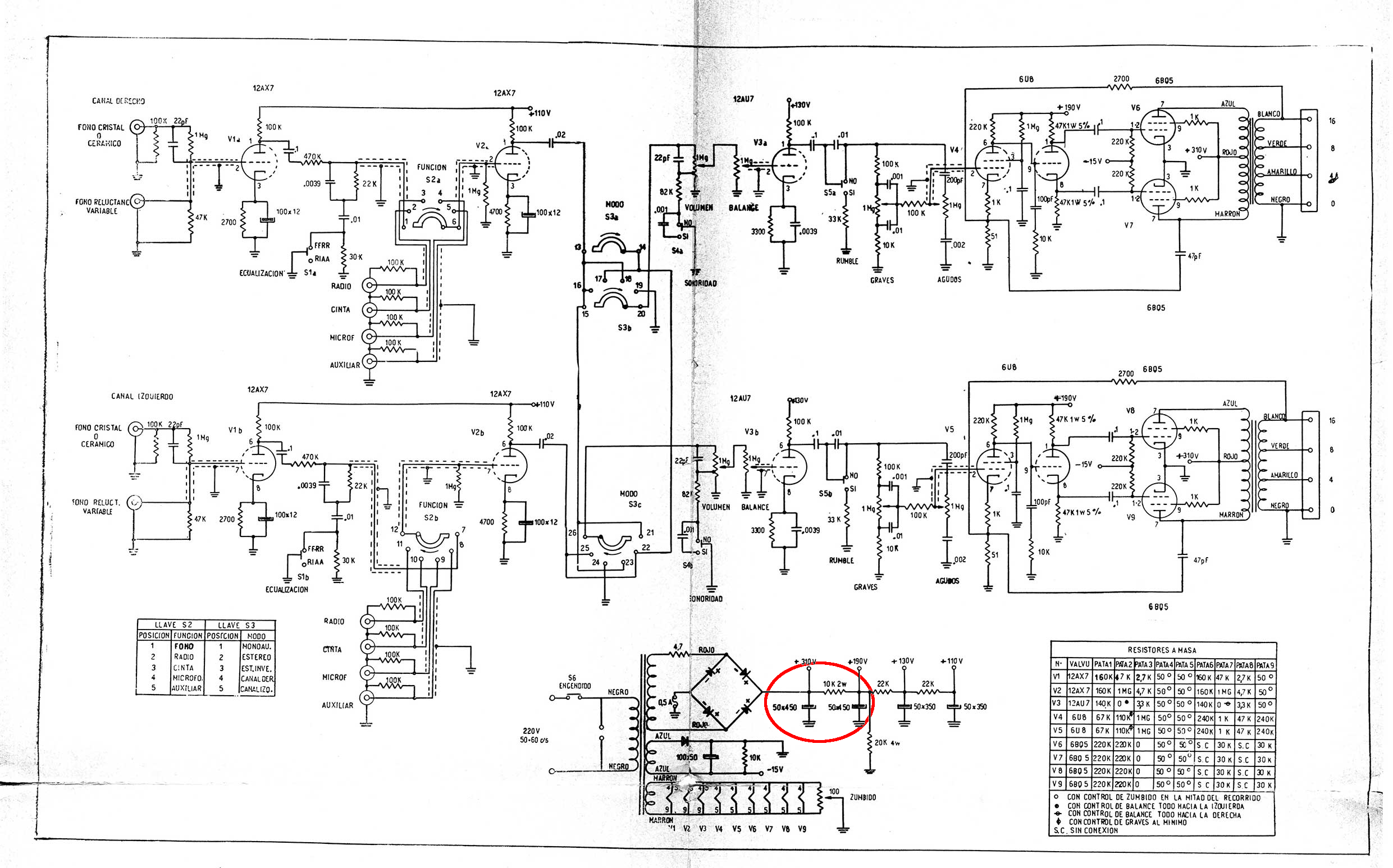

The first valve amplifier I assembled was the classic one I attached here known as "Silco".
I remember that he had hum, and he changes (uselessly) the OPTs believing they were to blame ... but the manufacturer attached the leaflet with the wiring and all the colors of the cables.
In those years (1967) the solid state began to "make noise", so assemble the classic RCA of quasi-complementary symmetry. The idea was to copy the MC Intosh MA6100! So to make it less complex, I decided to build the power and the preamp separately. At that time around here there were people who made the transformers to order, and did a good job.
I ordered EI oriented grain sheets, the winding attached to the middle for the two sections of the RCA (+ and -) and a 110 volt branch for the preamplifier.
The amplifier still works perfectly, the pre could never finish it.
I would have to upload some photos in the corresponding thread ....😉
Here is something ...
Preamp MC Intosh MA-6100 (DIY)
