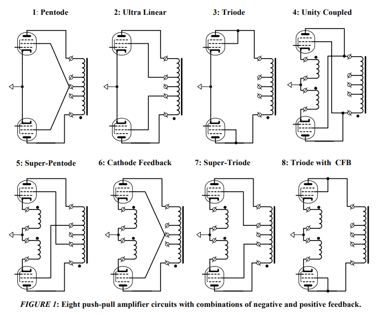

I don't have any of Menno's books. On Veen2EN.pdf the 8 circuits are shown with same nothing for Unity Coupled Circuit 4. There are 4 other circuits using windings as cathode feedback but Menno does not name them Unity Coupled. Please confirm. I suspect Menno found something with Circuit 4 but would not mention anything, perhaps out of his respect to MacIntosh.... He describes that transformer *always* in the context of the Unity-Coupled circuit. All circuit diagrams show those windings used as cathode windings...
Datashets show 3.5% cathode feedback winding for the 1070-UC. On a non potted one, it is possible to manually add winding to allow Unity Coupled operation at feedback ratio 1.
The datasheet is rather confusing giving labels of screen grid to a couple of windings and no reference to how they are to be used in circuits. Seems I mistook the single 3.5% feedback winding for cathode feedback use.Trust me, I've got both of Menno's books. The 1070-UC is the bifilar-wound transformer with two identical primary windings, one meant for anode, the other for cathode....

Or is Cathode feedback an entirely different thing?
Cathode feedback is a similar concept, but a much broader descriptive term.
Cathode FeedBack(CFB) is a term that describes a circuit whereby feedback from a winding on the OPT is applied to the cathode(s) of the output tube(s). It can be a separate winding expressly for this purpose as found in some old Arcosound transformers, or it can be the speaker winding itself.
Cathode feedback attempts to correct some of the distortion caused in the output tube and the OPT by applying feedback to the output tube only, not over the entire amplifier as in Global Negative Feedback. The feedback ratio in this case is a small fraction of the plate voltage swing, usually less that 10%. A modest increase in drive signal to the output tubes is needed to offset the gain reduction caused by this feedback.
In a single ended amplifier (CFB) can make some cheap OPT's sound bigger than they really are and improve their bass response. If the OPT has design issues (unintentional, or intended for cost reasons) the cathode feedback may not offer an improvement, but rarely causes serious problems unless it is inadvertently applied with the wrong phase.
My SSE amp design can use CFB from the speaker winding as an option. I find that it helps the bass a lot when running a big tube like a KT88 in UL mode driving big speakers (15 inch OB drivers) with loud dynamic music like Pink Floyd. I prefer triode mode with no feedback at all with an EL34 or KT88 for less extreme music.
In a push pull amplifier cathode feedback can be used for the same reasons. In order for it to make an improvement, the OPT must be wound such that both halves of the primary and secondary are symmetrical. Phase and amplitude imbalances between the two halves can apply different levels of feedback to the different sides of a push pull amp. These imbalances will vary with frequency and can make matters worse at the low and high frequency ends of the audio range than no feedback at all. This has been the case with ALL of the cheap EI core OPT's that I have tested in a push pull amp. In some cases CFB provoked amplifier instability.
Some popular old tube amps employed CFB with good success. Audio Research was one of the popular companies to do this using the speaker winding. The OPT must be designed for this use though.
Unity Coupling is an extreme case of CFB. The feedback ratio is exactly ONE, and must remain one over the entire audio range in both amplitude and phase. The plate and cathode windings are essentially the same, and are often wound together (bifilar). This places extreme insulation requirements on the wire used in the OPT.
Unity Coupling reduces the voltage gain in the output tubes to two or less, requiring a LOT of drive voltage. Mac employed a positive feedback "bootstrapping" arrangement to get the voltage swing required to do this, but other methods exist, including the use of driver transformers.
The advantage to Unity Coupling is the removal of the distortion artifacts that occur as the output tubes pass through the "crossover" region where one tube shuts off and the other takes over.
The balance between the two halves becomes critical with a unity coupled OPT. Serious imbalance in the transformer can make the amplifier unstable with no hope of correcting it short of making a new transformer.
I bought a large quantity of cheap ($16 each) OPT's many years ago to make guitar amps. I have used them successfully in HiFi amps when driven by a low impedance circuit. They do NOT work well with CFB in any case. I have been meaning to try the Crowhurst twin coupled design with them, but haven done so yet.....someday.
I have managed to add CFB windings to "dumpster toroids" with limited success. I doubt that you could stuff enough wire through the hole, and get it even enough to work properly for Unity Coupling.
The bottom row of figures are using transformers in the 10-20% CFB range (I can't remember right now how much his transformers have). The UC case in the upper right corner is the 50% CFB bifilar transformer (1070-UC). He notes in his book (and it is intuitively obvious) that the cross-coupled screen-to-plate connection in the UC circuit will not work with a normal CFB transformer of less than 50% CFB because there will be a whole bunch of positive feedback to the screen which will cause instability. In the 50% CFB case it works really well because the voltage between screen and cathode of each tube stays constant and the tubes operate as pentodes.
He mentions plenty about McIntosh and the circuit in his books and on his website where the transformer is for sale, so I don't think he is averse to sharing his thoughts on the circuit. The virtues of the circuit and large driving voltage required are well known.
