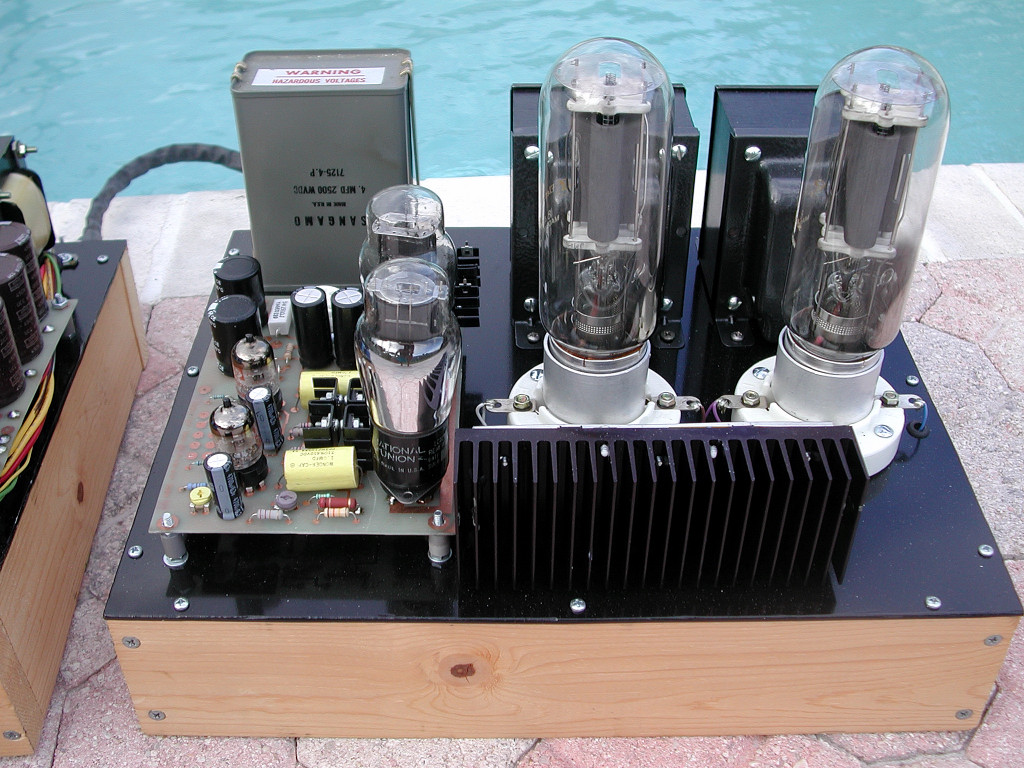

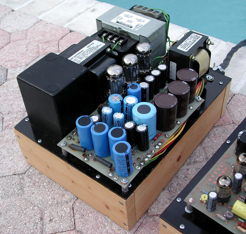

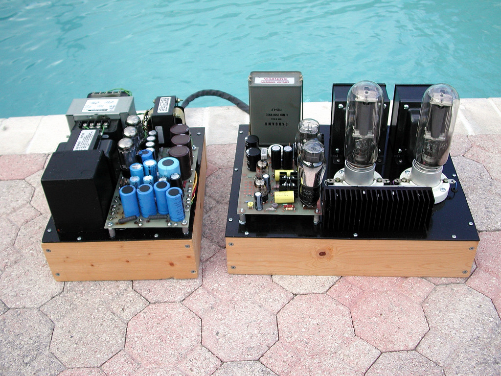

here's a 20w single ended tube amp... can I make one like that pretty easily?
That amp uses the 845 tube originally intended for radio transmitters. I designed and built my own. It makes almost 40 WPC and runs on 1100 volts. Are you ready for the safety, layout and assembly issues associated with that level of voltage?
How much difference does it make putting the power supply in a different box?
In some designs it make sense for two reasons. The power supply by nature is full of electrical noise so it can be good to keep it away from sensitive electrical circuits. I reasonable sized amps this can be mitigated by careful layout. The other reason, and the one that I used in my 845 amp is that putting the power supply and two large output transformers and the power supply all in one box makes for something too large and heavy to me easily moved. Pictures of my DOY 845 amp are enclosed. I made it almost 15 years ago. My woodworking skills are a bit better now.
