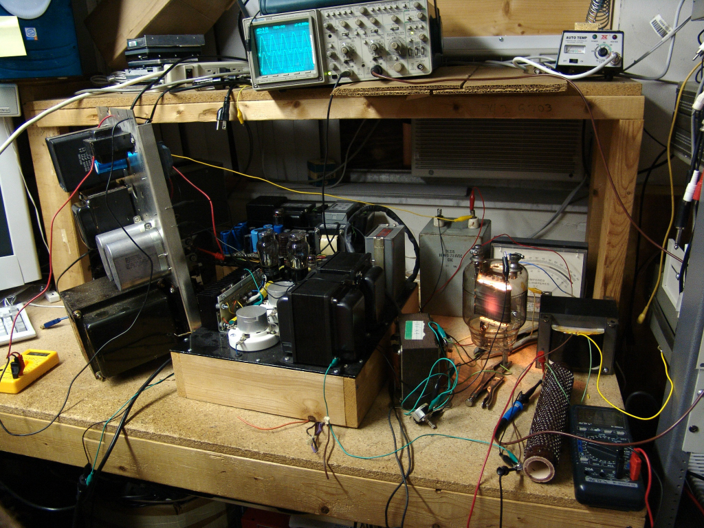

The biggest single STAGE amp that I personally have made was about 8 watts per channel. It was an experiment to see if it could be done, and it wasn't good for much. The biggest single stage amp seen on these forums is 5 watts or less.
The biggest SINGLE ENDED amp that I have personally made was 200 watts. It was again an experiment to test a custom transformer that I had wound by an experienced transformer winder at a cost of $200. The transformer turned out to be not good enough for HiFi, but it made for a wicked guitar amp. The test amp ran on 1500 volts, and is NOT something that should be attempted by an inexperienced builder.
I'm sure that given enough money a 1000+ watt SE amp can be built. They have been commonly made for years, as the modulator stage in a radio transmitter.....again the transformer and the super deadly voltages are the issues.
Sometime later another member of this forum took the same concept further, had some custom transformers made in Europe and successfully build a 200 WPC SE amp for "cheaper than a Corvette..." This amp runs on 2300 volts which can make you dead real quick....no margin for error. His build thread is here:
The Midlife Crisis - My 833C Amp Build

My 200 watt SE amp ended in failure because the OPT was not good enough for the job. The winder expressed his doubt's at the time he made it, but I dropped the $$$ and took my chances. I lost. I still have the transformer almost 15 years later, and maybe I will build a monster guitar amp some day.

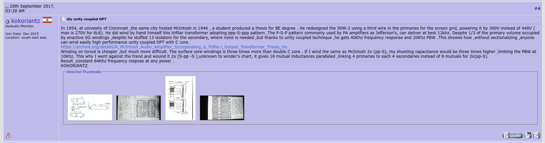

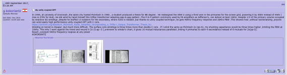

This guy said he made a unity couple OT by hand for $36 in parts and it tested out with good measurements.
Winding Unity Coupled Toroid OPT+IT
To be honest if he and others "really" did that then I can do it and I think the best path is a MC240 or MC275 clone and then work on improving the quality of the parts if there are better parts in 2019 than in 1960s and I've heard about some mods like a charged tube or something like that (something like putting a 9V battery on one of the tubs) that further reduced distortion.
If I can't ever figure out these unity coupled OTs then I'll just have to find out what the next best thing is. That's why I went for the next best amp that I remembered and that was the Conrad Johnson, but seems not many know how they are made either.
