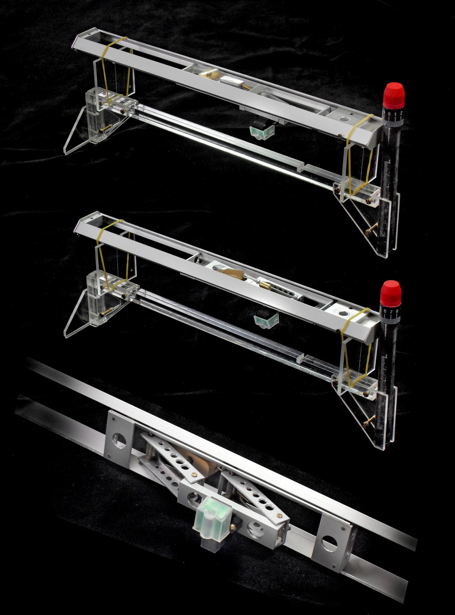

This flat parallelogram is just the pocket-size version of the mobile parallelogram, Mike's invention.

Thanks Carlo for sharing CORKSCREW MK2, this is brilliant and probably the easiest to make and most stable to operate.

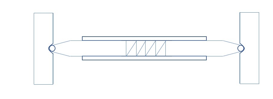

Is that a good idea to load a 2mm od spring between the backs of ballpen tips for easier assembly?

Thanks for the praising/teasing, friends - Carlo is just an old mule who tries everything possible to waste time.
2A3 - Sorry to disappoint you, unfortunately this is one of the most difficult arms I have built, and i'm still modifying it. Keeping the parallelism is anything but trivial: no play at all, and pivots positioned to the hundredths.
How will you use the spring? On CS, as previously on Lil Casey and others there is an elastomer, a small piece of O ring in the center of the groove for the two pentips

Hi Carlo, I was thinking about using spring to hold the tips instead of adjusting the set screws, punching on side walls is probably easier to be accurate.Thanks for the praising/teasing, friends - Carlo is just an old mule who tries everything possible to waste time.

Great, when finding a 2mm spring with the right force.
A piece of 2mm diam. O ring chord in the same position is fine for me: gives the right pressure on pentips, prevents their rotation and seals the ink (or grease) inside. 3 jobs for a single small piece of plastic (it can hardly be seen in the photo of parts ).

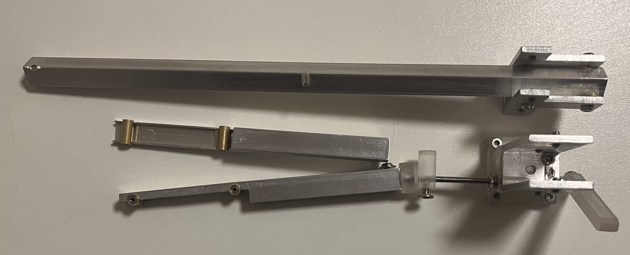

I am using rubber grommets on the parallel arms which has the same effect of giving spring loading on the pivots but I feel happier with the pivot rigid as well. i haven't built both to compare!
I had bit trouble with ball-pen tip bearing esp in cold weather as the oil is more sticky.
So I tried the regular bearing instead, it works well and not so sensitive to pressure on the tips holding the bearing.
Very good, 2a3set. I did the opposite, using ball bearings on the first Lil Casey and pentips on the carbon and the prism versions. Less friction (measured) and perhaps less chattering.
At this point (really good cantilever behavior) try to reduce as much as possible the weight of the mobile masses (ie vertical effective mass). The grooves made on the rail for that also reduced noticeably its resonances.
I have still the desire to make one in carbon fiber, but the right square tube seems unavailable

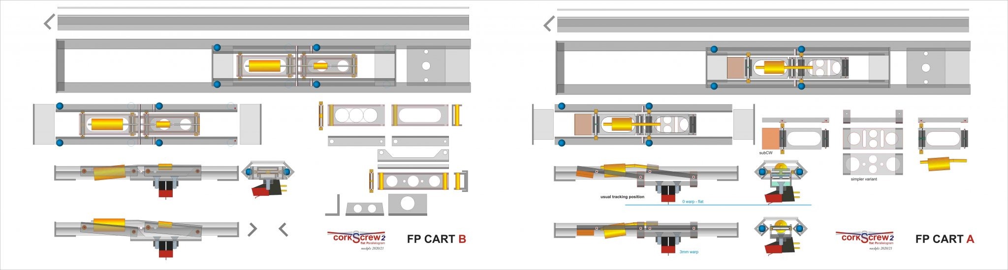

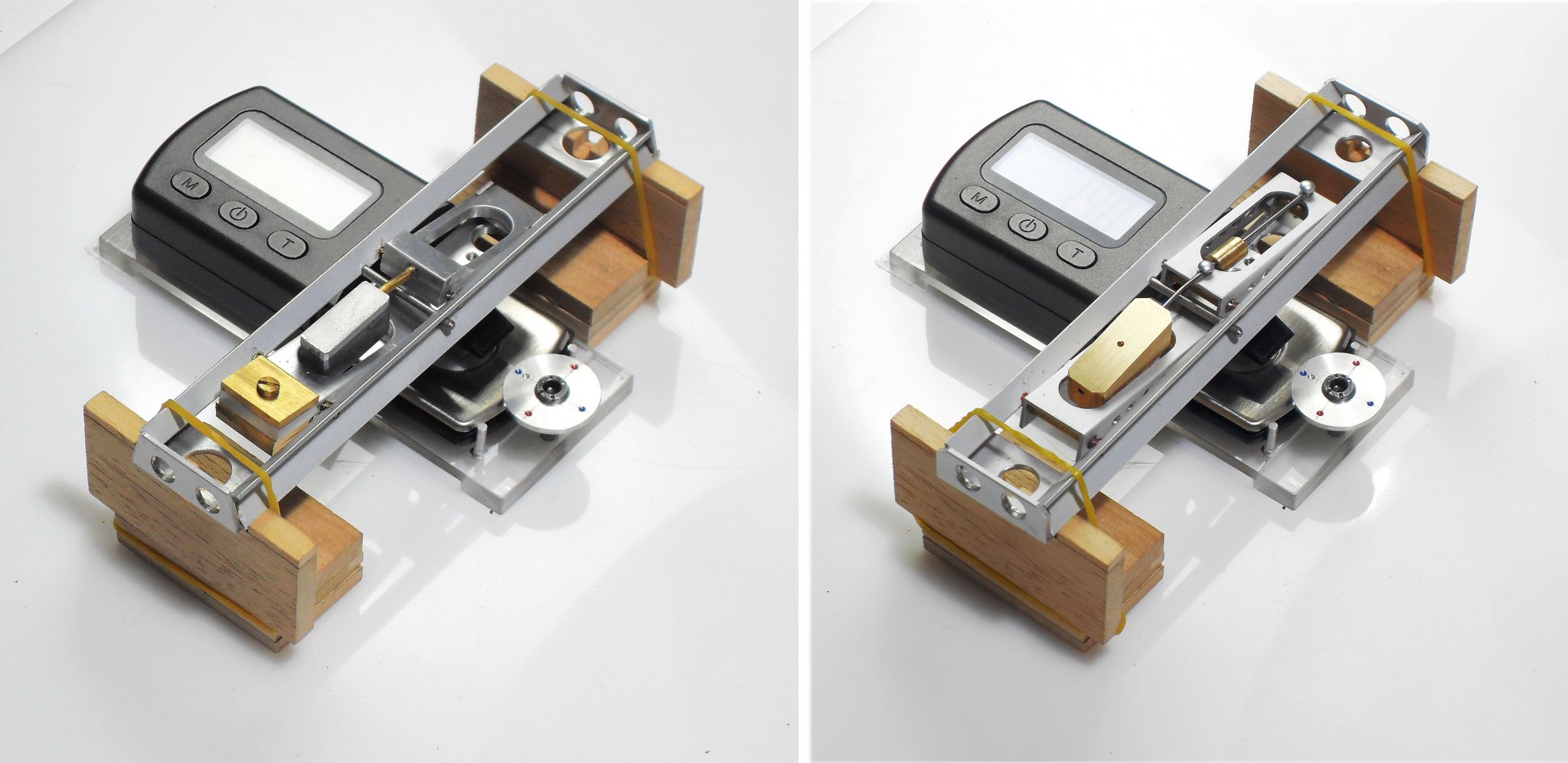

CORKSCREW MK2 MEASURES -(#4560)
sorry for the delay - but there was a good reason, beyond my laziness
my "crash test", although encouraging, showed a somewhat "hesitant" behavior: the carriage on eccentricities flowed easily, which is not unusual with non-recirculating bearing, but the movement was not as smooth as I like it. Mike56, who had some initial problems with CG placement, gave me helpful hints and I began to notice several other details to improve. In short, I built a second carriage: the improvements are small, almost not measurable, but the cantilever moves better, and this is important.
(drawings - attachment)
VTF VARIATIONS (digital scale setup - attachment)
The first A cart, reassembled, and the second B cart show not much difference; indeed the former perhaps moves better, due a single CW (instead of two different ones), longer base ("headshell") and more building precision

The digital scale measurements confirm the first rough tests done: very small changes in VTF due height (only 0,15 gr ca on severe warps >3mm) and a quite good repeatabilty (however worse than a good pivoted)
FRICTION - STICTION (sine bar set up - attachment)
A cart Total weight = 48 gr
friction - runs with a tilt of a 0,35 height / 300mm rail. angle = 0°2'17" = 0,038 decimal --- μ =0.00066
stiction - starts with a tilt of a 0,75 height / 300mm rail. angle = 0°5'10" = 0,086 decimal --- μ =0.0015)
B cart Total weight = 46 gr
friction - runs with a tilt of a 0,40 height / 300mm rail. angle = 0°2'17" = 0,038 decimal --- μ =0.00066
stiction - starts with a tilt of a 0,65 height / 300mm rail. angle = 0°5'10" = 0,086 decimal --- μ =0.0015)
A bit worse than the CorkScrew cart ones - and I was so proud to have reached 0.1 and 0.04 of parallelism! - Evidently some more play with a self centering rail doesn't hurt. and less weight too! (39 vs 48 gr)
The two carts have practically the same (average) measures, but not the same behavior - rolls unevenly the first A cart, really smoothly the second one, the B cart - an acceptably centered CG seems really to count a lot.

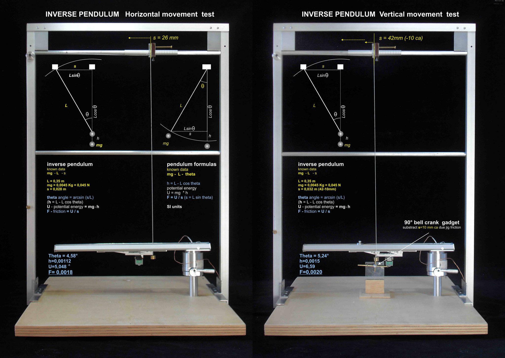

INVERSE PENDULUM (inverse pendulum set up - attachment)
as known, the pendulum measures are only stiction measures, and even less reliable than those with the sinebar (more measures for an acceptable average) However, their observation is very useful to better understand their behavior on a leveled rail.
(only for the cart B - the measurements of cart A do not give measurable average differences)
B cart Horizontal movement
displacement S = 0,0028 m
Θ (angle = 4,59°
H (mg height) = 0,00112
U (pot. energy) = 5,048-5
F (friction) = 0,0018 N
B cart Vertical movement
displacement S = 0,0032 m (42- ca 10mm)
Θ (angle = 5,24°
H (mg height) = 0,0015
U (pot. energy) = 6,596-5
F (friction) = 0,0020 N
A cart - H / VTF
0 / 1.58 - 0.5 / 1.56 - 1 / 1.55 - 1.5 / 1.58 - 2 / 1.60 - 2.5 1.62 - 3 / 1.75 - 3.5 / 1.73 - 4 / 1 , 72
B cart - H / VTF
0 / 2.22 - 0.5 / 2.19 - 1 / 2.22 - 1.5 / 2.23 - 2 2.25 - 2.5 / 2.18 - 3 / 2.20 - 3.5 2.08 - 4 / 2 ,10

Sorry, no youtube. Who wants to see this stuff has to make the effort to follow our threads, imo.
simply zipped .mp4 (conversion from .avi) due DiyAudio allowed formats
