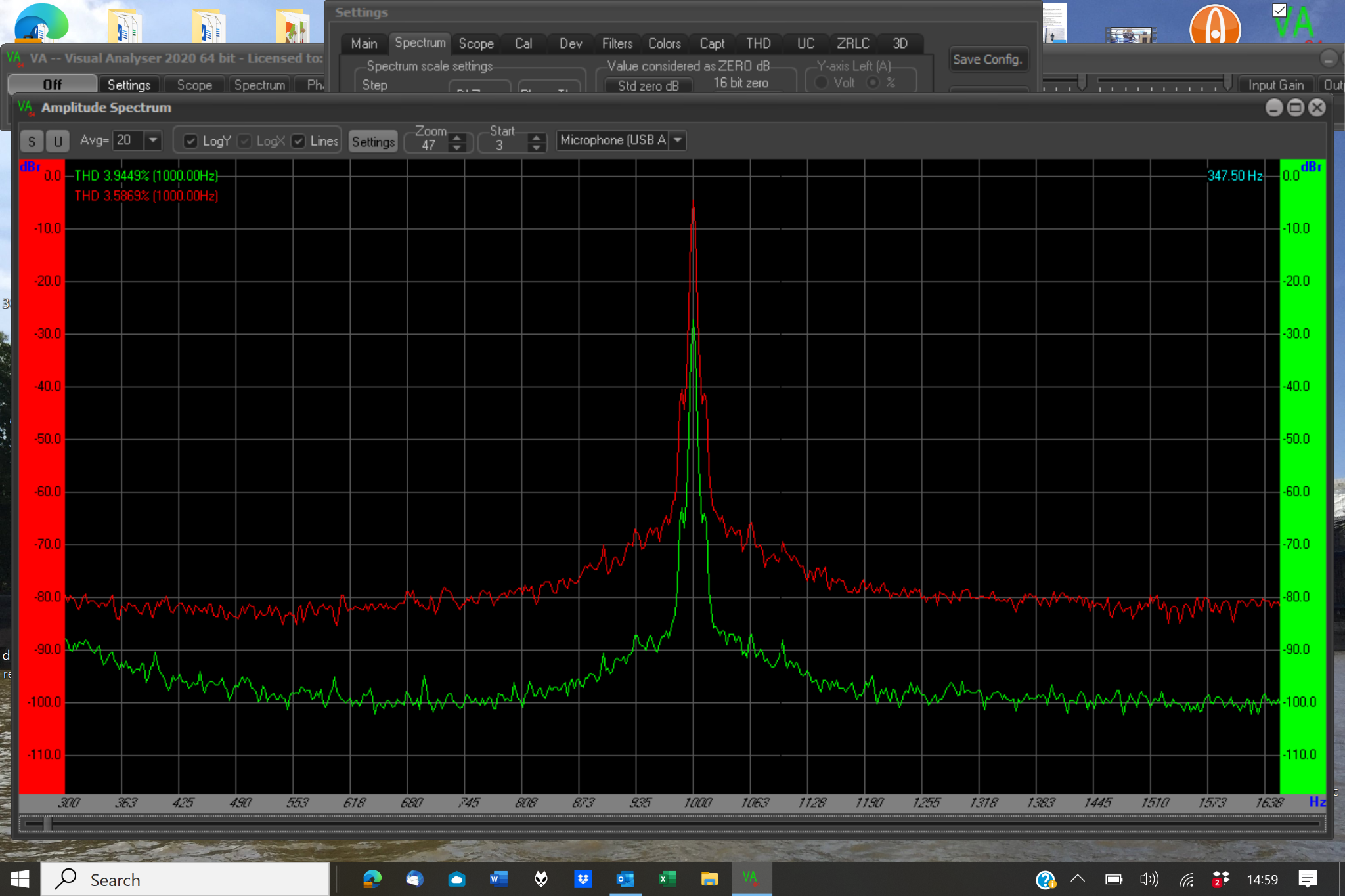

Good afternoon Andrey,
I haven't looked for the problem you describe, or become aware of it.
Maybe I have not understood correctly!
If Niffy were to play a constant tone test record recorded on one or both channels and display the output or outputs showing the level, do you think there would be a noticeable variation in the level over time?
I perceive this is the problem you are trying to solve.
Am i correct please?
If there is no variation over time you may be trying to solve a problem that is not significant.
What do you think please?
I have not heard or perceived the variation you describe.
I picked an example at 1000Hz and attached it , showing a recorded tone and its crosstalk to the other channel, and other artefacts. I have also done this type of measurement at around 3000Hz, but I have never seen any variation of the peak signal level with time at these scales. I have also run higher frequencies for frequency response measurements. I guess a variation in level of 1Db would be noticeable, but not audible?
M
There are lots of other problems that do exist, don't worry, but maybe we should add this one as well!?

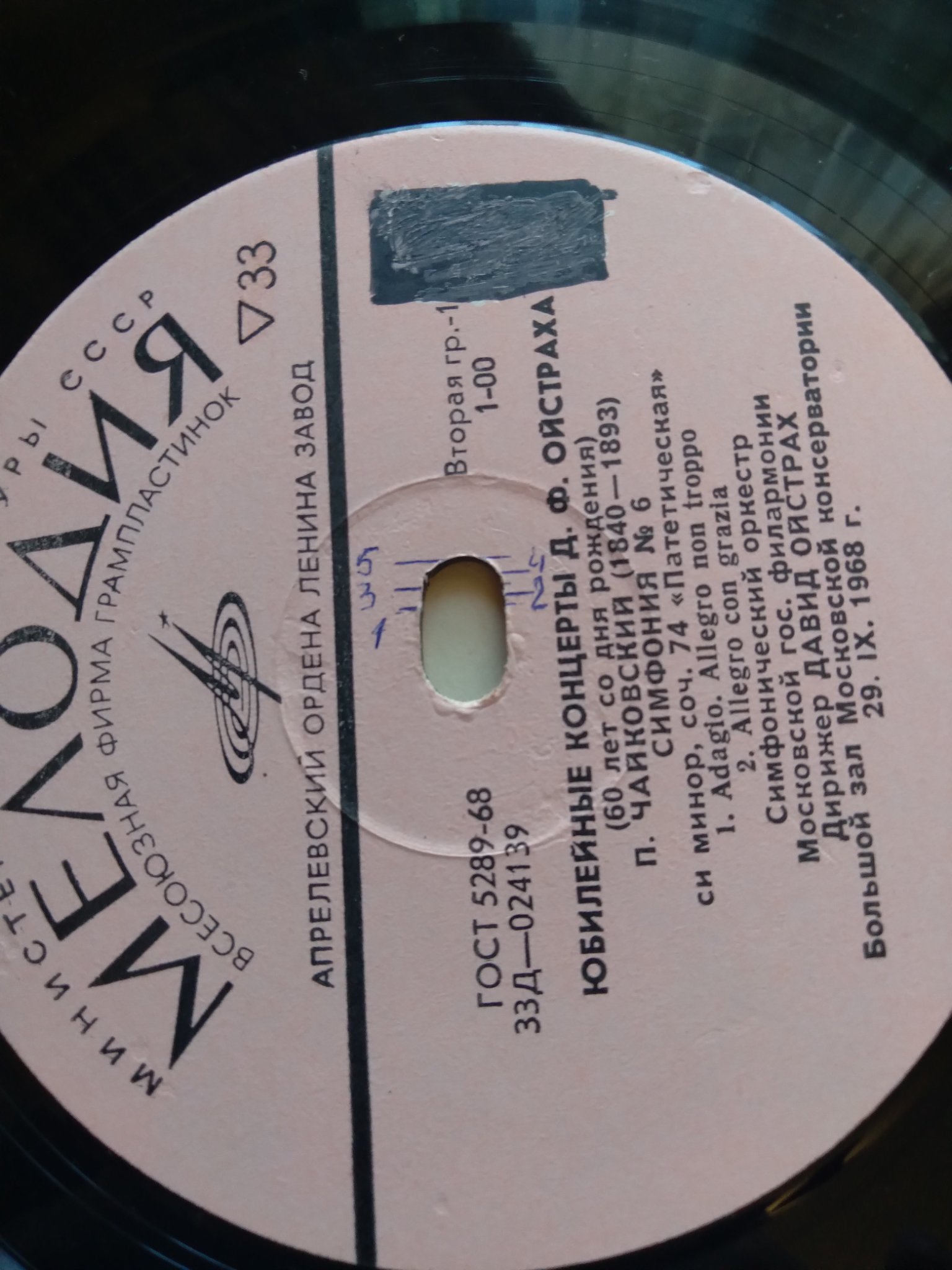

Mike56
You understood my question correctly.
But the research needs to be done differently.
I'll explain now. You need to take a record with high frequencies. Let's say from 10 kHz to 18 kHz.
Make artificial eccentricity in it with a file (see photo).
Connect the cartridge to a dual-beam oscilloscope.
You need to compare different frequencies at different eccentricities and see howthe signal changes in each channel.
Perhaps I'm exaggerating the problem, but most likely not.
High frequencies should decrease in turn, first in one channel,and then in the other.
The greater the eccentricity, the greater these swings will be. Left - right, left - right ....
If I'm wrong, I'll be happy.
AG.
