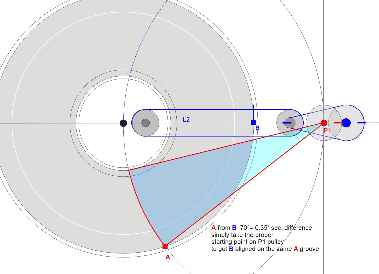

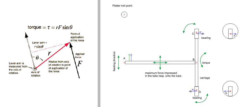

This is exactly what I wrote about in my post 5488 about synchronizing two cartridges.The pauses between tracks would begin earlier for the reading arm and would end earlier too.
But Carlo did not consider this a problem (5489).
Let's see what solution he has.
I have my own solution.
I would be delighted and intrigued to see your solutions Andrey, and any others out there.

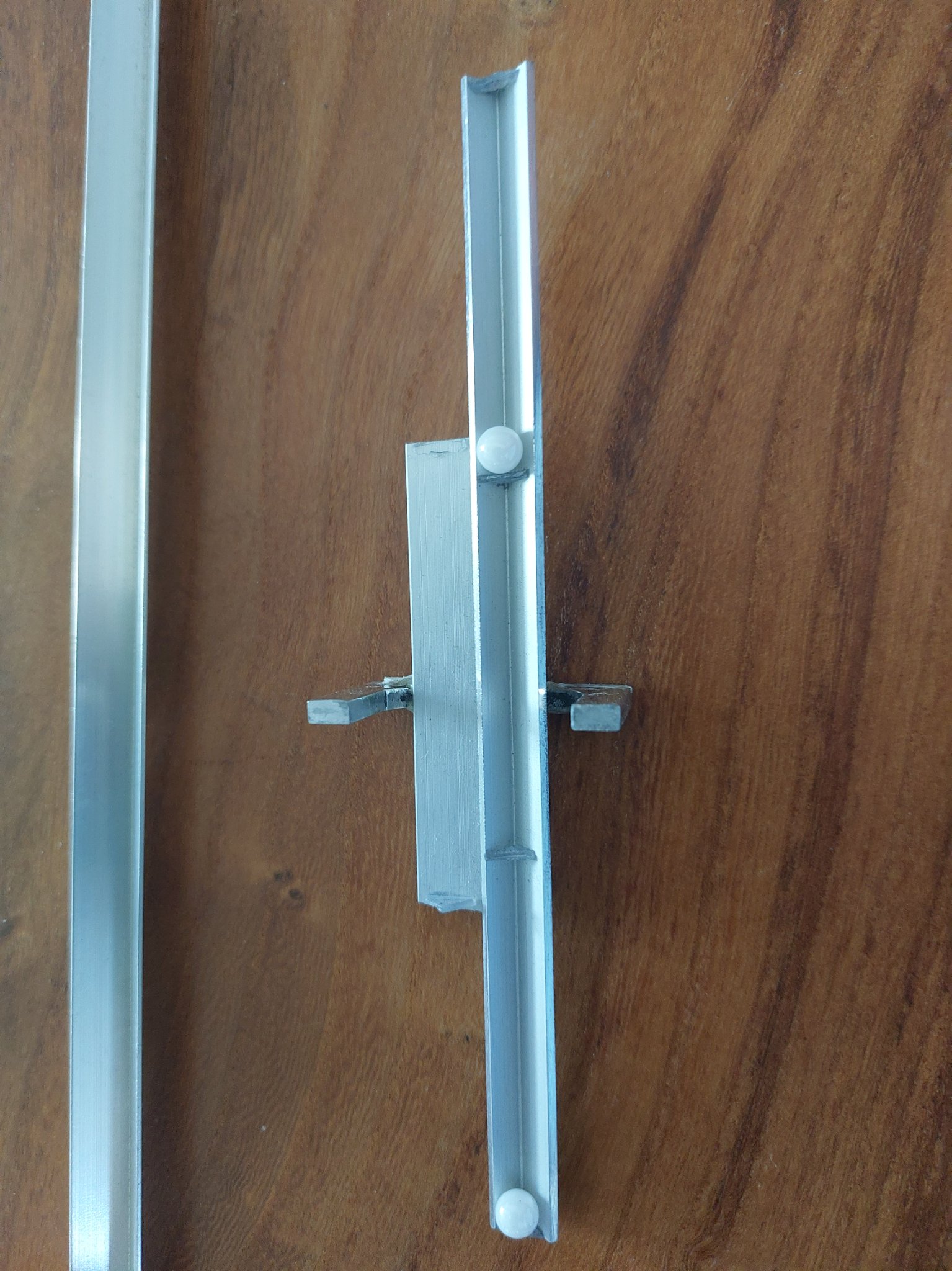

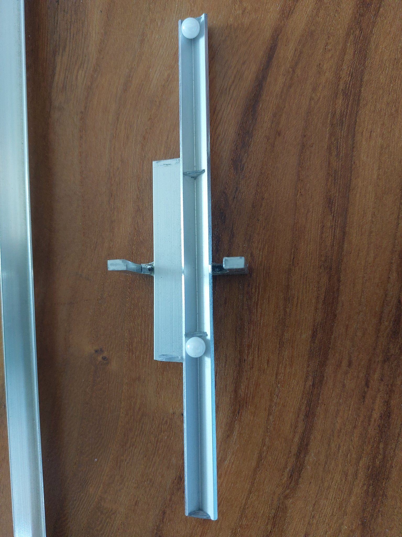

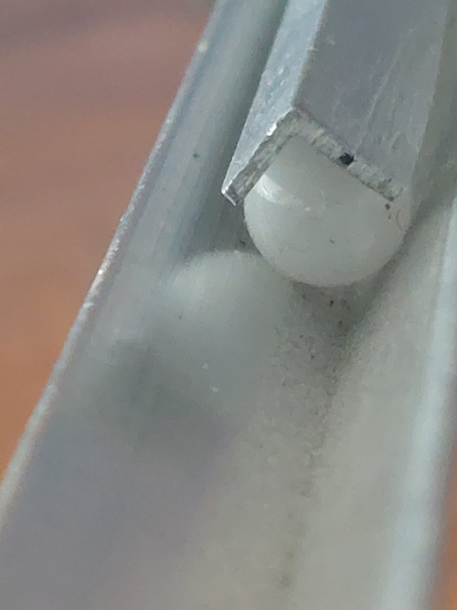

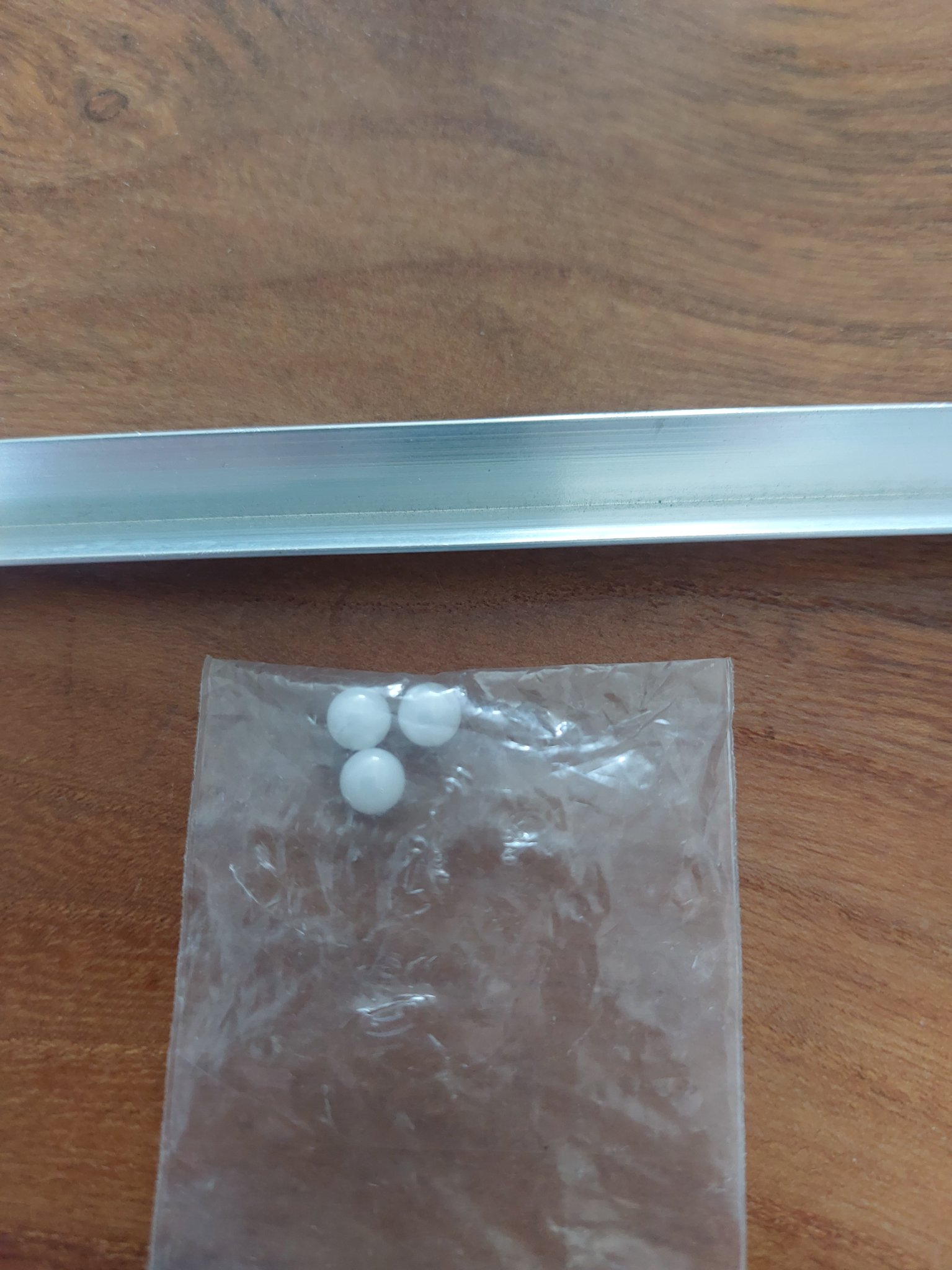

Thanks for the reply, Mike.Hi Paul, i built numerous experiments without any machining equipment at all, and i am sure many others the same.
Don't be daunted by that!
I chose non recirculating balls on anodised aluminium rails to avoid recirculating ball bearings and glass rails (where i also started).
Its an elegant and simple solution allowing low resistance with simple bought in parts.
M

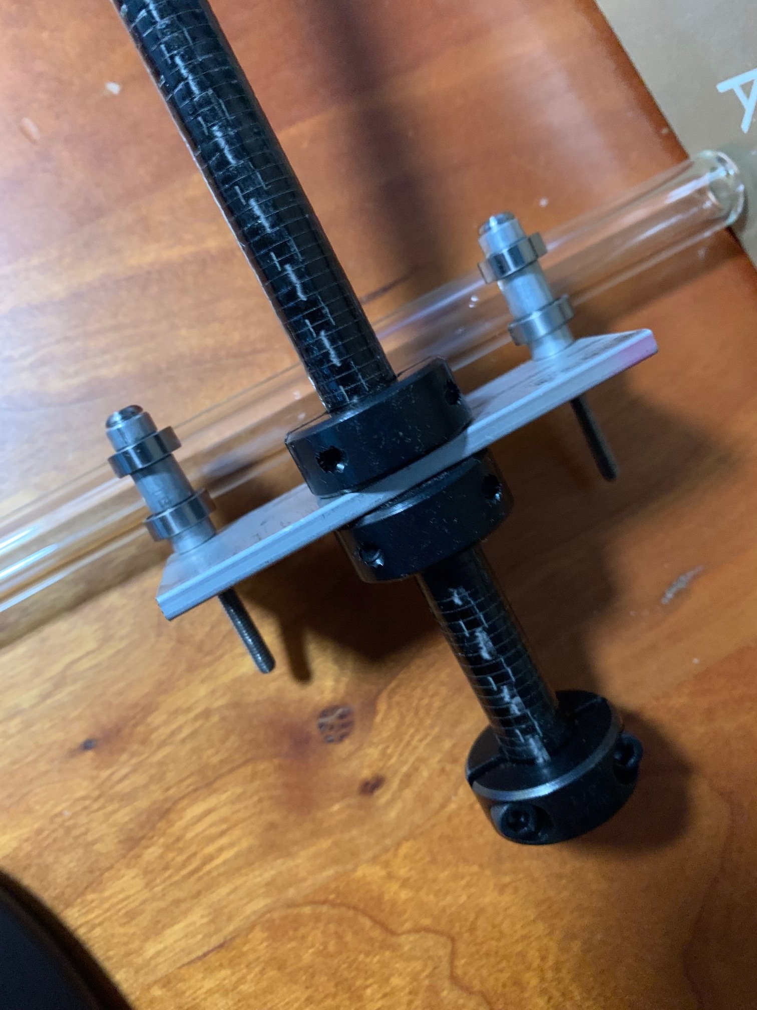

For the rails, do you mean something like these?
Linear Motion Shaft: Ceramic coated 6061 Aluminum
My first prototype, though I'm not even sure I'd call it that, more like an investigation of concept is pictured below. It uses a glass tube and these bearings:
3/16x3/8 ceramic ball bearing
Is that the sort of bearing you're talking about? If not, could you please elaborate (link, picture or description)?
It seems to me that there are 2 material (as opposed to design) upgrades from my current prototype. The first would be a tungsten carbide rod. I'm not sure where I'd buy this or if it would require machining I cannot perform. The second would be a jewel bearing design. What I've seen off the shelf is a bespoke design based on parts from a vendor like this:
Swiss Jewel
Is this the sort of thing we're talking about? These parts seem very small and fragile. Am I wrong about that? I'm also not clear which parts I would use and I don't know what I'd use as a disc or wheel.
Initial "investigation of concept"
