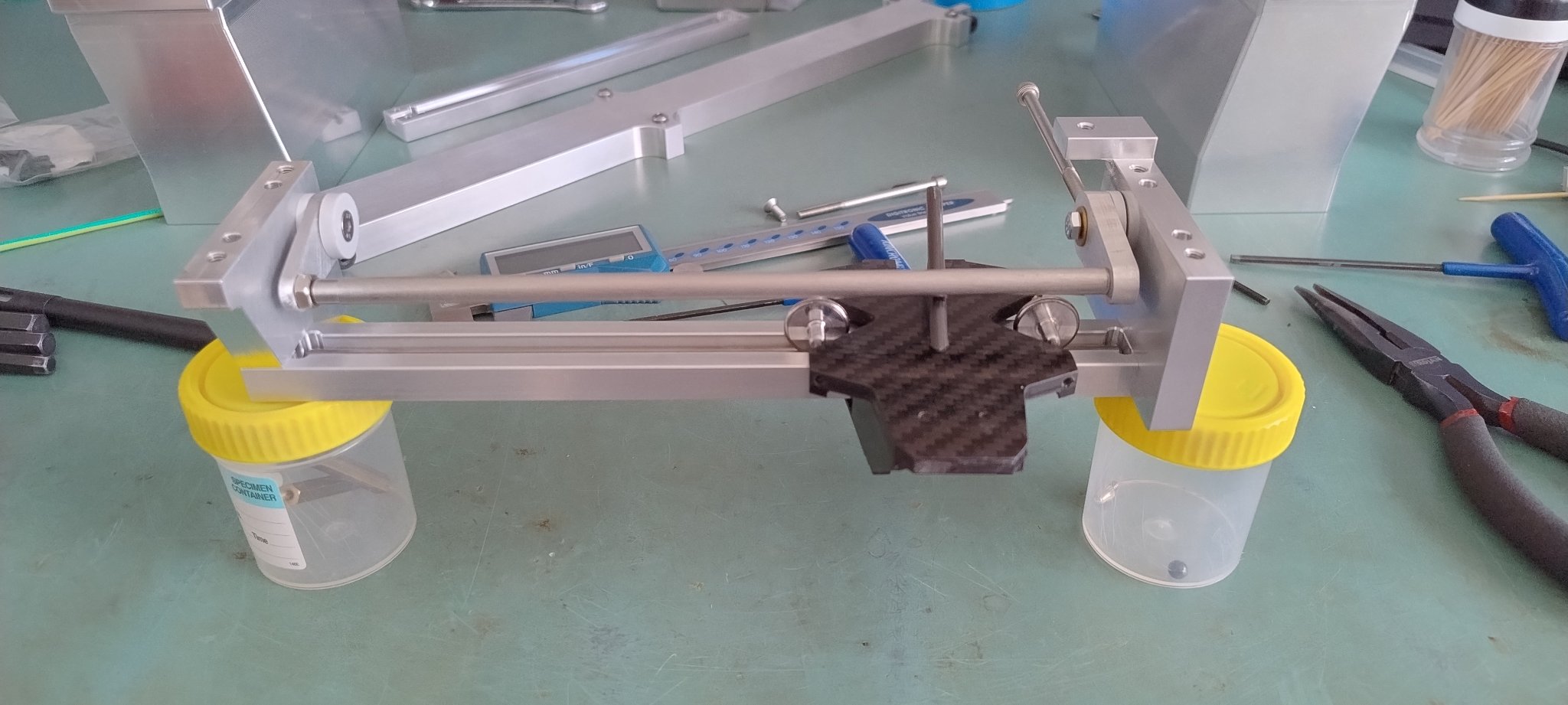

Hi Mark,
I agree that Beryllium would be the dream material for tonearm construction.
It has low density and high modulus which will facilitate the building of a carriage with extremely high bending mode frequencies. It also has the highest speed of sound of any material (at normal, non-exotic pressures). As you say, it's a pity that it is so toxic, up there with plutonium.
The closest material for a high rigidity to density ratio is ultra-high modulus carbon fibre. Especially that with nanotubes in the mix.
I did want to build my carriage with UHM carbon fibre but I couldn't find a non-industrial source.
I reckon I could have made my carriage with a first bending mode of around 28khz. Using standard modulus carbon fibre I still managed 20khz.

Hi gents, thanks for the interesting discussion about the sapphire veneer. @niffy this might wet your appetite with regards to the CNTs https://www.ossila.com/collections/carbon-nanotubes
