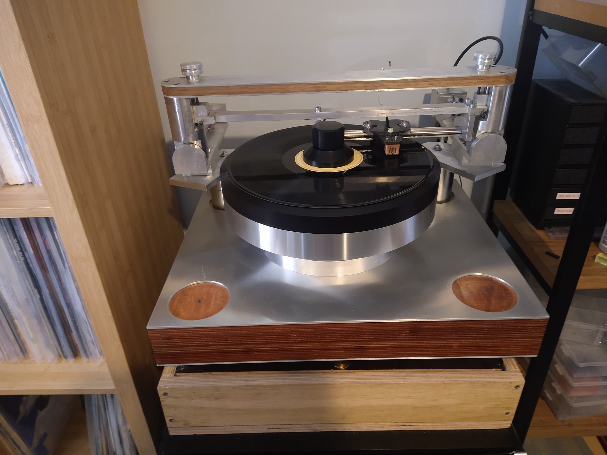

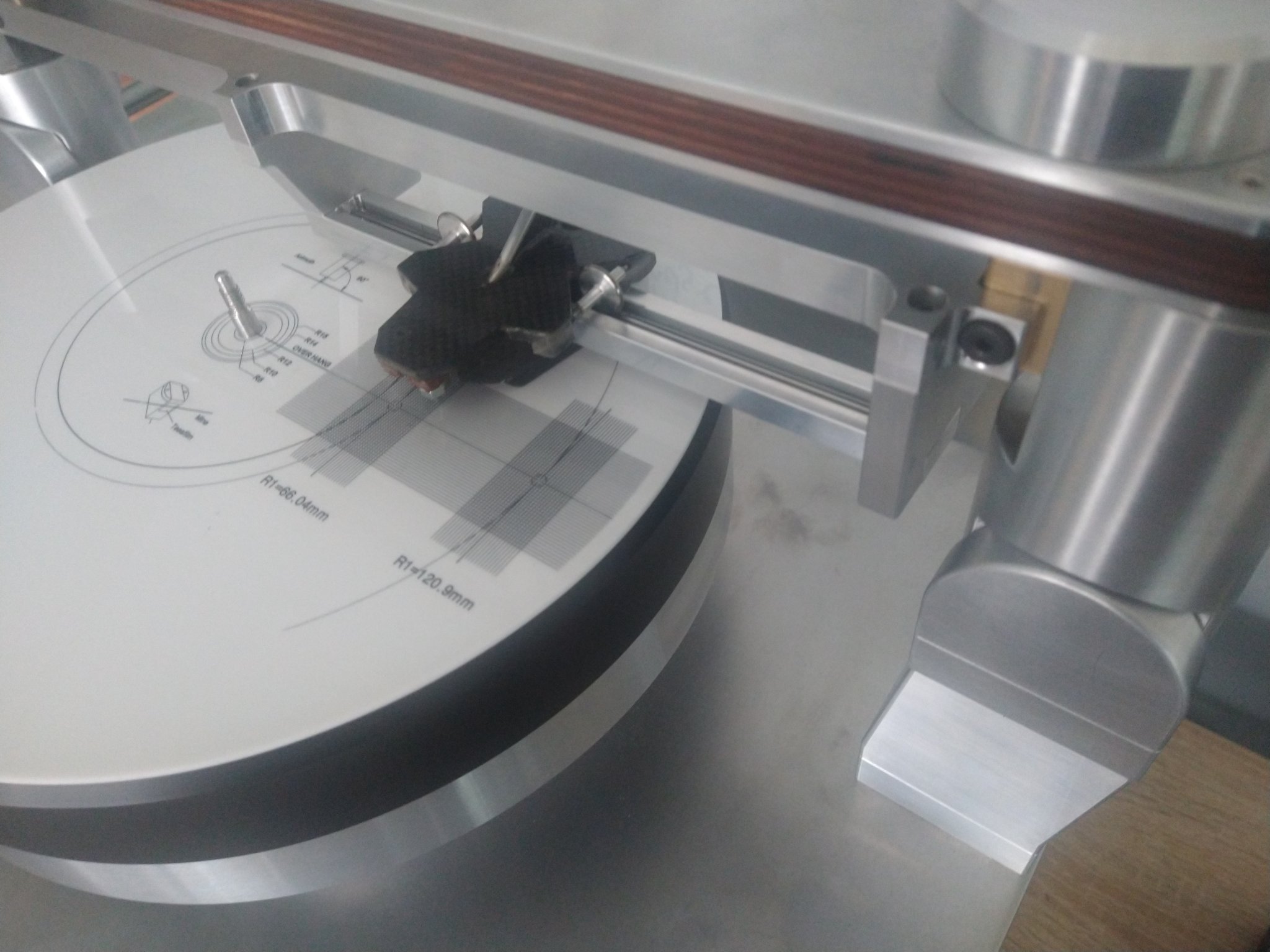

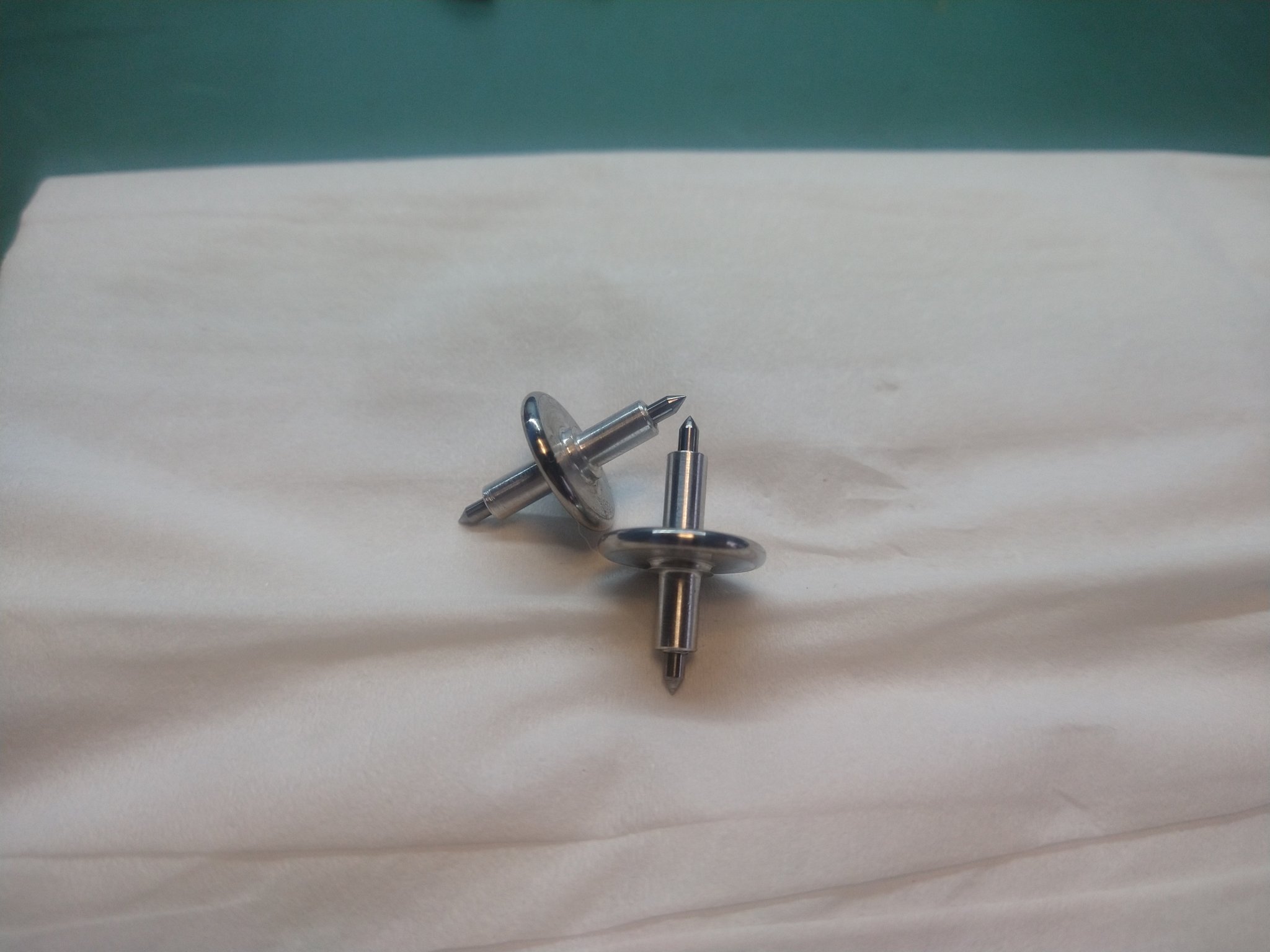

It lives. Still have to sort out the arm wiring which is temporarily taped to the back of bridge with blue painter tape. First impressions are a big improvement in clarity which I suspect is mostly attributable to the wheels being more concentric than the carbide rings. The carriage now rolls much smoother with no falling to a single position which is good since the wheels alone cost over $600/pair to build. This is still using the old carriage, there is a new CNC version happening and I'll post pic of that when it's done.

Kuzma make a pivoting tonearm wand from sapphire. @niffy carriage design the first bending mode is at the top of the audio band where there is little energy. I suspect adding sapphire to this carriage might not gain anything except lowing COG. Even with my new wheels which were less than 1/2 the mass of the carbide and 2mm smaller in OD COG was still above the vertical pivot. I have added a 2g washer to the bottom of the carriage as a temporary fix until the new CNC carriage is finished.

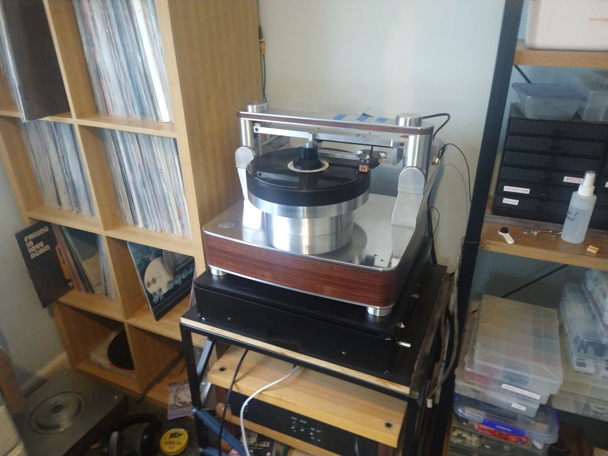

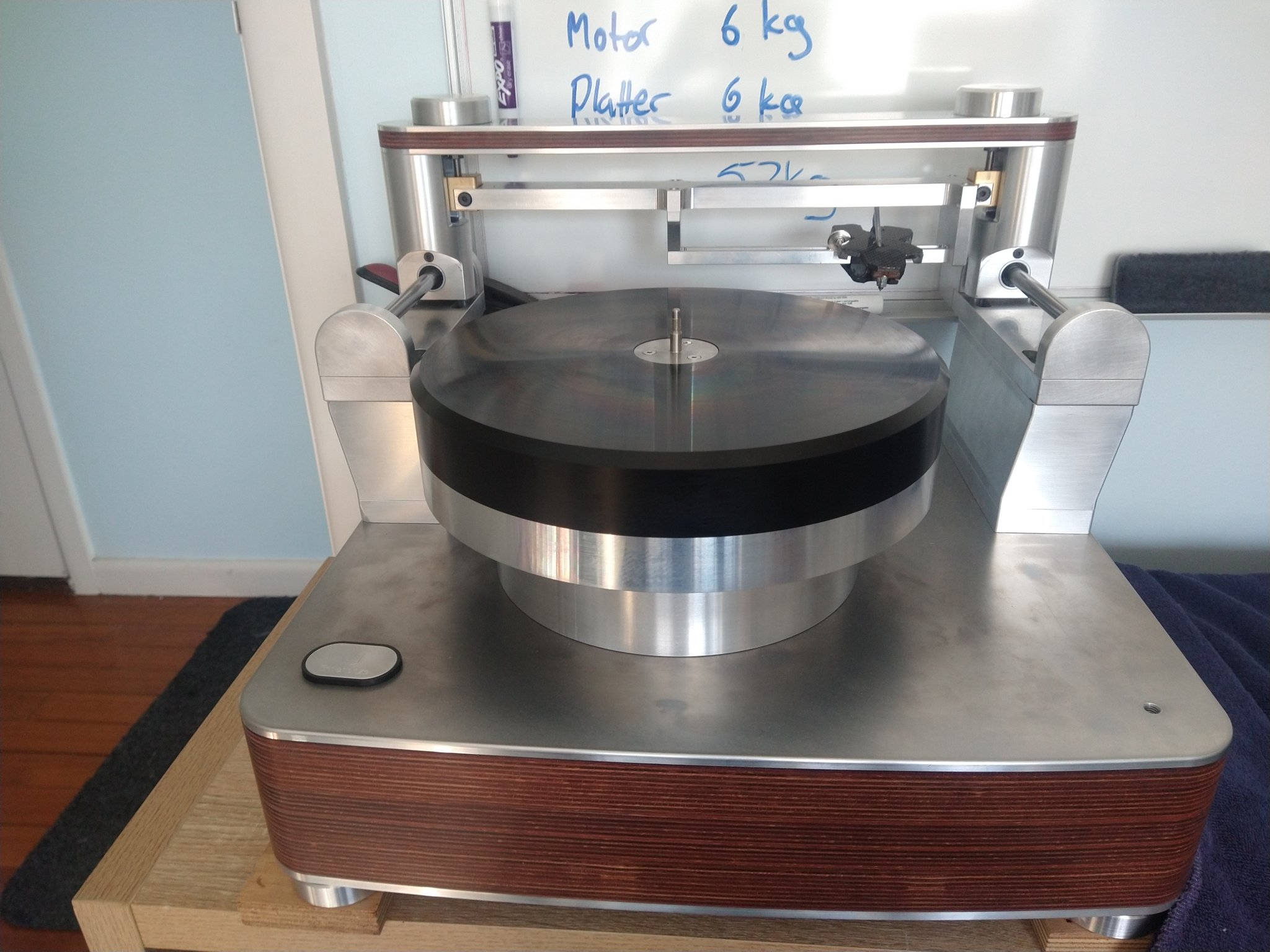

@Sether this LTA is so good I have doubts I'll ever build anything else for my own use. This TT/LTA resolve so much detail from the groove I was astounded at the improvement from my previous version. One thing of note is I had to turn the volume up 3dB on the preamp which would indicate that this new setup has reduced resonance in the midrange.
The updates to the LTA over the previous version are, larger bridge with Permalli sandwich, the cross bar that the rail hangs from is stiffer and also has stiffer mount to the height adjustment, blocks, better wheels and a more rigid mount to the plinth. There is an updated cross bar on its way with Permalli inserts to hopefully reduce ringing. Pics of the old and new TT. All the updates have been to increase rigidity.
