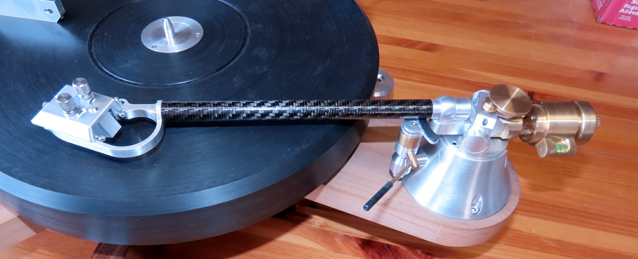

Hello Andrey,
Welcome to the exciting world of tonearms. This thread is about linear tracking tonearms, where the arm is tangentional to the groove at each point of stylus travel, and the pivot follows the stylus movement.
The other thread is about pivoted tangentional tonearms, where the arm is similar to the conventional pivoted arms, completed with a clever trasmission that makes the arm tangentional to the groove at each point of stylus travel.
It is difficult (for me) to decide from your photos, which category your arm belongs to.

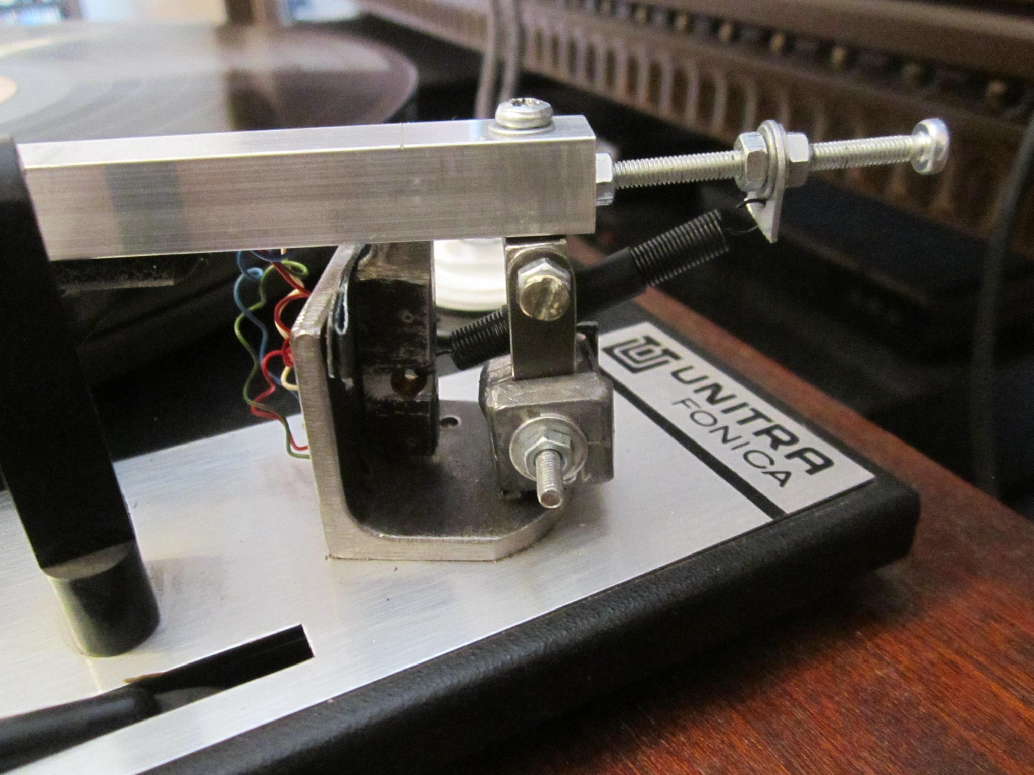

Я думаю, что тонарм Андрея - это прямой тонарм с так называемым нижним навесом.
Hello, Ralph.
I read about your wonderful tonearm in another thread.
I am very impressed by your ingenuity and talent for creating such amazing mechanisms.
Allow me, across seas and oceans, to shake your hand.

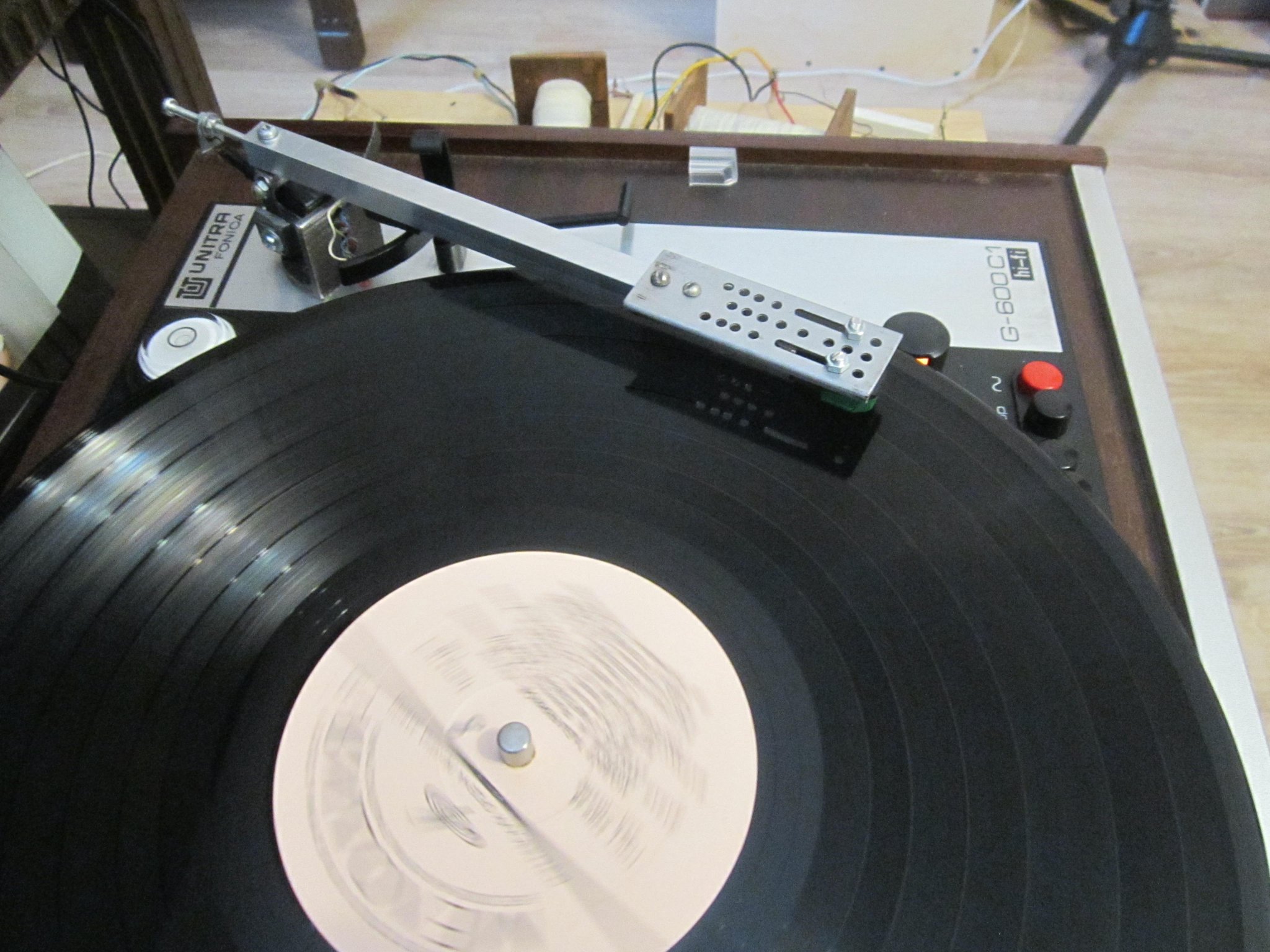

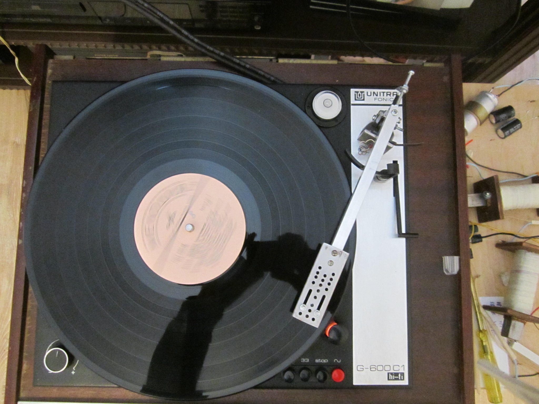

Unfortunately, in your assumption you made a small mistake.
Yes, this is a straight and short tonearm, in which the needle does not reach the spindle.
It opened my eyes to the sound of records at a point with zero skating force and full-fledged sound from both channels.

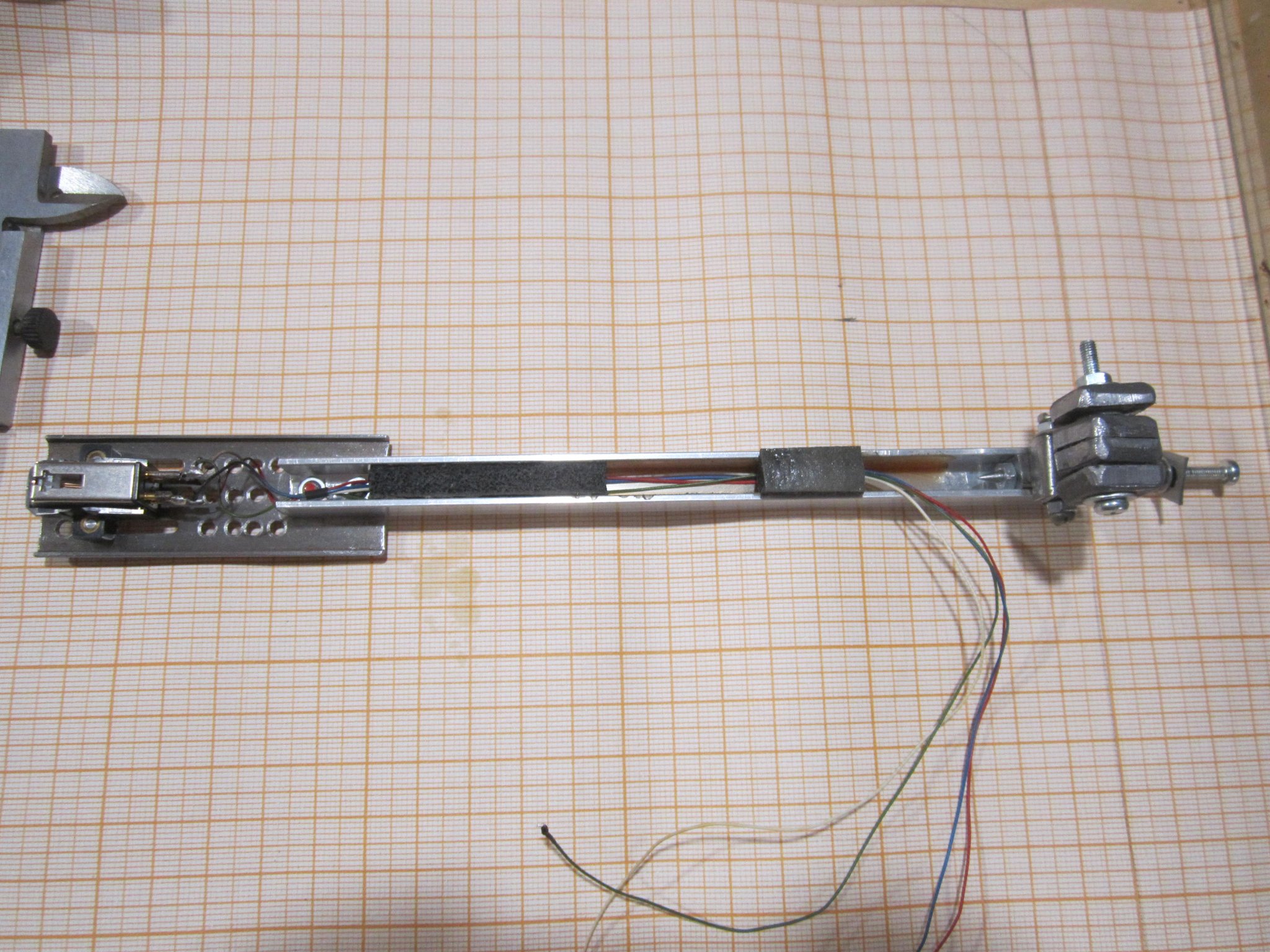

My tonearm has a horizontal support in the arm itself, that is, from above, I show the photo.
With deep respect to you
AG.

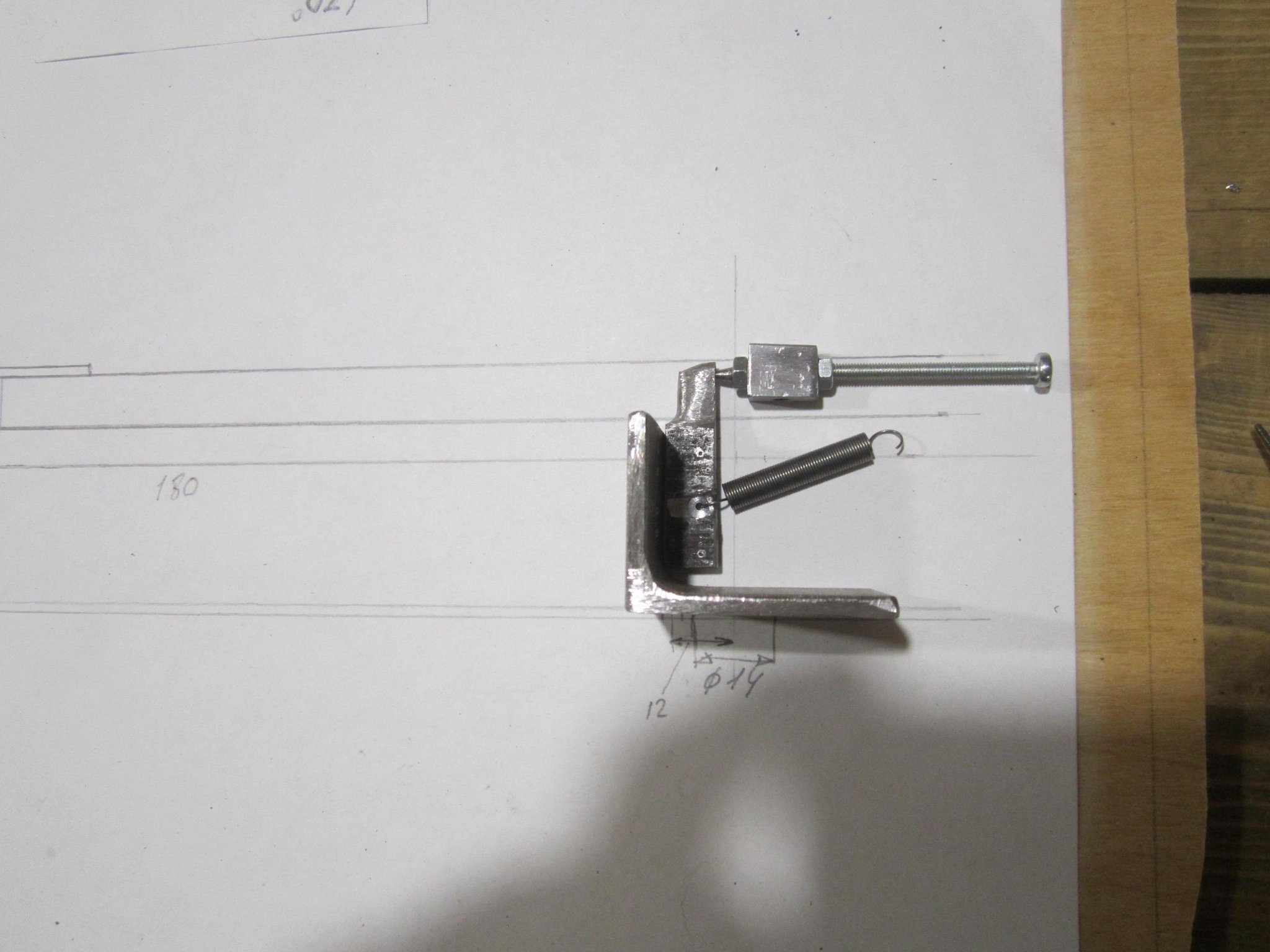

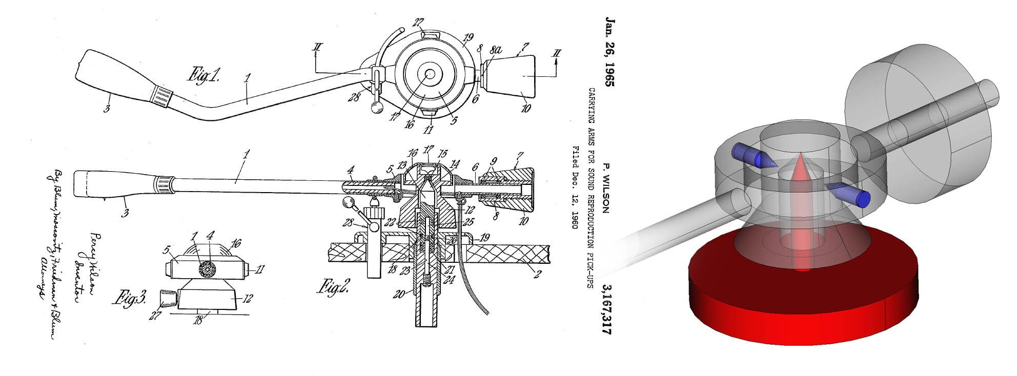

Ciao Andrej, like Ralph I also fell into the same "small mistake"; in the first photos that arm seemed too naive to be true.
Now, with these new details, looks as a really interesting approach, instead.
Do you know the Percy Wilson work? long time before us he had worked on the same problems, which unfortunately remain still open.

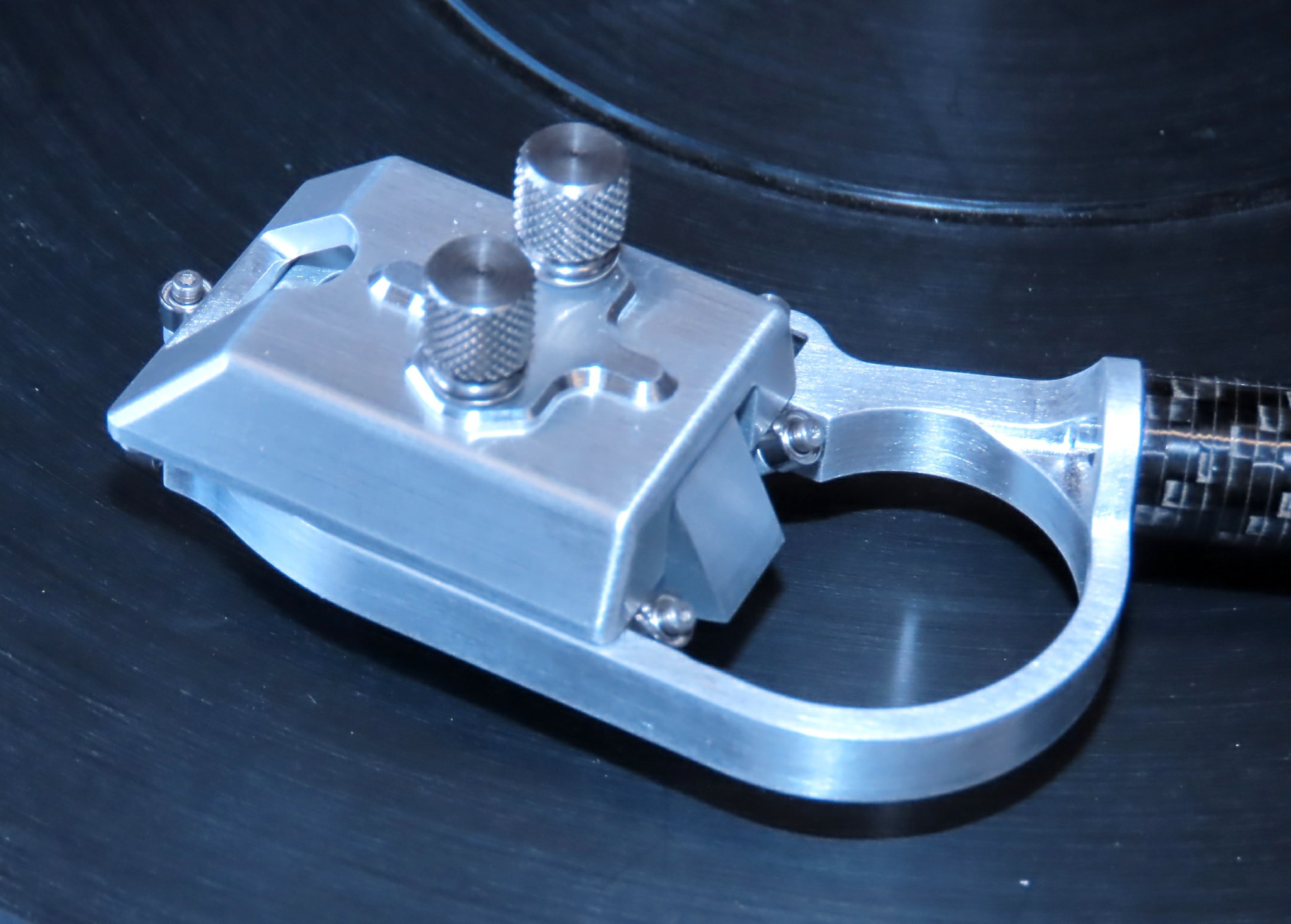

Hi Andrey, I've read your posts and, trying to make many types of arms with different solutions to the problems found, I came at conclusions quite similar to yours.
For example, to reduce the side force in linears I eliminated the negative lever of the wand (the "radial rail" - the LIl Casey + Corkscrew RTAs). The failed PTTA Syrinx instead was really useful to understand the real forces in play, then measured directly with a pendulun device.
I confess that the "0 offset pivoted" leave me instead very perplexed since they seem to me to be the translation of the famous saying "the most precise clock is the the broken one, because it shows the exact time twice a day" This happens to those TAs at their null-point, but elsewhere the TE...
Percy Wilson was already trying in the 70s to have a direct "automatic" braking of the stylus drag and consequent skating. (here is his arm with a sketch of mine to highlight how it works + his patent). The articulation* of yours, from what I understand from the photo, seems promising for this, that's why I talked about it.

I do not deal with the tonearm shown in the photo.
I took it apart a long time ago.
