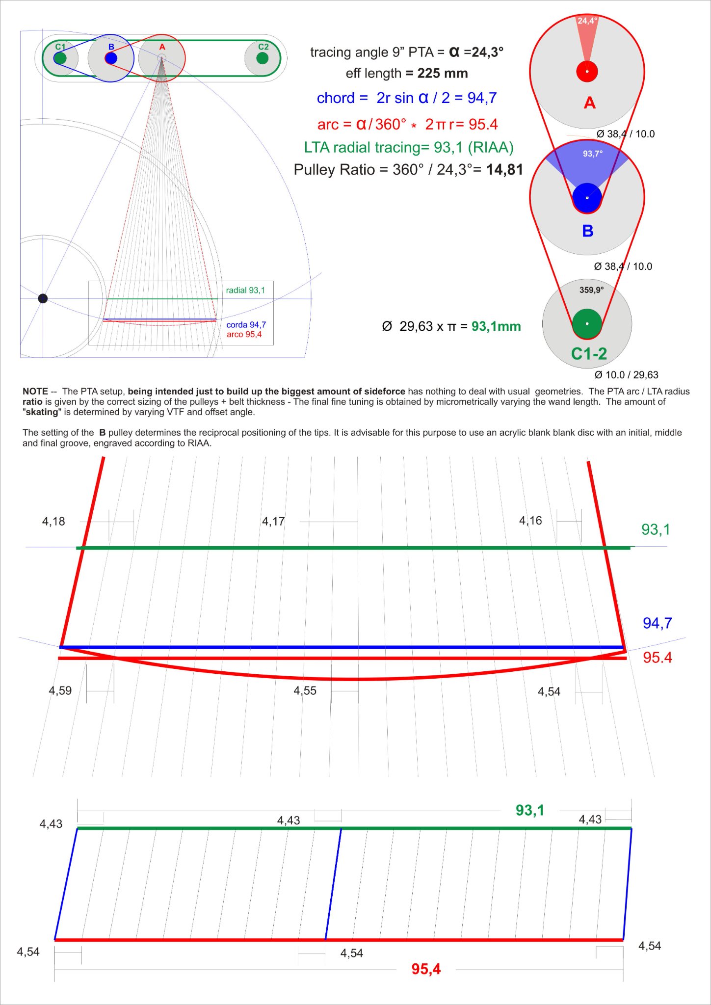

Another step of my box kicker method - some more due infos.

Paul, whilst you're gathering thoughts i would like to introduce you to 4 other areas you might consider (or discard!!)
Wiring, leverage, levelling and vertical orientation.

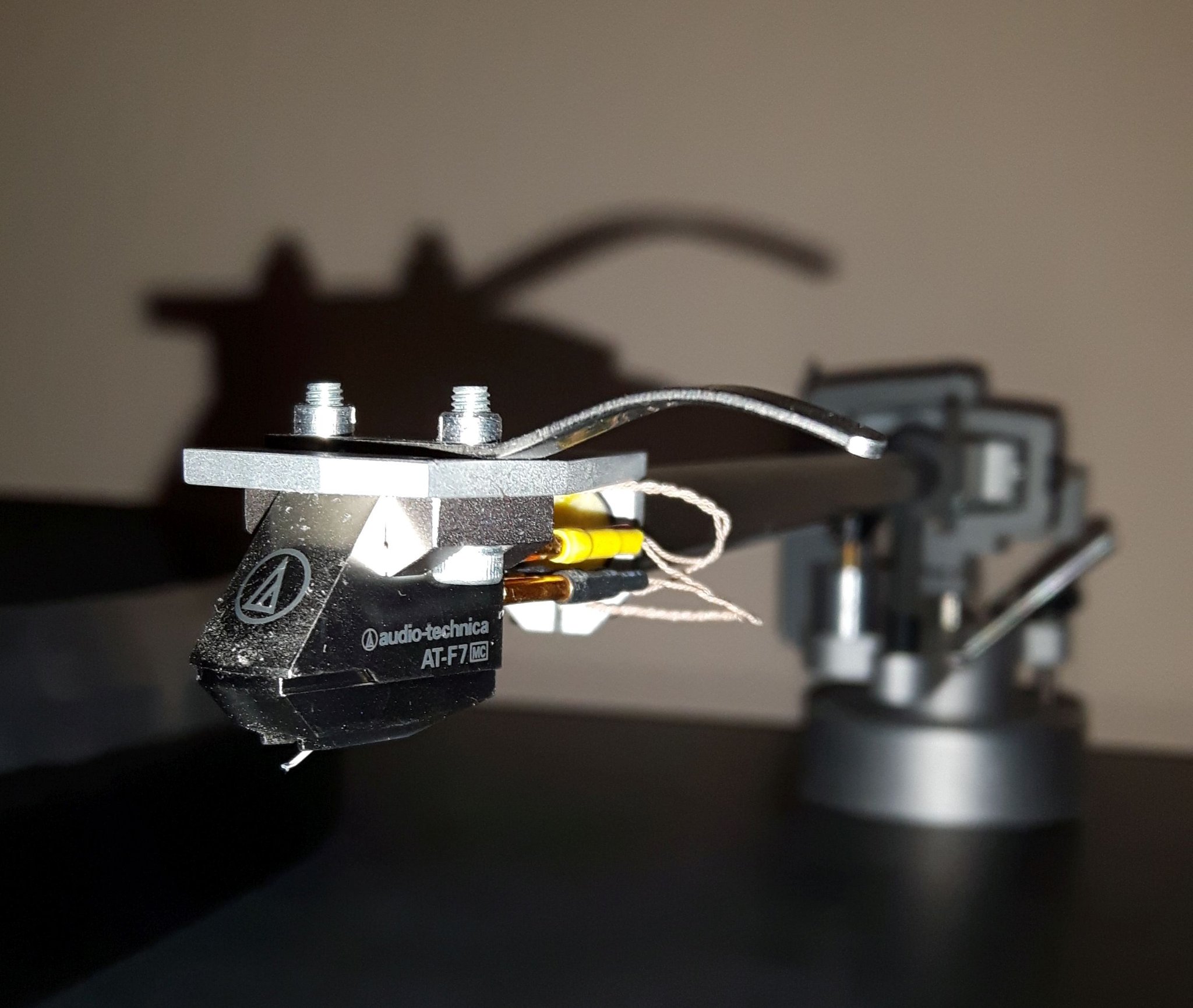

1. Wiring is probably an easy one, many folk, including me start out with something available and rapidly find springy wiring is a significant failure.
I followed Niffy's advice and use two spiralled cores per pole all wrapped in a sleeve of three cores of screen, so 11 cores in total of fine enameled magnet wire, you may have found the references already. With this there is no perceptible effect from the wiring.
2. The much used wand and carriage asks the stylus side force to move the carriage on a long lever, like pushing a car to and fro with a pole out the side, rather than pushing it on axis, Radial arms where the carriage is above the stylus remove this lever.
3. Levelling your arm will be critical, way more critical than any bubble will show you, and so also stability of your TT/carriage base set up in level will be important. so, locking the arm in vertical orientation (balanced level, stylus off the record) you can adjust for level travel.
4. On a wand the cartridge will change its vertical orientation to the record constantly with factors such as record thickness and warp. Carlo resolved this with several of his RTA's with a solution for leverage at the same time. In my opinion these are well worth a study.

And 5291 gives a picture. To give a feel of the flexibility, this is about 175mm long in my set up and moving the connector end from one side of a record width to the other will not "pull" the carriage, despite the low friction. There is enough form in the group to retain the spiral shown. There is no perceivable hum now with shielding as described.
A satisfactory solution for a few cents of wire and some simple work.
