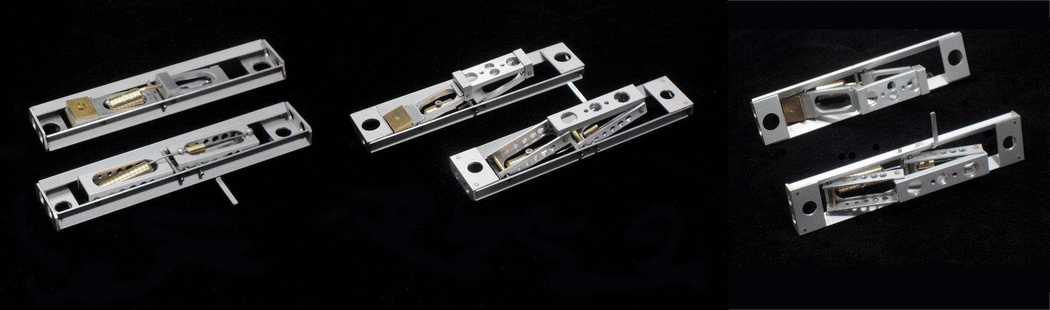

Here, for those interested (Mike?), the photo of the two carts of the CorkScrew mk2.
As you can not see, the differences A vs B cart are minimal for us humans but not for the cantilever behavior, fortunately.
From outside this CorkScrew mk2 is practically identical to mk1, so I refer you to # 4219 for the photo.
thanks - carlo
