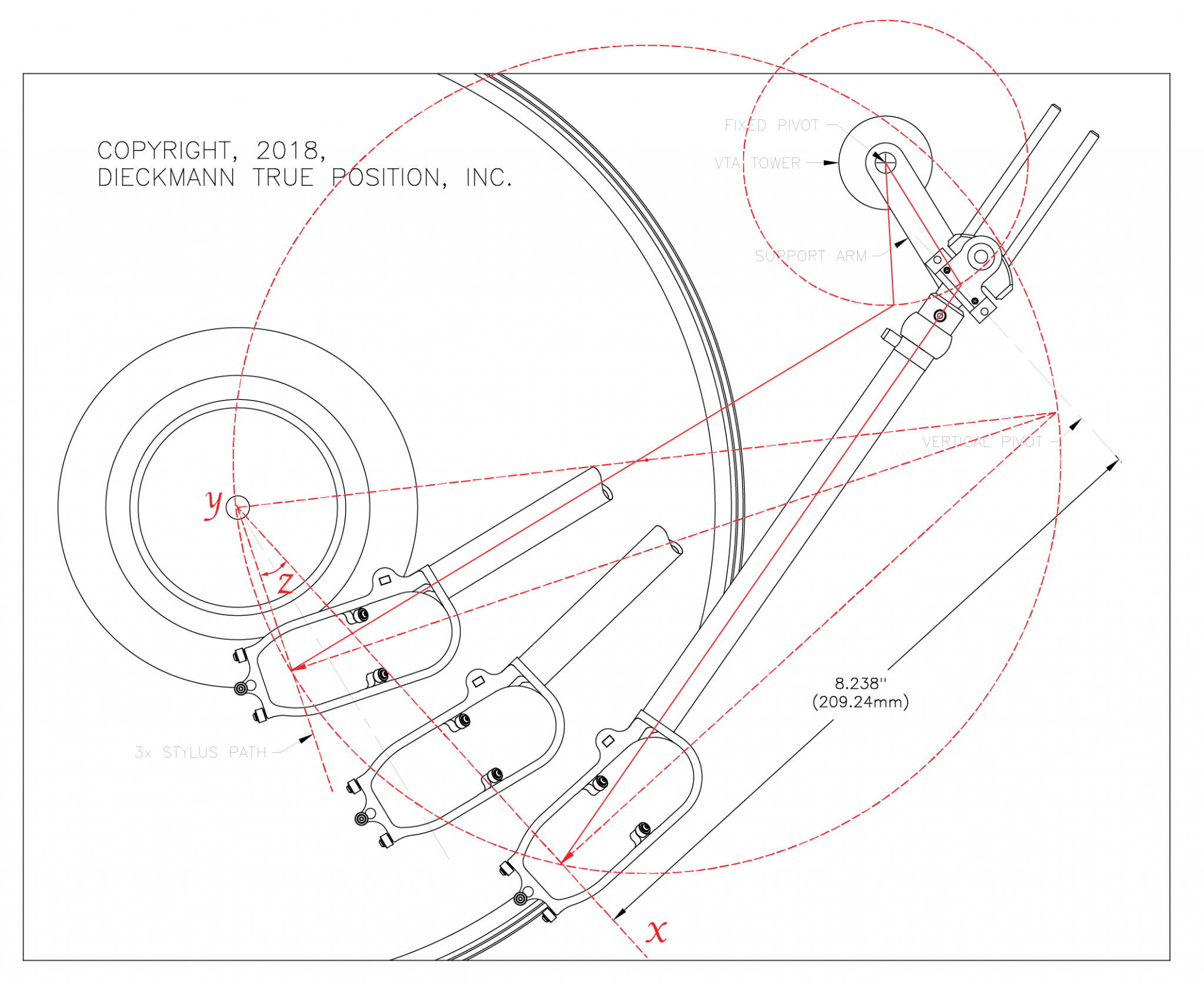

Ralf's arm is a variant of Birch-style arms with an offset angle. It has tracking errors, too. In fact, I would say the tracking errors are not minimized from his drawing. Does the offset angle help to reduce tracking errors? I am not sure at this moment.
My other concern is the efficiency of the small linear bearing. I still don't see the need for a small linear rail unless the servo doesn't allow to move backward if the eccentricity does exist.

Does it matter? No. As I said before, a Birch-style arm needs at least two linkages. Ralf's arm has only one linkage. Its constraint is built in the servo. Let's forget the rail for a moment. So, the servo which acts as a constraint( or 2nd linkage) is correcting the angle. Correcting angle can adjust the position of the headshell, too. I simply don't see it matters.

My tone arm's tangential position is solely controlled by a set of two cams and their cam followers. They are not shown in the drawing posted by super10018. The geometry is perfect and there is no tracking error! The oblong component at the end of the tone arm, I call the cradle. It supports five miniature ball bearings to support the "floating" head-shell for straight-line motion to keep the cartridge's cantilever tangent to a concentric circle of random diameter within the limits of the beginning and the end of the modulated groove of an LP record. The offset cradle/head-shell deliberately introduces the "inward force" so that the tone arm becomes "self propelled" across the surface of the LP. Because the tone arm and the head-shell move independently of each other, some means of preventing a collision between the tone arm and the head-shell had to be devised. That is the purpose of the "servo". It simply controls the "inward force". You might call it electronic anti skating!
There is another reason for off-setting the cradle/head-shell of my tone arm: All pivoting tangentially tracking tone arms require that their pivots be moved by a certain distance. Off-setting the cradle/head-shell reduces that distance by ~50% as opposed to a non off-sett cradle/head-shell.

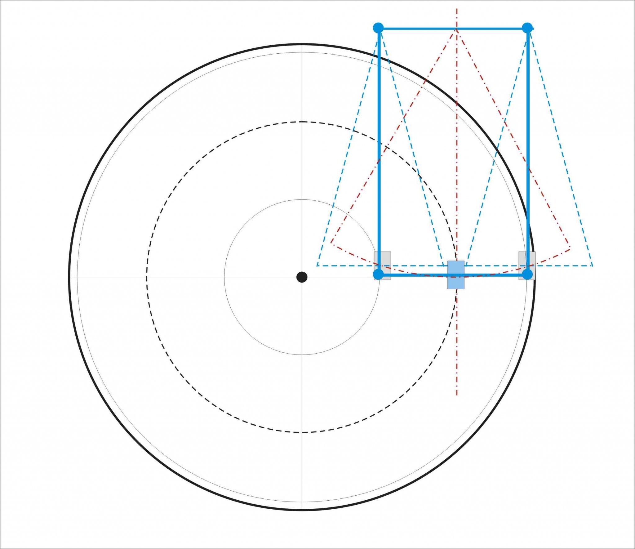

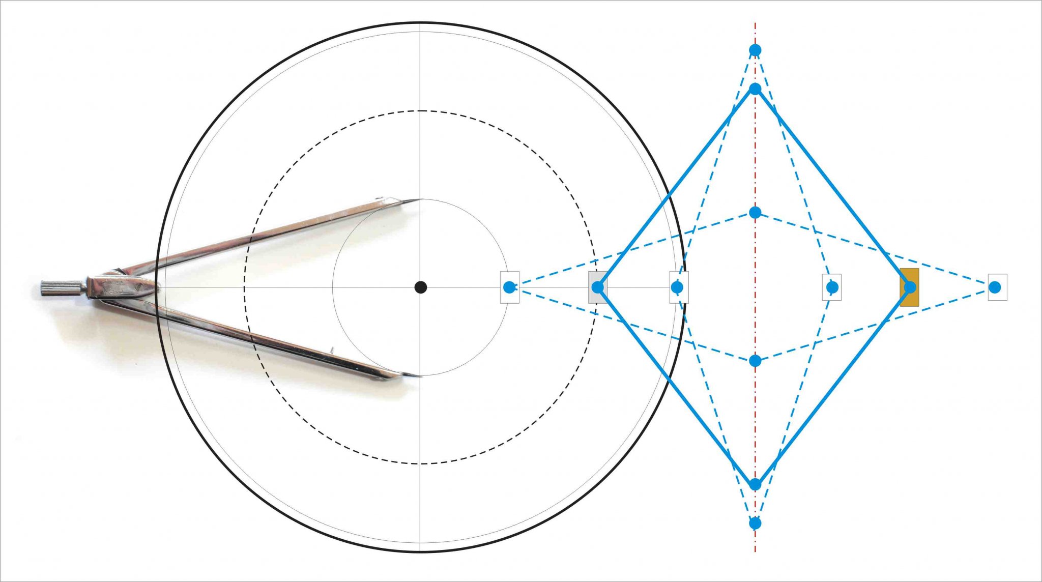

The red dotted line in #4,611 must be a linear bearing.
No there is no need: i.e. the photo of my Kern compass is there because, like many others, uses just a cam to maintain the alignment.
My sketch is clearly a provocation, not a solution, with all those pivots it would surely have serious problems to work.
Since many are looking for clever geometries for PLTs, why not also for our linear ones?
carlo
Sorry. Seems that sometimes my sketches are even less understandable than my English. I hope this mockup is clearer (even if the mechanism is much less sophisticated than the KERN compass). But what's important is to understand each other
I think the old Garrard (and clones) worked more like the parallelogram shown at #4614.
