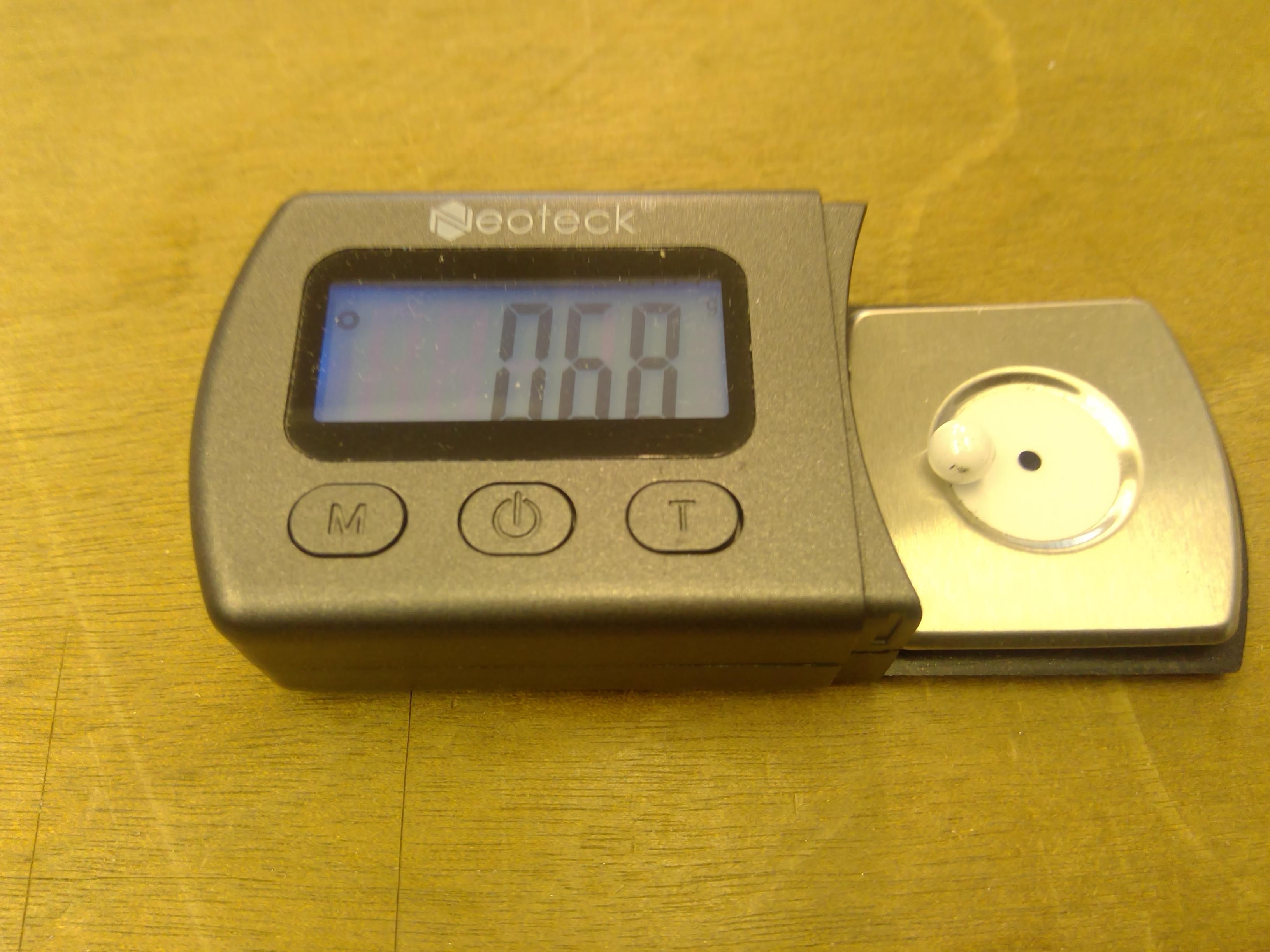

Evening all, echo Niffy on the pushbike analogy, i started with 5mm becasue i picked it up as an idea somewhere and found the 6mm to measure slightly better. my measurements also varied a lot at that time, i expect because the surfaces were inconsistent.
So i weighed a 5mm and a 6mm ceramic ball, which i use on a 3 or 4 ball carriage and found 0.28 gm difference, so a toatl of around a gram...........

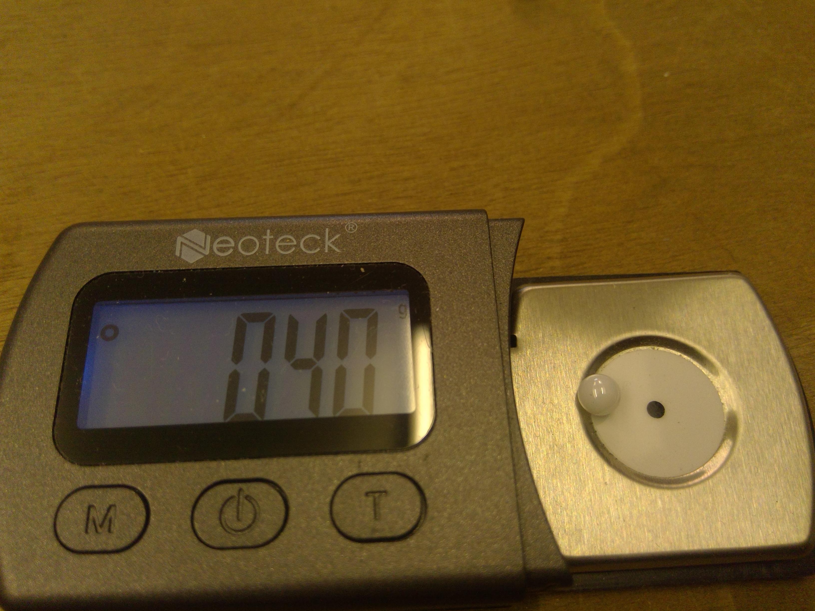

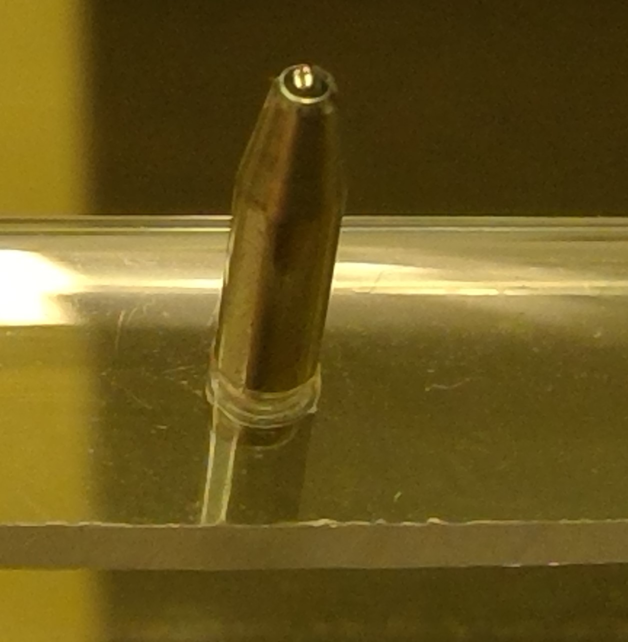

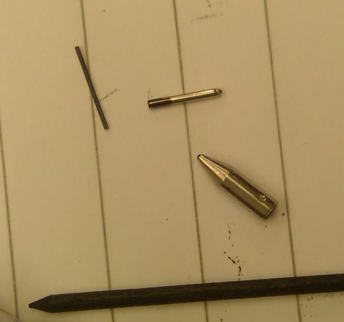

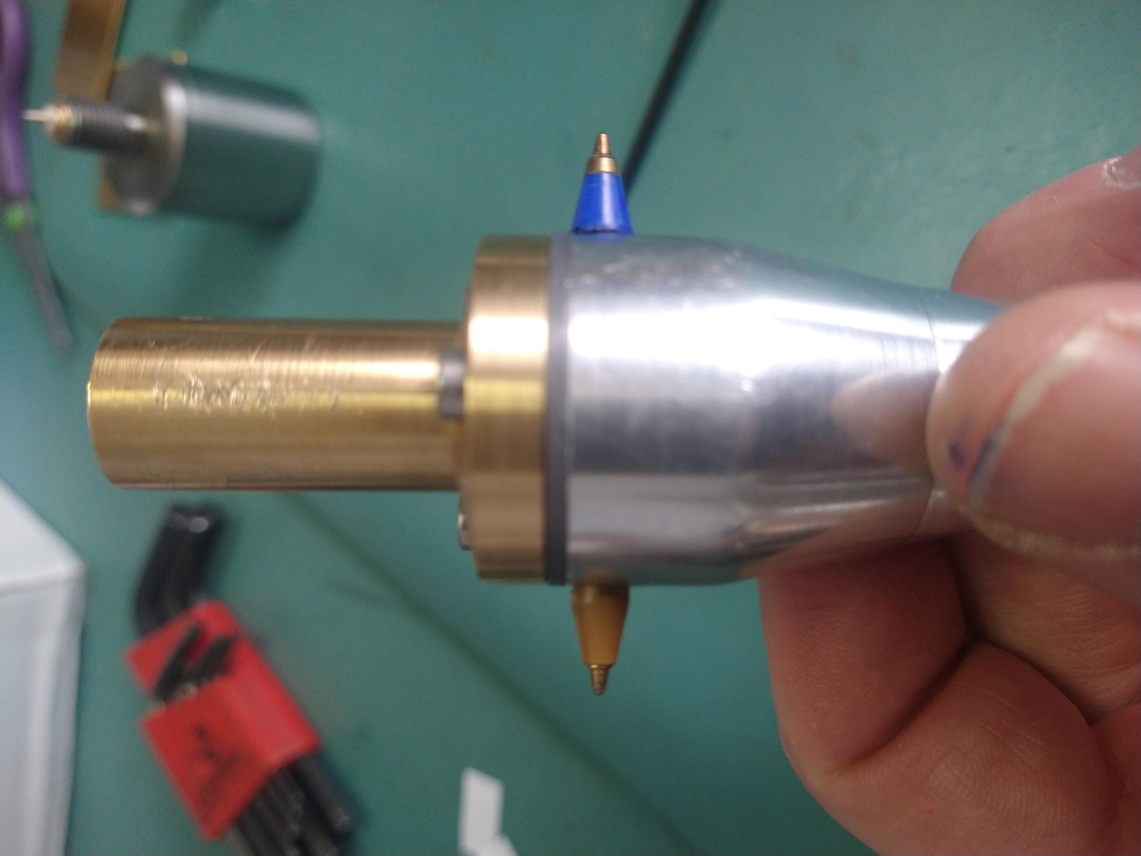

I know this is a pivoting arm but I was asked to post it as the method can easily be applied to the carriage of an LTA.
Background, I am building a 4 point pivoting arm that I bought 4x sapphire Vee's and carbide pivots. An unfortunate mishap damaged one of the carbide pivots so Carlo suggested I try Bic ball point pens. I was not expecting the Bic pivots to outperform the sapphire/carbide but they did.
I measured sensitive of the TA with the sapphire pivots which was just under 20mg to commence the arm moving. Bugger me the Bic pivots moved with 8mg.
The Bic pivots used regular Bic classic fine pen points in M5 setscrews. The setscrews had nothing done to them no polishing. The ball rotates in the pen seat.

Very interesting result Warren, and not a small margin either, less than half.

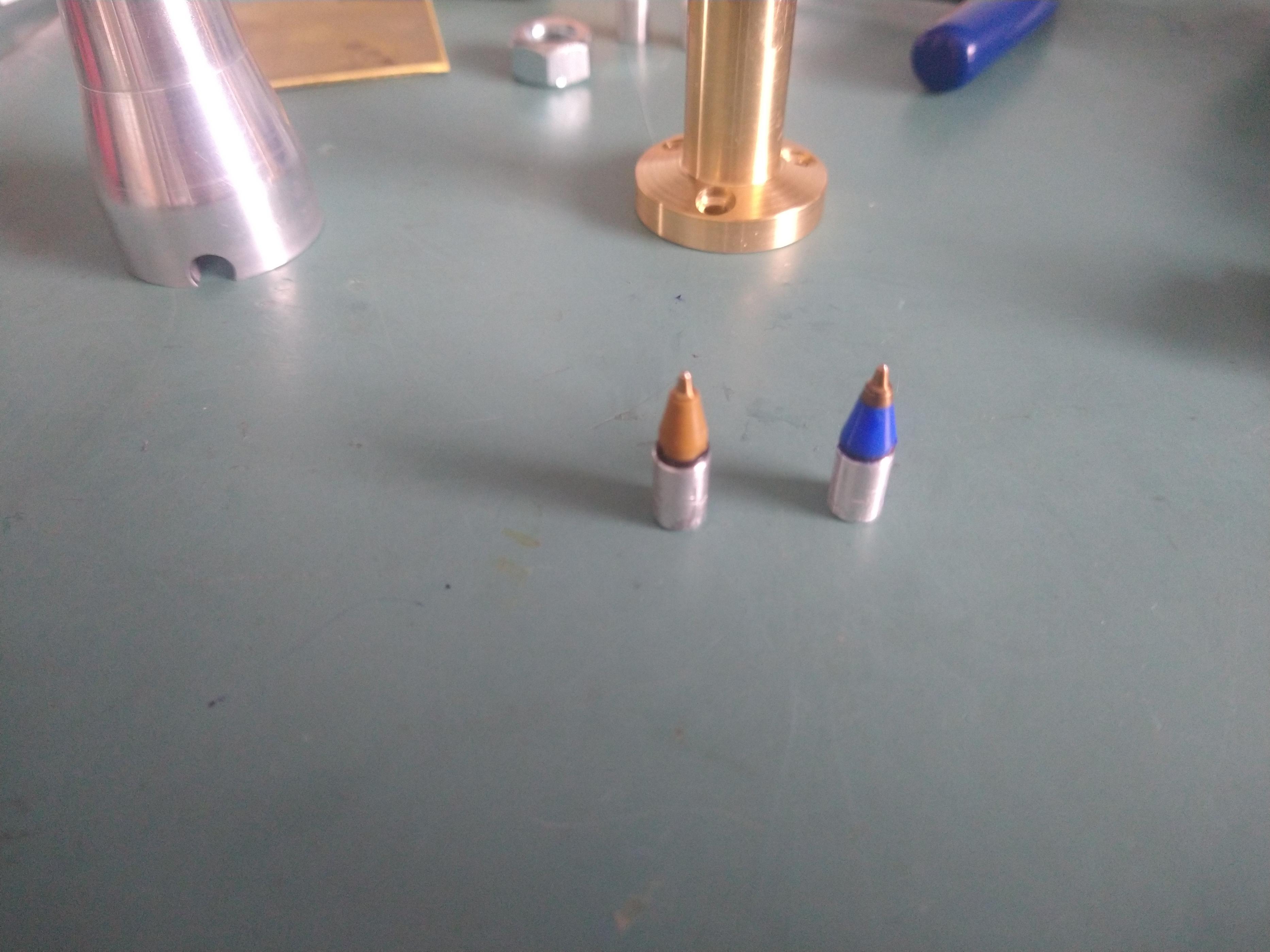

As you know, i use pen tip pivots in my LTA for the paralelogram. They would lead to inconsistent VTF readings if they had much friction and when well set they don't, they are a low friction zero play pivot and beat all the other types that i tried.
Mine have been gel ink ones and i shall now try the Bic type as the ink is a better and longer lasting lubricant.

Ever the cheapskate i used these, £10 for 20 and i bought large and small to experiment, only used the larger so far, only problem is these use thinner inks and a wick. the large ones need filing to go inside a 2mm ID tube

Hi Warren,
Interesting results, good to hear that you have managed to reduce the friction of your bearings.
May I ask a couple of questions?
What were the tip and cup radius of the tungsten carbide pivots and vees?
What is the effective length of your arm, how far from the pivot did you apply the force to obtain these results?
With my arm I obtained a starting force of under 10mg using the jewel bearings. In my case the force is applied about 8mm from the bearing pivot as I am using wheels that are about 16mm in diameter. The majority of this force is due to rolling resistance of the wheels on the rail, the force required to rotate the pivot alone is probably in the region of 3mg. If using a long pivoted arm with the force applied at the stylus the required force should be substantially less than this.
The starting TORQUE at the bearing for a pivoted arm will tend to be greater than for my arm as the total supported mass will be higher. The starting FORCE applied at the stylus for a pivoted arm should still be much lower due to the armtube acting as a long lever.

I used rollerball tips which i believe used a water based ink, whereas others using oil based inks from ball point pens have successfully retained the ink as lubricant.
Using these could improve my results so i look forward to further info here, thanks, M
