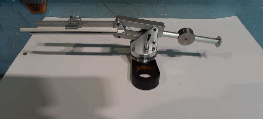

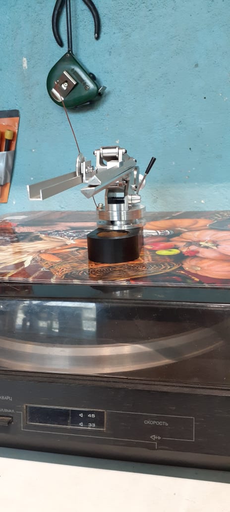

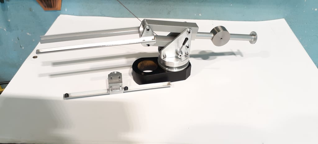

DIY linear tonearm
After numerous variations, the easiest to make and the best sounding variation, two balls on the front rail and a roller on the rear rail.
Hi Alex, have you tried linking the rails and damping them, Linking can give you more stiffness for little weight and some quite light damping might stop them ringing to good effect (maybe a strip of sticky back felt or so?)

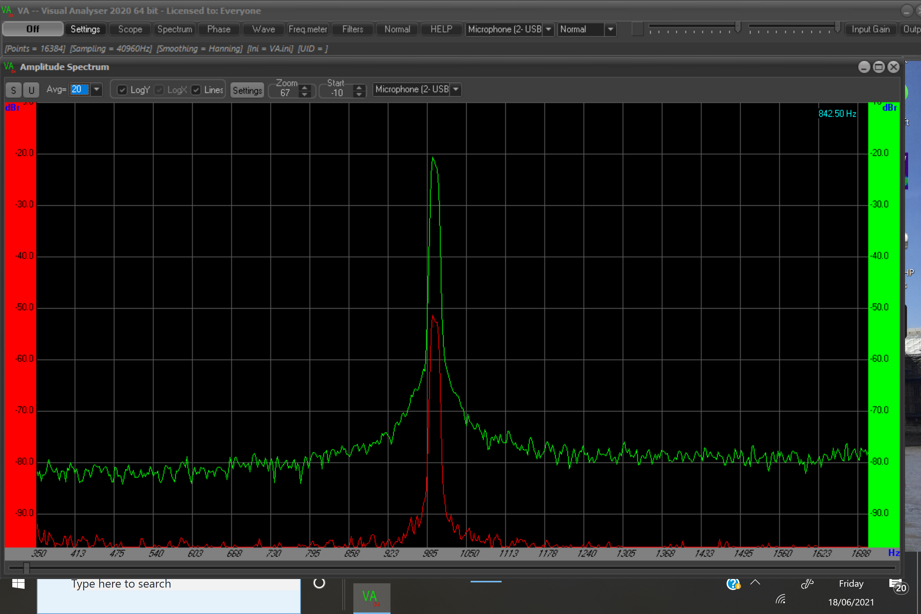

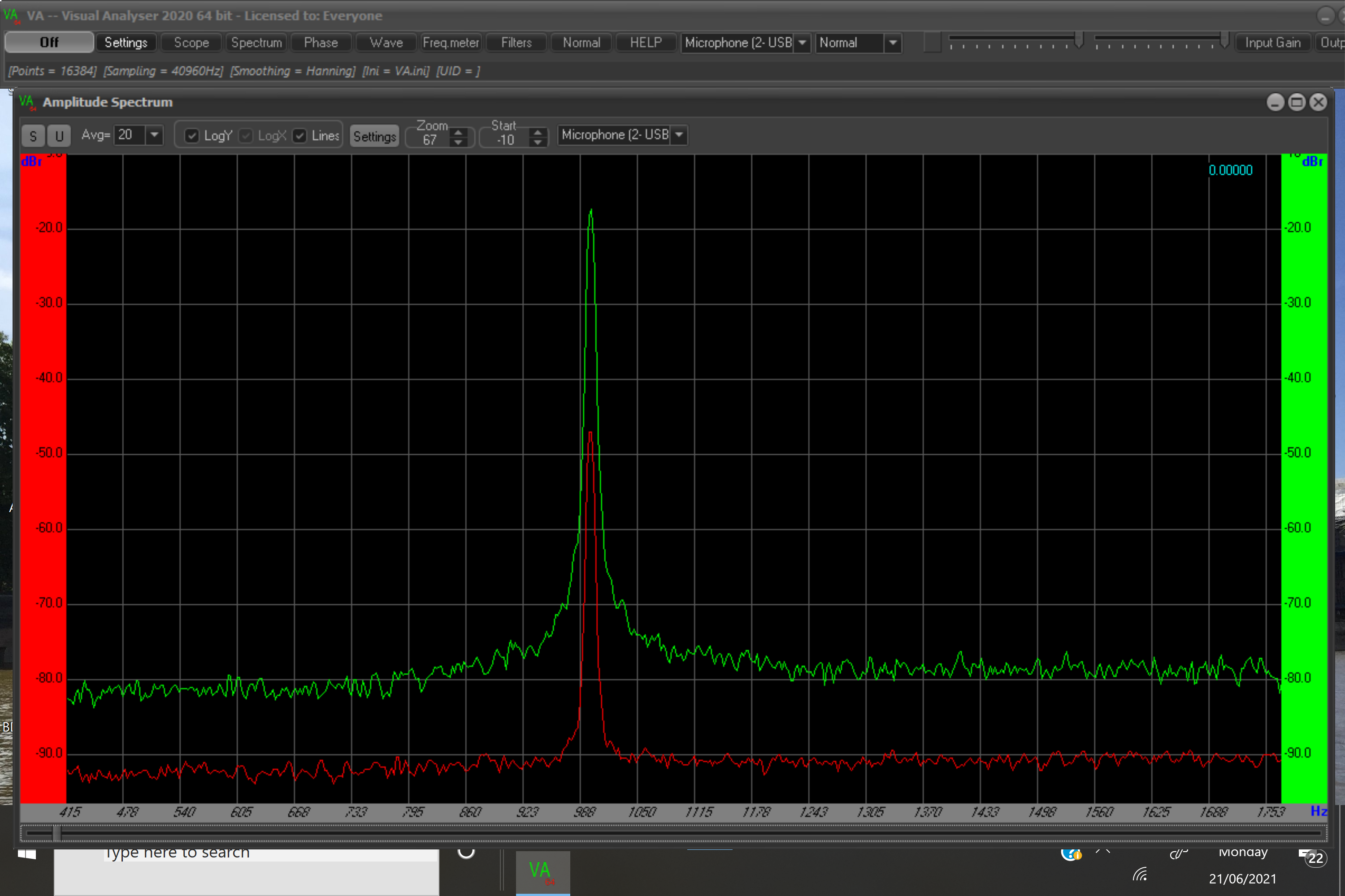

My recently completed Stainless steel tube rails are the lowest resistance i have achieved, better than anodised and more consistent. They wont work for you because your rails are on the mobile part and the weight wont work there (I believe!).
However they give me a nice stiff rail set and the opportunity for simple damping internally. i will try a few different types at some point, but you can see how it tightens in the base of the signal response in the measurements, 638 before, 645 after. the spike is also narrower, can someone more expert than i explain what that is showing please?

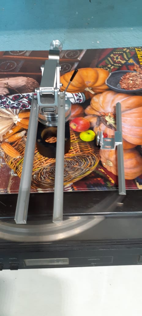

A first prototype arm, rolling on two balls in a V groove...
Very nicely following an excentric record.
Not yet wired and auditioned but just a raw set up to check tracking.
Promising...

Hey, good to see, i think i see steel bearings, have a go with ceramic. when it comes to wiring go straight to Niffys proven solution, happily borrowed by the rest of us, then get listening to a great experience.
Folks on here taught me about listening, measuring and improving and i am sure you will enjoy the same route, what's your background, physics, audio etc, how did you get to here?

The balls roll in anodized aluminium grooves; these are anti slip staircase profiles.
Tubes are carbon fibre.
Nice thing is that the bearing point is positioned much lower than most constructions I see here which should be better for VTA.
Now that it is clear that the principle works well I can focus on materials, base construction, wiring and so on.

He will be thinking cantilever deflection, which results from the force necessary to start and move the carriage is too high. Folk on this thread helped me get to a reasonably low friction set up i now have.
After lots of trial and error I am now using two 8mm stainless steel tubes as runners, flattened/straightened and highly polished as a low cost hard flat runner, ceramic 6mm balls and anodised aluminium carriage. that gives the best, lowest starting resistance, and rolling resistance that i have measured so far. The tubes are glued together and rigid and damped inside which improves the measurements as well.

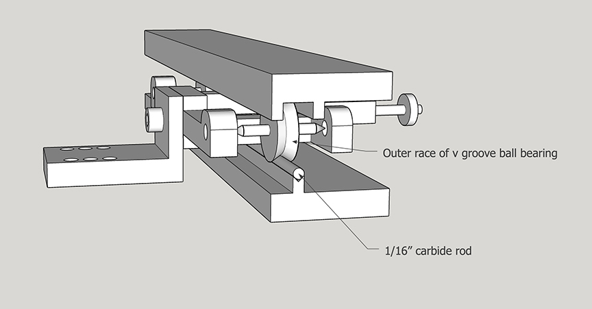

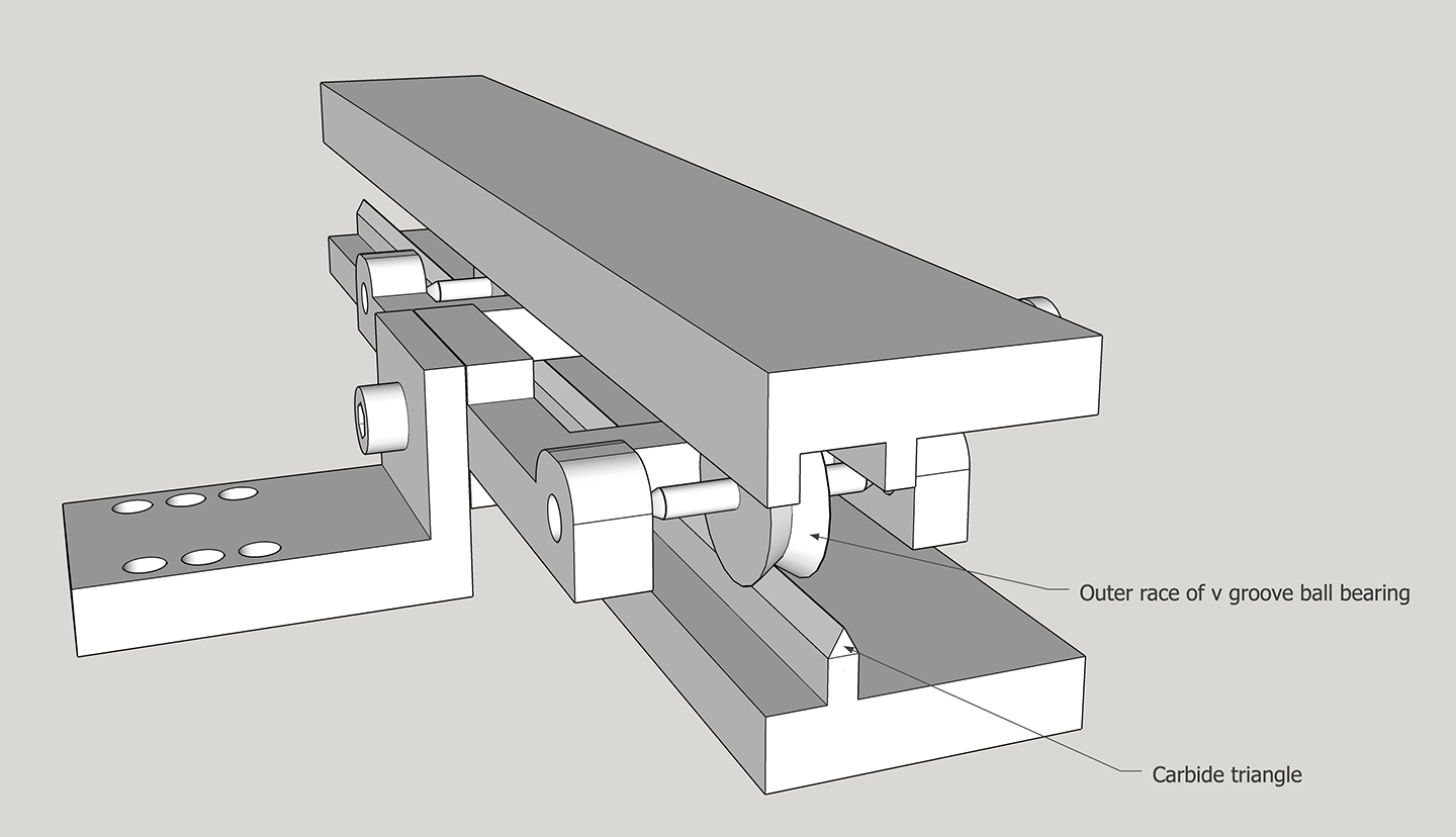

Personally, I think the ball rails have just too high friction and are not easy to control the movements of the balls. Although I highly recommend Niffy's design, I am not satisfied with the rail design. Here is a design idea. I probably will never go back to mechanical linear arms, but I will be glad if my idea may help. The proposal is highly DIYable.
My advice for anyone who wants to build a mechanical linear arm is that sticking to the basic, put all your effect into the rail design. Your first and last goal is to reduce the friction of the rail.

Very nice design, Jim. I particularly like the repurposing of the outer race of a V-groove bearing. It reminds me of a Schroder diy arm that he repurposed the inner race of a ball bearing on an angular track, sort of the opposite or upside-down of yours. I might have to borrow your idea!

Initially, I used a carbide triangle in the design, but I could not find it. A carbide triangle may not be DIY-friendly. If it is a triangle rail, it is even better because it acts like there are two moving pivot bearings. There are only two contact points.
I would like to control its mass around 60 grams and would recommend anyone who wants to build this arm to use jewel bearings. Jewel bearings are not too expensive. However, if anyone doesn't want to pay for jewel bearings, there is an alternative. I found that cup-point set screws may be used as the vee-cup of jewel bearing, too. Hard drywall screws may be used as pivots.
In order to reduce the mass and to make the arm even simpler, the socket screw for adjusting azimuth may be eliminated. In my experience, I almost never adjust azimuth on mechanical linear arms before and air-bearing arms now.
