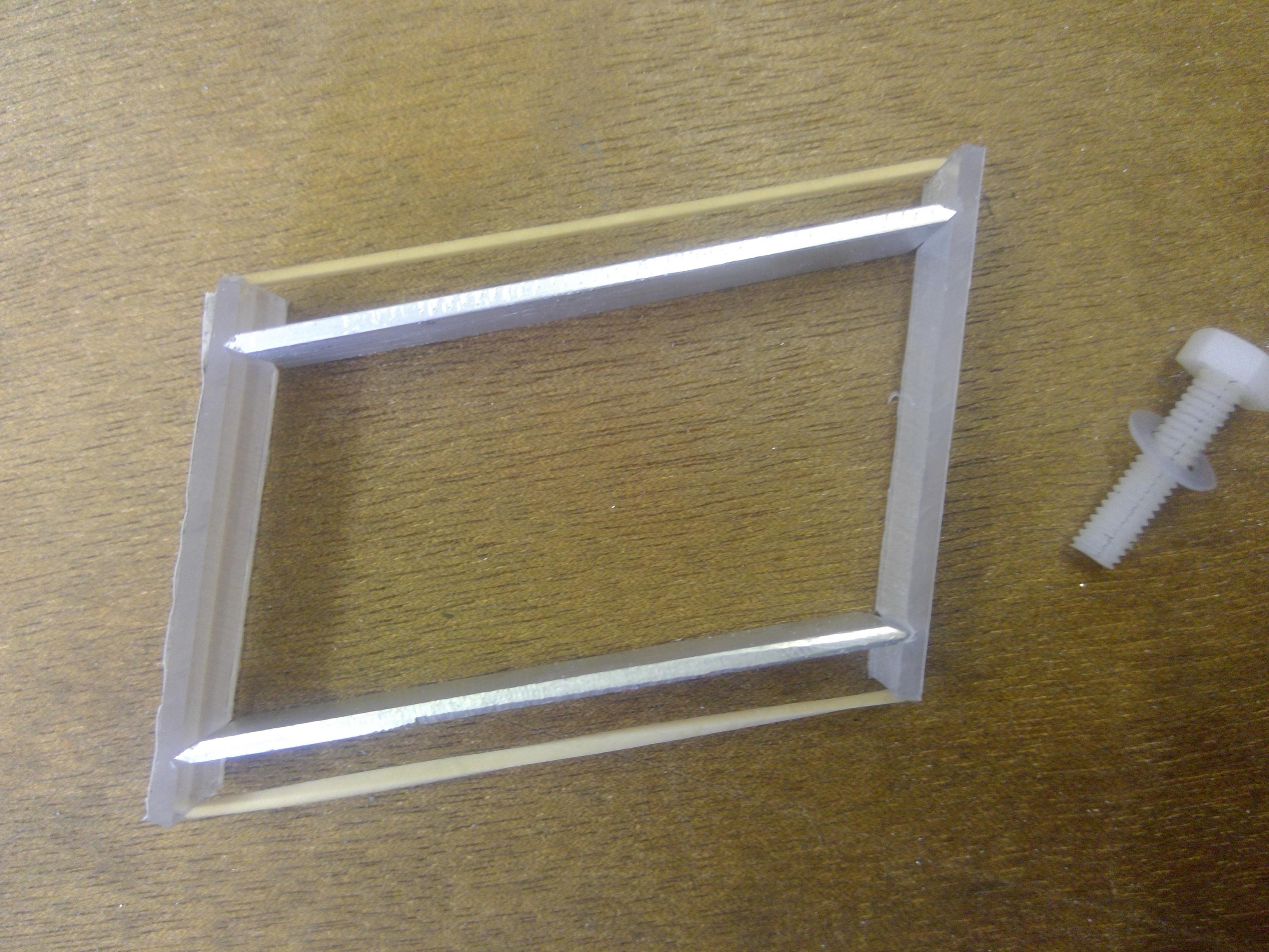

Well, i couldn't resist it either, so out came some aluminium and some Lexan sheet, I filed the notches in the sheet and the points on the aluminium.
the elastic band keeps it together while playing with it.
its roughly the same size as my parallelogram, so i could continue and fit it and you can feel it would work, low friction stable across the plane but i can see it coming to bits and flying all over when setting up etc, i only have one cartridge....and feel it needs always to be firmly attached to something, so for now i will continue to seek out some thinner mylar and see how that way feels. that's an M4 bolt for size

Never use a mock up (+ rubber band!) with a real cartridge, even the cheapest in the world!
Mylar: it has to fold with some roundness not on an angle (this will break it), so what about parallelogram geometry?
I've started to think that the inextensible string + one extensible lever (2 small springs to keep it always in touch) may work.

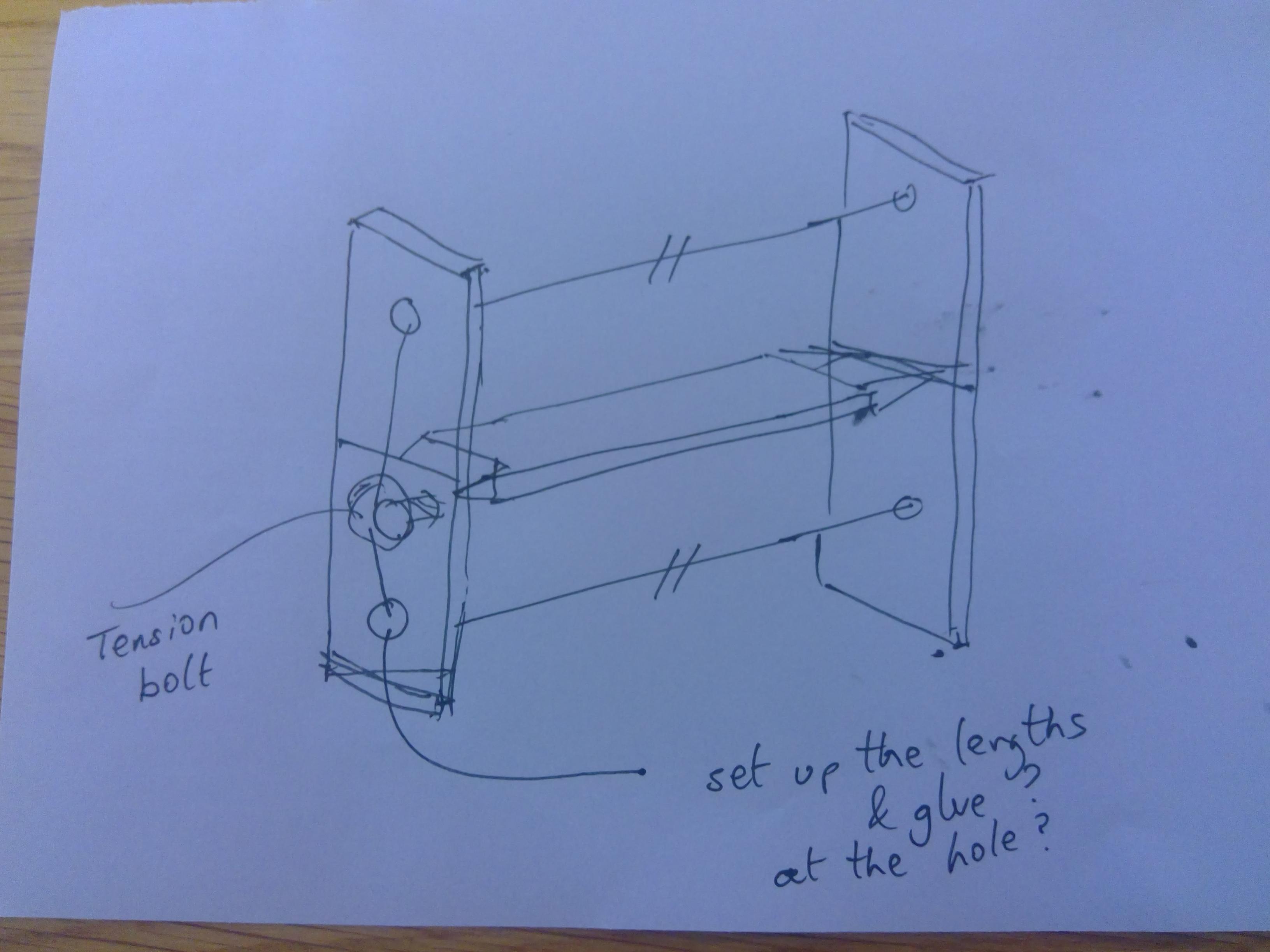

I think the Mylar small bend will be very small and consistent on the 4 corners if i can make it very accurately, but time will tell! At the moment i am struggling to buy the very small amount i need!
I also like the idea of some retaining mechanism, but cannot think of one that suits the hand tools only man! Perhaps one solid central lever and inextensible string above and below with tensioning/length setting might work.....this mornings scribble attached, mike

for me better 2 strings around (but just 1 continuos rope) to avoid every possible side torsion. The extensible lever came to mind because the word inextensible doesn't belong to real world, and the blades friction wouldn't increase noticeably.

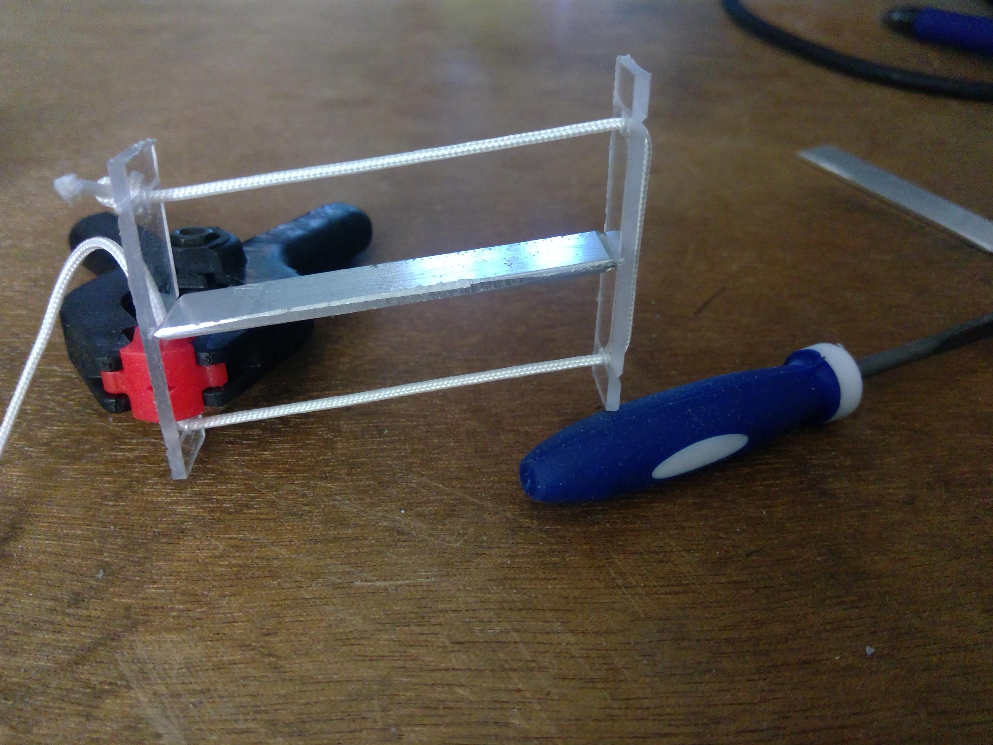

You will recognise some of the parts, just a bit of drilling and filing from yesterday.
This is quite stable to handle, but i think the string is too thick, and although it falls (in warp direction) under its own weight it is much more friction full than yesterdays, however, one can see this is maybe not far off a working idea, would be easy to make and very inexpensive. Tomorrow i will search out some more flexible cord.
I think if the slots are hand filed like mine they, and the knife edge should be longer to avoid play in the VTA direction, alternatively work more accurately. Maybe the end plates in aluminium would work better as well in terms of filing.
I didn't glue the string at the back of the holes yet, this was just an experimental set up, hence the clip remains in place.

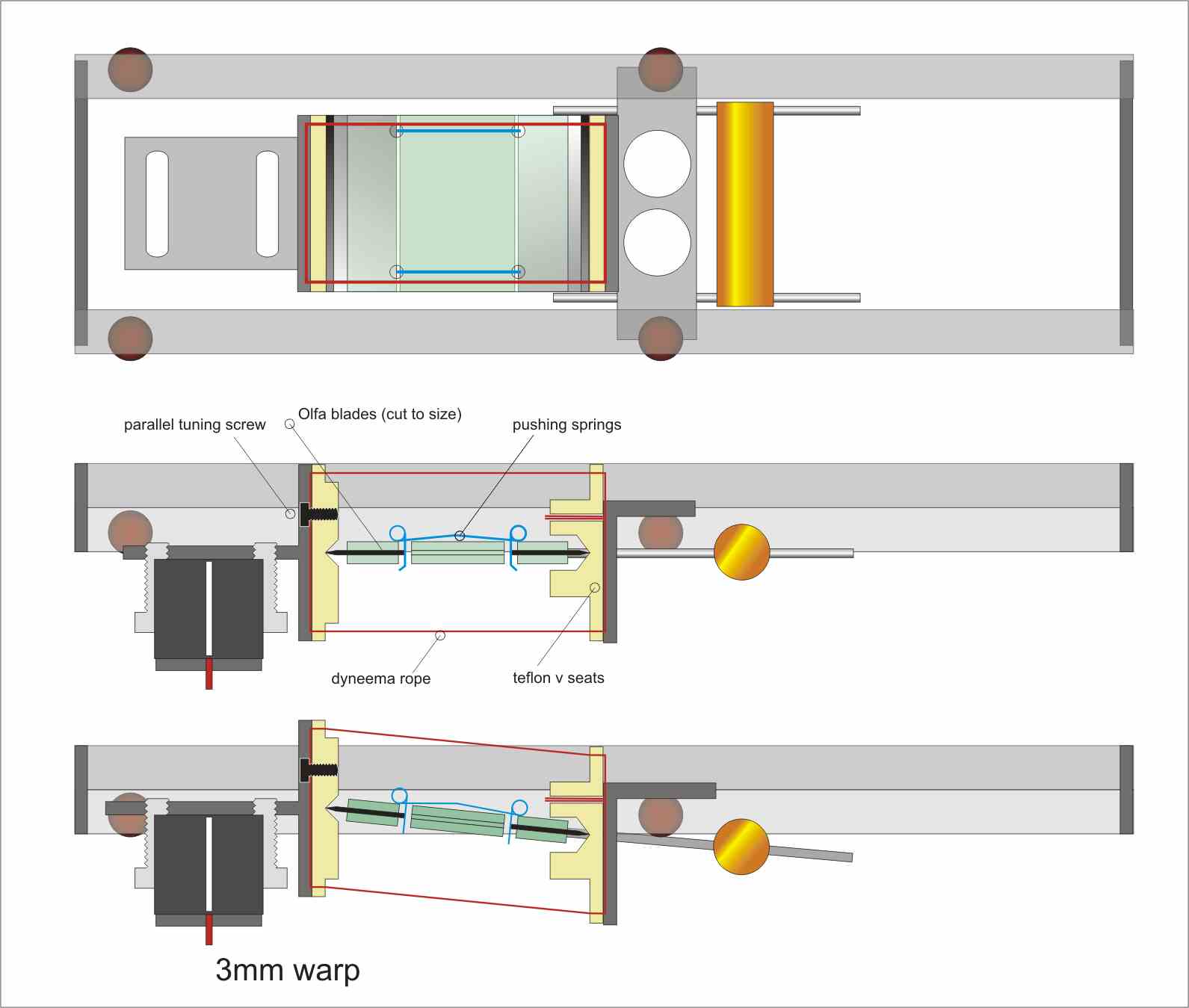

2+2 - 0,25 mm dyneema or spectra string - (4 strings of this diam. may lift a person, and we are dealing with 10 15 grams)
Something like this: the spring lever may be really useful to share equally the loads on the two sides of the parallelogram, much better than rigid lever+ elastic strings. Different tensions drive to uneven vert movement.

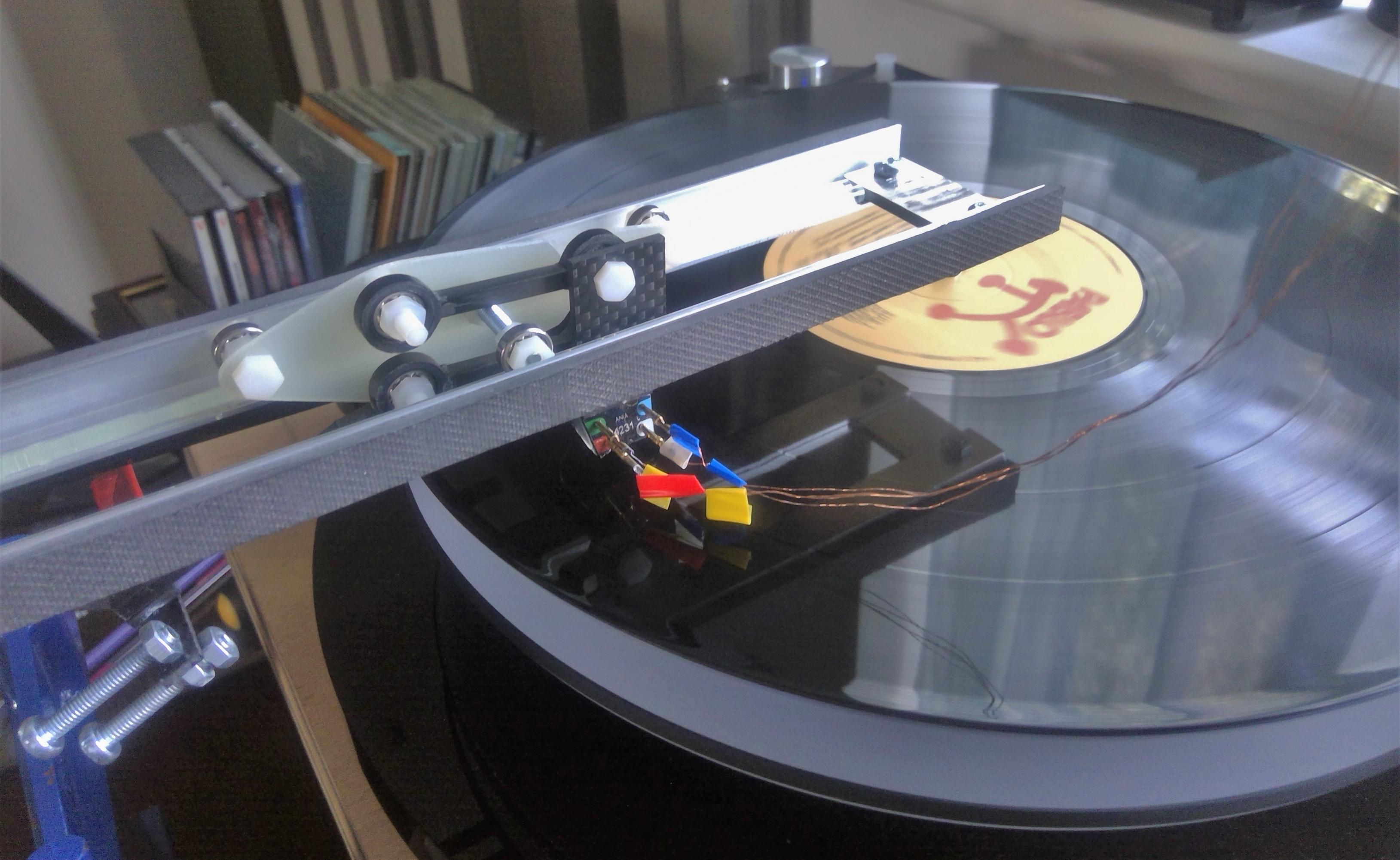

Anyway the first version is up and running and we've tracked half a dozen records without skipping at all now.
The stiffness of the wire when moved sideways wont move the carriage at all, a massive difference to before.
I rebuilt the carriage to move the stylus up closer to the rail and its sounding good.
Ah yes, sorry about the tape tabs, i don't have any shrink sleeve at the moment!
Next move is to improve the rails, along Carlos lines i think, then to change the parallelogram bearings to remove BB's and reduce side play.
I notice more open cymbals and the like as well as good tuneful bass, a fun project and listen.

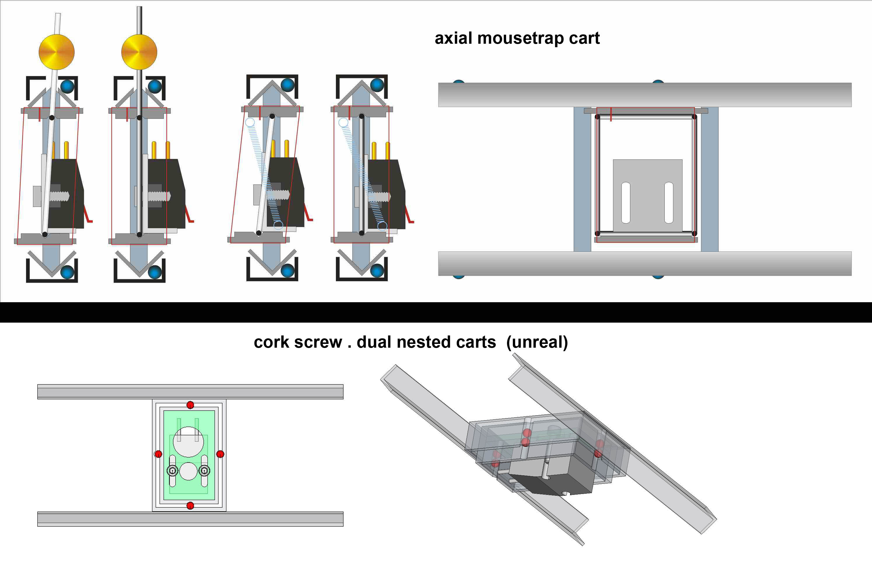

a small step along the mouse trap path (#4007), trying to reduce as possible the levers length, for the concerns explained at #3987. The more i think, the more the axial solution seems more appealing (just to me).
Still toying with my corkscrew cart (here too, I do not like those two arms), but beginning to despair to find a solution: could be something like the one below, but having to go on the moon (1/6 gravity) to listen a record seems rather uncomfortable...
carlo
