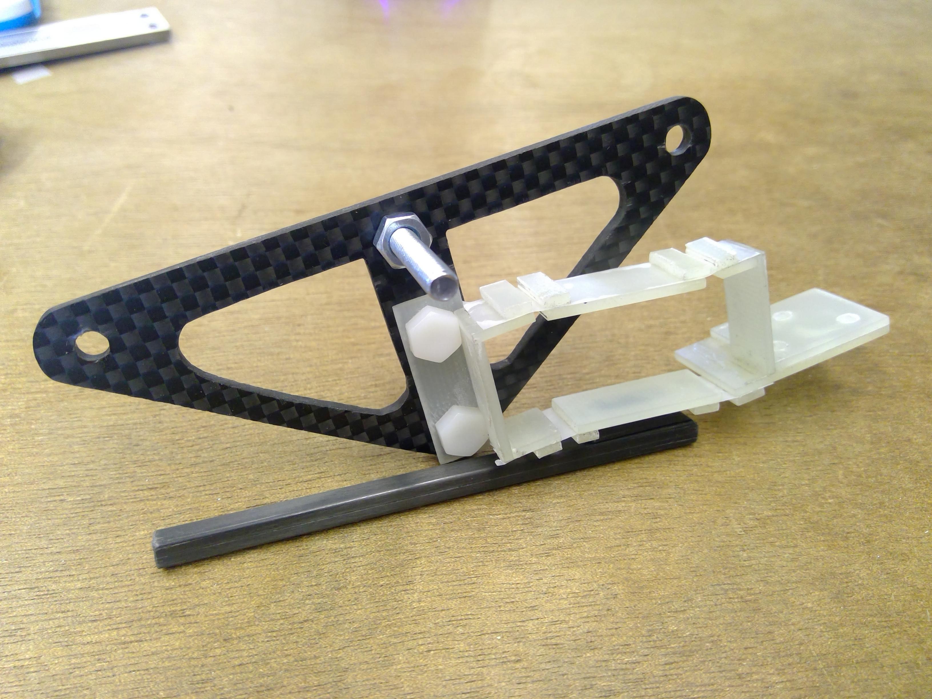

Its raining heavily here so i mounted my latest Mylar hinge parallelogram on my original carbon cart, the workmanship is not pretty but i sense it feels OK as a concept, counterweight, bearings and cartridge to add, i might run it on the TT later.........then if it works i can refine construction, all as usual to be done with a hand saw, files and sandpaper.
Its got notably less expensive as well!

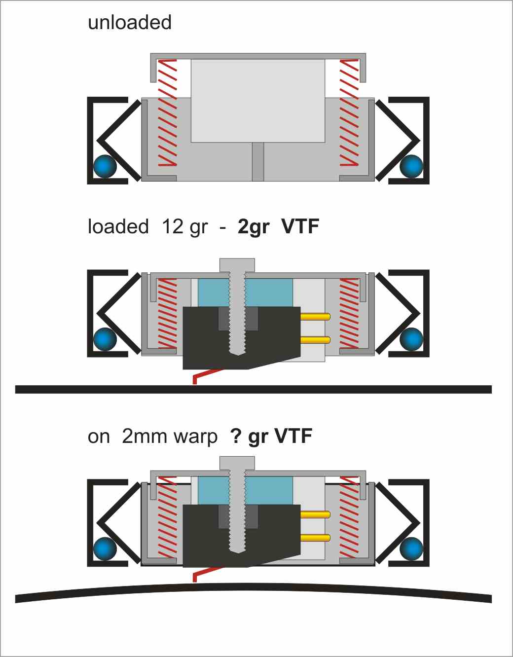

better explaining what i'm trying to understand - calculate
c2
If you take a long but very weak spring, which is compressed almost totally by the weight of the cartridge assembly, then the relative change of the spring force will be very small for 2 mmm displacement.

Meanwhile I did some practical tests (trivial doubts come to me more and more often, will I have to worry?) with a digital scale, two rubber bands, a weight of 100 gr and a thickness of 2 mm. I zeroed the scale with the suspended weight above, then I added the thickness under and that's it = 14 grams more (of which 1.5 is the thickness weight)
So it is as I feared (Hooke law) - if I have a spring with 10 mm of compression for 10 grams - when the warp raises by 2mm, the compression is now only 8mm, that is, I am compensating for only 8 grams, and therefore VTF has increased by the 2 grams. Horrible
So how the hell could they use springs in the past? because Alighiszem's reasoning is right: if the spring was very long (or instead the elongation of the spring a few tenths, thanks to the wand's lever) with 1-2 mm warp the variation of VTF would be minimal.
So sadly we still have to go to the moon (cart weight 1/6, near to needed VTF) to hear this cart playing. Or use that of #4061 or, maybe better, Mike's or Koldby's clever parallelograms (near to what you've sketched, Hiten)
carlo

Mike56's idea mylar hinge is excellent. I am not sure but springs will probably have motions in horizontal plane too. Mylar hinge and knife edge bearing have solid mechanical ground plus only one directional motion. Dual tonearm had spiral leaf springs but it had vertical bearings too.

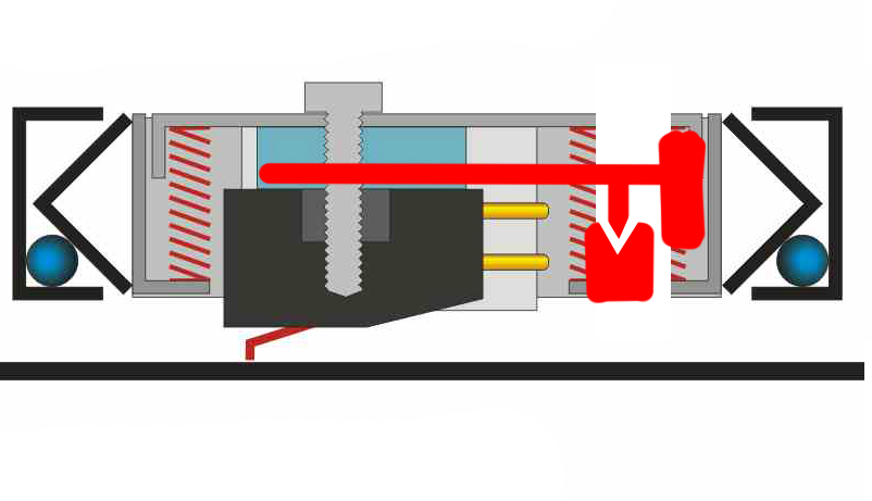

ciao Doug, what a pleasure to hear you again, and that you have not lost interest in TAs.
With the limitations of weights and dimensions of this kind of carriages the solutions are damn few and difficult. An extension spring was also on my Rabbit PLT (mixed 1/2 spring 1/2 CW, to decrease hor. eff mass). Recently making some cosmetic changes I took it off. Imperceptible change, it seems to move better on warps, maybe just autosuggestion.
Until now with the springs I had naively trusted the magic word - linear - but this cart forced to understand that Hooke law says much more than this: as Alighiszem rightly notes, when elongation is relevant it is also the change of the force to get it, that is the VTF. Always linear, but relevant,
This also explained the strange behavior of the springed version (Luxo lamp style) of Lil Casey Mk1: the elongation was small, but already sufficient to alter 10-20% the VTF.
Unfortunately despairing for a true pistonic movement, I see magnets in my future....(the desperate designer's last resort - sob)

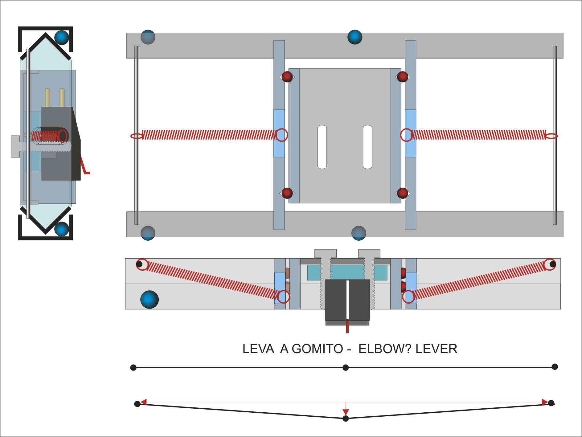

what if
Doug, Dd your words gave me an idea.
What if we used a "leva a gomito"(elbow lever- how do you say?)
When a rope is taut, a minimum force in the center is enough to flex it, with great traction on the constraints. Maybe that's what we need: a vertical displacement on warps obtained with irrelevant force (ie VTF change).
What you think about?
carlo

I guess the vertical balls will fall out due to gravity.

Yes and no--maybe.Sorry, in this sketch I didn't draw the end stops, not even for the horizontal carriage. If it worked, there would be in the realization, and also in the executive draw.
But would it work? what do you think about, Karsten?
c
It looks like you have drawn vertical bearing like the horizontal bearing : a non recirculating ball bearing. IMHO this cannot work, end stop or no end stop, as
the only thing that would prevent the balls from sliding down would be friction!
But it made me think that a sliding bearing (teflon , bronze or whatever) maybe could have very little friction as long as the side thrust was near zero ?
Then I think it could work. Problem could be to have two springs behaving exactly the same way to avoid side thrust.

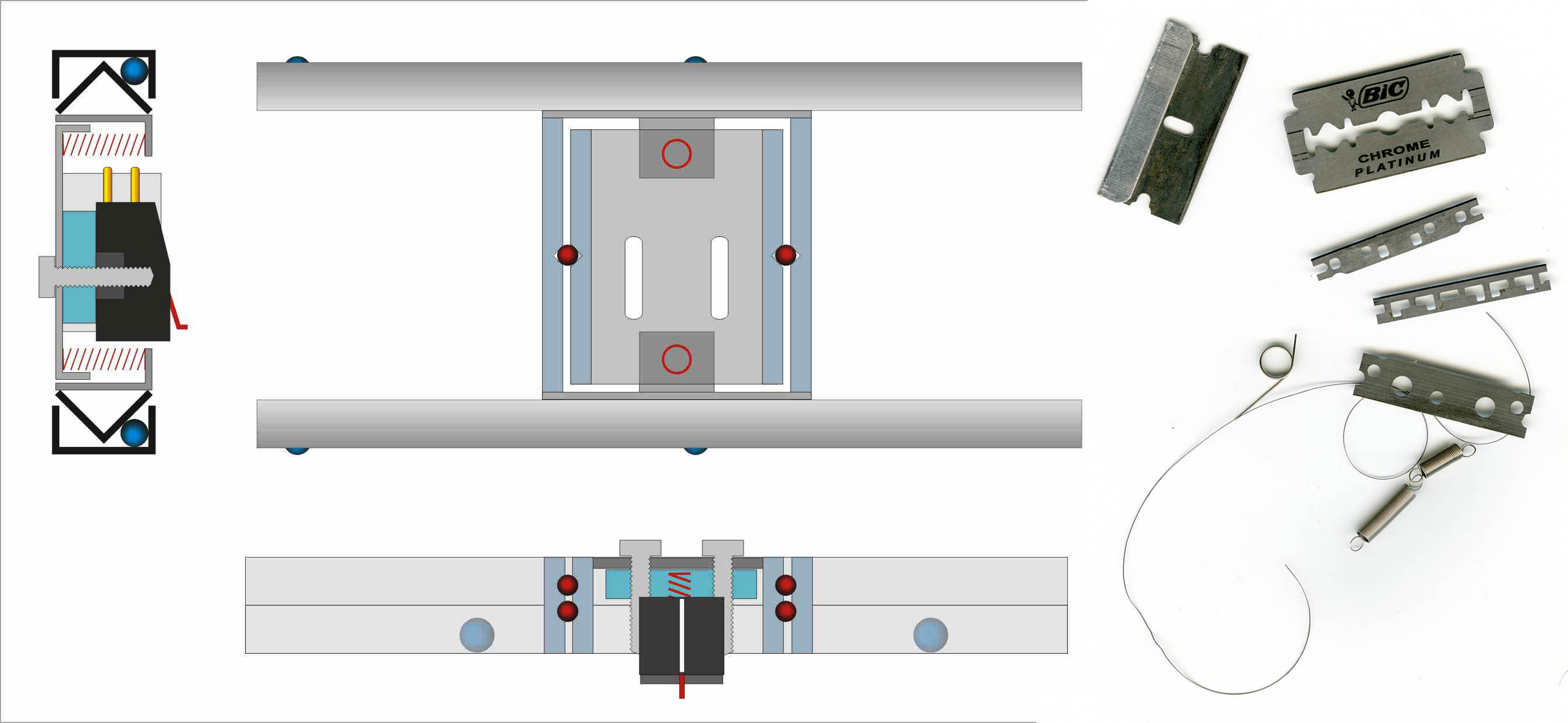

Good evening gents, and it all seemed to be going so well, (Carlo and others talked of the wrong turnings and so on!) ........so i mounted it on the arm, by which time the lower arm that holds the counterweight has sagged the Mylar hinge a touch and its clear all is not moving parallel as it has a slight spring centring action, whereas before that it was very free. Anyway i played a few tracks and unfortunately the current set up is a backward move from my BB parallelogram that sounded rock solid in pitch, this is warbly by comparison so what apparently cannot flex noticeably is doing so as things move in warp. More thinking required at this point, i still like the mylar hinge but its inexact to construct and its not carrying the weight well. The hinges might be wider to counteract those things, the counterweight split between upper and lower, the hinge shorter etc etc more experimentation now required
You're right Karsten, it takes a little friction to keep the spheres from falling - in my drawings gray is used for aluminum, yellow = brass and colors for various plastics; if you notice the guides are light blue = teflon and the spheres red = delrin. But it's also needed a small cage to keep the 2 balls detached.
And I still don't know if all this "bric à brac" can work.
Normally I start to use my hands when, thanks to drawings, I have clear enough ideas not to waste too much time. But with these damn springs, with no relative experience, some mock ups are surely needed, and so well made enough to derive valid measurements and indications for designing.
thanks for hintalighiszem t: if i'm not mistaking on that kind of levers (but with rigid shafts) forces ratio goes by tan alpha, isn't it?
magnetic piston Unfortunately it never materialized into a product. Directdriver
...no difficulty in figuring out why.
carlo
