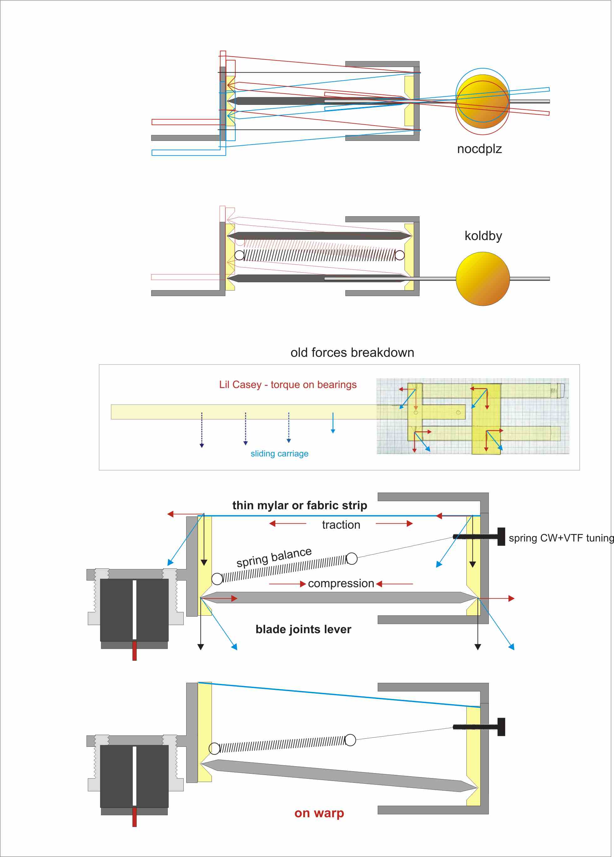

mousetrap tech 2
I was thinking of a vector breakdown done long ago to explain the need and the behavior of the parallelogram on LC.
Yesterday hypotheses may be further simplified, and look more like something buildable
carlo
More interesting thoughts Carlo.
There are constant force/tension springs, but i am not sure if they are made small enough or inexpensive, which would put aside any worry over VTF variation with the conventional spring, however small that might be.
I am playing with small bits of Mylar (drawing film) i have while considering their use for flexural hinges and whilst i see how the forces work on your diagram, i feel that solution might be more vulnerable and less rugged than the two solid struts.

The upper mylar strip is compressed and not pulled, so it would break down.
The spring should be attached under the knife edge.

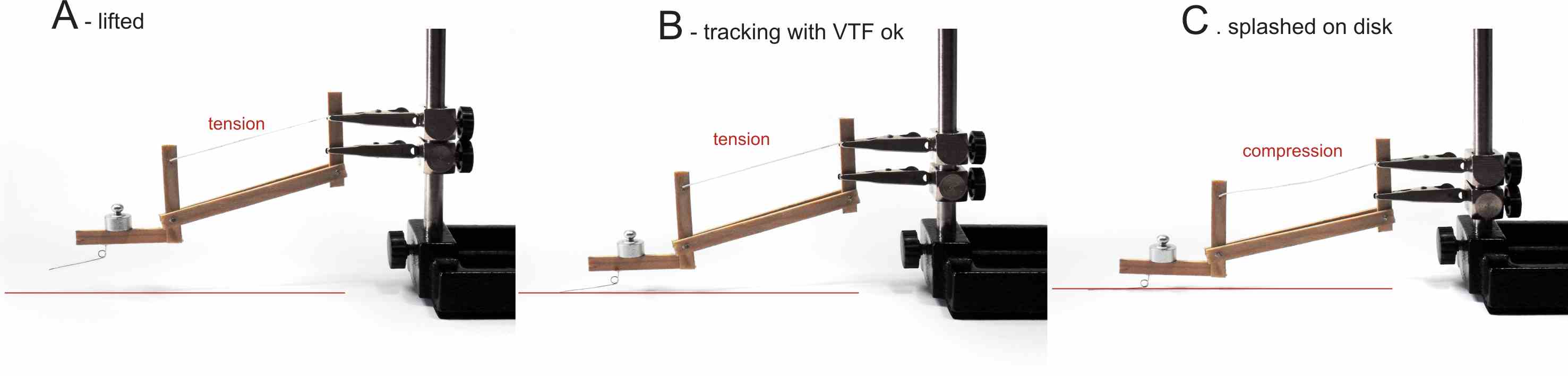

Hi Alighiszem, by now I am so old and dumb that you made me doubt, and I had to make a quick mockup to verify
A - lifted - the parallelogram is just a cantilever = rope (or mylar) under tension
B - tracking -- the parallelogram is still a cantilever, leaning on the stylus springiness = again rope (or mylar) under tension
C - smashed down beyond stylus spring capability - weight completely on disk = only now rope (or mylar) compressed as you said.
On tracking condition B the parallelogram seems OK, isn't it?
maybe i'm not so old. - carlo

Smash down
Ciao Carlo,
I guess your small mock-ups nicely illustrate the real problem with the proposed approach: there is nothing that prevents the collapse of the whole parallelogram construction. Inevitably one would end up with situation C and damaged albums or worse
saluti, Mark

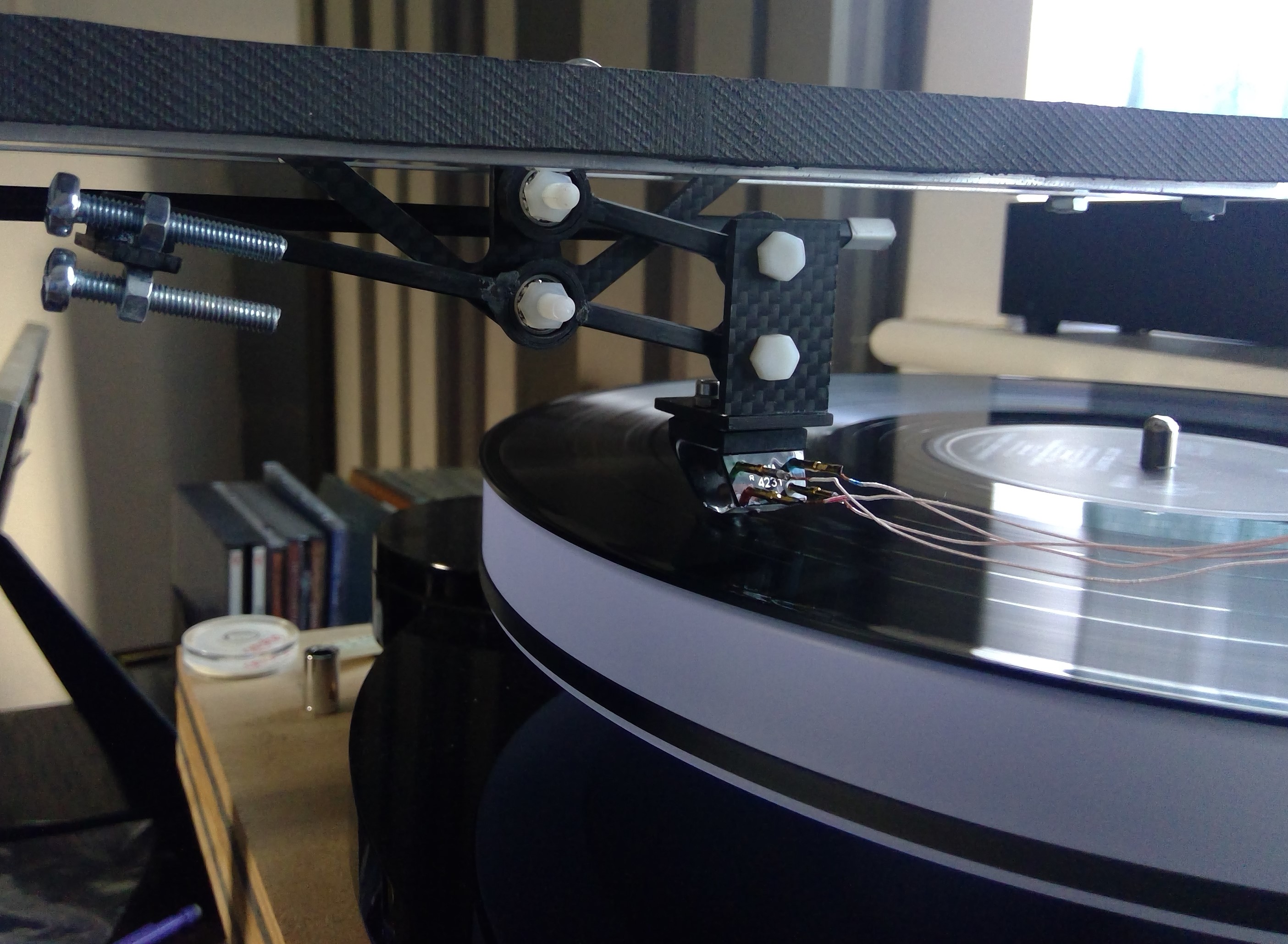

Hi Mark, i am particularly interested in this bit as a move forward from my current version, pic attached. My current parallelogram has BB joints as you can see and these alternatives seek to avoid those with their play etc.
I think two things need remembering from previous posts in addition to Carlos most recent explanation, first that there will also be either a tension spring or a counterweight, two options to balance the cartridge weight and adjust VTF, so in all normal circumstances the fact that VTF remains positive always keeps the top in tension, second the top line would only go out of tension if you pushed the cartridge down and or unloaded the spring/counterweight. However, with finger trouble that might happen, but it might also be less vulnerable with a top line that can compress.
BTW, i stuck mass loaded vinyl to the sides of the rail carriage, cannot say i noticed a specific difference but the whole still sounds really rather nice and i look forward to further improvements. The running of my wiring is currently the most unpredictable thing and needs refinement, i think a loose plait might be something to try, or several ties perhaps.

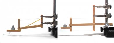

Couldn't resist: added the spring (well a rubber band) to work as CW, and behaves the same as previously; and another mock up for the first idea - one lever+2 strings - This one seems easier to build and calibrate, (especially the azimuth). Promising, imo.
Ciao bambo, that mock up "nicely illustrates" simply that the upper rope, under normal tracking conditions is under tension, not compressed.
...there is nothing that prevents the collapse of the whole parallelogram construction:
For sure, exactly as any pivoted without a lifter, but from a lower height. Do you usually put lifters on your mock ups? not me
carlo

I can see it with new rails (something like Carlos) and a mousetrap (i.e. a parallelogram without BB's) already! - actually it will of course be a new arm by then with much influence from all your excellent suggestions.Couldn't resist: added the spring (well a rubber band) to work as CW, and behaves the same as previously; and another mock up for the first idea - one lever+2 strings - This one seems easier to build and calibrate, (especially the azimuth). Promising, imo.

Hi Carlo,
thank you, now I get the point you're aiming for. Should have read more before jumping in Great inspiration you are providing! Particularly with all the small steps you actually make and demonstrate to share. I like it a lot. Best of luck with your construction adventures!
