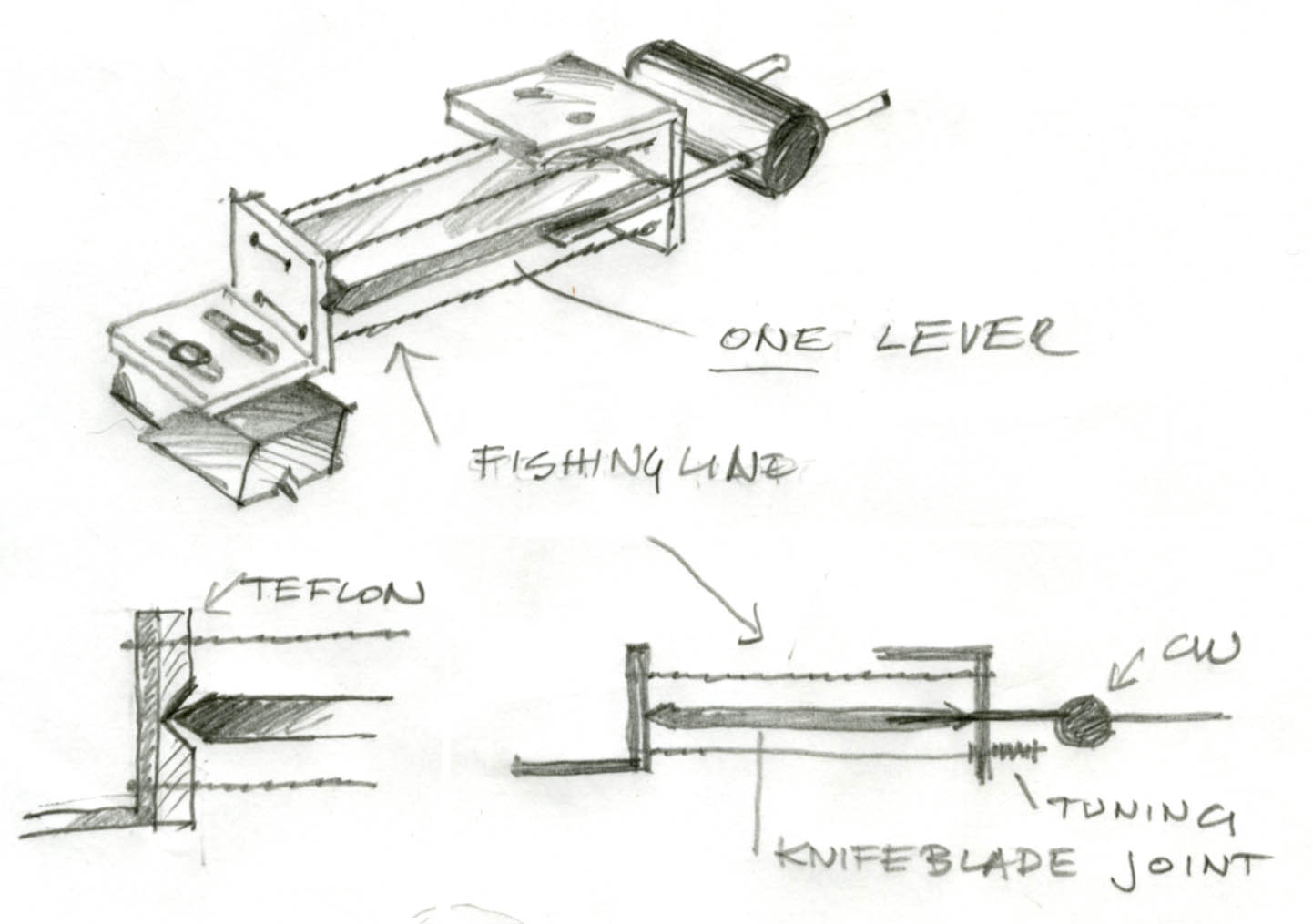

I like this a lot Carlo, the counterweight gives constant VTF in warp but the tensioned line would not?
This and similar are nice and tight in the perpendicular plane as well.
Is 3.5mm BB your best from experience please?
thanks
Mike
I don't know Mike. is a solution considered for the first LC, but the loads were excessive.
With the CW, the VTF should not depend on the fishing lines, that just folds, without usually springs behave linearly, but who knows.
That sketch is not enough even for a mock up, to start you must prevent the cartridge from going down more than necessary.
carlo.

Or just a bit of mousetrap tech...
You could (I'd rather say should) go with only one fishing-line for the upper / lower sides, because the blade makes the parallel alignment of the "headshell"—less fuss with adjustments, proper/even horizontal distribution of the tension …
doesn't a fishing line wear out? It's quite elastic after all... Did you consider silk or plant fibre like bamboo?
another 2c
d.)
Nylon, dacron, spectra, dyneema, etc.* in order of stiffness. But would be better an elastic or a totally rigid? totally rigid, tensioned by screws o springs? Continuos or separate? and how to deal with?
Tons of problems (and failures) laying around: that's fun. But before looking for titanium isotopes maybe better scavenging inside old toys for solutions, that's what i meant
carlo
* all lasting much more than me

May I?
Tensioned by springs, adjusted with screws: a spring doesn‘t wear out (or slower at least) so that the tension of whatever you use is neglectable...

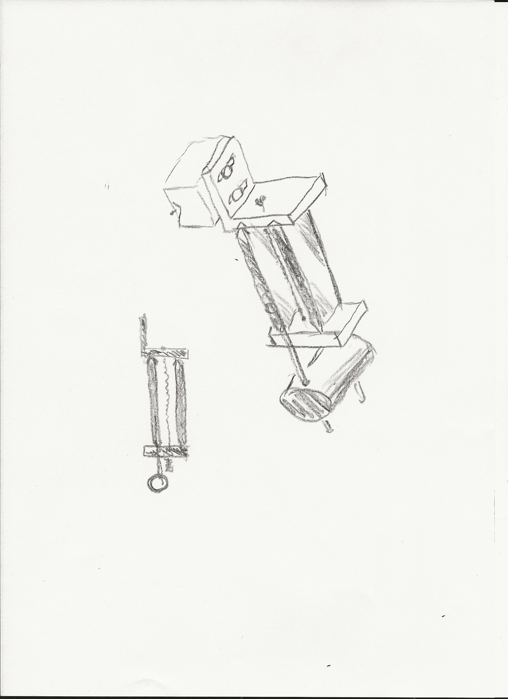

For the motion of the carriage, whether prism or flat or as drawn in your recent corkscrew proposal, thanks, mike
I like the basic concept a lot, no rattling cans of nails, excellent lateral stiffness/lack of play but i see all the difficulties in assembling it with the correct geometry, equal lengths, tensions etc and its all in the effective weight if one adds complexity as well......Dental floss?
I perceive Carlo has the bit between his teeth at the moment and look forward to more!
I like the idea of the top and bottom lengths being preset accurately on a jig and exactly equal as they need to be and putting tension into both equally by adjustment of the lever length buy a simple and clever mechanism that someone else can think of!Or just a bit of mousetrap tech, Mike.
if it works (if...) separating upper ropes tension from that of under, could spare even the CW.
carlo
Tapers or something?
Wouldn't this just tilt the cartridge ?Or just a bit of mousetrap tech, Mike.
carlo
I perceive Carlo has the bit between his teeth at the moment and look forward to more! -- Mike
Unfortunately no, Mike. Imo there's no need of a parallelogram with a fixed rail, and therefore I'm looking for solutions starting from "corkscrew carriage": for now I'm just realizing the problems and making some calcs.
I posted this solution, that we all already know, but that can be lost in sight while chasing details only secondary for now. Why look for the best bearing in the world, if you can do without it?
However, I know two things: if the line is single and continuous (and rigid as the dyneema) you give the tension (with a screw?) and then set the two plates perfectly parallel. At that point lock the line into its holes with a drop of loctite - That's all; spectra or dyneema will no longer move.
If instead we want to remove the counterweight (how complicated are simple things) we must use something a bit elatic
(nylon monofilament or, better, the dacron - dental floss) in two sections, to be tightened separately.
Wouldn't this just tilt the cartridge? Karsten
Sure, but now we have to design two fine tuning, that allows us to have them perfectly parallel at the right VTF.
Hoping that 1-2 mm of warp won't change things too much (i can't bet on this)
carlo
new sketch
May work really fine Karsten, and it'much simpler too; but 2 levers again (without ball bearings, though )
