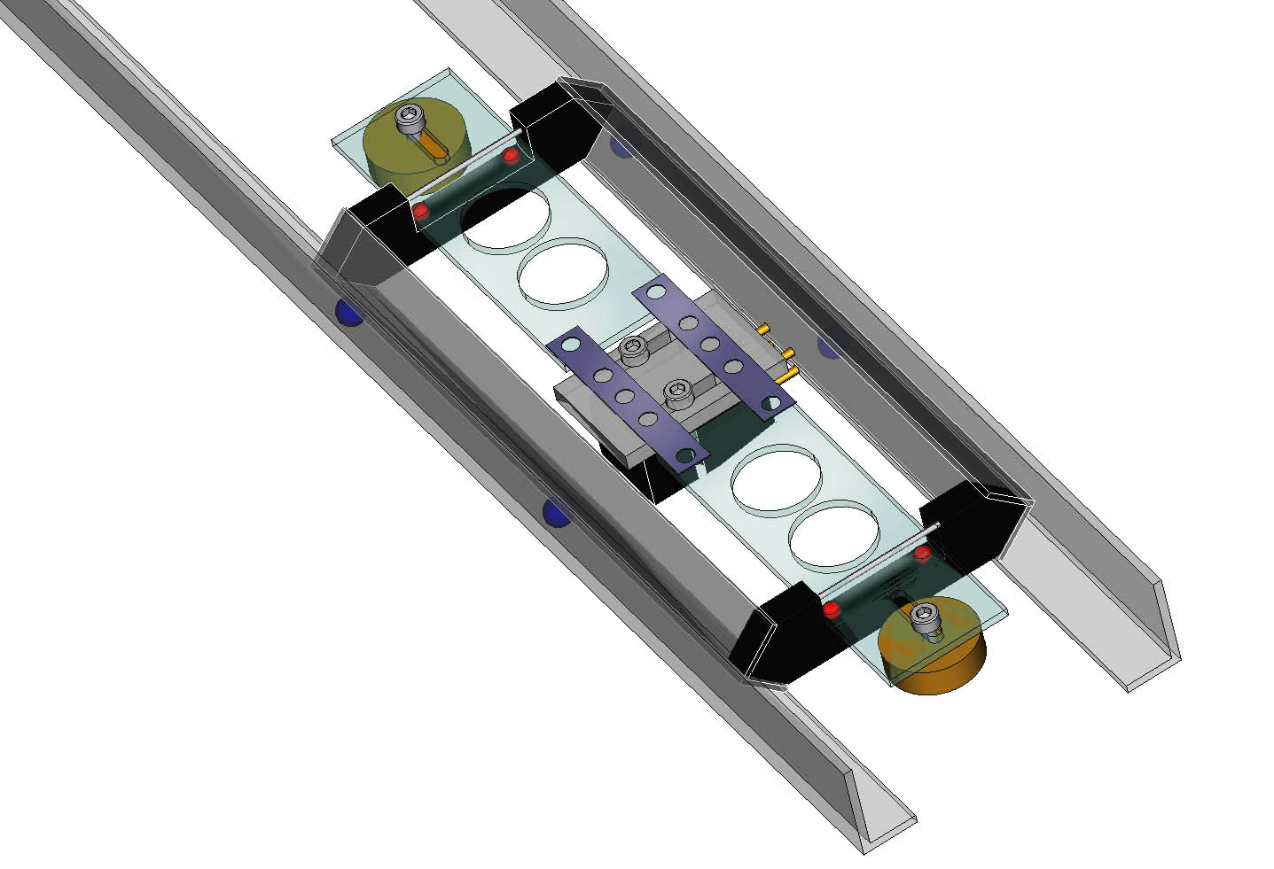

Mike, your parallelogram lends itself to flexure pivot bearings. You would end up with fewer rattling balls.
That is a good idea. Korf did a series on these and tested a couple of different types.

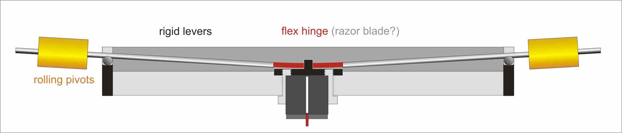

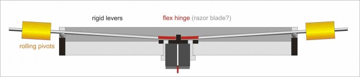

Hello Carlo,
Looks like a good idea. How about changing the support rollers to knife edges? I assume the spring steel blade would be straight and horizontal when the stylus is in the groove?
I am impressed, you keep coming up with unique concepts.

I like the idea of the carriage roller and pivot combined, but looks to me this can tip in Azimuth until you apply your next bit of great logic

Thanks Ralf, your appreciation is particularly welcome - I always try to design on the "what if " basis, even at the cost of mistakes, and someone's laughs; but with some unexplored results.
Knife blades - carrying the drawing on computer I saw that it didn't work: by turning downwards, the levers - tied to the center hinge - must move on the fulcrum, which can be obtained only by rolling on the support (to be calculated precisely).
levers horizontal at the max warp - in the middle on leveled groove; i think that a one direction rotation may be more consistent than an inversion.
Mike, I don't understand: the carriage moves horizontally on it's non recirculating balls. The cylinder, welded to the levers rolls on it's support just for vertical articulation The rotation on both sides is symmetric , so the azimuth should remain vertical.

Good morning carlo, sorry to confuse.
Horizontal, my note was really an additional idea to try and get two things for one, it was to use the same pivot for a carriage roller as for the vertical motion machine, whatever that is, that way it reduces bearing/pivot numbers and allows the small lateral motion needed for length change of the arms. it relates to a wheeled carriage, not a linear bearing type.
Vertical, i see the flex plate as being able to bend in various places along its length and so one side can move more than the other, i thought about it as two pivots one each side of the cartridge to confirm that in my mind, may well, of course, be wrong!

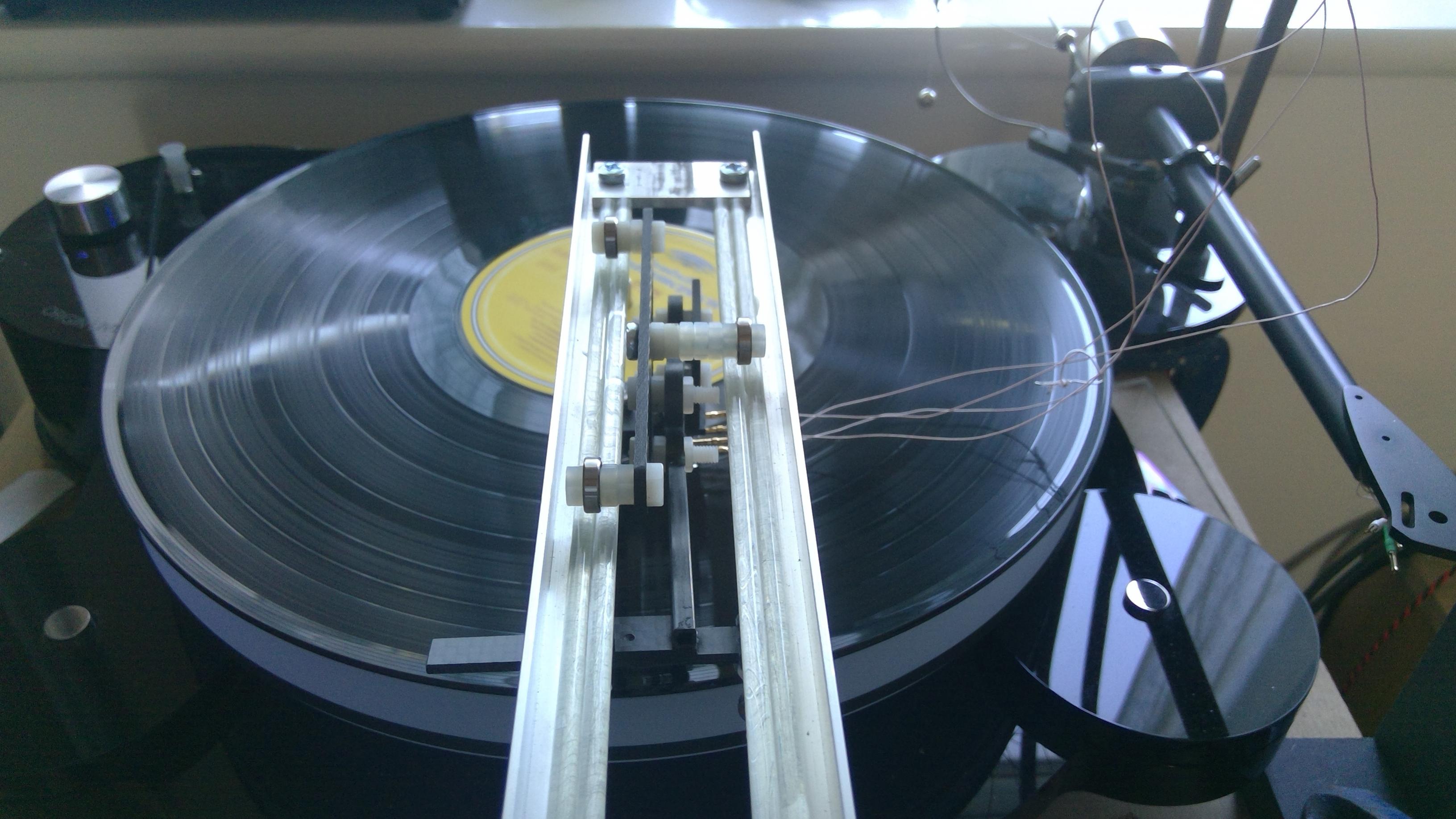

My first corkscrew carriage posted, worked with the same principle: the carriage wheels gave also the vertical movement. But letting ideas freeze, can be thought that this way the horizontal movement could also cause a vertical one. Not a good thing.

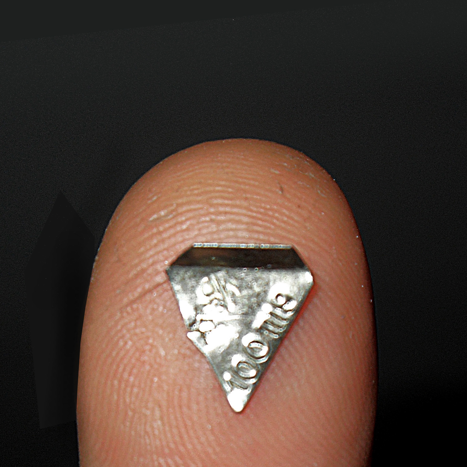

Stylus tip point of view
I had never posted this photo, not to discourage anyone: it is the hard lesson learned long ago from my Syrinx PLT (an "ambitious" project) total failure. This 100 mg is the force that may be exerted by the stylus to move an arm, at most 200mg, (a 5x5 square of office paper).
Now think again a flat hinge while folding (if it can)

What would prevent the rolling pivots from rolling earlier than the balls on which the whole gizmo rolls? The load is smaller on them.
Well.....i completed the three wheel upgrade as per pic attached.
I have played just one side and it seems OK, the pitch motion and associated wow is apparently gone.
No detailed assessment yet because the change in geometry knocked on to the lift, which i did not foresee like several other things and i now need to fix that before trying more
mike

Ciao Alighiszem, it' a long time: encouraging that you are interested.
Right observation, but I still don't know almost anything about this contraption, not even if it's worth a proto.
Being the two rolling pivot counteracting on the two opposite sides it should be stable, moreover the forces are acting separately and orthogonally, but who knows.

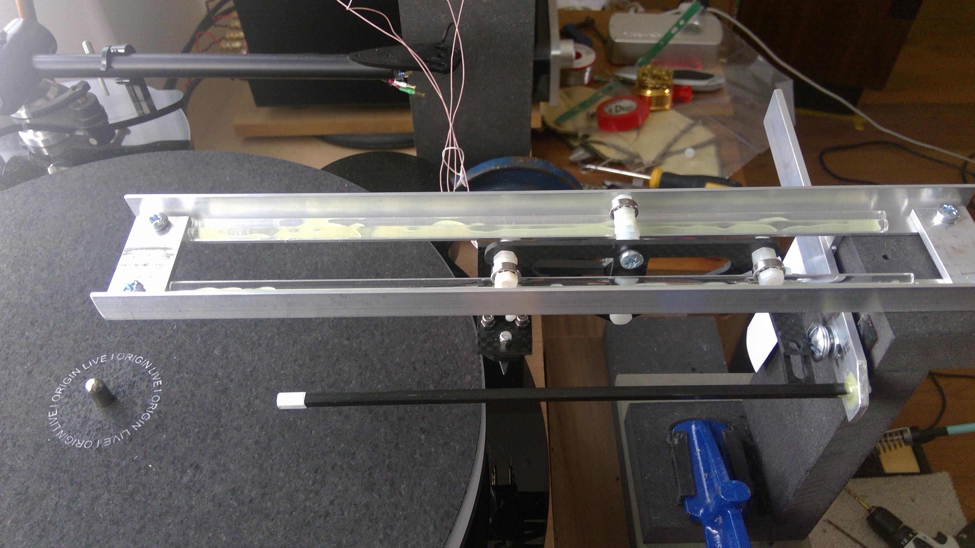

I also like lots of this Carlo, having just got my Tricycle aligned to the rails, and that was difficult enough i like 3 point carriage main ride to avoid line up difficulties, maybe one side is one ball, the other 2? or perhaps this rail/carriage self aligns........?
BTW in the pic attached the carbon arm underneath is squint, it was a mod for cueing and it glued crooked, but no detriment in that, its not an illusion!
so this plays records, some good detail in places, sounds rock solid, good bass. biggest thing i notice is handling the carriage and the supports have microphony(? -is that the right word?) where my OL stuff has little - damping? also of course i am not yet "connected" to the platter spindle
Great improvement, Mike.
On mine better a symmetrical friction on both sides, and just gravity for self centering, but I understand well that 3 bearings are better than 4.
Do a quick test, put a steel ball on a L profile, and try to hold it still: you will see that often a level is not enough. Then do the same test with a ball bearing cart. That's why I like non-recirculating: better there are only the sophisticated solutions developed by Niffy.
This will be normal to some extent. My rail is damped to the point where if I tap it with a pencil I get a dull thud through the speakers. But I can hear when I move the carriage by hand on the rail.
If I were you I would damp the rail. If you used glass tube fill the tube with epoxy. I then epoxied carbon fibre between the rods and rail. My rail uses carbide rods. For your next rail you could use linear rails. I have a set of 6mm round linear rods I was going to use but went 4mm.
