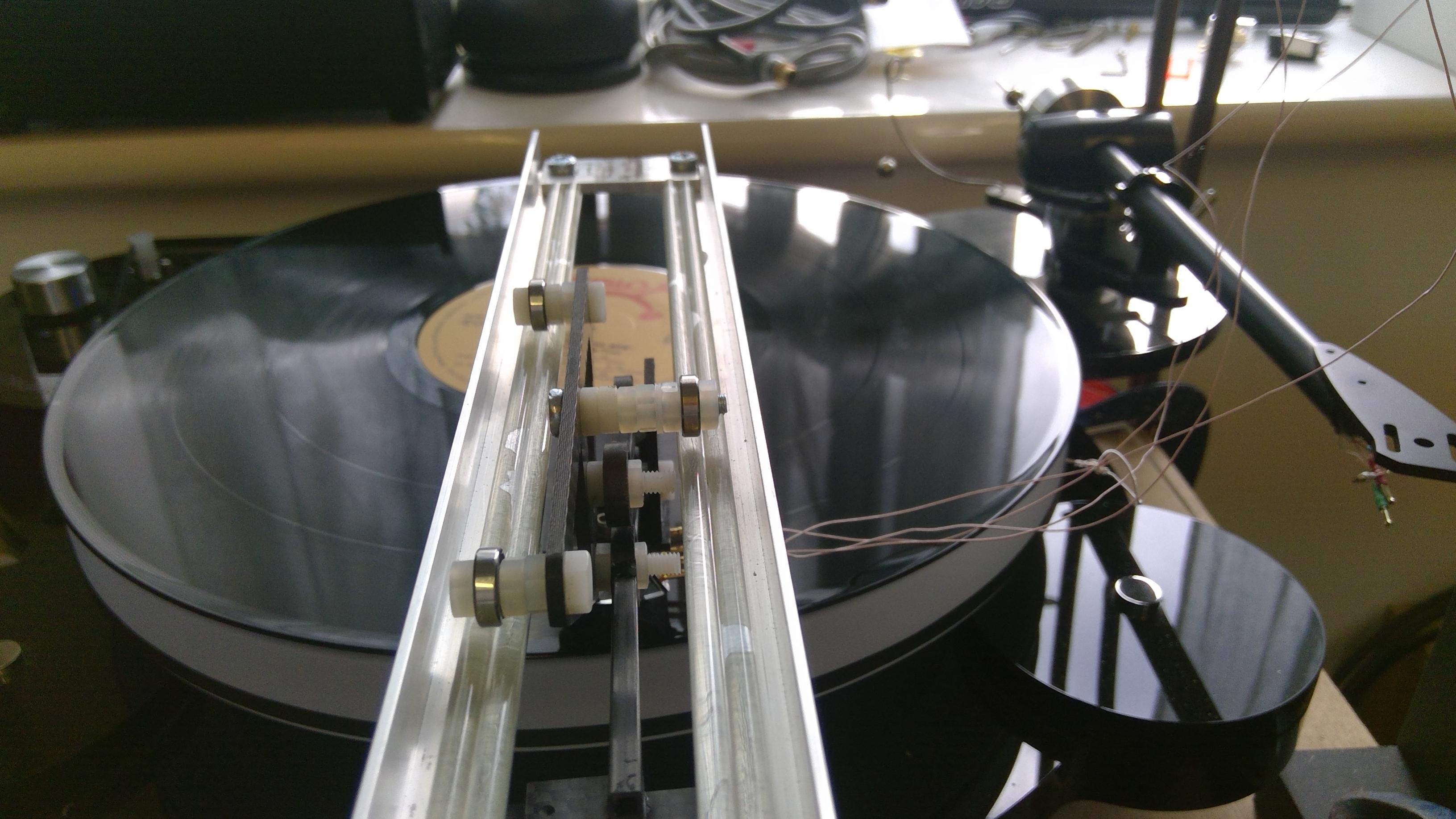

Mike, you could dispense with one of the rear glass rods and run the bearing on the top of the rod. The front rail is effectively your alignment in that case. I'd be concerned that if front and rear rails aren't absolutely perfectly aligned, or if there's any friction in the end float of the bearings, one or more will be trying to climb the wall of the rod.
Thanks Carlo, i will keep on the development route as its encouraging enough to be worthwhile!Great improvement, Mike.
On mine better a symmetrical friction on both sides, and just gravity for self centring, but I understand well that 3 bearings are better than 4.
Do a quick test, put a steel ball on a L profile, and try to hold it still: you will see that often a level is not enough. Then do the same test with a ball bearing cart. That's why I like non-recirculating: better there are only the sophisticated solutions developed by Niffy.

They are glass rods Warren so i can only really damp the aluminium mount, but its not really very tolerant of mishandling and i may well move towards a Carlo recirc balls route, however i am still not sure how one gets them to stay in the correct location........dont you keep needing to reset them?This will be normal to some extent. My rail is damped to the point where if I tap it with a pencil I get a dull thud through the speakers. But I can hear when I move the carriage by hand on the rail.
If I were you I would damp the rail. If you used glass tube fill the tube with epoxy. I then epoxied carbon fibre between the rods and rail. My rail uses carbide rods. For your next rail you could use linear rails. I have a set of 6mm round linear rods I was going to use but went 4mm.
My Vernier says they are 100% parallel and they look the same as the carriage rides from one end to the other, but you are correct, its a tolerance issue and sensitive as well which i don't like and i am sure at microscopic level they will be wrong, so a three wheel tolerant solution that maintains VTF if it self centres is sought............Mike, you could dispense with one of the rear glass rods and run the bearing on the top of the rod. The front rail is effectively your alignment in that case. I'd be concerned that if front and rear rails aren't absolutely perfectly aligned, or if there's any friction in the end float of the bearings, one or more will be trying to climb the wall of the rod.

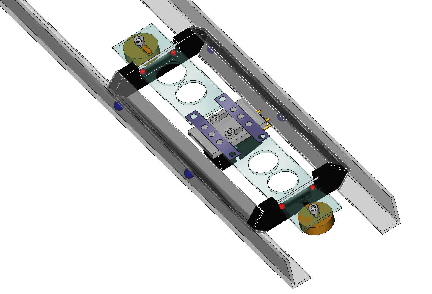

Corkscrew - radial rail
The only example of using a flex strip bearing in a linear turntable that I've seen is this aborted kickstarter project with a servo tonearm, except the flex strip is placed front to back instead of sideways.Since the back strip is fixed position and the front strip can flop up and down so it's really a pivoting bearing without the rigidity of traditional pivot arms.

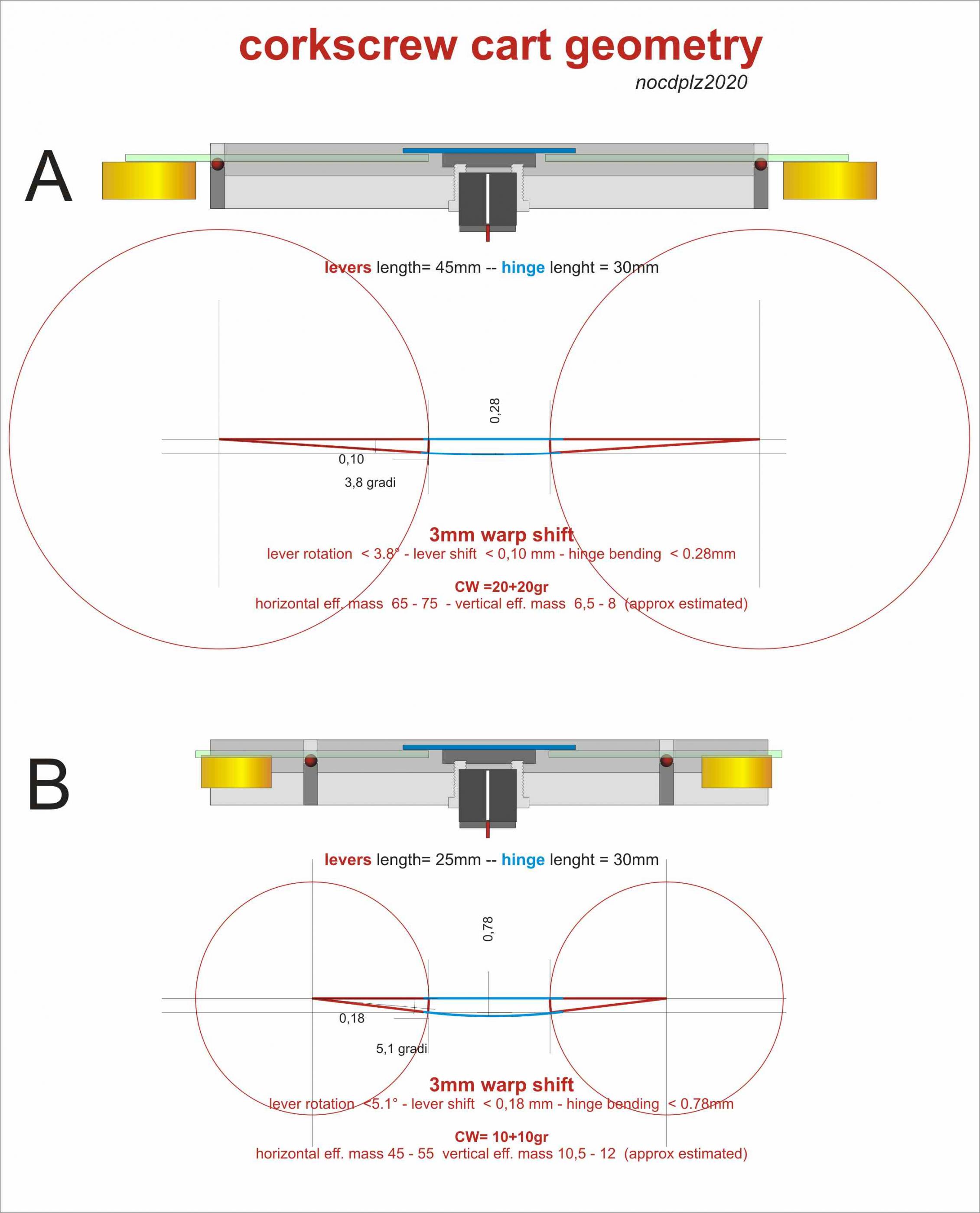

Let's start designing: some numbers and evaluations about the "Corkscrew Cart" radial rail.
Compared to A, solution B allows greatly reduced weight of the moving masses, while increasing the vert. eff. mass (thus improving the vert. vs hor. ratio*). This at the price of a greater (0,78 vs 0,28) hinge bending. (less consistent VTF?)
The extremely tight measures of unwanted movements are very promising, but the overall weight of the carriage must be kept as low as possible. (materials, dimensions)

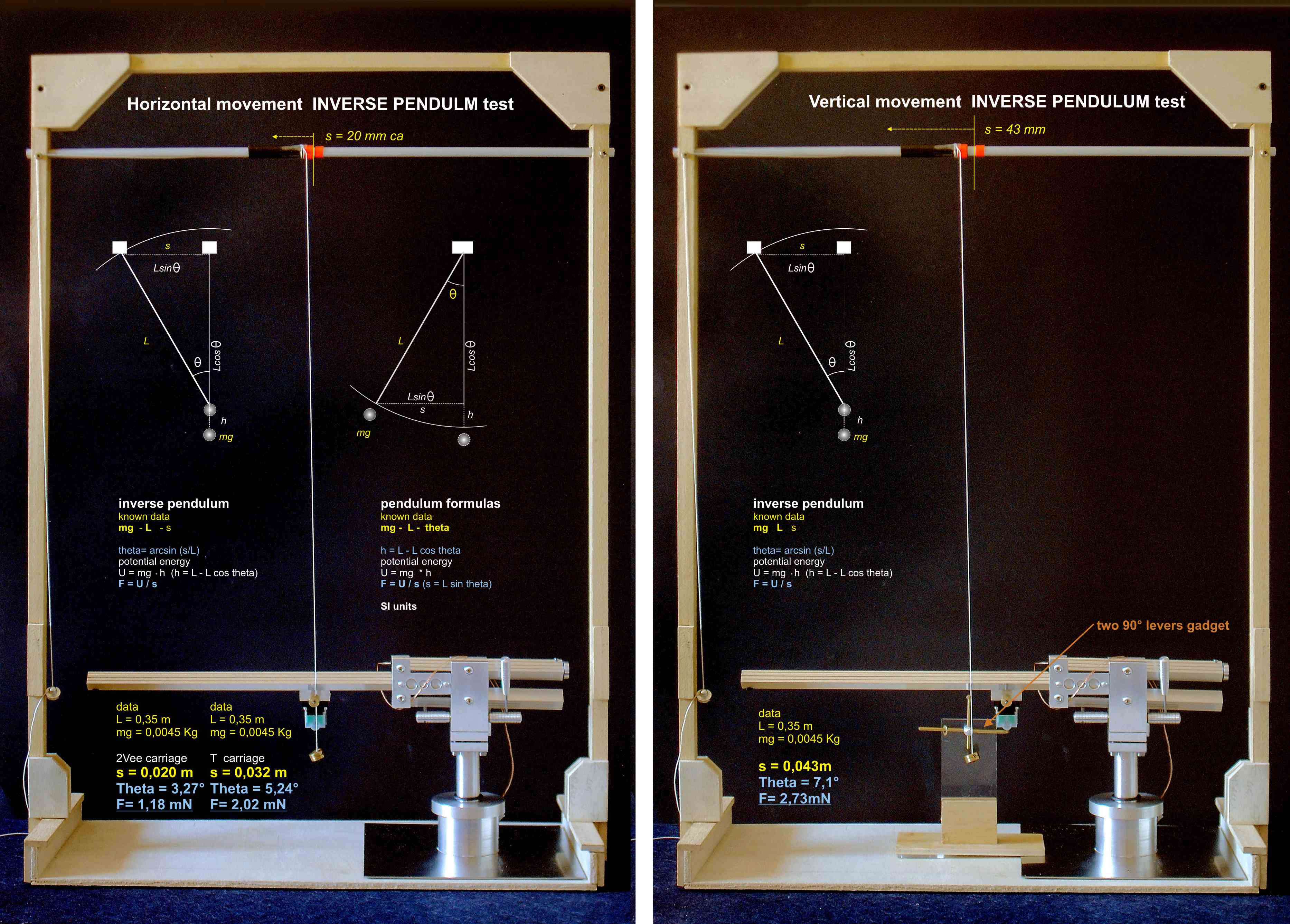

Hi Dd, glad to hear you again. At personal level - remembering all precious hints you gave me in the past - and since you know well what's new and what's not in TAs design.
If you look at this present attachment you'll notice that i'm trying not to use the flex hinge for the articulation (just a 0,28 bent). But that solution seems attractive, even if it lets imagine great VTF variations. Do you know something more?
carlo
* this is an interesting point to think about: in fact a rigid radial rail, which eliminates the disadvantages of the mobile one - starting from the famous parallelogram - brings us back to a situation very similar to a normal LTA: hor eff mass much greater than the vertical, and vertical articulation through one or 2 short arms.
Now one of the advantages of the LC, according to authoritative opinions, is precisely the elimination of the arm (= resonances) and, according to others less authoritative (mine), to have a better ratio of V/H masses, and no chattering, by grounding the cartridge directly to the mass of the rail.
So, at the end, which one will sound better ?

Good news and bad news, running the third bearing on top of one rail was an easy enough adjustment, i just respaced it on its bolt and although this affects VTA, steeper by a degree or two as the bearing is higher than the others it seemed to work, got past the previous sticky bit but then stuck at a new one later on the same side which the two bearing one tracked no problem.................all (simple!) ideas very welcome, mike
Well, my Kludge proto is all a bit sensitive in my view, it tracked the second glitch cleanly now by moving the centre of the wiring towards the centre of record and a touch more tracking weight, towards the max recommended of 2g now.
It wont ever be a viable entertainer that way so I will have to improve it further, occasional repeats are not really a viable level are they?
However i enjoy listening to music on something i didn't believe i could build which is the whole idea! - it sounds OK, and that makes it worthwhile, several of you said, just build something and i have and that's fun, thankyou all so far, and i look forward to the benefit of your expertise in the future!

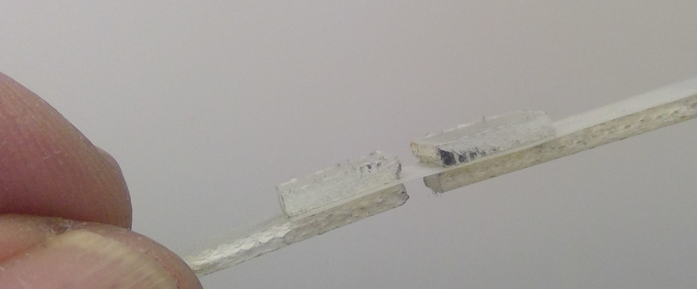

Mylar hinges to replace BB's on my parallelogram?
I mocked up a Mylar hinge from 1.5mm grp plate and heavy drafting Mylar.
this bit of 20mm long plate sags 2mm under its own weight so empirically i feel it wont be a big VTF variance in warp. the hinge is really play free in the plane perpendicular to the hinge plane....should be better than the bag of nails BB's?
Any thoughts before i do a complete mock up failure please?!

That's your flexural pivot with a summary of all its advantages. Who knows how it's going to work for your particular use case?

On your parallelogram, with 4 hinges and just a lever of 4-5 cm. you need a really thin Mylar.
