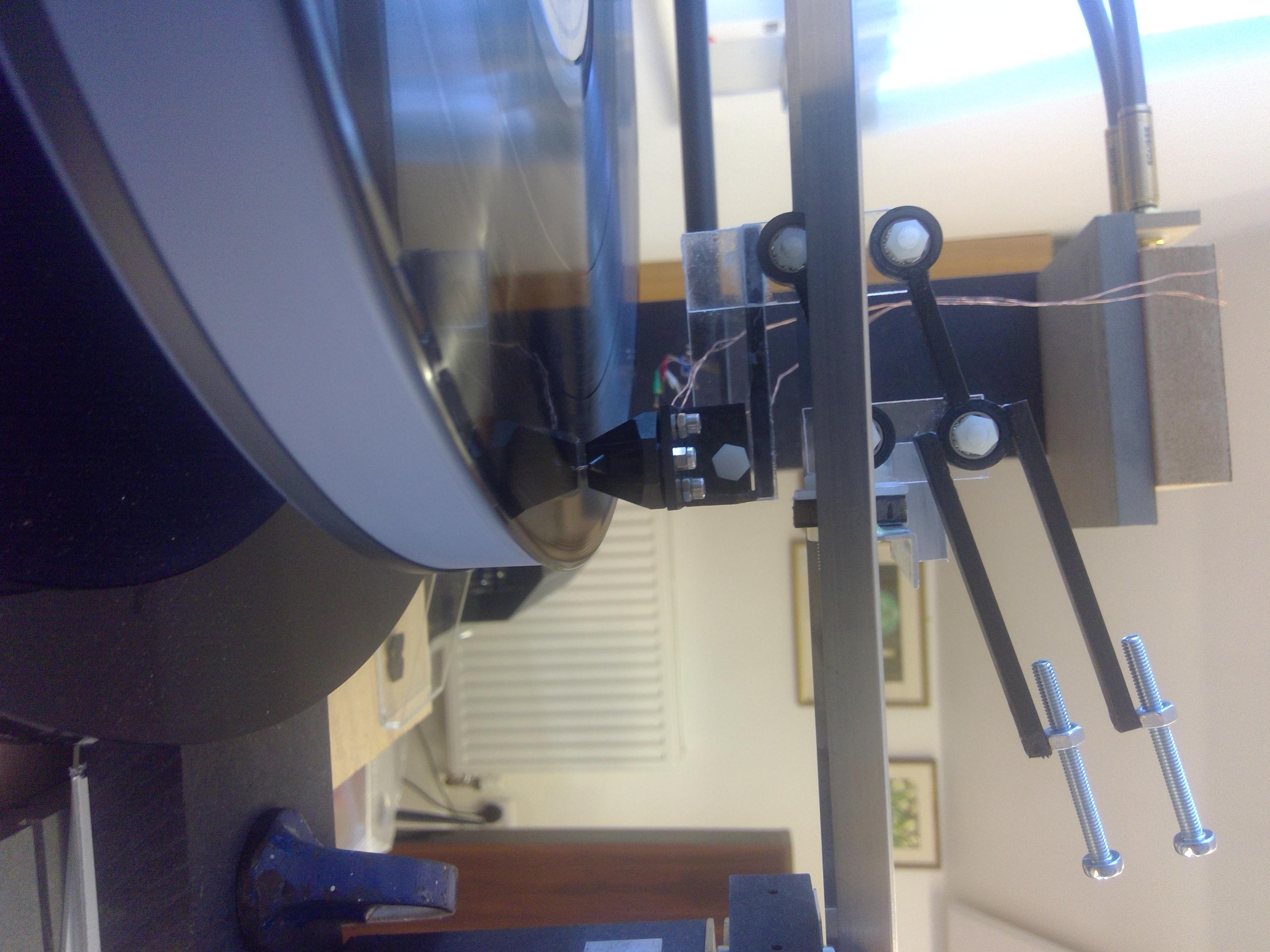

Thanks Warren, it may be that this pic attached when at rest better shows the mechanism opened out so the coincident stylus and fixed pivots are apparent, cannot make the pic attach rotated correctly though!
mike

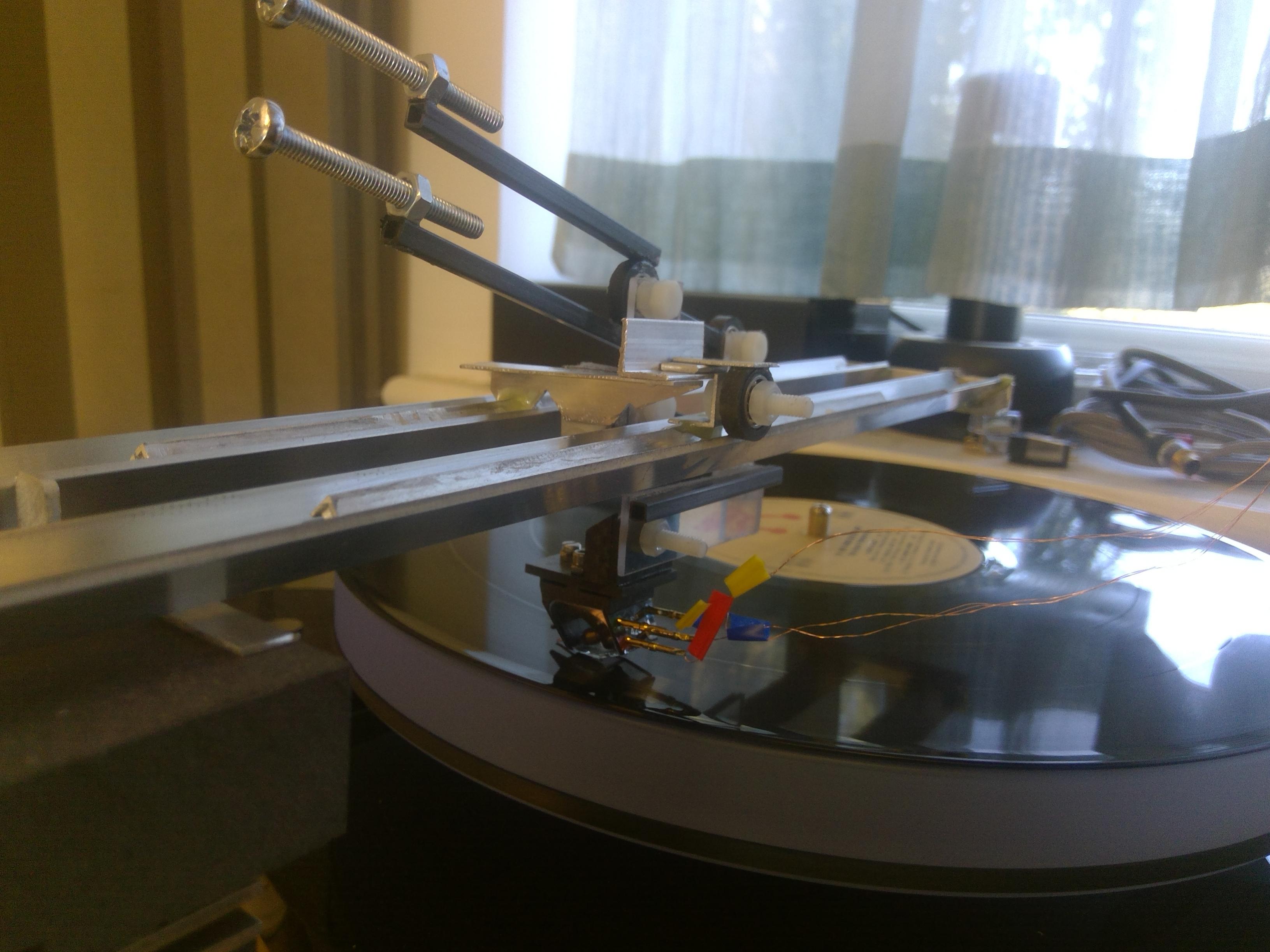

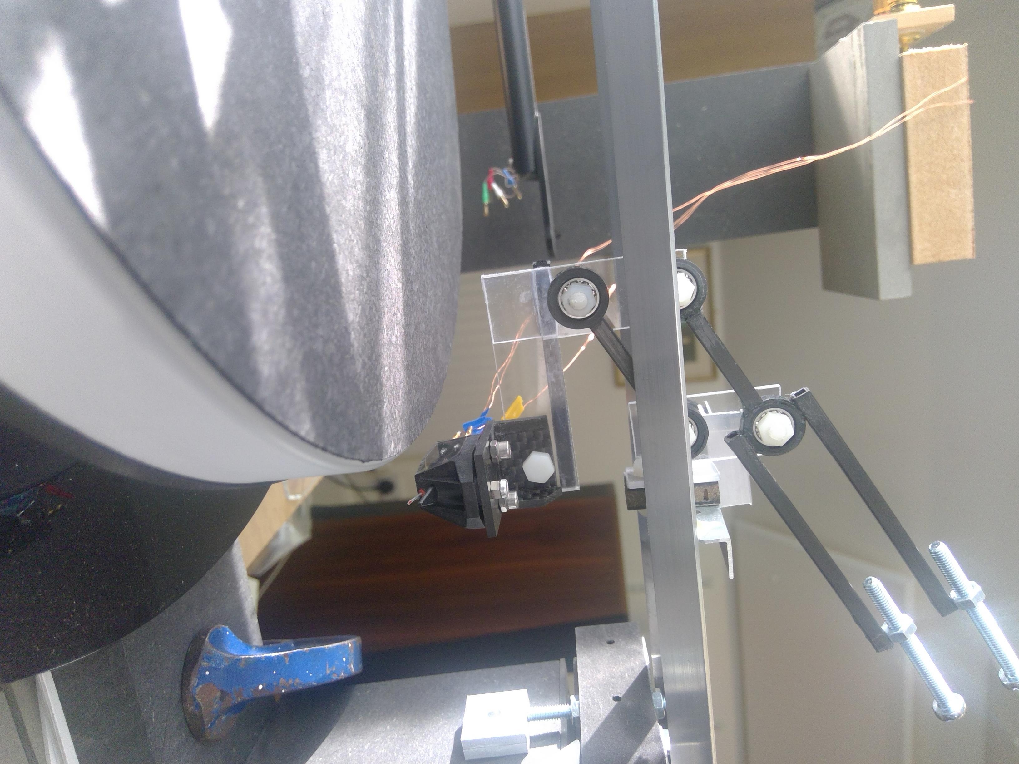

Good morning Folks on this thread,
I am hoping for some feedback, analysis and advice please.
Having become interested and read a lot and following advice from several of you i have reached a stage where i have a working radial rail prototype arm, it sounds good to me, it’s not pretty because i spend what time i have on making it work rather than elegant build.
I work essentially with hand tools so it has to be simple and economical to construct and have tolerance to cope with inconsistent construction which i feel also gives tolerance in operation.
The radial rails are V on V 5mm Delrin balls with a 30mm spacer between the runner areas. There is a primary rail with the carriage etc fixed in relation to the runner rail and a secondary runner and rail to provide stability which is articulated from the fixed part in all axes to accommodate irregularities
Under and between this is the parallelogram to accommodate vertical cartridge movement to accommodate warp with the cartridge mount extended under the fixed parallelogram leg. Its built with Ball bearings at the moment but i might do a Mylar hinge variant as well. It can be miniaturised for weight as well. The pictures attached show it playing a record and idle to show the mechanism extended.
I would like some input, analysis and advice please on a few things;
1. Does the geometry and mechanism for warp accommodation eliminate horizontal torque on the carriage completely or as well as possible, it works better than before when the cartridge extended along the length of the parallelogram so i would like to know if those more knowledgeable feel its now optimised in that respect.
2. What next might improve things further?
Many thanks
Mike

Hi Mike
I am not one that can answer those questions, but I really think the achievements here, making for the first time a truly tangential tracker, deserves all the expert wisdom to further refine the basic concept.
To think, that this has been developed in a DIY audio forum, with the great pioneering work from Carlo and the persistent work from Mike to make a working example of a arm where the parallelogram is moved out to the cartridge (and, in Mike´s case, only with the use of handtools), and not in a sophisticated laboratorium in one of the commercial manufactors of audio, is amazing.
Great job, Gentlemen!

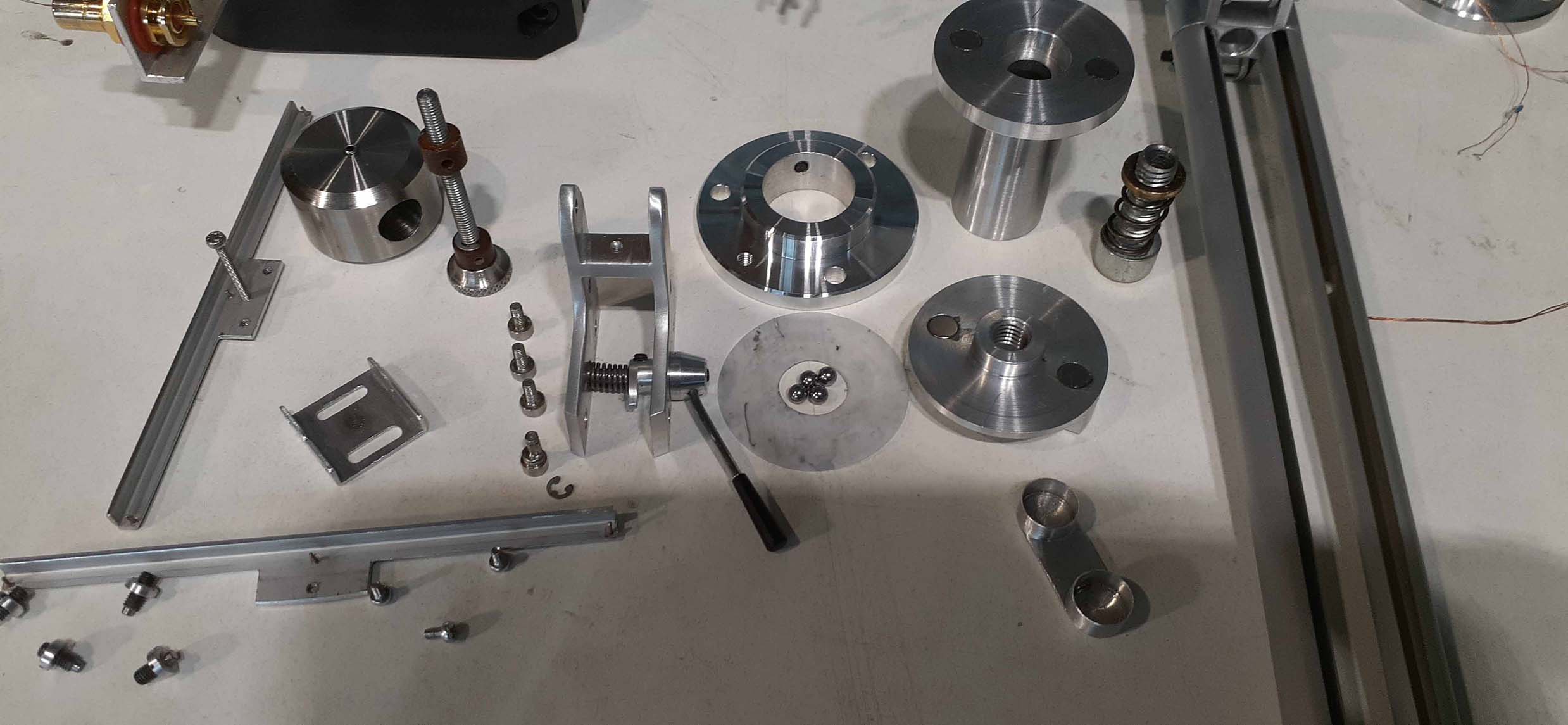

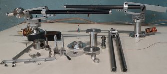

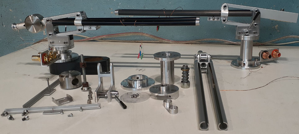

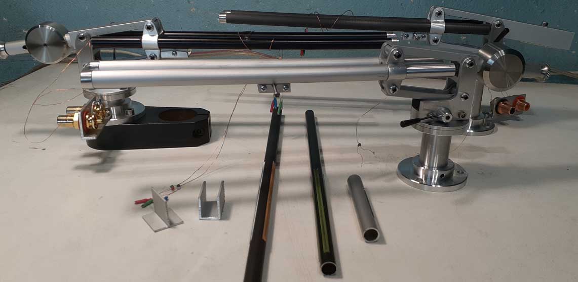

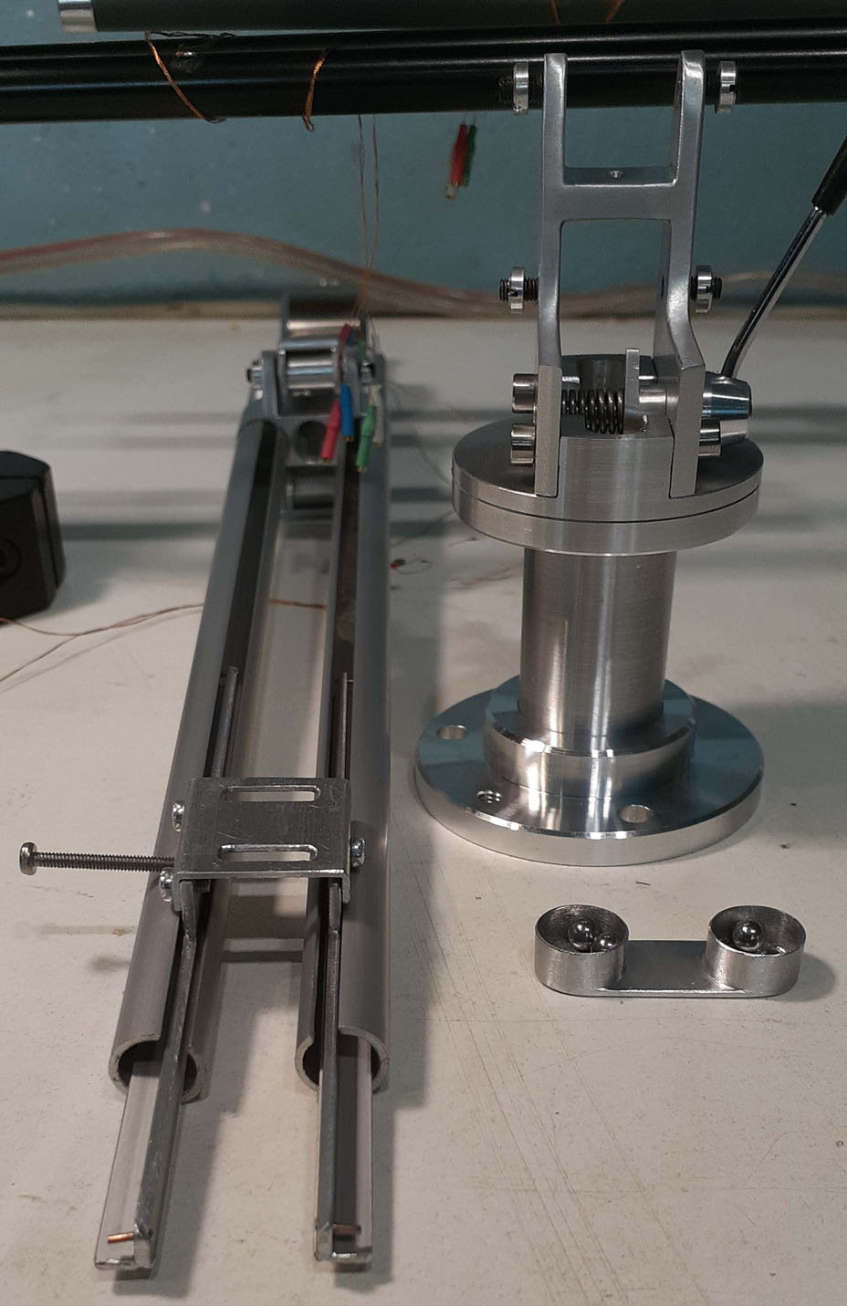

I'm using steel 6x2x2,2mm bearings, cleaned of oil by kerosene, and breakin-in using electric motor
before installing. All three tonearms are working very well in vertical plane, not depending of difference in
vertical masses.
For tubes I'm using crossbow arrow shafts, made of both duralumiium and carbon, they are light and well
made. For heavy tonearm (used with low compliance cartridges and substancial tracking weight) goes
regular aluminum tube from DIY-ers store.
First picture shows metal profiles, used for tonearm.
For the purpose of using larger balls, slots are somewhat turned, and r-shape inserts are used, rear one
installed on hinge.
While using two tubes it is easier to get stability and minimal play.
All three versions are working well, both mechanically and sonically. Owners really enjoy them all.
Lil Casey is very compact, user friendly, and allowing installation on almost any turntable.
Hi Mike,
You have done an excellent job designing and building the arm.
My input would be to measure the arm.
1. Check VTF at 3 stylus heights and 4 positions across the LP. What you're looking for is consistent VTF as the stylus raises and lowers across the LP
2. Spectrum analysis of a sweep to see if there are any artifacts and where they are in the frequency band. This will highlight resonance behavior.
Also maybe try G3 or5 ceramic balls.

Hi Mike,
This is a long thread but have a read through the first few pages.
Howto - Distortion Measurements with REW
I use a Focusrite Solo with REW as an audio spectrum analyser. Virtins Technology tested the Solo and it performed extremely well. I was going to buy an Agilent Dynamic Signal Analyser until I stumbled on this. It's cheap and it works especially well for comparison measurements (before and after). I have never tested its absolute accuracy.
It would be worth investing in a digital scale. I found with my LTA VTF was varying with stylus height and the carriage was not stable as it rode a warp (which almost all LP's have). After some measurements of VTF at different heights I lowered the COM of the carriage which made a significant improvement in sound, mostly fine detail.
Before and after measurements showed reduced sidebands in a 1kHz fundamental tone, this proved carriage stability was causing frequency modulation of the signal.

Hi Eduard
Thanks for the clarification on your Lil Casey - interesting developments
The idea of ​​bearing break-in is very useful - I had used 5x2 bearings on the first one, but maybe they weren't good enough; using pentips on the Carbon and Prism versions improved both friction and sound, but complicated their construction
Again on the first LC, not finding arrows of diameter > 10, I had turned an Ergal tube down to 0,4 mm; but then, once cutted the groove, it resonated horribly - the material of the arrows is much better even than the Avional.
Also interesting is the retraction of the parallelogram attachment to the base, which allows the carriage to be extended by a couple of cm.
I don't like the double rail, but to do without it with the Prism version took me certainly a bigger constructive commitment.
