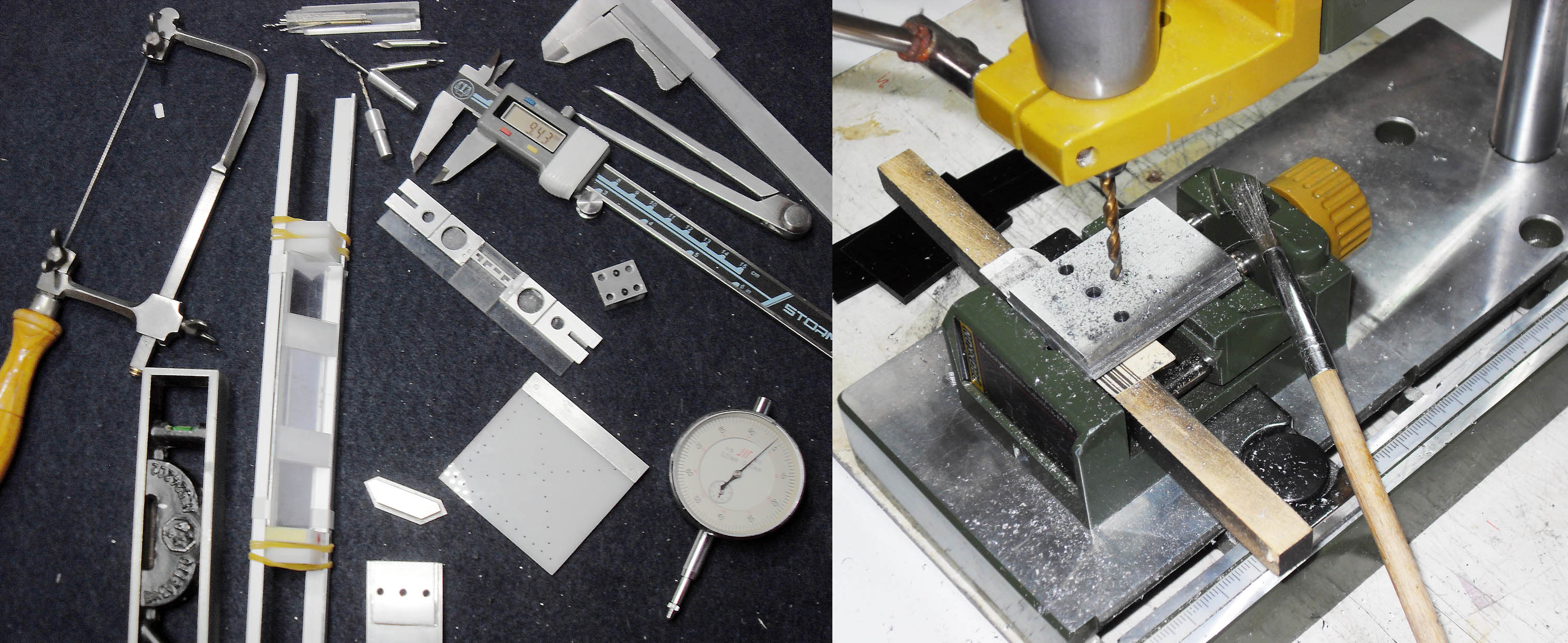

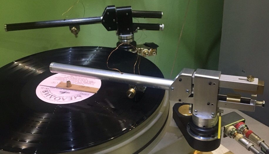

Mike,
I’ve made and tested three maquettes and four tonearms to order. Two of them were already given to the customers, and the other two are headed for testing.
Interestingly, the change to the sound is minimum, and, after listening to LC, the customers do not want to go back to their previous tonearms.

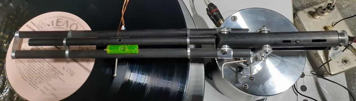

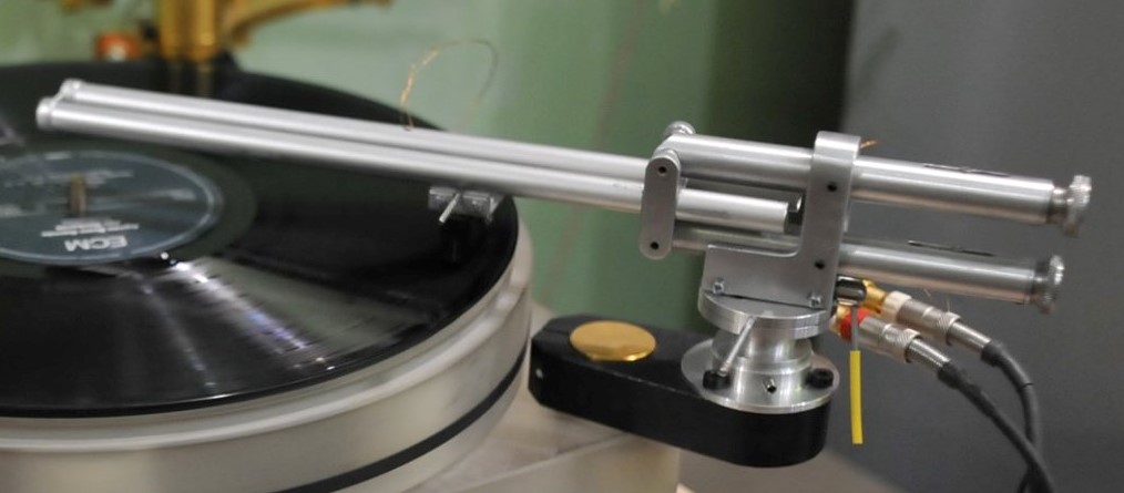

Mike,
Great looking work Edouard, congrats.
Beautiful work and happy customers = success!
Please keep us all updated with your new work as well
mike

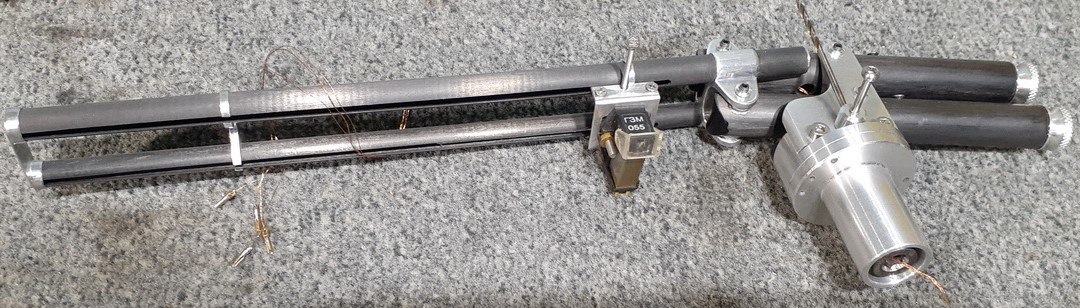

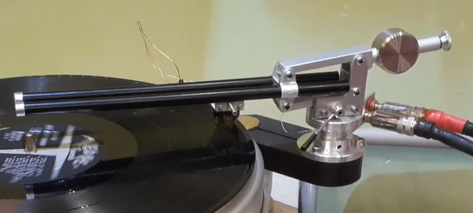

Carlo & Mike,
I had to redo the heavy version, since the pipe from a shop was not anodized inside, and the carriage did not move very well. I bought an arrow and made an elongated version out of it. Now I can replace 10” tonearm without drilling a new hole.

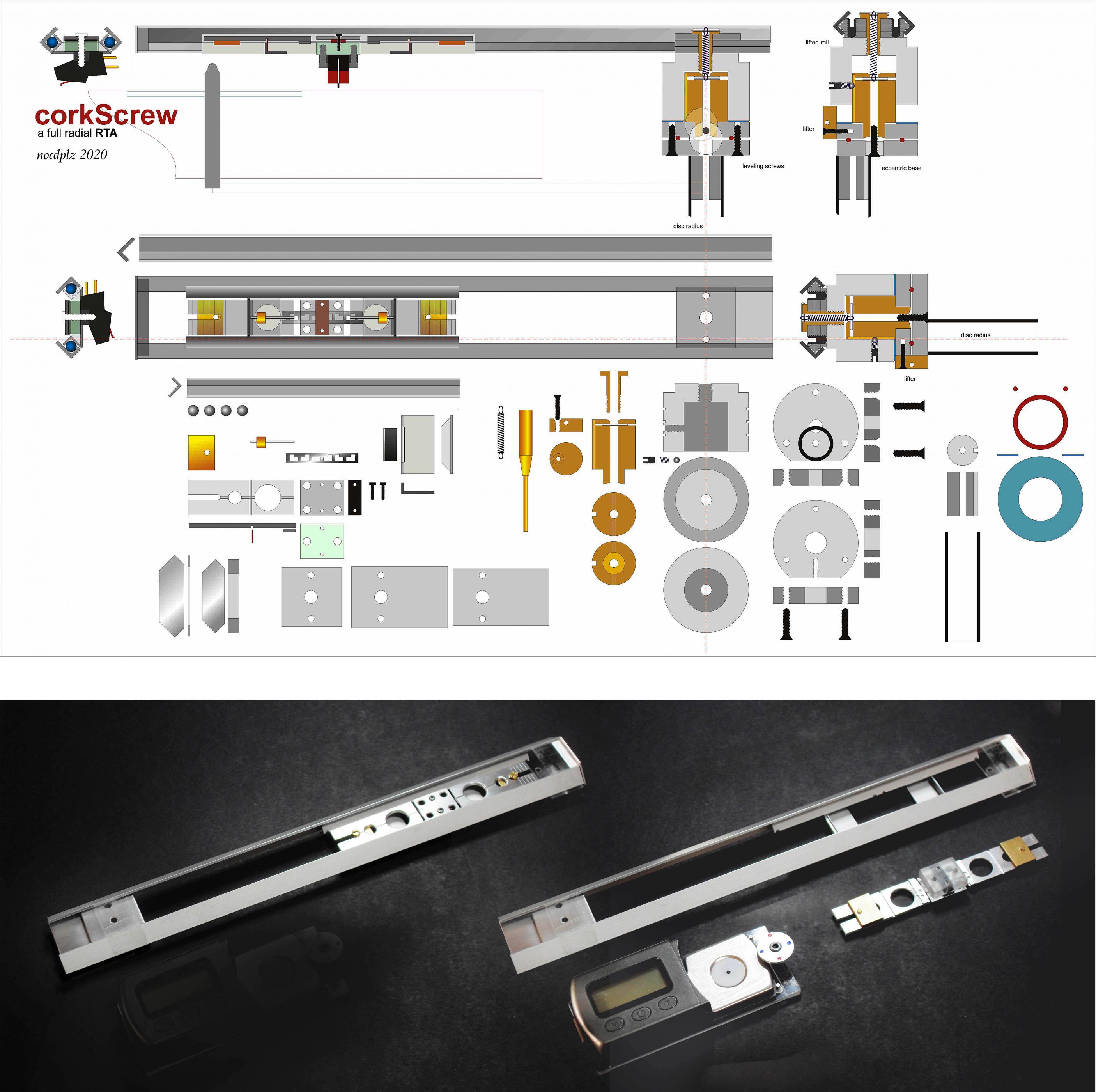

corkScrew RTA
This is what I am lazily building, together with many doubts. The new cart works very well, the corkscrew articulation seems promising (went back to disposable razor blade hinge), but i will have to check it on a disk to say something real. (measures + behavior).
So a complex construction of a - leveling + rotating + lifting base - is now in progress. As can be easily understood, not exactly for first timers*, not as much for the number of parts as for the required precision (carriage and vert. articulation)

What would prevent the cartridge from tilting (one hinge goes up, the other down)? alighiszem
Perhaps the fact that there is only one hinge and the headshell hangs under its arching on warp's pushing; and even the tests done so far with different hinges.
But also I have a ton of doubts since the beginning #3762: that's exactly why I'm building it

I'm afraid you'll see many changes before the end (especially thinking i'll have to make them) the ratio flexibility/verticality of movement on warps is the punctum dolens of the whole.
The variables are:
the razor blade - which I began to modify (<width <thickness); I would like to have 2 very narrow and thin ones.
the length - now reduced to the least for a steady verticality of the movement.
the width of the central "sandwich" attachment, which size influences the two aspects of the said ratio.
Currently the scale measurements say that the elbow-lever that characterizes the corkscrew cart works fine on warps up to 1.5 mm (almost no VTF variation) but after the increase becomes detectable.

Its impressive to have gained almost no VTF variation on 1.5mm warp with this mechanism, can you quantify detectable after that? is it enough to matter on a severe warp?
I feel that this is really angular displacement in the mechanism rather than vertical, so if you can double the levers you already have acceptable VTF variation on 3mm.................
Are you able to photo the cartridge alignment in warp tests and see it it stays vertical always, it may be that azimuth misalignment would be a worse disadvantage than vtf variation. mike

Are you able to photo the cartridge alignment in warp tests and see it it stays vertical always .... Mike
In a couple of weeks, hopefully; a month, or more - who knows. These things can only be properly tested under carefully controlled conditions, not by sensations. It's needed an almost final prototype, and I'm a methodical fellow.
VTF - perhaps less surprising than it seems: this mechanism uses 90% two conventional arms on blades (i.e. with very little friction) while the hinge only intervenes to maintain the alignment. And, as you know, it is springyness that makes VTF vary, not the CW.
Also consider that the "corkscrew" works like an elbow-lever (think of an object attached to a rope stretched horizontally; at first the effort to move it is practically zero but increases exponentially with the angle). Even a lateral displacement would practically irrelevant because the force is almost axial (and in any case the carriage would move)
I have modified the razor blade hinge (narrowed and thinned) so much that what I fear now is that it can tilt with the stylus drag; that's why I said I'll have to use two - but I'll start testing with this one.
