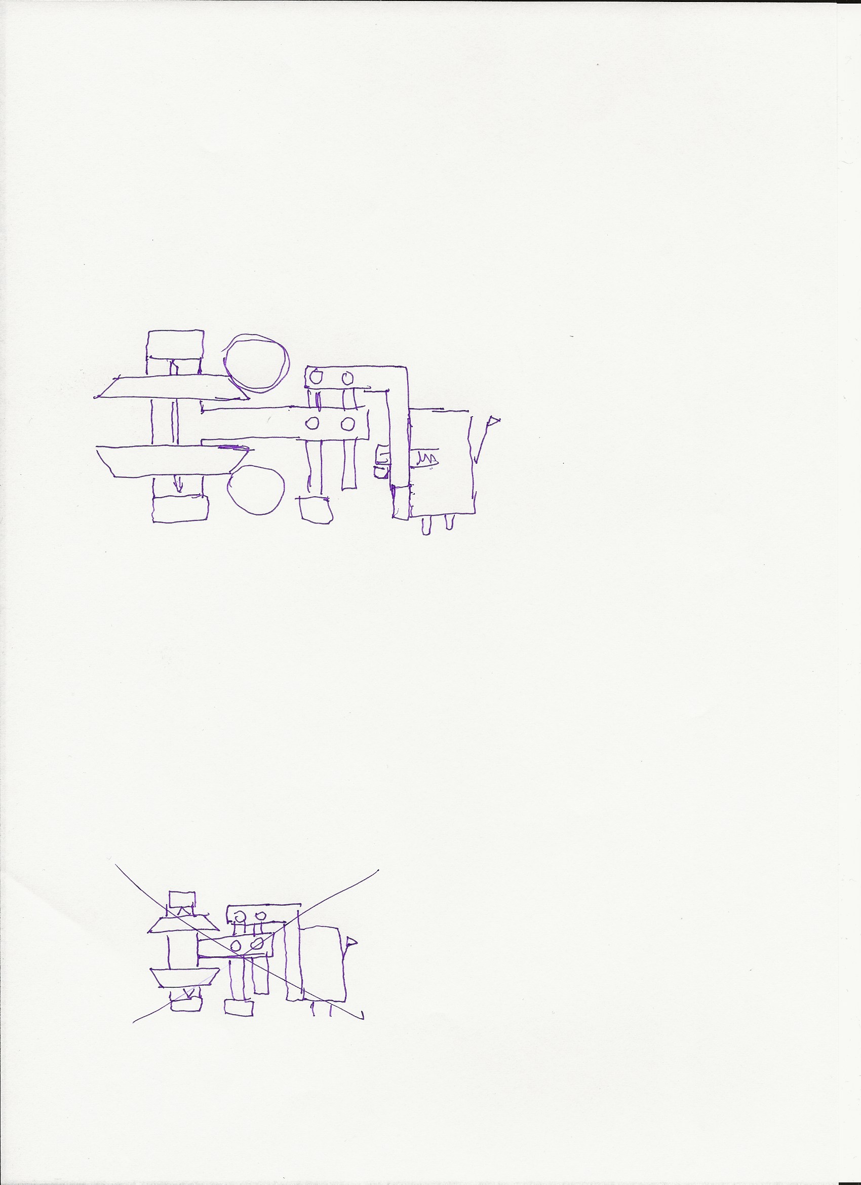

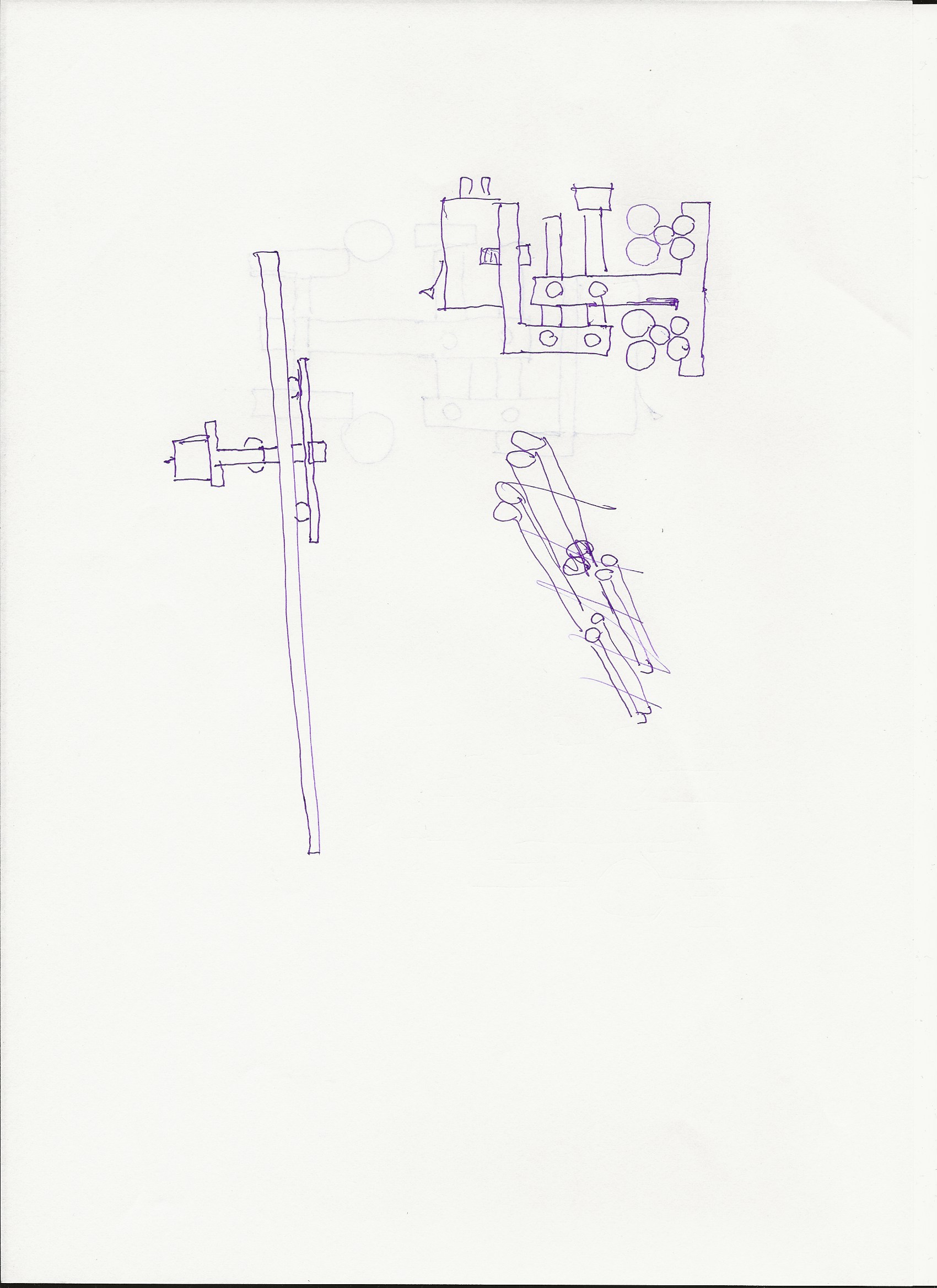

You could even change the direction of the parallelogram like in pic. 1 I think the balance in the hole system will improve.
And instead of the difficult to produce wheel and pin bearings , you could use the suggestion in pic. 2. This straight ball bearing is in fact the basis for the Lil casey rail, described in this thread:
My Linear Tracker (a new variation perhaps?)
By using two rails you avoid the pivoting action of just one rail.

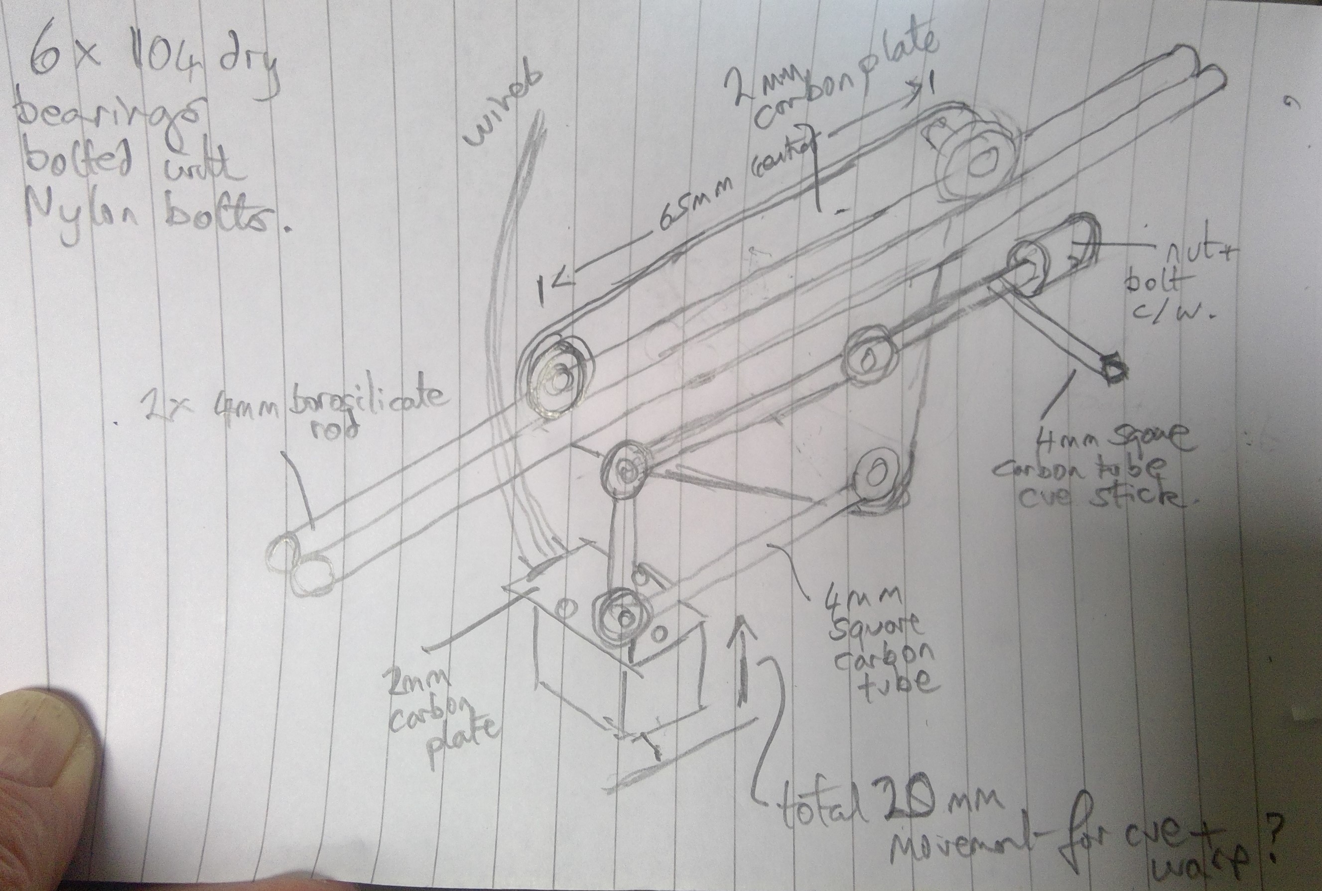

Now i apologise for the sketching, but my "ideas shamelessly borrowed off others" (ISBOO) design currently looks like this attached. Hope its understandable....
Cheap and simple approach but hopefully mostly proven and addressing a good percentage of the important aspects. Cut and glue bits of carbon and bolt on the bearings.
I will do a basic glass tube track and then see how to refine it later.
I haven't done the weights, centres and levers yet, but i think the proportions feel about right?
Please tell me what is obviously wrong with it? - and any suggestions on dimensions much appreciated as well.

Your arguments is exactly the ones I would use to have the parallelogram in line with the GROOVE as it is in my suggestion . Then you have no sideways movement in the groove, as opposed to having the parallelogram in line with the rail.
Another thing is if you use only one rail, you can get a pivoting movement in the rail, whereas if you use two rails there are no pivot action as in carlos and in my models
But two rails is two lots of friction which seems to have been a major problem.

Hi Mike,
The issue I see with this design is you have a double vertical pivot. The carriage can pivot on the rail and the cartridge is attached to a vertical pivot. With 4mm rods you will need 3mm wide bearings to sit them at the correct angle on the rail. 6mm rods require 4mm bearings.
