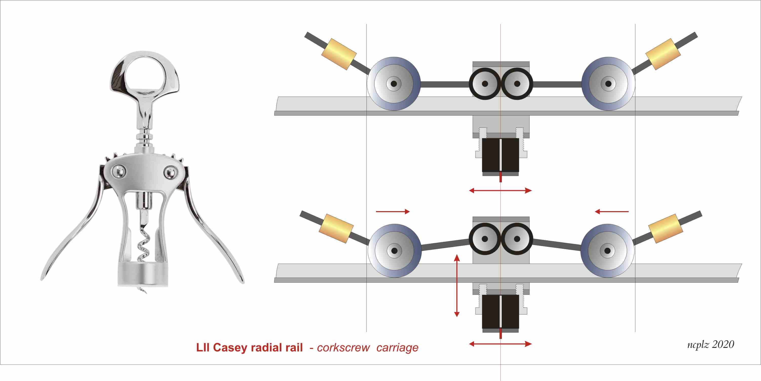

I am slowly building the Lil casey 3 (everything is unnecessarily complicated without a milling machine) and yesterday I was wondering what advantages there should be, since basically I am just changing the rail + carriage to avoid a tilting that is not even on my present version.
To console myself I have uncorked a good Barolo, and these are the consequences.
It's just a joke, but what if it would work? a fixed rail, with all the necessary weight, sophisticated jeweled carriage, to the garbage the parallelogram and all those damn complications.
But how great will be the friction of the 2 counteracting pulleys?

thanks for your words, Mike.
the two counter rotating pulleys are used to prevent rotation, with a vertical movement as in the corkscrew.
Now I'm wondering if a simple adjustable central spring, instead of the 2 CW, could be enough to avoid the pulleys.
But since there is no relative motion between the two pulleys, the friction should not be terrific - it will take me a coffee
addendum - of course to maintain horizontality the wheels are used in pairs, but with the same number of jewels

It's still just a joke, more a corkscrew than a LTA carriage.
It must travel on a horizontal plane, so with paired wheels with outer bearings, like a train.

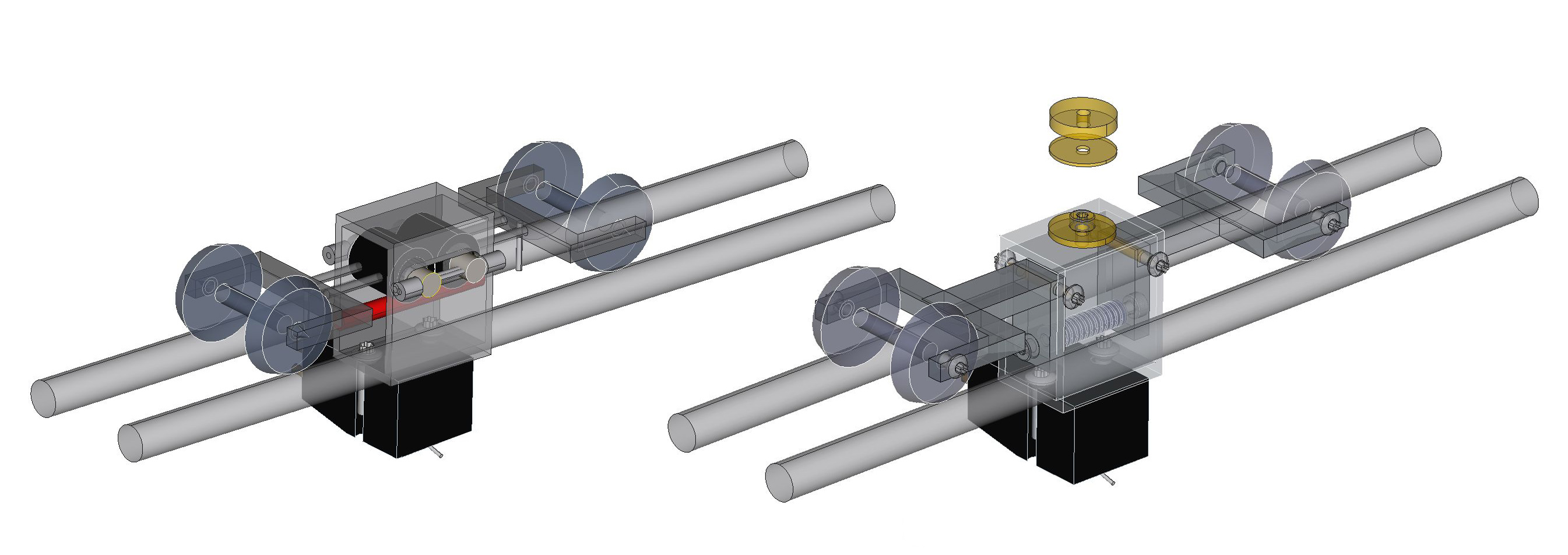

Carlo, questions if i may!
Could you please explain the red rod?
Do you now prefer bevel wheels to your linear ball bearing aproach?
I see the friction wheels keeping things aligned vertically in V1, but how does the spring do that?
Mike
Surely, Mike.
the red cylinder is the central adjustable spring - instead of the 2 CWs - i've talked previously. There are tons of problems, maybe insurmountable, as you can understand from those two sketches (a pencil is enough for me too, but for the others I try to be clear as possible, sometime without success).
So no preferences, certainly not for a strange hypothesis vs an arm more or less working.
However, if you are thinking to build the best arm in the world at home, don't rely on me.
I like just experimenting every kind of TAs, with very conventional ideas about the qualities to achieve. A good advice to follow is to start with an Altmann or a Nanook 219 (it takes just a WE), and then a blind test, compared to your preferred one. Very useful
ciao carlo

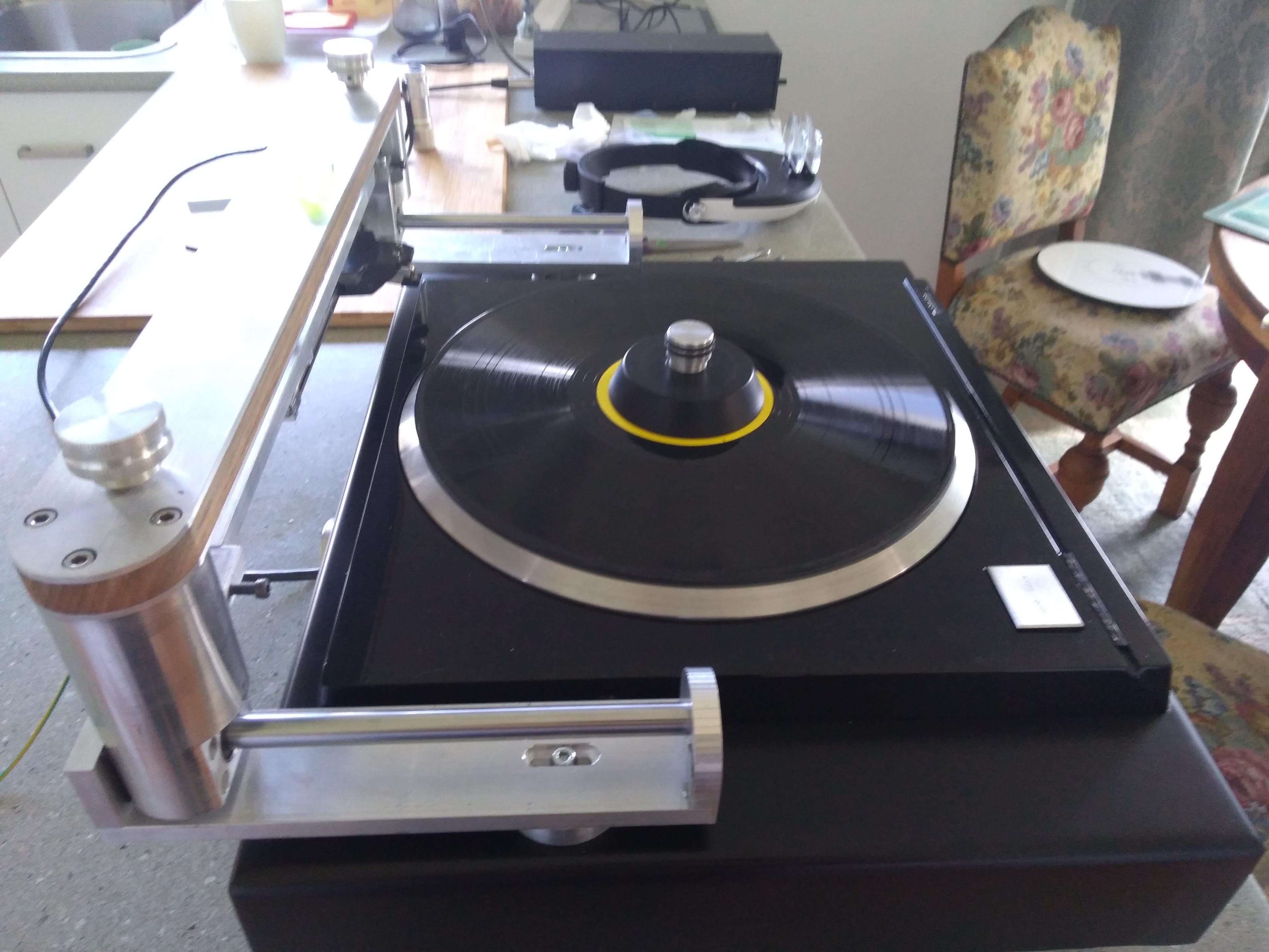

Spent the last week rebuilding the LTA and replacing the BOCA bearings with pin bearing wheels. I also extended the bridge rail 50mm beyond the rear of the plinth to make changing LP's easier and now I can remove the platter without having to remove the rail.
It still was not happy with the Stanton so I installed the Technics EPC205 which has a compliance similar to the Ortofon 2M Black. This combination seems happy to track an extremely warped LP. With the Stanton installed I could hear the distortion in each channel as the CL waggled back and forth.
The EPC205 sound amazing in this arm. Quiet passages are eerily silent. If I were to sum this up in a few words - Dynamic, Clarity, Detail and it sucks you into the music..........I love it

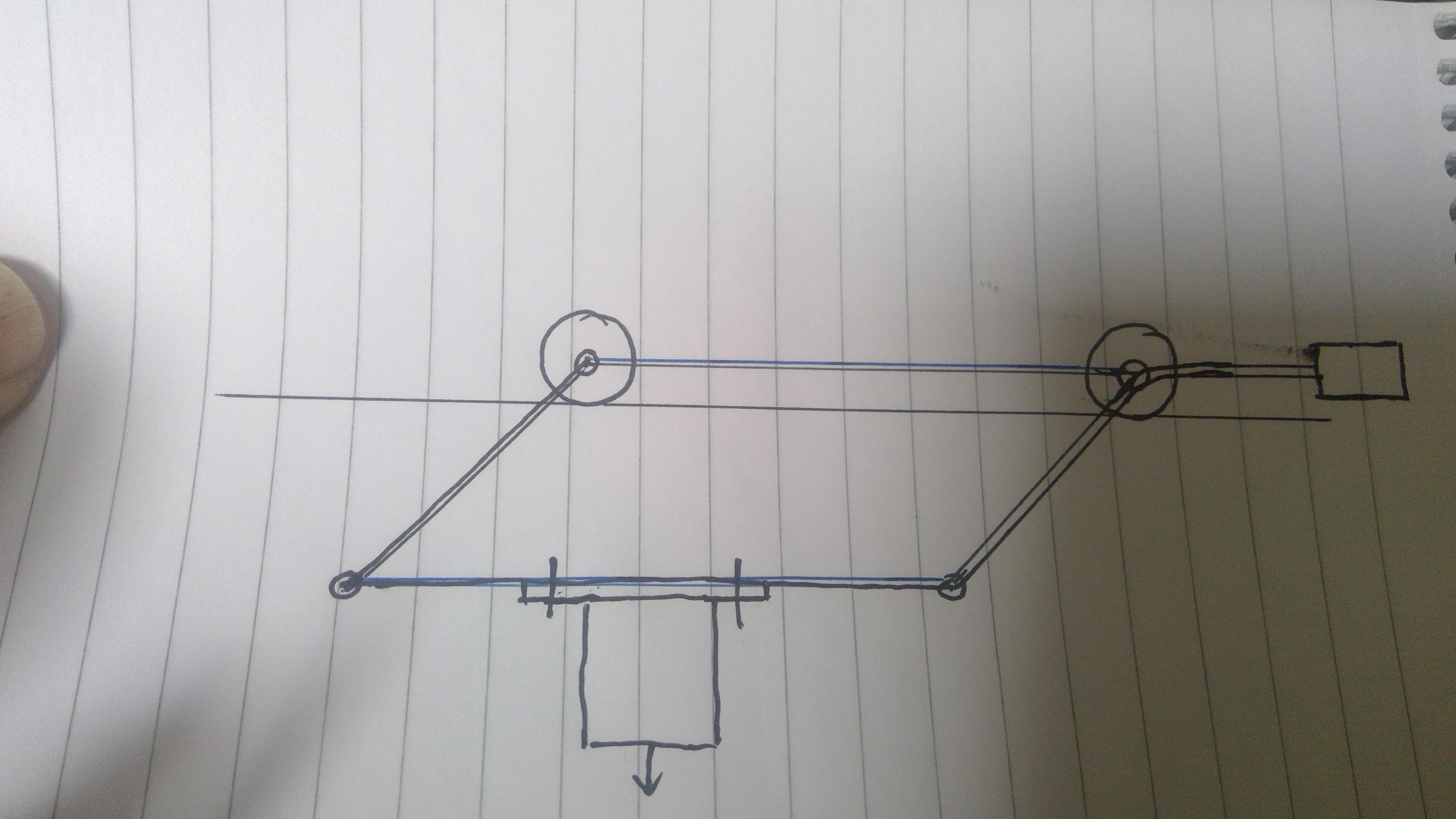

Or perhaps without springs, lightweight parallelogram on the vestigial carriage?? - apologies for poor quality of scribble attached...........i have obviously ignored lots because i don't have the knowledge and experience but it would satisfy all the criteria i have noted so far including stylus in line with carriage "wheels"
I see what you are getting at. Might be a good solution. But you get a side thrust on the cantilever every time you are dealing with a warp. That could cause problems.

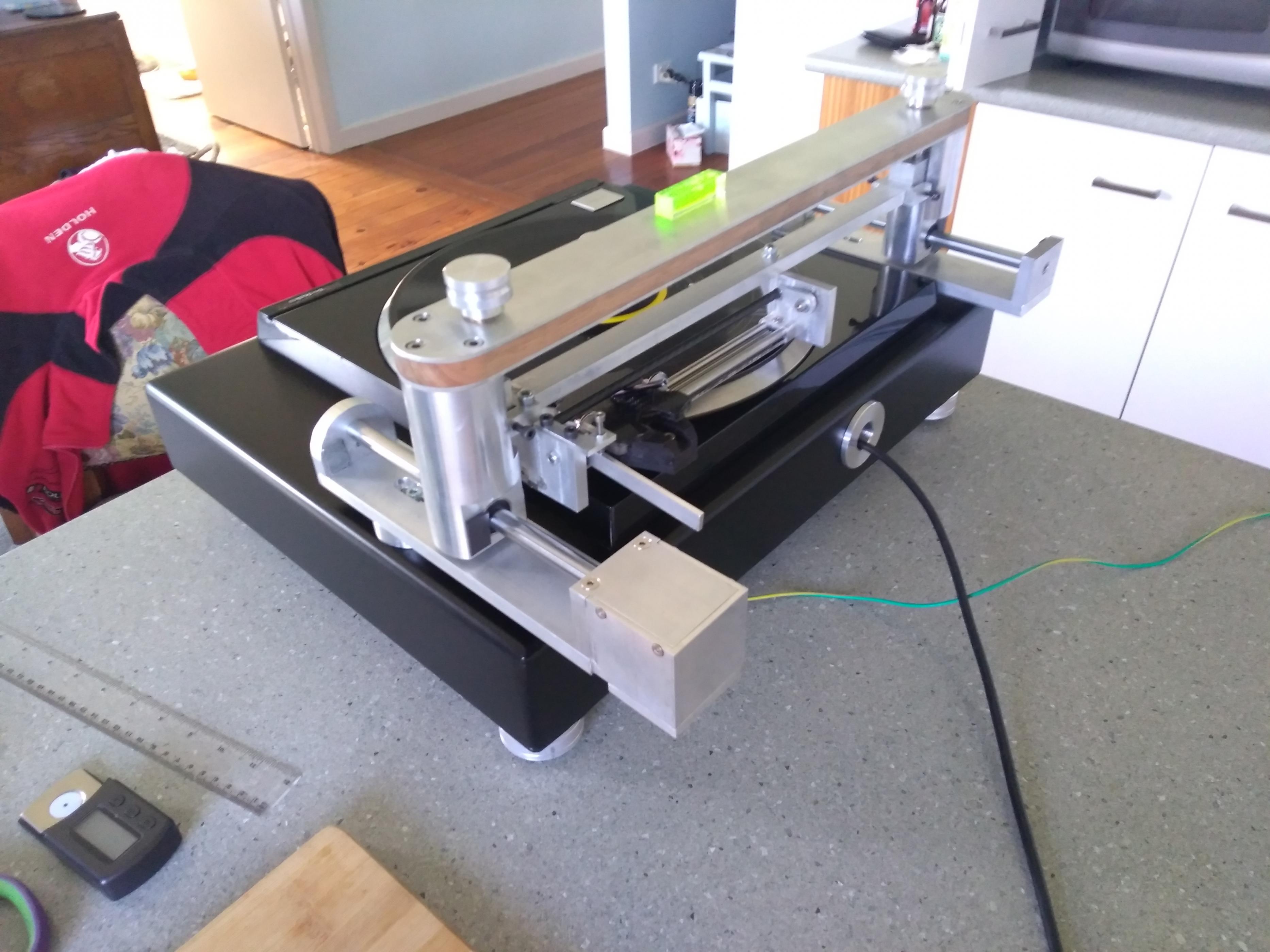

The YouTube photos are great.
In all cases, your disc and TT are not concentric. To my eyes, the arm seems to be overshooting the groove centerline. I also can't tell if the overshoot is symmetric.
Exotic styli generally improve the groove fit in the tracing part, but the arm overshoot is a tougher task. Cart compliance and resonance damping are particularly difficult to match when separate components are used.
Some similar comments apply for vertical tracking/tracing.
All I can do is ask if you see the above overshoot. The questions, then, are (1) can you hear the difference, and if so (2) does it matter? Your personal assessment seems to be "yes" for both, but then it's hard to criticize your own child objectively.
