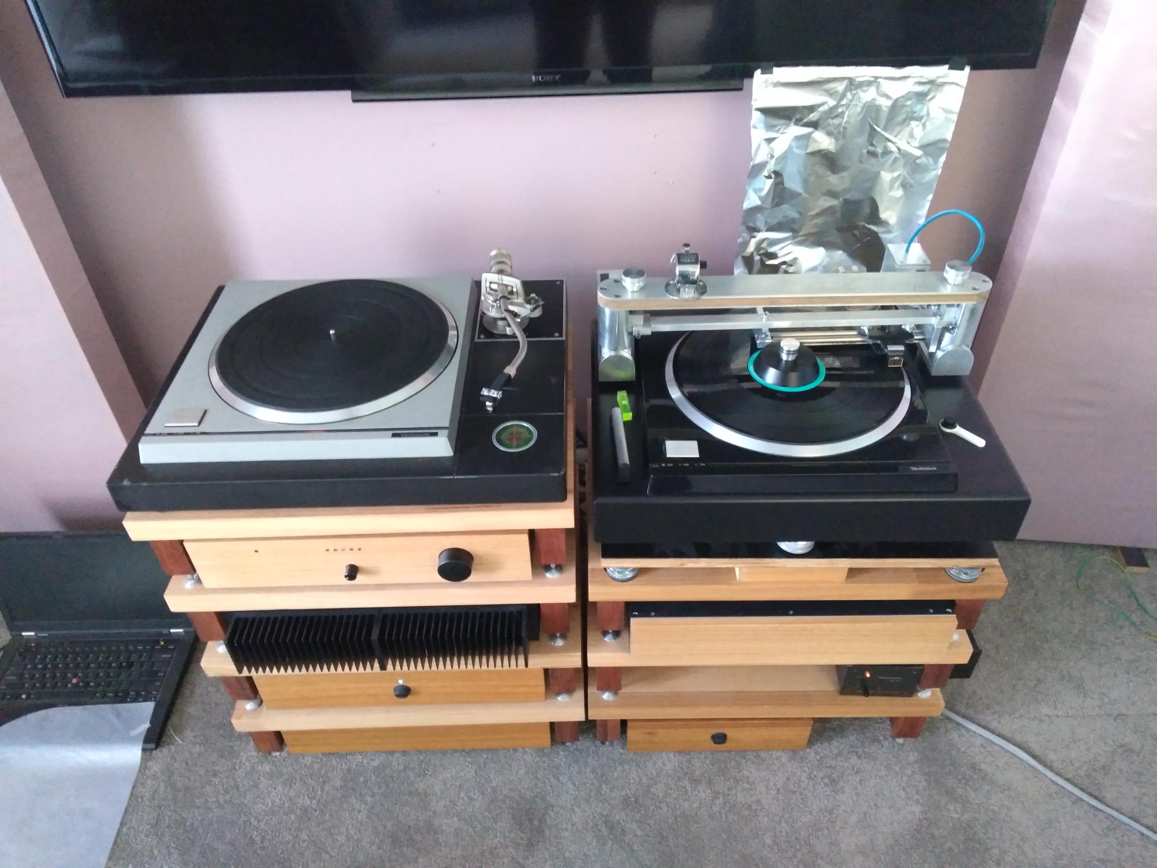

It looks great! - do you feel its reduced friction of the pin bearing wheels that's brought this improvement, or something else? - i really like the idea of hearing eerily silent........so when you cue a track, just a click as the stylus touches down, no discernible hiss/rustle of typical vinyl noise?
Hi Mike,
The reduced starting torque with the pin bearings certainly improved the situation with the Stanton, and I tried it without the brush as a worst case scenario. The 881s is a very high compliance cartridge and needs a light arm.
The EPC205 with the Jico SAS / Boron CL is a great cartridge. In fact the ECP205mk3 has one of the lightest moving masses of any cartridge published and is lighter than most MC's.
There is still stylus in groove noise in the lead in/out and in between tracks but it is very much attenuated over my pivoting arm. What is almost totally missing are clicks/pops and noise in quiet music passages.
The YouTube photos are great.
In all cases, your disc and TT are not concentric. To my eyes, the arm seems to be overshooting the groove centerline. I also can't tell if the overshoot is symmetric.
All I can do is ask if you see the above overshoot. The questions, then, are (1) can you hear the difference, and if so (2) does it matter? Your personal assessment seems to be "yes" for both, but then it's hard to criticize your own child objectively.
Hi Andy,
The LP playing is an old kids LP I elongated the hole significantly to make a torture test. Yes there is overshoot as the CL is still wobbling slightly, any tonearm cartridge will over shoot on an off centre pressing even the best, this is physics at work. The more mass moving the longer it takes to change direction. In a low compliance MC you just might not see it because of the stiff suspension but stylus to groove wall pressure will change.
First I was not listening to this LP as this was a visual test.
Yes I can hear the difference. My reference arm is a Technics EPA100 known for it's ruby bearings and on of the lowest starting torques of any tonearm. This LTA now significantly out performs the EPA100 on my worst off centre pressing Neil Diamond Stones.
Not quite sure what you mean in 2 so I'll just ramble. I am my own worst critic, this is why I spent time rebuilding the arm. Also any tonearm is a compromise and it comes down to what compromises you desire to make. In this case I think what Niffy said about the lack of bending modes in the extremely rigid carriage more than offset the better off centre tracking in a longer arm.

Warrjon,
Thanks for your reply. You answered most of my questions, in a different order. I have some clarifications.
1) It was obvious from your first photo that it was a sort of worst-case, but the other two were not. Therefore, I asked if you could see the overshoot there, and could you hear it, and whether it deserved further effort to eliminate it.
2) There are many visual errors that you can dismiss because they don't sound worse (e.g. they reduce separation, or only show up in the absence of a spindle clamp), so I asked if these were "don't-care", my term for them.
3) Critiquing your own arm is hard. Several contributors since have asked for the opinions of others on various topics.
4) This is never settled, whether we use test records, 'scope traces etc. because we, our ears, our systems, rooms, preferred music etc are all different. I just wanted your take on how you finally determine something is better, since your posts reflect a different and often superior sensitivity in areas I am interest in.
5) In a similar way, you mention arm bending modes. This is a large topic, since it involves strength of materials (what aluminum type & thickness, round or square) & length. Then their are carbon film tubes, ease of working it (or not), using holes to offset arm weight, and cost/availability. As soon as you mention something, our minds start to evaluate (the price of being human!).
Keep posting!
Thanks, Andy

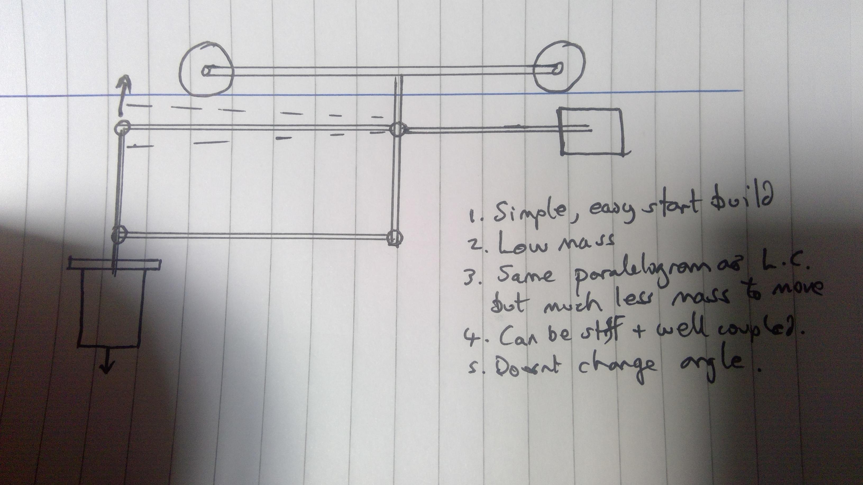

So the parallelogram should have a fixed vertical side on the carriage, and horizontal pivot bars so that vertical movement on the cartridge carrier is tangential and has tiny angles only in a warp movement, i had also originally started with it paralell to the groove tangent but its more complicated to put the stylus in line with the wheels and keep mass very low
A sketch please, I can't follow you
Hi Koldby, that's most probably because its most likely a poor idea, however, herewith my sketch and background notes!
mike
mike
It is actually a Lil Casey parrallelogram you have placed under the sledge. I have had the same thoughts and it could be a solution.

See answers in Blue
All 3 videos used the same off centre LP I answered your question in my last post "Yes there is overshoot as the CL is still wobbling slightly" Can I hear it in another off centre LP Neil Diamond Stones no I can not. The LTA has far less surface noise and greater dynamics than the pivoting arm.
I am not dismissing anything you are making assumptions that I am happy with my LTA and will not develop it further. This is an incorrect assumption. Is this LTA better than my EPA100 on the other SP10 - yes it is in most areas. Certainly it has far lower noise floor, better dynamics and bass response. The EPA100 beats it in imaging.
The EPA100 is an extremely good pivoting arm the Titanium nitride arm wand is extremely stiff and its noise floor is very low for a 10" arm. It also has the lowest starting torque and bearing friction of ANY gimbal bearing tonearm made, so I have very good reference.
Unfortunately I live in a rural area 100's miles from a city so there are few audiophiles around here to come over and listen to my system. So I am left to my own devices. If I built rotary dairies to milk cows I would have no problem getting someone to come over.
I wish there was someone who could come and critique this for me but alas no.
As a fully qualified electronic technician and engineer I have enough objectivity to continue to develop this arm to solve the one major issue I see, and that is carriage inertia which is causing the OVERSHOOT as you call it.
I have loads of test LP's and these are used in the development phase, once I get close then listening is the key. I have a few specific tracks I use to evaluate differences. One is Elvis's Old Shep and the LTA does not do a good job on this track, I can hear distortion in the right channel, which is not there with the EPA100. So I know I have some refinements to do the LTA.
I have no explanation for this as yet because that Elvis LP is not off centre. The worst off centre pressing I have is Neil Diamond Stones and the LTA tracks this and sounds superior to the EPA.
True, material and composite construction has a large effect on this. A good rule of thumb though is the shorter the arm the higher the first bending mode frequency. Speed of sound in the material will effect this, but will be uniform for the same material.
In my research it's the 3rd harmonic that is the worst, so if the main bending mode is above 10kHz then the 3rd is 30kHZ well out of the audio band.
My next upgrade is to add a servo driven main arm which will be rigidly fixed to the carriage so no vertical or horizontal movement in the main arm. this will be mounted to the current bridge so the servo will be over the LP making the main arm short.
Then a mechanical vertical horizontal headshell. Maybe something like a very small version of Carlo's Lil Casey on the end of the main arm.
This is my current setup. Unfortunately I do not have 2 EPC205c cartridges so the EPA has the Stanton 881 mounted.

Has anyone considered a 'scissorlift' type of setup directly under the sled?
That would allow the cartridge to move absolutely vertically, but would be a challenge to build due to the small size and small bearings required.
I sketched that as well, and thought it promising, but it requires something to stop rotation(looking face on at the cartridge), and i thought that more difficult or heavier
