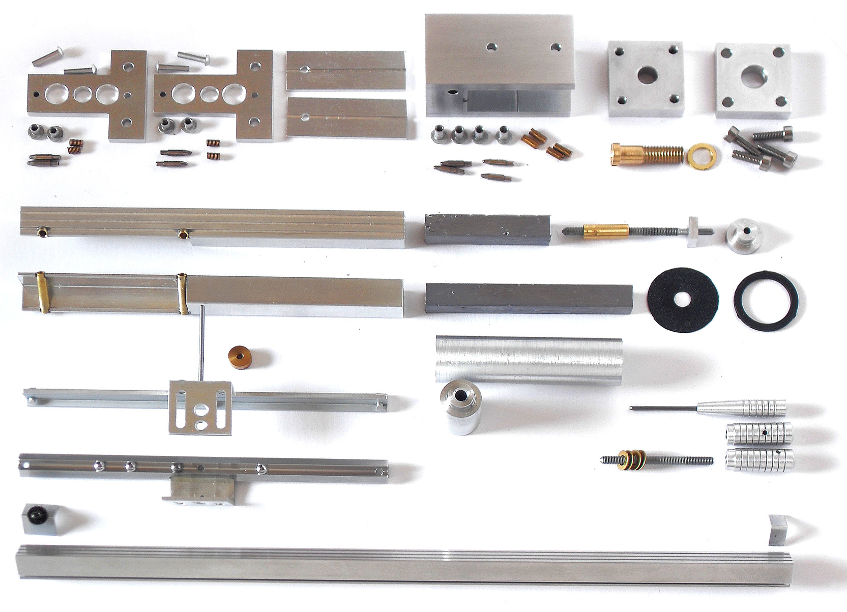

My Linear Tracker (a new variation perhaps?)
By using two rails you avoid the pivoting action of just one rail.

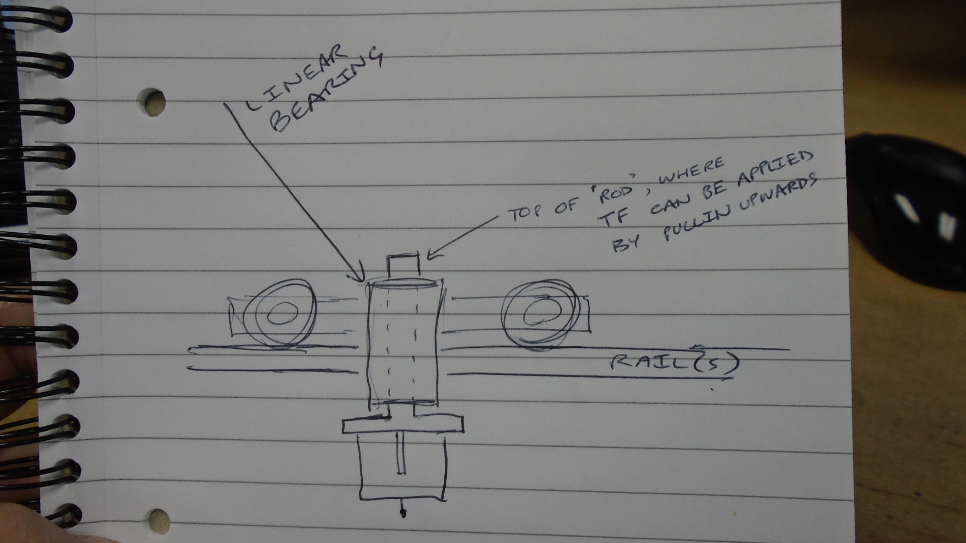

Now looking at miniature linear bearings for vertical movement directly under the rail.
I know they rotate as well, but if the stylus is in front of the rotation point, drag should allow self alignment in the groove should it not? Assuming of course, low horizontal friction)

Hi Apache, i may be misunderstanding the description but one key point i am aiming for is the stylus under the rail centre, and also one has to achieve tracking weight, hence the parallelogram solution, whichever orientation its in.
Maybe scribble a sketch?
With some previous arm designs, I've used fine fishing line to translate from the application point to the counterweight via bearing pulleys. I was anticipating a similar solution here.
The rail layout only shown to show where the linear bearing might sit. To do it as shown would require two rails spaced with enough clearance for the vertical bearing to traverse. Not sure I like that idea. I would possibly sit it just in front of the conventional two wheel rail and put up with any warp wow / use a clamp / not buy warped records.
<edit> D'oh. Obviously it would require a four wheel sled in order that the vertical pivoting of the two wheel design didn't occur.

Miniature linear guides or linear bearings look to be a complicated area to research, but could be very elegant if its achieved........
I ordered one, complete with slider last night after talking to the supplier, who assured me that the seals can be removed easily. I need to devise a way or measuring stiction.
I'm wondering how important that is, because on the two wheel / single track version there is 'stiction' for the want of a better word, in the vertical plane anyway, and this is regarded as a positive feature as it holds the cartridge body still unless upset by significant vertical disturbance.
Anyway, I'll have a play with it and see what, if anything comes of it.
I don't think linear bearings are going to be high performance for the rail. I used 12mm industrial (read better tolerance than eBay units) on the sliding bridge and they have a fair amount of lateral twisting movement available to them. They are noisy when moving the bridge back to change LP's

I'm looking to use one for vertical plane only (see my scrawl on the previous page), with a conventional rail. I've been drafting out some sketches and can see how it might work, and a novel (for me!) way of applying tracking force.
I'll post a retraction when I prove myself wrong 😉

Busy to finish and match this stuff, I missed 10 discussion pages. I didn't think the corkscrew gadget could stimulate so much creativity, I will study all carefully.
Only one tip dictated by experience: keep it simple, friends. We are working on a minefield, friction > 2-3 mN begin to be problematic: little weight, few joints, less bearings (linear ones? no thanks) are the starting point
