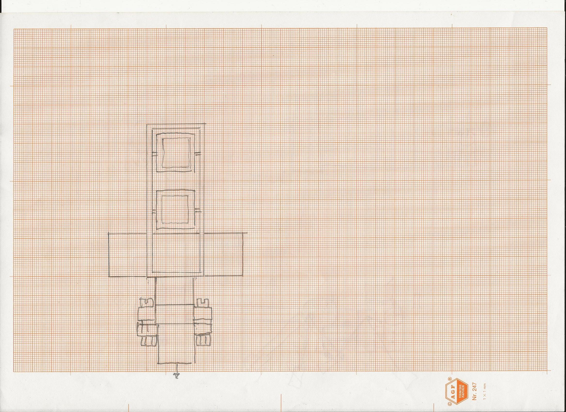

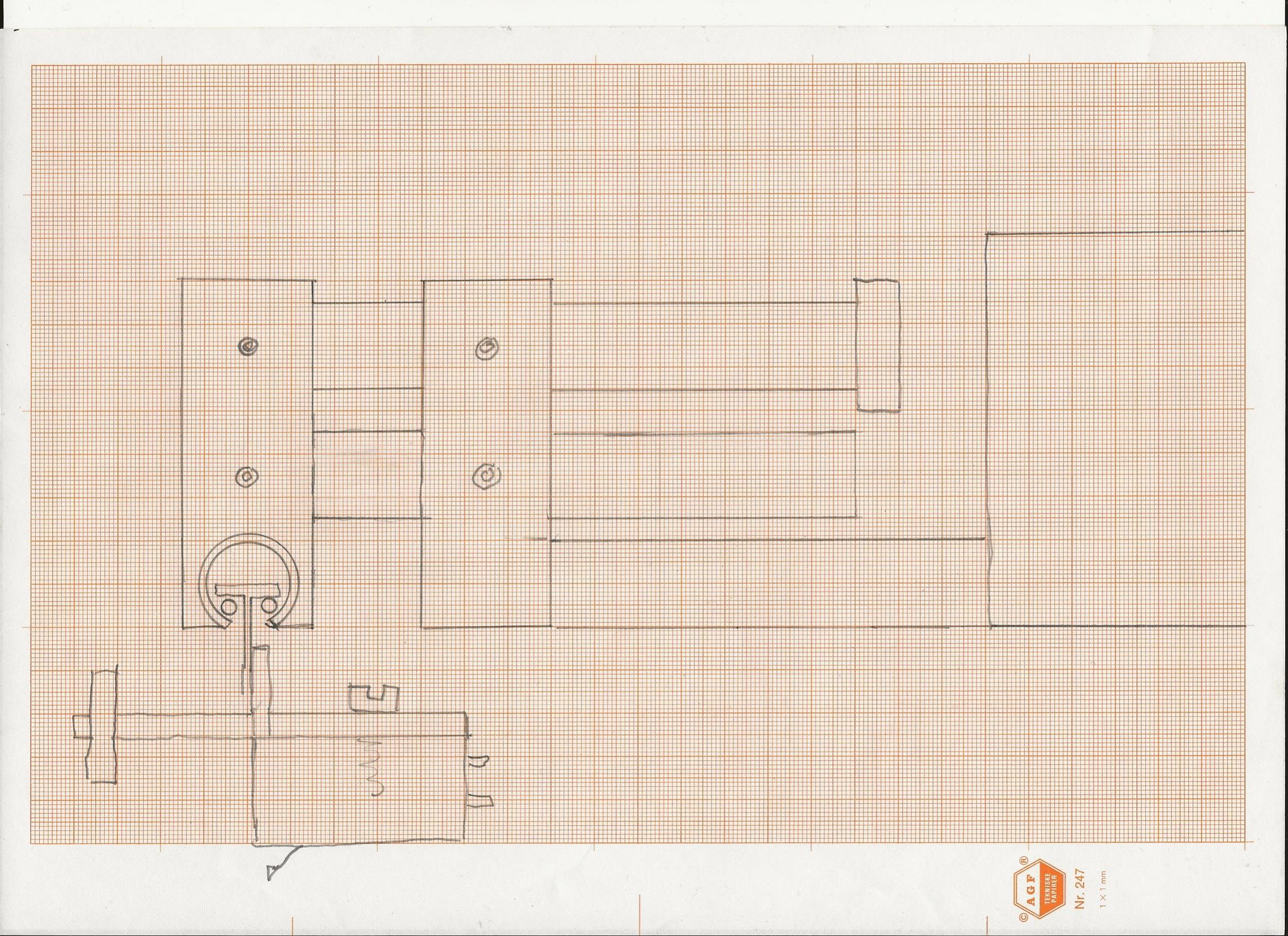

I have now ordered enough bits to make what i scribble/sketched at my previous post, so I will build something like that as a start point soon now.

My "Design"+copying+sketch/scribble will no doubt need to evolve, right now i am following early advice to "build something and see"/get a real life feel for it, but trying to avoid as many wrong turnings as possible.
I perceive each poster has a style of thinking and process, some no doubt much more scientific than mine, but for this question i have a light carriage but with some weight available on the parallelogram to do the balancing/inertia written about.
I will centre the stylus under the rails geometrically and leave the weights a touch forward of that initially and hope the balance is correct. I have a small counterbalance weight on the parallelogram already and will swing this away or closer to the rail in a plane parallel to the platter to achieve balance. i have ordered a selection of light nylon nuts and bolts to allow for such experimentation by unbolting and replacing parts.
Thanks again
Mike

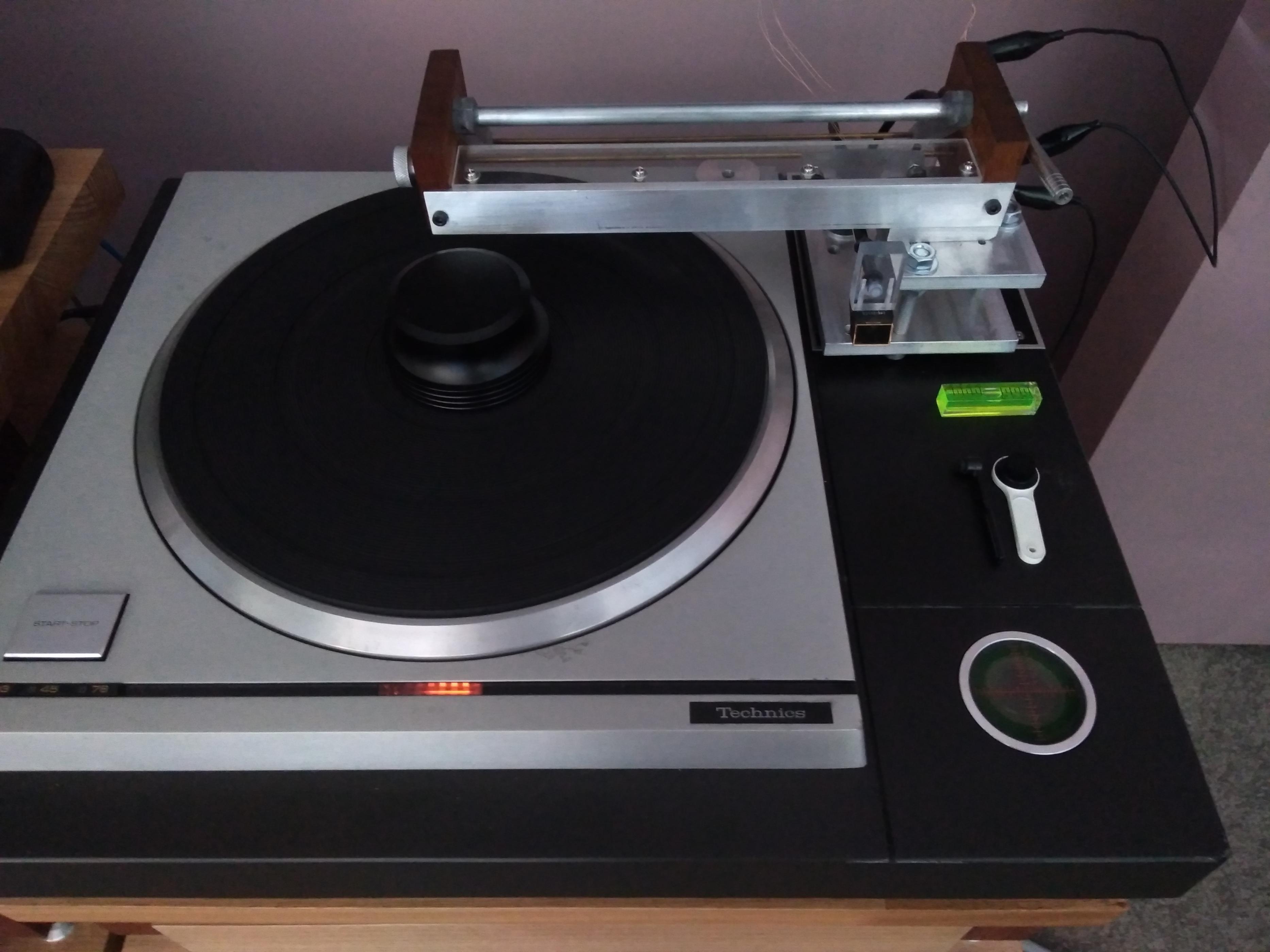

Was playing again today with the LTA. Used the HFN test LP to check tracking and I did not expect to see the stylus skate across the LP on the tracking ability test side 2 band 1, The only way I could get it to track was 2.5g VTF, the reference EPA100 tracked this at the 1.5g which is at the top of the VTF for the ECP205.
I can still hear distortion on heavily modulated tracks and distortion changes channel on off centre pressing, because the arm sounds so good this distortion is very obvious on SOME LP's
Damn this LTA has no right sounding so good.
Plan 1 - Rebuild the original LTA but increase the diameter of the arm wand to 8mm instead of 6mm. Was this LTA just not detailed enough to hear the distortion or was it missing as the carriage is so much lighter?????
Plan 2 - If 1 works build a new lighter carriage for the bridge LTA still using pin bearings. I have some ideas here but will wait for the results of 1 first.

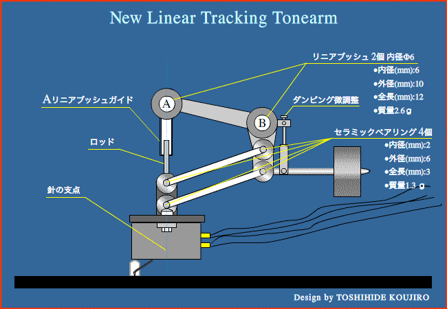

Hi Mike - this topic was previously discussed - Walter (look at #2689) pointed out to me that solution (I doubt ever made ) shortly after the realization of the Lil Casey MK1. My opinion #2695 has not changed substantially. even now that i'm building the third one
carlo
carlo
together with weights, friction has a great importance

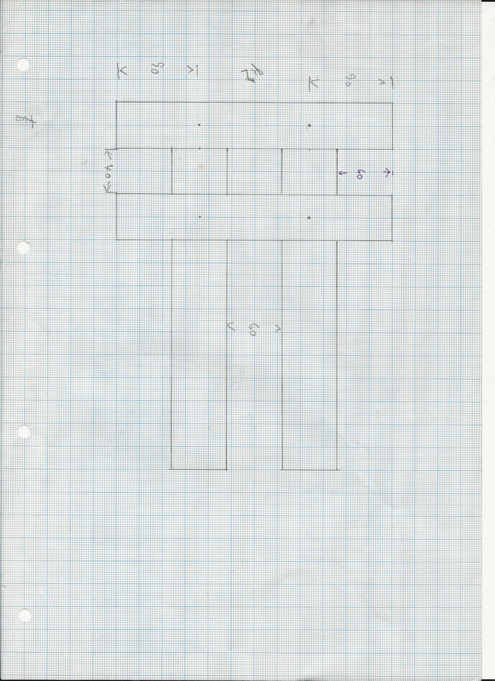

Many thanks Carlo, my sketch so far is very simple, 2 carriage bearings, 4 parallelogram bearings, really, as I've said before, "borrowed" from your ideas and others, i just moved the parallelogram onto the carriage, i will build that over coming weeks and see where it falls on the disaster/success curve! - i am still waiting parts, but cut some carbon just now...........more soon, mike

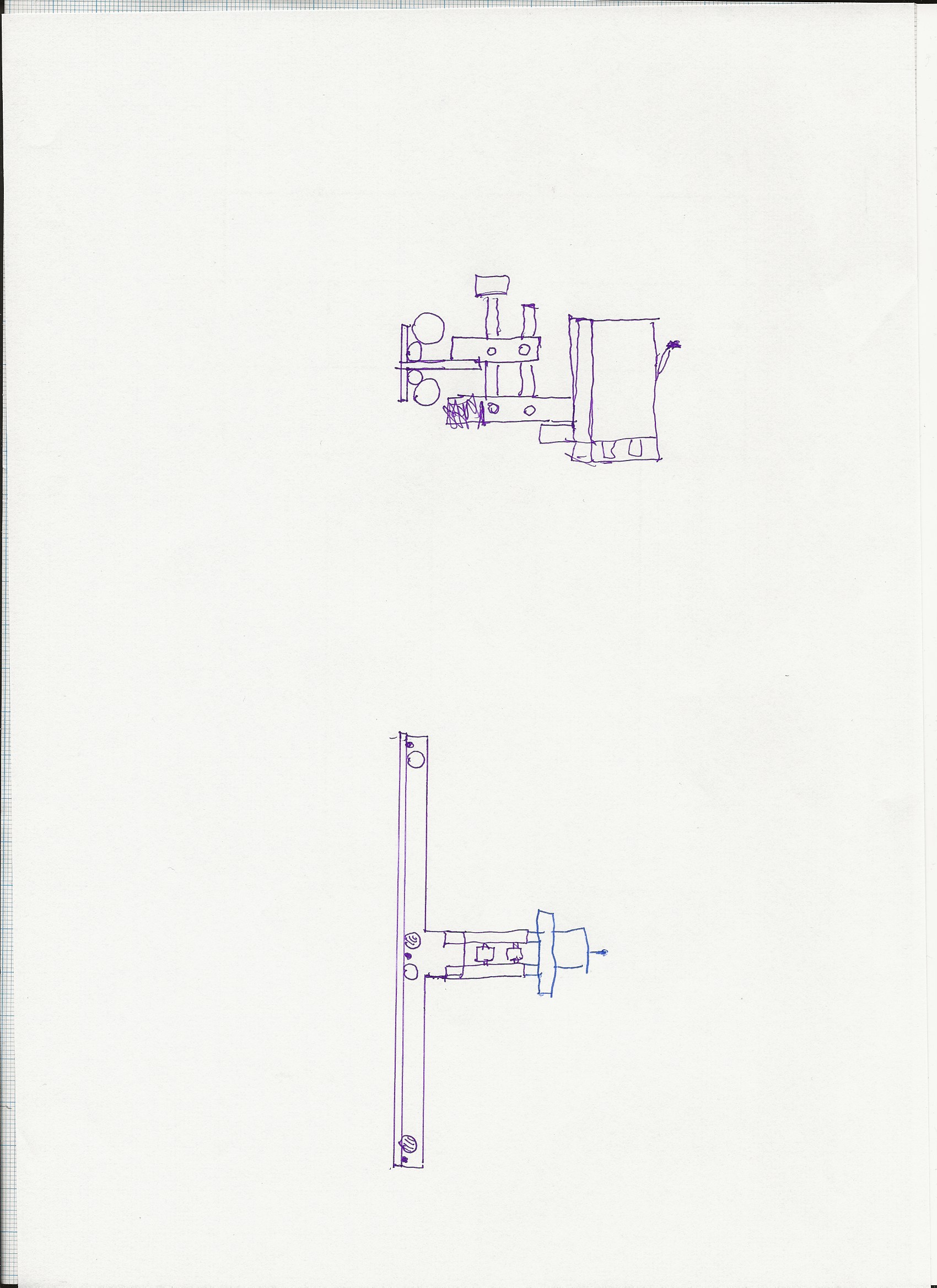

All these interesting ideas gents, for me though as i am building totally with hand tools, so I also need to consider practicality of build, a small hacksaw and abrasives work carbon easily enough so just that and a hand drill have to suffice, some quick epoxy glue or superglue and i will have something built within two weeks to see! mike

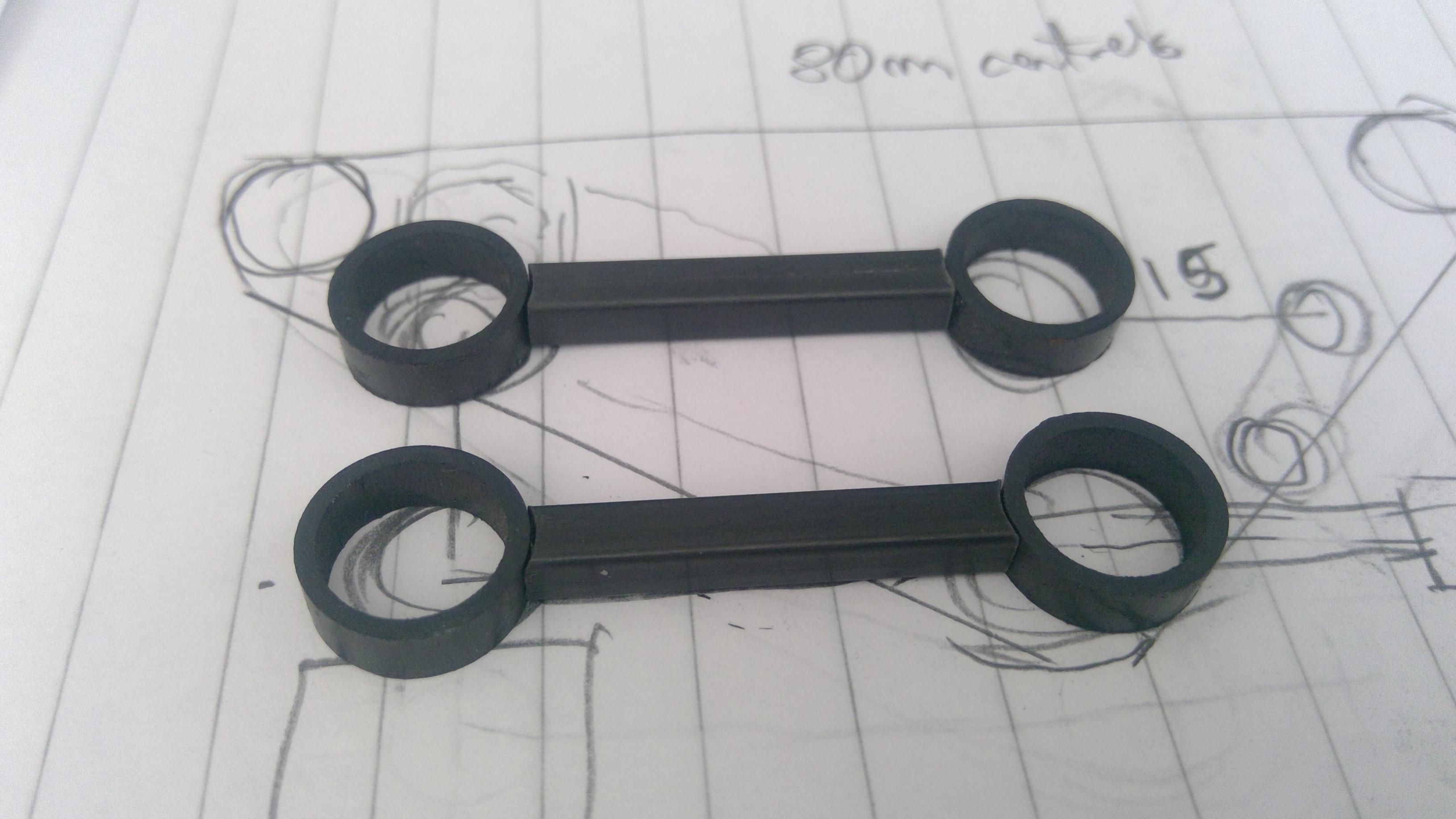

I finally cut some parts just now, these are the first connecting rods of the parallelogram ready to glue up on the jig that carry the 10mm bearings, when they arrive.
Makes me admire even more all your craftsmanship! 10mm I.D. tube sliced off and 4mm square tubes. Should be 3 grams each with the bearings.

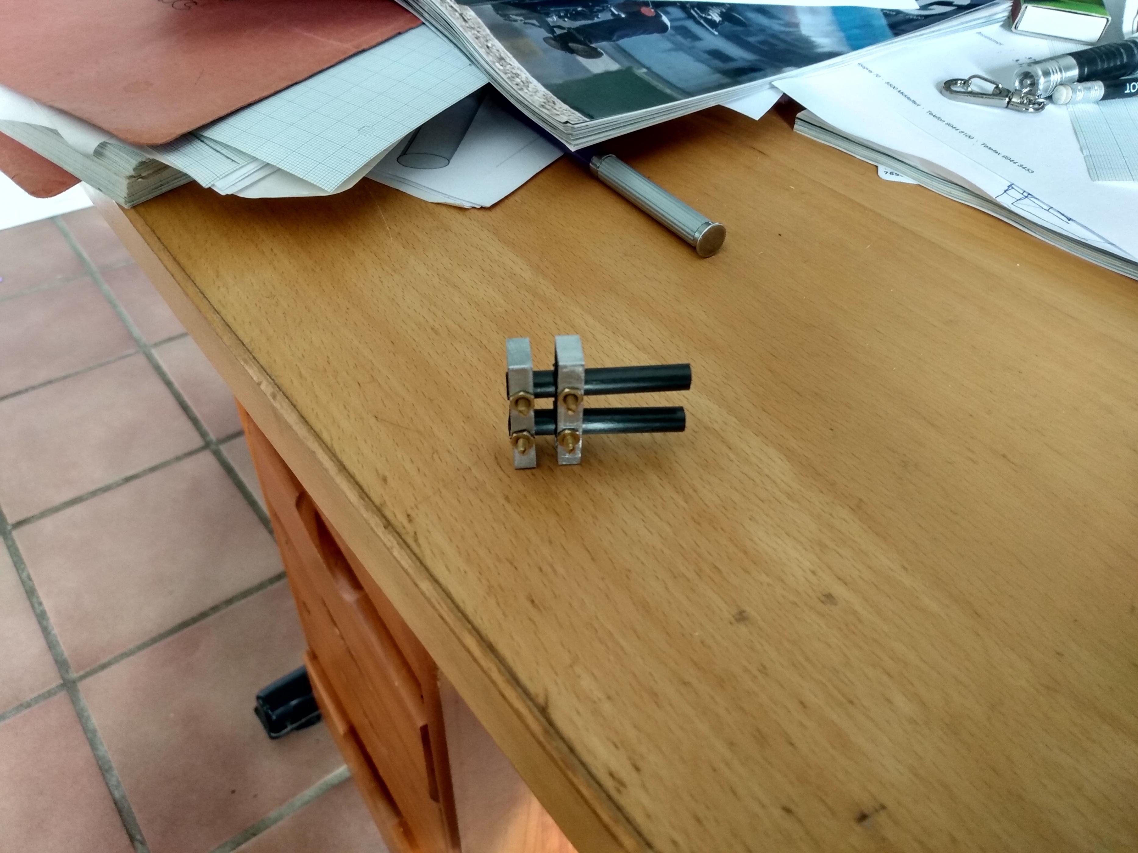

My take on this is two 6 mm carbon rods. The bearings are from some turning coil instruments I had lying around. The pinol screws have a spring loaded seat inside and I made some 1 mm pins from 1 mm drill shafts machined with a point shape that goes through the carbon tubes and into the seats.
Weights less than 5 gr.
I am absolutely not sure , that I have made this with the precision required, but having fun trying...
Dimensions in second pic.
It could be used under the rail, in a passive arm as the third pic, or over the rail as in the two last pics.
In the last example, the supporting structure would be an arm that moved , if the cartridge moved in the short rail.
The last two sketches were made before I actually made the parallelogram, so the dimensions are off.
