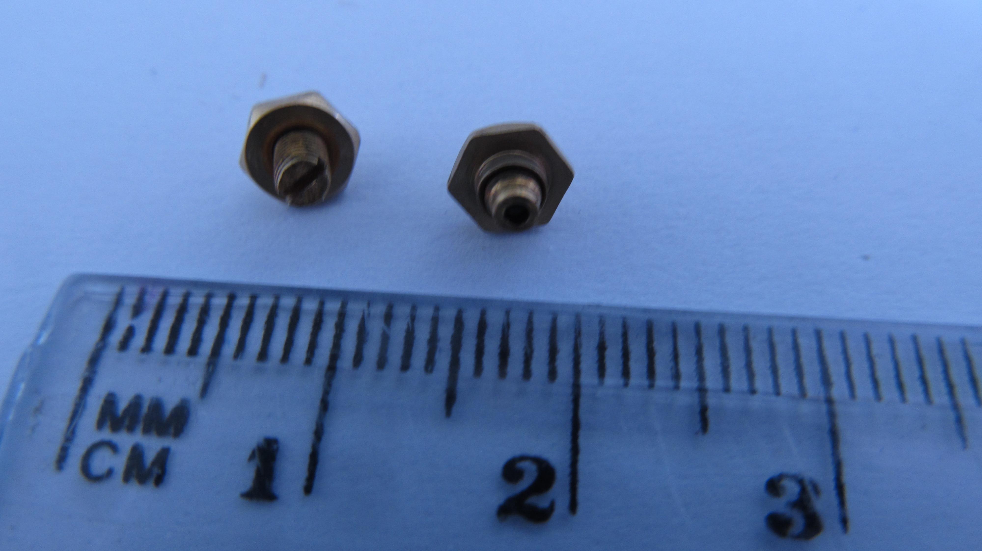

These bearings come from very cheap instruments , like this:
Voltmeter SO-45 AC 0-300V Round Analog Dial Panel Meter Voltmeter Gauge Black | eBay
That sounds like a good idea. Do you have any photographs of the bearing assemblies once removed from the meter movement?
Here are the bearings. I made some ø 1mm pins from 1 mm drill bits and made pin point with a Proxxon drill rotating it and at an angel on a bench grinder.
After that polished it on a fine stone still with the Proxxon

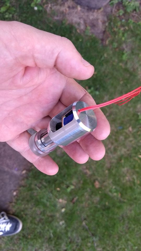

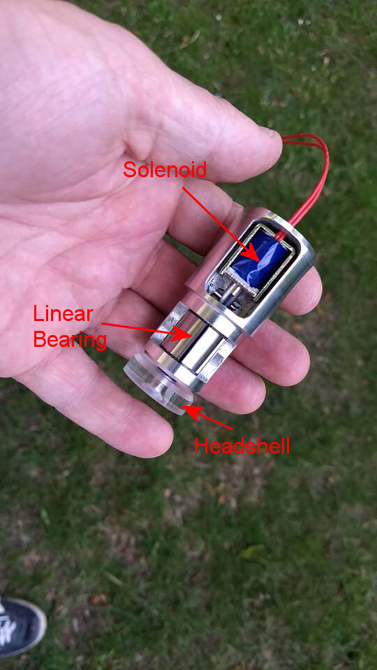

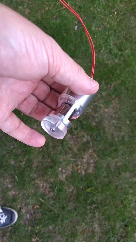

I've been thinking about an electronic way of applying lift / lower, but have got a bit carried away! This is the entire vertical movement part of the arm, using a de-sealed linear bearing, with the rod changed to acrylic so it doesnt carry the mag field to the cartridge. Lift / lower (and possibly tracking force) can be applied by activating the solenoid (probably slugged with a biggish capacitor to avoid rapid ascent and descent.
I'm thinking it may be possibly to apply tracking force by varying the voltage on the solenoid. It's a 6v for 30g pull one, (may not be sufficient but it's what I had around)
I've just put it together as a trial fit (I need to 'loosen' the link between solenoid and acrylic rod as it's a little tight) and just see what range of force I have, and then borrow a gauss meter from work to ensure I don't have too much field at the cartridge position.
Experimental at the moment, but would be neat if it works.

Variable tracking force wont be possible with this type of solenoid, as the amount of pole piece inside the coils varies with the position. Duh, should've spotted this. It will require one with the pole piece passing right through and always being within the coils.

I tried solenoid to do the lift with wireless remote control on my air-bearing arm. However, my application was different from yours. The cartridge picked some noise from the solenoid so I had to give it up although the noise level was very low.
What was the nature of the noise? If using clean DC there shouldn't be any, aside from a potential spike when actuating / deactuating.
I am leaning towards a remote servo to do it now to be honest. After pondering the design today, I'm seeing more and more hurdles.

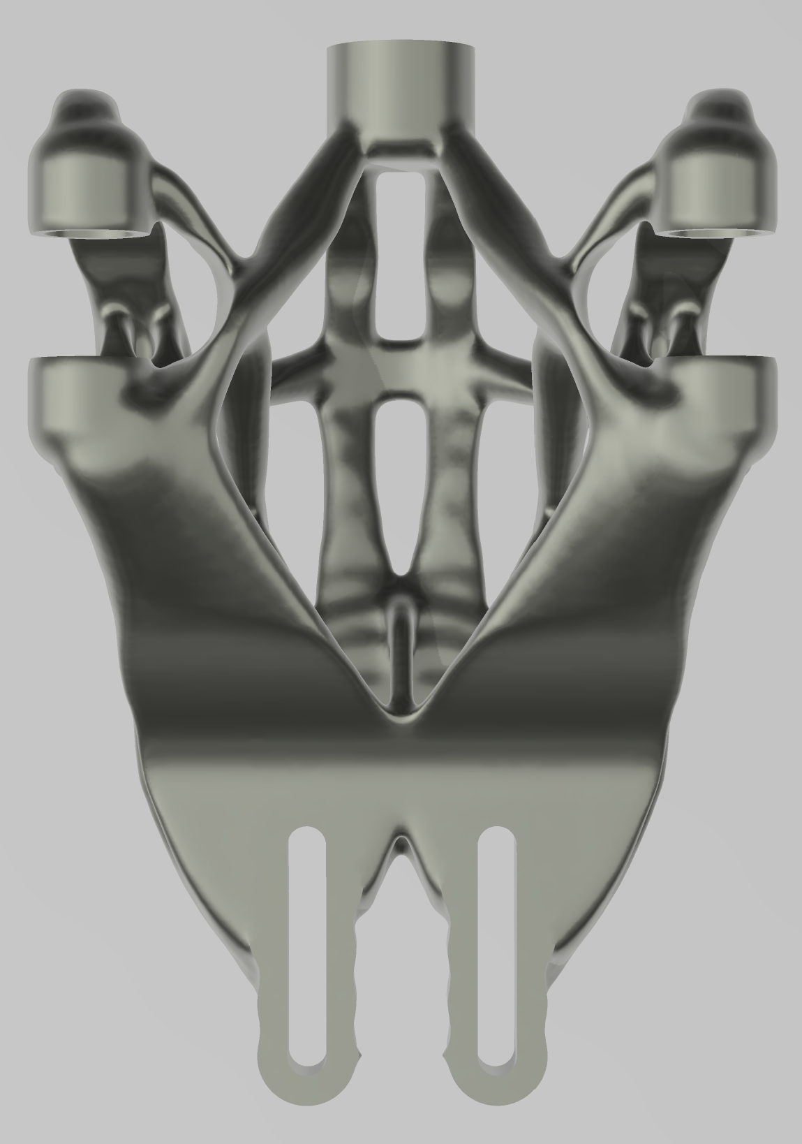

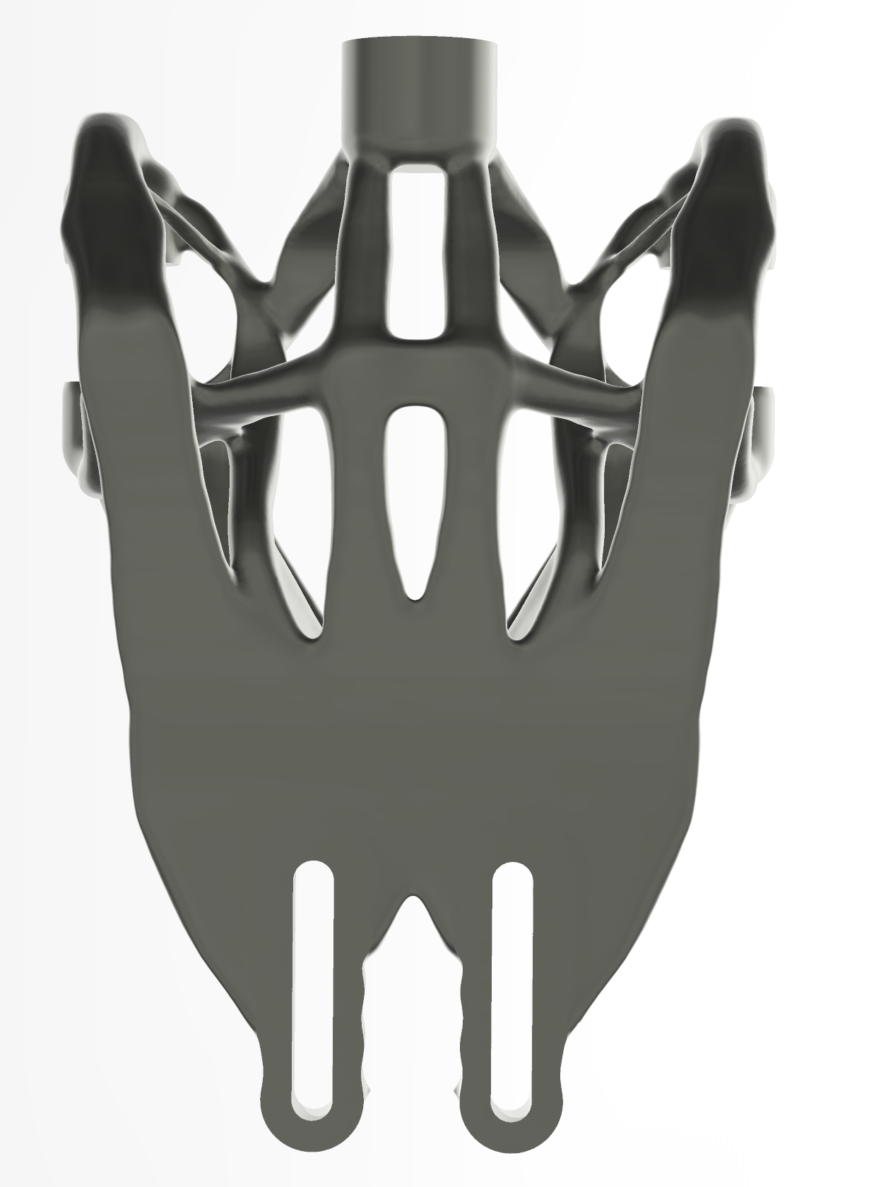

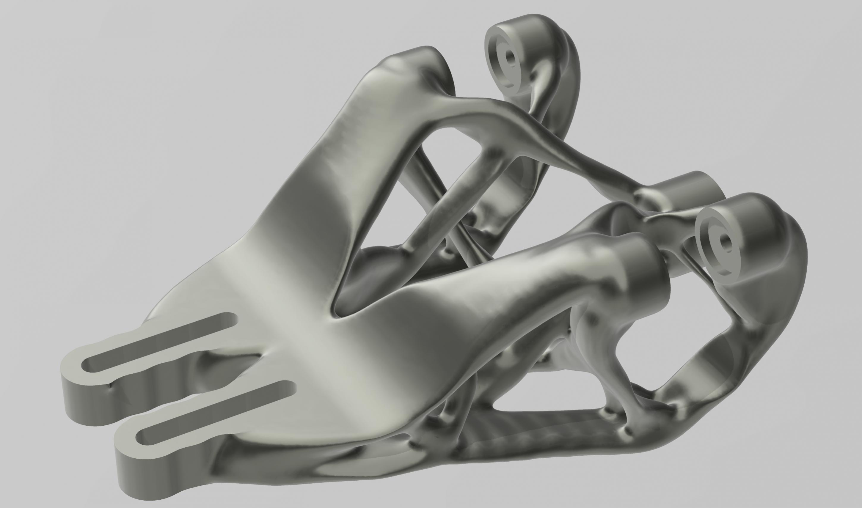

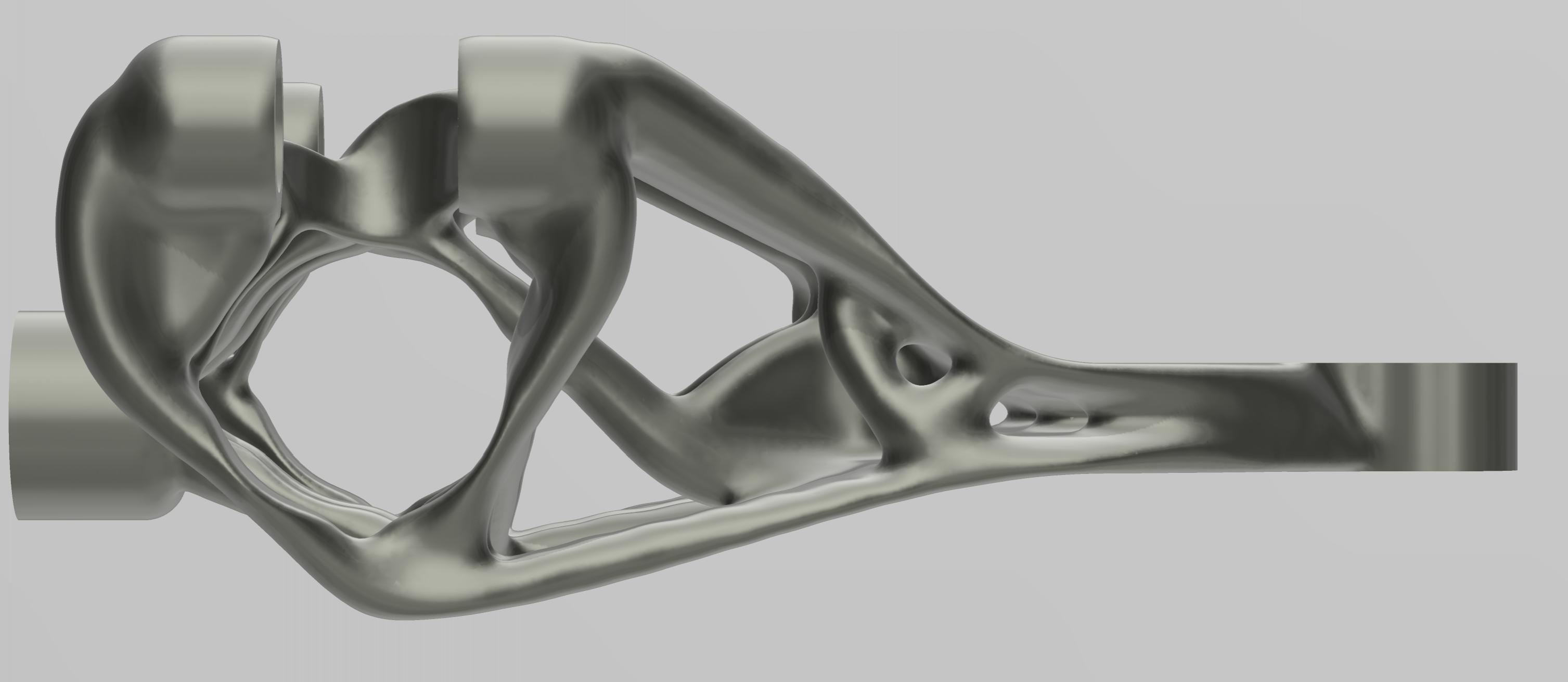

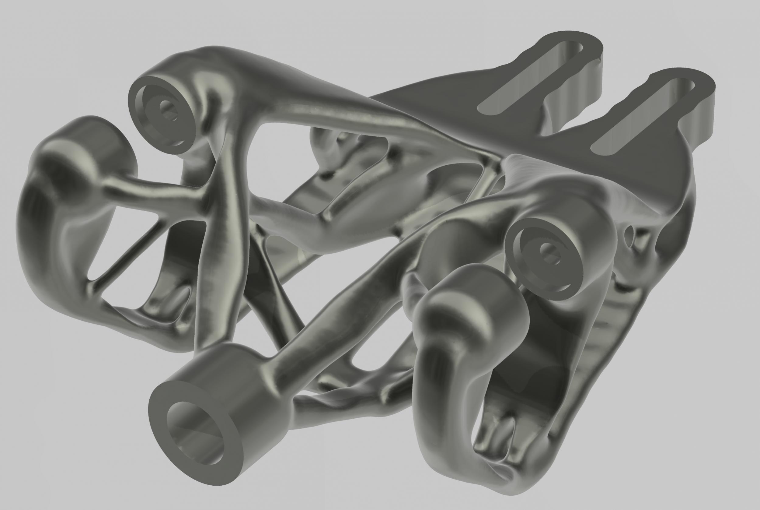

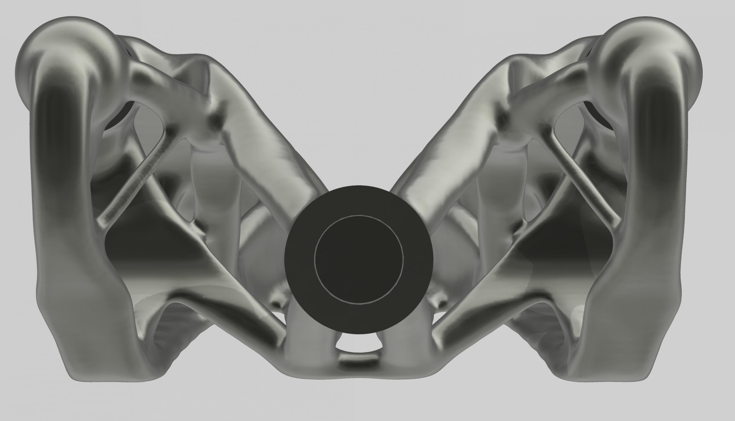

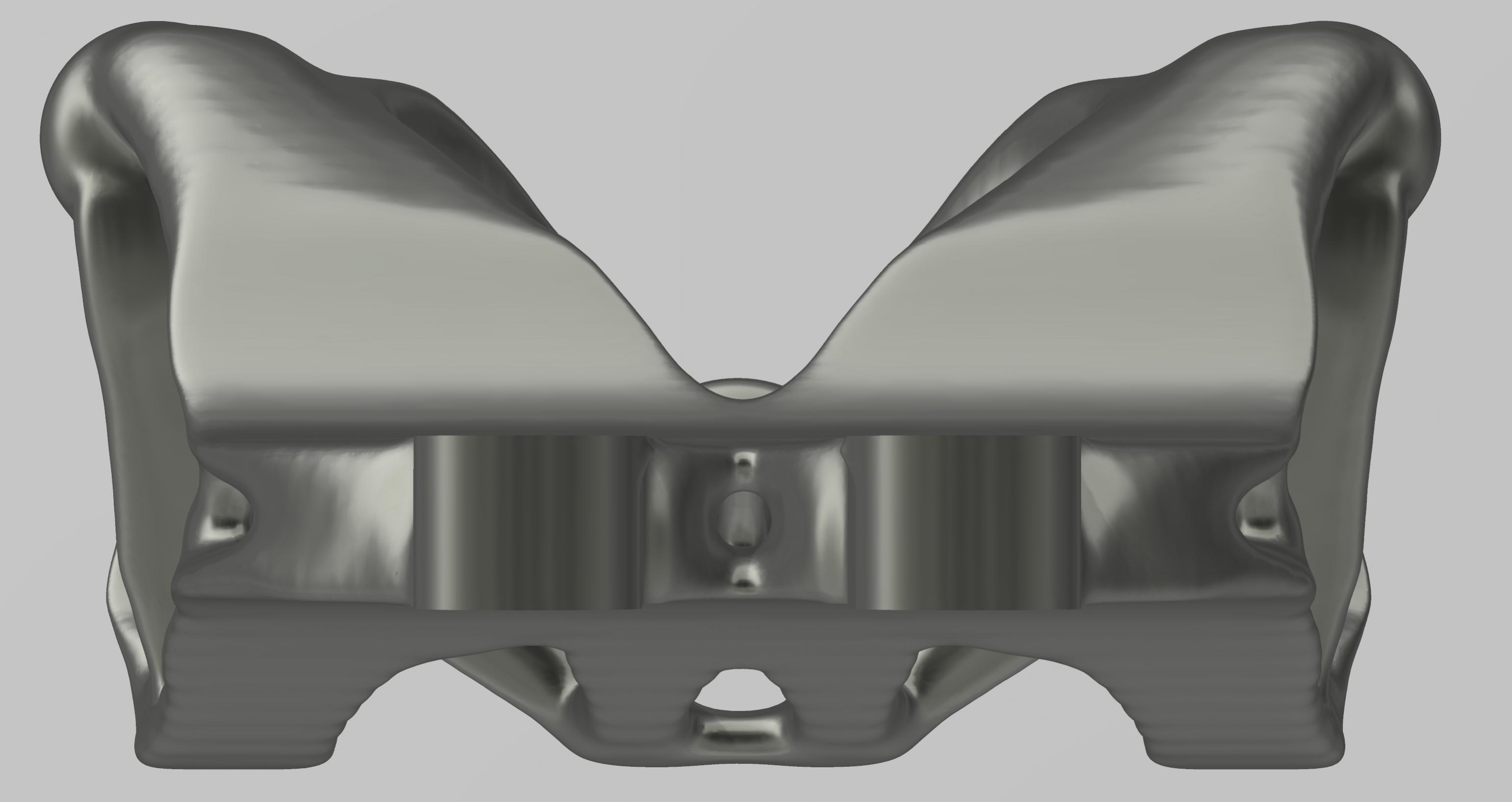

During simulations to measure the truths to a rigid grounding topology for tonearms being superior, I modelled a theoretical carriage with the optimum weight/stiffness, max deflection @ 10 time working load is about 0.5um. Vanishingly small.
Carriage weight ~9g.
I'm not building this as my interest lie elsewhere, just an experiment.
