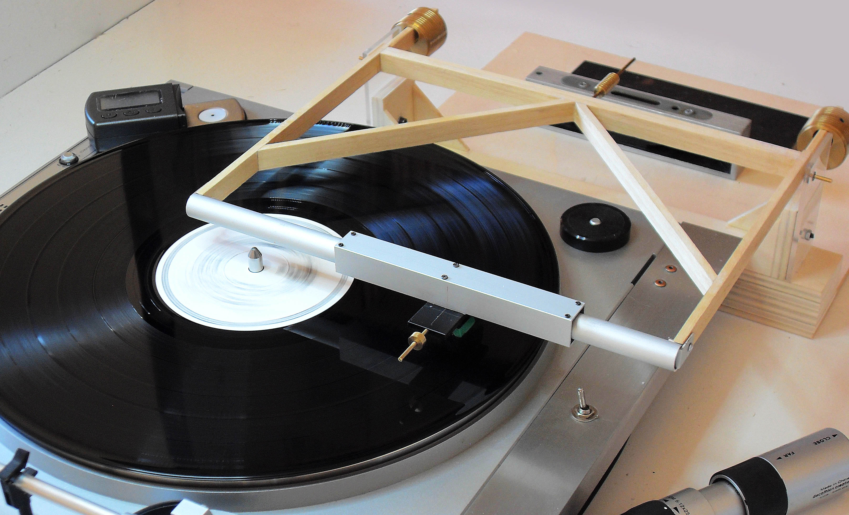

Radial tonearm starting to work - first rough proto, made on the principle - if even this works, after i can't do worse -
The carriage (same as used on Jr Casey #2368) now moves effortlessly at 1,5 VTF, with the rail at zero degrees (no use of tricky slant); having no torque on the carriage helps a lot, as expected.
The way to a good arm is still very long: the weight of rail + cart must be reduced to minimum (< 40 gr with cartridge), and the linear bearing should counteract as possible the vertical tilt . (even if this one was conceived to slide&rotate it still works, but eliminating the small CW would be better); reducing as possible the length of the two arms would benefit too, getting a lower effective mass.
Everything must be built extremely light, but absolutely rigid. I'm evaluating a rail made with a carbon fibre tube but don't know if inner finish would be adequate.
ciao - carlo

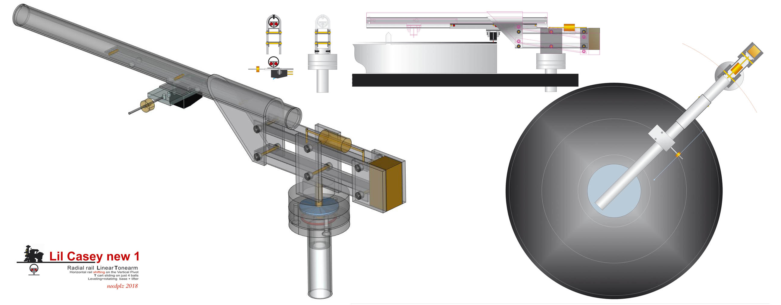

Maybe a new significant step: there is no need to place the vertical pivot as in #2355 and in my first test # 2383. The mechanism for the vertical movement can be aligned radially, but now it must shift using a parallelogram, not tilt on a pivot (sketch). This drastically reduces the vertical mass, and makes the arm more compact, positionable on plinth at a standard distance.

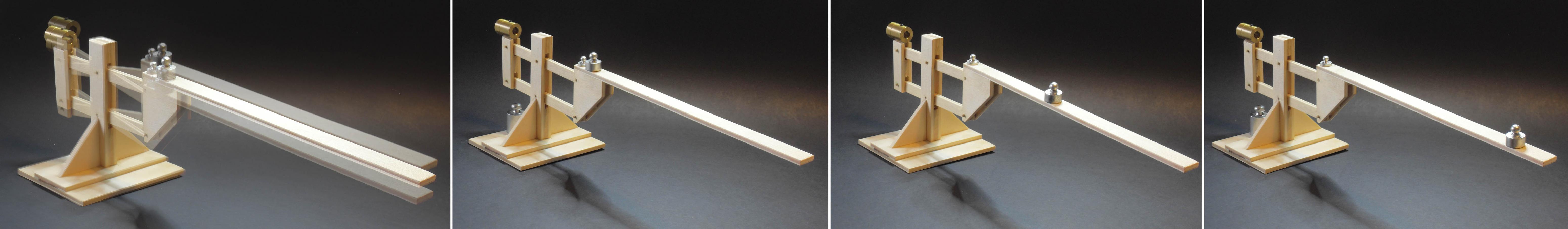

Having still some doubts that the sliding of the carriage would change the VTF, I made a quick check (photos). But there is no change: as in a scale the balance depends only from the distance of the pins from the fulcrum, not where you put the weights on the plates.

This tonearm is linear, but very different from normal linear trackers - Off topic? warn me, please

Sorry, Icsaszar; I thought you were referring to the floating linears others were talking about.
The problem of the rotating cart was mentioned in my posts, if you're referring to this. From measurements made in the other thread, the stylus drag was worth 3,5 mN or less, but sufficient to rotate - at start - a carriage conceived to slide and rotate like the one used - on purpose - in the test; however 2 gr of counterweight were enough to eliminate the problem.
The project will use a T carriage that runs on 4 balls inside the tube, and should be self-centering, but will certainly need many tests; the same for the parallelogram that has 6 (or 12) bearings (balls? jewells?)
Linear tonearms are really difficult to build: having eliminated the torque on carriage due to the length of the arm of the normal ones, and reduced vertical masses to reasonable limits is not bad, for now. First test is encouraging too.
Walter: there will be a base that rotates horizontally, bringing the rail outside the platter (as in # 2360); A solution similar to many linear trackers with a very short arm.
Damn warps: the parallelogram will be able to deal with? It needs just 50 gr of CW instead of >200 of the previous solution, so... For bad eccentrics the radial rail is a marvel: no stylus bending at all seen in the test.
carlo

Carlo, how does the arm design cope with the varying tracking force and dynamic mass?
I´d think that in this design a moving counterweight or some means of varying force is required to level out the different positions of the pickup.
As I understand Your sketches the tracking weight and the dynamic mass increase the closer the pickup comes to the end point of its travel across the disc.
jauu
Calvin
Dd - a 4 -5 mm warp makes any LP unhearable - with such deviation the variation of hor. distance is <0.2 mm, and is compensated by the displacement of the cart (much easier than in traditional LT) just like a small eccentricity.
Using a linear mechanism involves higher weights and frictions (at least for my experience). But there is a lot of work to do. Thanks for appreciation
Rayma - Thanks, I didn't know it: very interesting, and reassuring - as I have already said sometimes, tonearm design (like potato peelers design) seems a continuous reinventing the wheel
Super10018 - Wich pivot? as in many commercial linear trackers there will be a snap lock (see exploded view # 2630, ) to prevent any involuntary rotation. For convenience the rotation is counterclockwise
Calvin - Exactly as in any linear, but not dissipating them in torque friction of the carriage.
Look carefully the photos, that show no VTF variation, as explained. When the carriage goes to the end of rail only the lower bearings of parallelogram sees more push, and upper more pull. I don't care at all.
carlo

Carlo, you're probably right about the distance variation that is probably even smaller than regular warp. On a perfectly flat record, it would not matter. Parallelogram is probably the simplest for vertical pivot. A pure vertical pistonic motion would eliminate the need for tedious VTA adjustment, something I wonder about in another post. My own idea is to place the vertical pull at the center of the carriage via a string and a pulley and then a lever or seesaw with counterweight. Think of the 47 Labs Koma turnable. Don't have picture but see if you can graph one. And for sliding carriage, I would prefer using eight rollers to make four wheels on two horizontal rods as the carriage assembly, which resembles the original design of this thread. And I think it can reduce mass significantly.

Roberval balance
717159d1542875822-diy-linear-tonearm-lil-balance-jpg
What you have is a form of Roberval balance. Here's a video that demonstrates the phenomenon. I think this can aid designing a linear arm for pure vertical movement.
