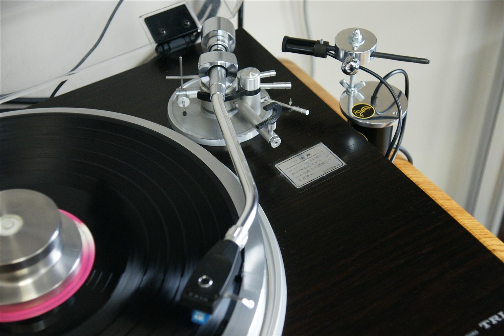

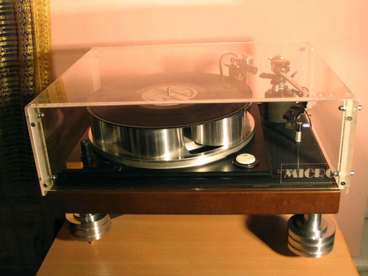

Thank you for reply, Ralf. Yes, I know the main problems, because I've patented myself IMHO mildly commercially perspective design of photo-elecrtically operated turntable auto-stop, that is a universal device, supposedly easy to install and use on the most audiophile turntables (which I use on my Micro turntable for 7 years). For the next one year I've tried to attract manufacturers attention by mailing and e-mailing them, and only one of them answered (that he is not interested), the rest just ignored. Finally, I've made myself and sold about 20 of them, to compensate for patenting, and closed the project forever. Pictures here are just to confirm that some of my ideas aren't that stupid. I'm still pretty sure that it is a profitable product, in case if a well known brand starts making and promoting it. Now it is for free to take, if someone is interested.
Now I build my prototype version of the pivot linear arm, which is different from all other versions, I know about. It is as different, as my auto-stop differs from mechanical arm-lifters (those are IMO clever, useful and underestimated ones). And I'm considering Pro's and Con's concerning patenting it. It only makes sense, if there is a chance to sell it to the well known brand. I'm not a well familiar person to the technical ideas market, and I'm not sure, if the demand on new ideas exists at all among manufacturers.
Sorry for placing that in the tonearm thread, but it is the only place, where I see some highly qualified professionals, with their own experience of patenting and promoting no-nonsense tonearm ideas.
This thread, as well as " Angling for 90° - tangential pivot tonearms" are real delights among all audiophile forums known to me.
Any experience and advice will be highly appreciated.

Yes, it stops the motor only. First, I was worried with that, and considered addition of the arm lift. However, experience with working unit showed, what it is not a problem even with the idler drive turntable, if you leave it stopped for a couple of minutes, and not for weeks and months. And stylus in a stop mode, resting in the immovable groove is 100% safe. Keep it simple works very well.

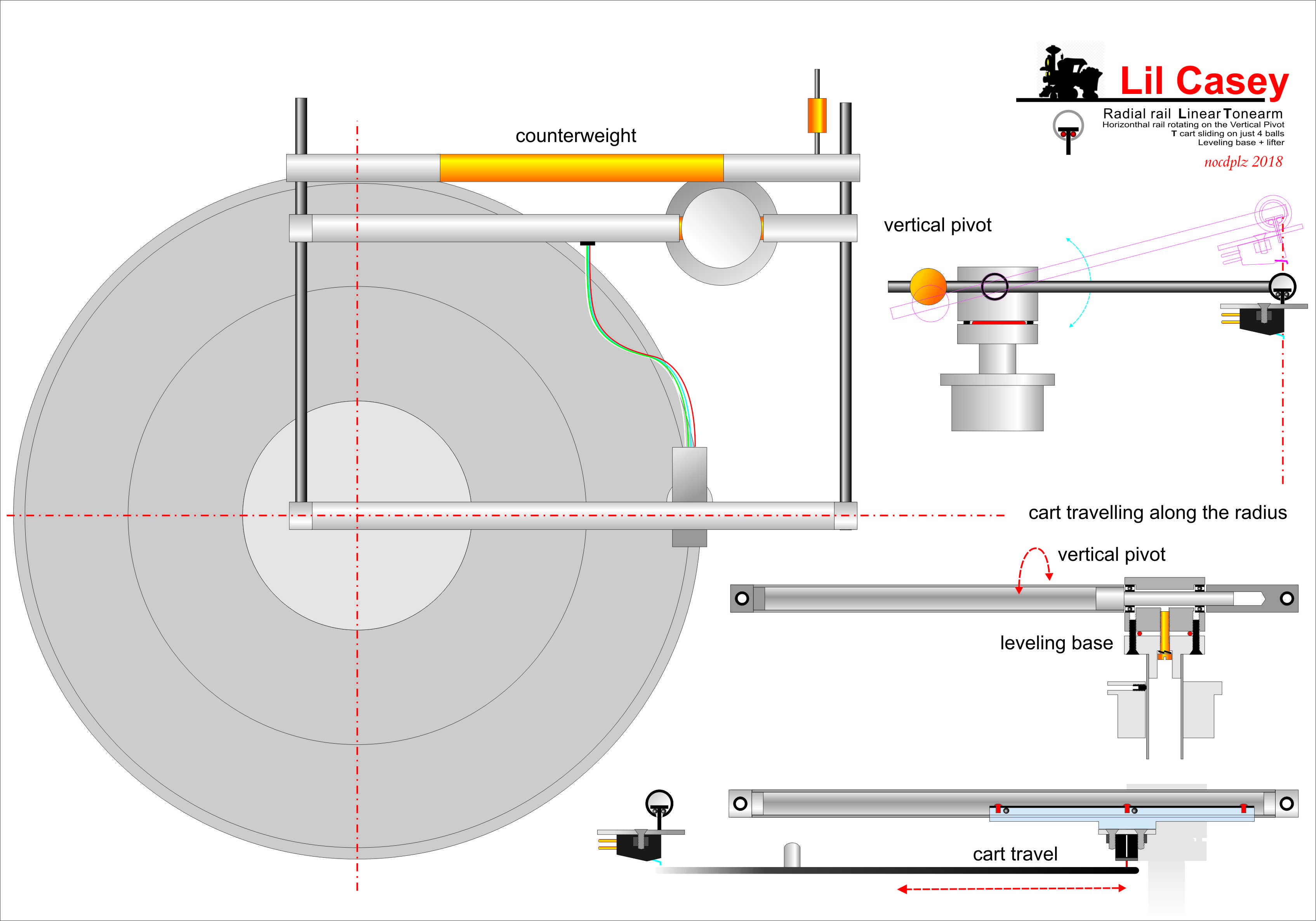

radial rail*- some thoughts
Hi all - first post here, but not new to this amazingly instructive thread.
After a dozen different pivoted arms, including some P.L.T. (working or not) I want to try something like this too. (attachment)
Linear geometry vectors did not convince me, but what if the carriage could travel along a radius? Seems far better, but now vertical movements can be no more faced by the shaft, even the shortest one Revox style. Maybe there is no need to keep them coincident with horizontal ones, so we can explore different solutions: a cart just sliding on a radial rail, a rail fixed horizontally but rotating vertically, a vertical pivot applied to the entire rail instead than to the shaft. (there's no real shaft...)
Could it work? observations and advices really welcome.
carlo
*- Direct driver's thread "Angling for 90° - tangential pivot tonearms" post #1957 #1960 - where this project started from

Hi, NOCD. I can't see, why it wouldn't work with an air pump. The only substantial problem seems to be very different horizontal and vertical masses. As well, as probable sonic influence of the air flow right near the cartridge. Anyway, it seems worth trying...
It is, as far as I can tell, not an air-bearing but a passive roller of some kind. From what I can tell from the drawing,I do think , though, that the bearings inside the tube are too small to have low enough friction.
The difference in vertical and horizontal mass is only a benefit to my way of thinking.
No air pump, no servo please, just passive: the cart uses what maybe you call "linear thrust bearing" in english: balls travel half the space of the cart, always in contact with the rail (= no chattering) and with the least possible friction. Previously tested on a pair of my experiments.
Masses: the horizontal is just the cartridge + cart, less shaft, less counterweight. The vertical seems big - the rail + cart + 2 shafts, + V.P. tube + CW - but acts like those in pivoted TA, so the eff. mass is highly reduced, and with some calcs can be made similar to the horizontal
But before discussing details maybe better to examine the basic idea: could it work?
thanks - carlo

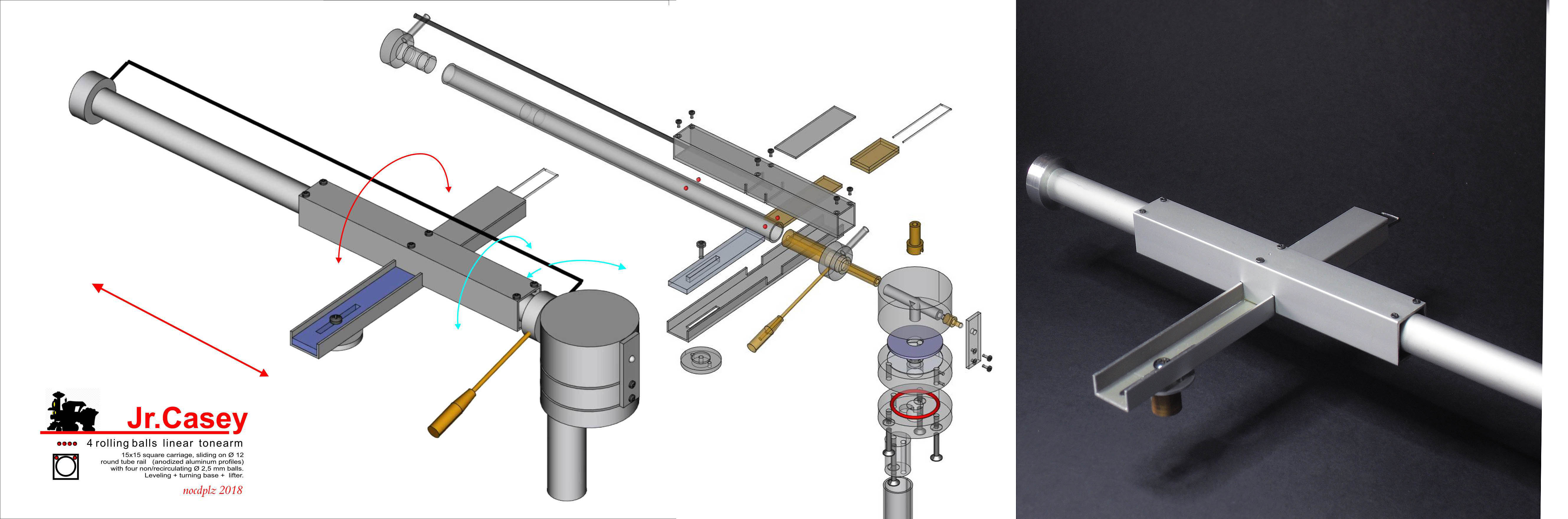

Hi Carlos, I'm glad that you've already taken up the challenge of making horizontal movement independent from a pivot arm and saw the positive side of the video of that very flawed tonearm and you did not dismissed it right away. It can spawn some good ideas. It is one of very few examples of doing tracking force differently, which include Ralf's design in another thread. I think it opens up new thinking.
One concern about this type of design is the loading on the rail which includes the mass of the cartridge, headshell, and rolling carriage. I think in your case, it seems to be adequate without encountering chatter or contact issues.
I think the arm can be more compact without the dual vertical arm design just for aesthetic reason.
Hi Dd: in spite of my projects, your thread still remains a gold mine for every diyer (and professionals too?)
I had already made this attempt (only half: carriage and rail) interrupted because the results were not too different from those seen in the achievements of friends: stylus bending. Despite a very short lever, and very low frictions the problem of the wrong point of application of the force seemed unsurpassed.
Then that video convinced me to try again: at first designing (without anything convincing) a vertical piston-like movement, then resigning myself to this trivial solution (always the most difficult to find): pivoting the rail.
The constructive problems now guessable are mainly these:
vertical torque on carriage, due stylus drag - modify the linear thrust bearing shape to counteract it.
cartridge compliance, due the very low horizontal mass - unfortunately an increase may bring in even bigger issues.
vertical mass - now the long lever works to our advantage, but everything possible must be done to limit the inertia of the moving masses. I fear that only one shaft would be nicer, but much heavier to get the necessary stiffness
