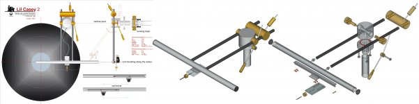

For a linear tacking tonearm with long arm tube, the difference in vertical and horizontal masses are inevitable. In fact, I am not sure how much the difference in masses will degrade the sound. It doesn't matter probably that much as most people think. On my air bearing arms, I have approved that the masses in vertical panel and horizontal panel are almost same for a short arm linear tacking. I believe it is true for passive linear tracking tonearms such as Niffy's design, too.
There are so called vestigal pivot arms, like Dynavector, with big difference between vertical and horizontal eff. masses. They seem to have their advantages.
As to linear bearings, there is a clever patented design with a float.

"I think the arm can be more compact without the dual vertical arm design just for aesthetic reason." Dd
Another sketch, trying to follow your advice, with a more conventional look. Seems feasible, but the shafts become a bit longer
Some mods to headshell (question: better to align the tip or the joint of the cantilever?)
Some guesses on the weight of moving masses based on profiles at hand. Horizontal masses behave as in linears, while vertical like in traditional pivoted.
Thanks to all for your posts, hope this new sketch will be clearer to understand how it works (or it will not): a radial rail seems new to me, but who knows? seems so simple...
carlo

There will be friction for the Russian arm. Air bearing is probably the only medium which has almost zero friction so far. Frankly speaking, I don't like it at all. I believe Niffy's design is much better than that.
The only thing, I think, can be better for Niffy's design is to improve the rail. However, for a diyer, it may be the best he can do.

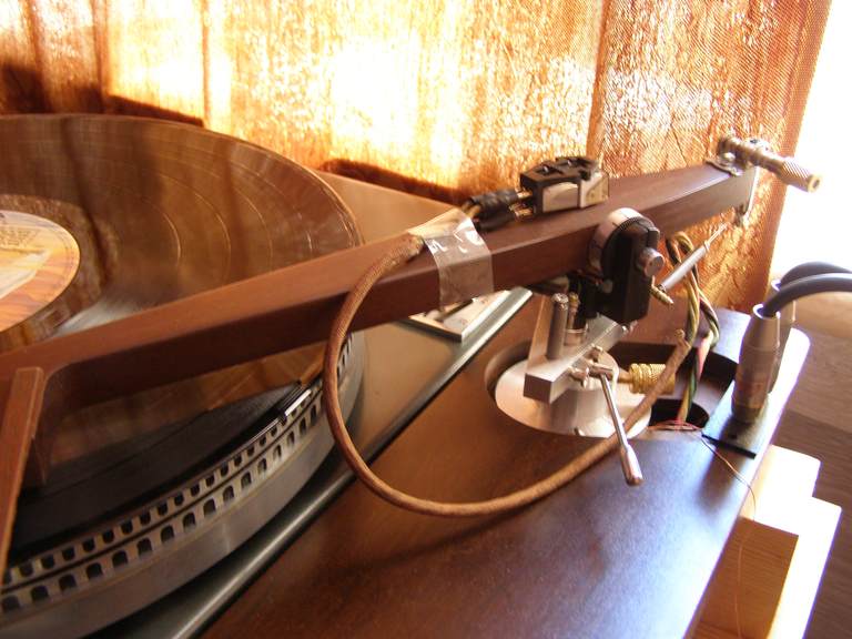

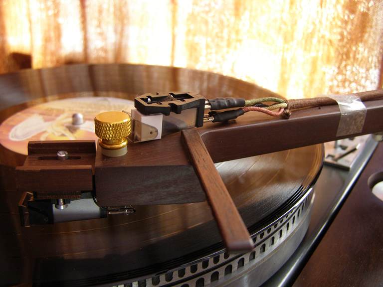

Chatter and rumble
Hi all. As to hearing and possibly measuring unwanted resonances, bearing and shell chatter and so on, I have used the simplest solution possible. It may be applied to tangent arms as well. Cartridge used was Ortofon VMS20, the stylus placed on the top of the arm.
nocdplz, actually, my first attempt was with a tiny microphone, and it failed. MM cart appeared to be much more sensitive, and you can clearly hear everything in any location of the arm or turntable. As to floating arm, my first thought was to apply a magnet guide instead of rollers. However, with a liquid it is inevitably unstable...Russian patent rules IMO.
That is very clever method. So, the stylus directly contacts the arm? I would like to try it later on.
About floating arm, I thought to make one which floated on a thin film of air. It doesn't need high pressure air at all since the load is very low. However, I gave up the idea because I think there is better solution already, why make things complicated. It is basically a moving pivot arm.
