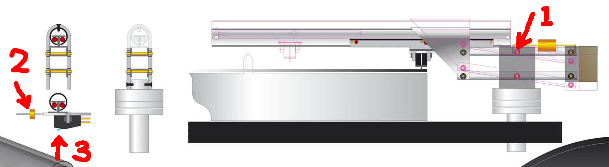

Super10018 - Wich pivot? as in many commercial linear trackers there will be a snap lock (see exploded view # 2630, ) to prevent any involuntary rotation. For convenience the rotation is counterclockwise

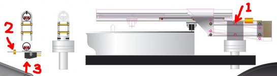

Please see attached photo. The pivot I was talking about marked 1. I understand the mechanism on the pivot is to deal with wrap. Let's look the needle position, marked 3. The stylus is directly under the rail. Why do you need to do this? Any benefits to position the stylus directly under the rail? If the stylus is placed directly under the rail, wrap will cause problem for sure. So, a mechanism to deal with wrap is necessary. But how about move the stylus away from the rail just as everyone else does? The distance from the tips of stylus to center of air bearing shaft are between 3"-2.5" for my air bearing arms. I also have an outer ring to prevent wrap problem. I have never encounter problems caused by wrap. The same distance for Niffy's design is even shorter than mine. I never see he says there is a problem with wrap. In addition, he doesn't even have an outer ring. You have a counter weight in front so the total mass of carriage may be same as or heavier than it is on the back as most of people do. The total mass of carriage is very critical for a mechanical linear arm. Placing the stylus directly under the rail doesn't help you to reduce the total mass of carriage. So, why need to do it?
Once you reposition the stylus away from the center of rail, you don't need anything to deal with wrap problem. Horizontal and vertical masses may not be exactly same. The difference is very small, 1 Hz or less, on my air bearing arms. I believe it may even smaller for Niffy's design since his head shell is shorter than mine.
Jim, your concerns are well reasoned. But I think you misunderstood Carlo's intent. I cannot fully speak for Carlo but I can provide my own observation. The parallelogram is NOT for dealing with warp. It is the VERTICAL bearing. He wants to separate vertical movement from the horizontal carriage. He wants to make horizontal bearing and vertical bearing independent from each other -- inspired by our esteem member Ralf's brilliant design. The parallelogram is his version of a pistonic bearing for purely vertical movement so the main "arm" doesn't need pivot/seesaw movement. That's why the stylus is underneath the center of the sliding carriage. Since the carriage design is a self centering kind that he needs equal mass on both side of the stylus, front and back. The reason he and I mentioned warps is that my concern about parallelogram can create subtle horizontal shift when going up and down, much like dealing with a warp records. Unless it's severe warp record, horizontal distance should not be a concern. Due to the "Roberval balance" the horizontal placement of the carriage does not affect VTF, a good thing! I think it will work adequately as an alternative parallel tracker.
Btw, I am not fond of the construction of ball rail. The piece of metal to hold balls in place may increase the total mass of carriage significantly.
I have to admit that I am with you when it comes to his carriage design. There's just too much horizontal mass that it negates the benefit of having a purely horizontal sliding carriage, a mini wagon like carriage is more to my own liking. And the self centering system doesn't seem very stable under dynamic behavior. We spend all the effort to shorten the arm and eliminate the lever, pivot, etc... and then you have this hulking wide carriage doesn't seem very elegant to me.
Take Niffy's design as example, same wheels act as both vertical and horizontal bearings. Both movements are separated.
The point of his design is that he does NOT want a seesaw style vertical pivot. If purely vertical, there will be no VTA change at all, hence the parallelogram. You just have to let him experiment and check the result. He's having fun and let him have his buzz first. :)

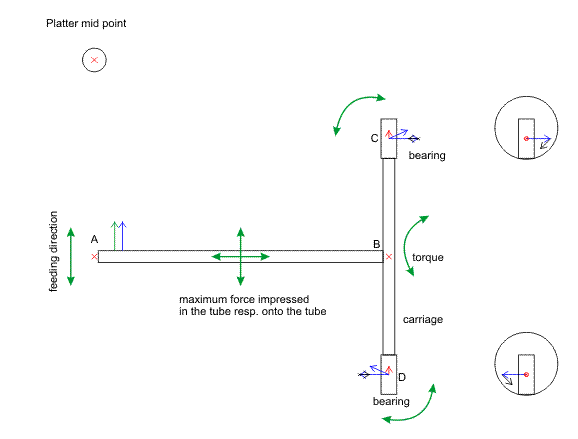

And now building details:
Carriage: non-recirculating linear bearing are used for no play and minimum friction movements in precision instruments, and someone used even on a linear TA
My Linear Tracker (a new variation perhaps?) An entire thread about
My experience comes from two versions of Syrinx PLT and Jr. Casey TA, slowly realizing that less balls means less friction (and probably less chattering). This cart will weight around 7 grams: if you have better ideas, better for me too. In normal linear carriages - even the most sophisticated ones - there is the arm + CW weight, and here not: so we start already with a nice advantage. The same for the self-centering movement: again consider that the rail too must weight almost nothing.
Vertical movement: nothing special, any scale, even with suspended plates, behaves like this. Now I have understood that here half parallelogram is enough, eliminating 4 bearings. Another step.
As I wrote in a post, at the beginning I tried too to make a piston cart (the most trivial solution, but too much precision, too much weight needed) and I have not succeeded. I design things that can be realized with my own means, not impracticable technologies.
Warps: half century ago I learned not to buy lopsided discs, and to keep my LPs properly. Warps must remain within the limits of decency. Imho the arms must be able to handle warps and eccentricity, not be designed for that. In Italy there was a (in)famous pre-phono designed especially not to hear the clicks of the dust, we're still laughing.
Thanks to all for your attention
carlo

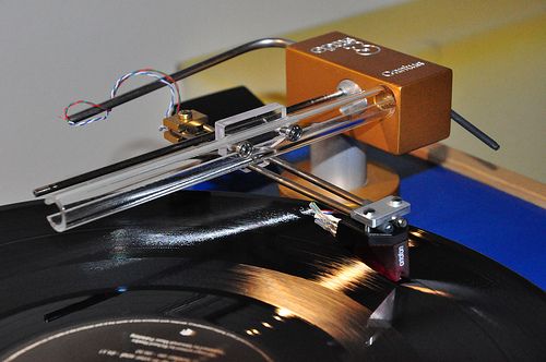

Carlo, I can see your point now. The challenge is attractive.

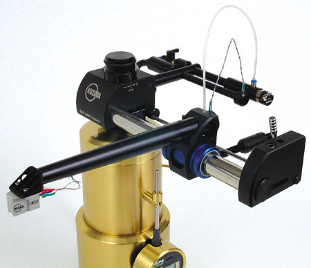

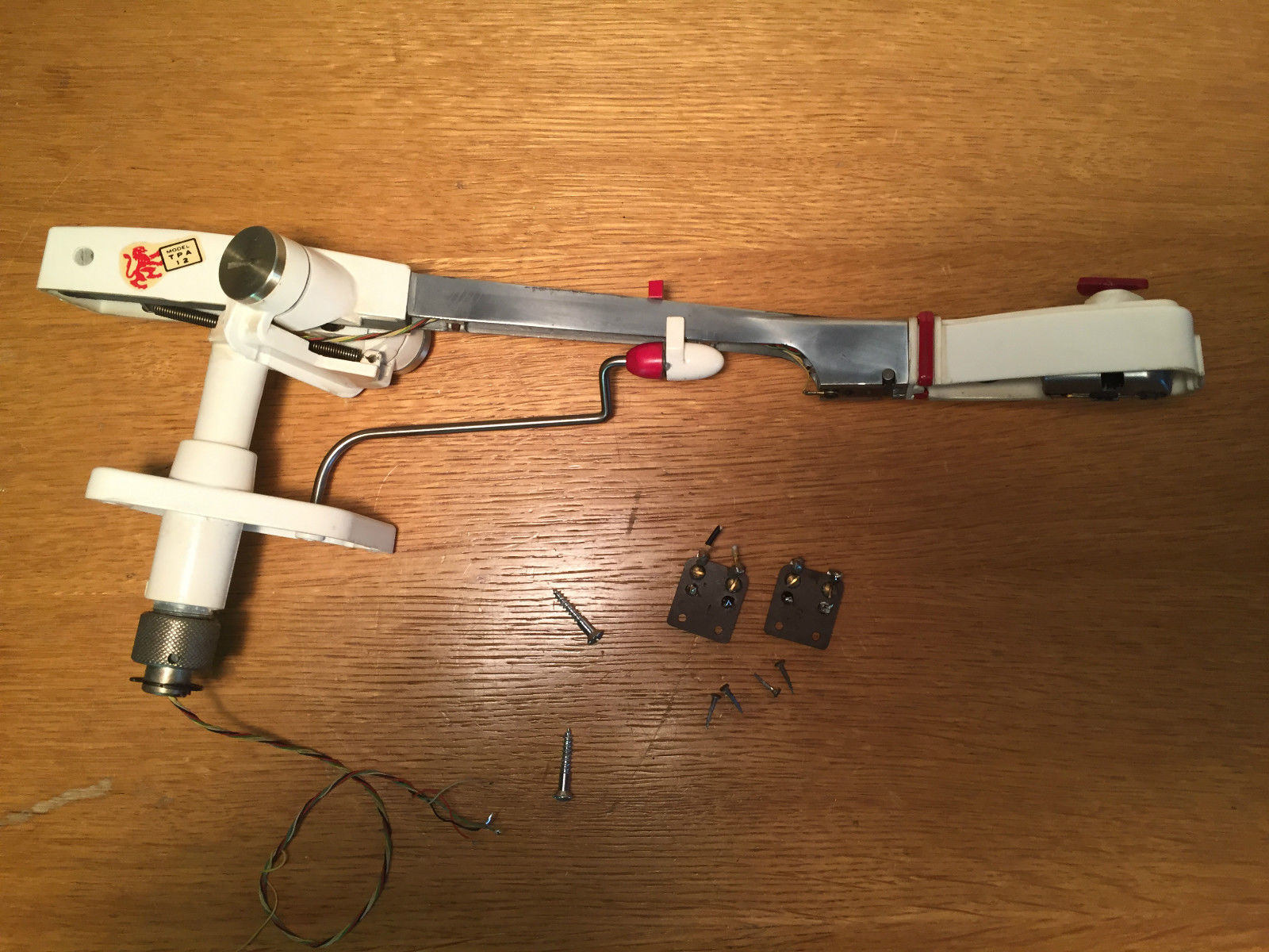

As to my understanding concerning linear arms, I'm still unable to grasp how to resolve a wiring problem, that is common with all LT known by me, with only one exclusion -it is solved by the Russian design (see video from my post 2362), by attaching additional pivoted tube (arm or lever).
My own experience with many traditional pivot arms showed that flexibility and shape of tonearm wires layout is often more important, than bearing friction, and is very influential as to both: sound and tracking ability. With pivot arms it is mainly solved due to leverage momentum and proper shape of the wire loop.
With LTA it seems, like nobody cares too much. I'm still unable to grasp, what is the advantage in having no skating force with LT, if we still have those loops of wires, hanging around, affecting tracking and sound. They are also unshielded, prone to cause hum.(see attached pics). By those pictures, I may expect lateral forces , far exceeding those caused by skating force in pivot arms.
Can someone, who is experienced with LTA, enlighten me, as to wire loop?

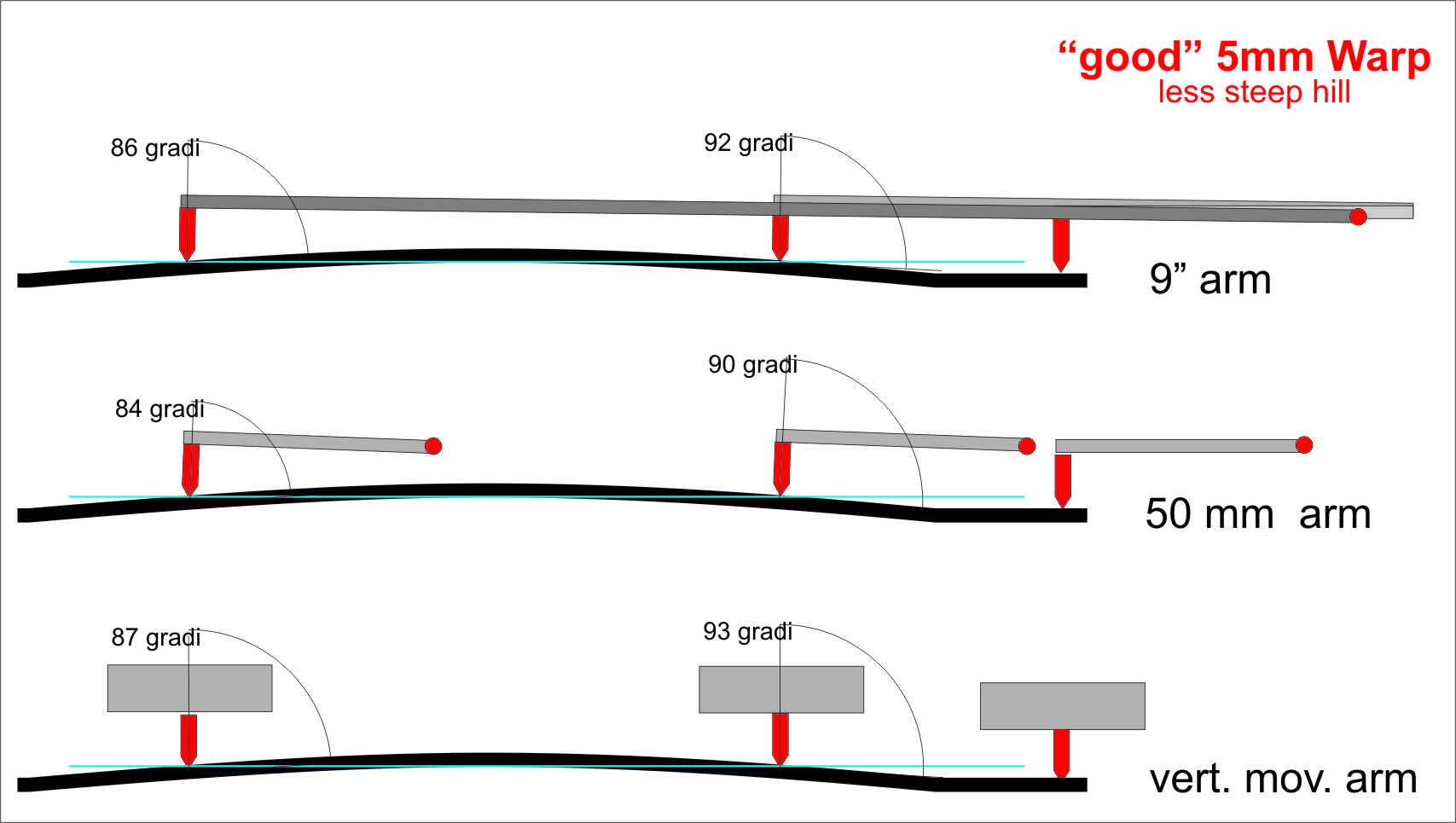

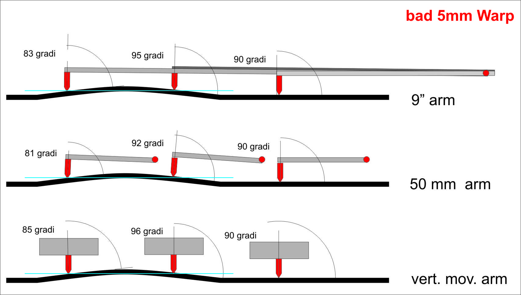

Hi Niffy, I was waiting impatiently for your contribution, as always at the heart of the problems. If you have 2 concerns mine are very similar to yours, but more numerous. I will answer carefully as soon.
Meanwhile, the VTA: great! is always surprising to check wrong beliefs stored from years: you're absolutely right
ciao carlo

Wire is not a problem at all. I use 4 strands of 44 g wires from a broken HD600 headphone wire for each channel. Bearing friction is the most important factor for linear arms. Wires don't need to be shielded. I have no problem with electronic interference at all. In fact, my arms are very quiet. Some of your photos are air bearing arms. For air bearing arms, air tubing may cause more problem than wire. However, on my own air bearing arm, I use 1/32" tubing which can hold up to 90 psi. I think it is better than any air tubings used on commercial versions of air bearing arms.
I have to agree with Super as the wire is not the problem with hum, ground loops are and need attention.
I have a spool of litz and have used the Cardas tonearm wire on many LT situations and never had hum issues that came from it specifically so need to stress over its arrangement

Hi walterwalter,
I tried quite a few different arm cable set ups before I settled on my current configuration. I use 4 x 0.06mm enamel magnet wire per channel reasonable tightly twisted, two for positive and two for negative. The separate bundles for left and right channels run independently and are not twisted together.
When designing the bearings for my arm I built a test rig to measure lateral friction. The test rig had a resolution of about 0.2mN (0.02g). I did a quick test with my current arm cable to see how much drag it added. I couldn't detect any increase in drag. (The measurements were not as thorough as those used to test the bearings, only about 30 separate measurements were taken with the cable added as opposed to 250-300 when measuring just the bearings). From this I can conclude that the amount of additional drag due to the arm cable is lower than the resolution of the test rig ie less than 0.02g.
Drag due to the arm cable really is a non-issue.

Walter, after Niffy's post I can no longer agree. What you say, what I thought, is what tells the common sense referring to the horizontal plane of a perfectly flat disc **. But if you refer correctly to the tangent to the groove, a quick graphic check indicates
bad warp (very steep - 5mm high)
9 " arm + - 3.5 ° deflection --- 50 mm arm + - 3.0 ° deflection --- infinite arm + - 4.0 ° deflection
"good" warp (less steep, same 5mm high)
9 " arm + - 3.0 ° deflection --- 50 mm arm + - 3.0 ° deflection --- infinite arm + - 3.0 ° deflection
Surprising - the vert movement (infinite arm) may be worse than the other two
carlo

Thank you all. Now I can see, that my concern about wiring is a bit exaggerated.
Super 10018, I've also found the headphone wires are among the most flexible for wiring the arms.
Avwerk, In my setup, I'm still having some hum issues with some LOMC cartridges, if the arm wires are unshielded.
Niffy, If your tests prove that the bearing friction is crucial, I would believe it and concentrate on bearings.

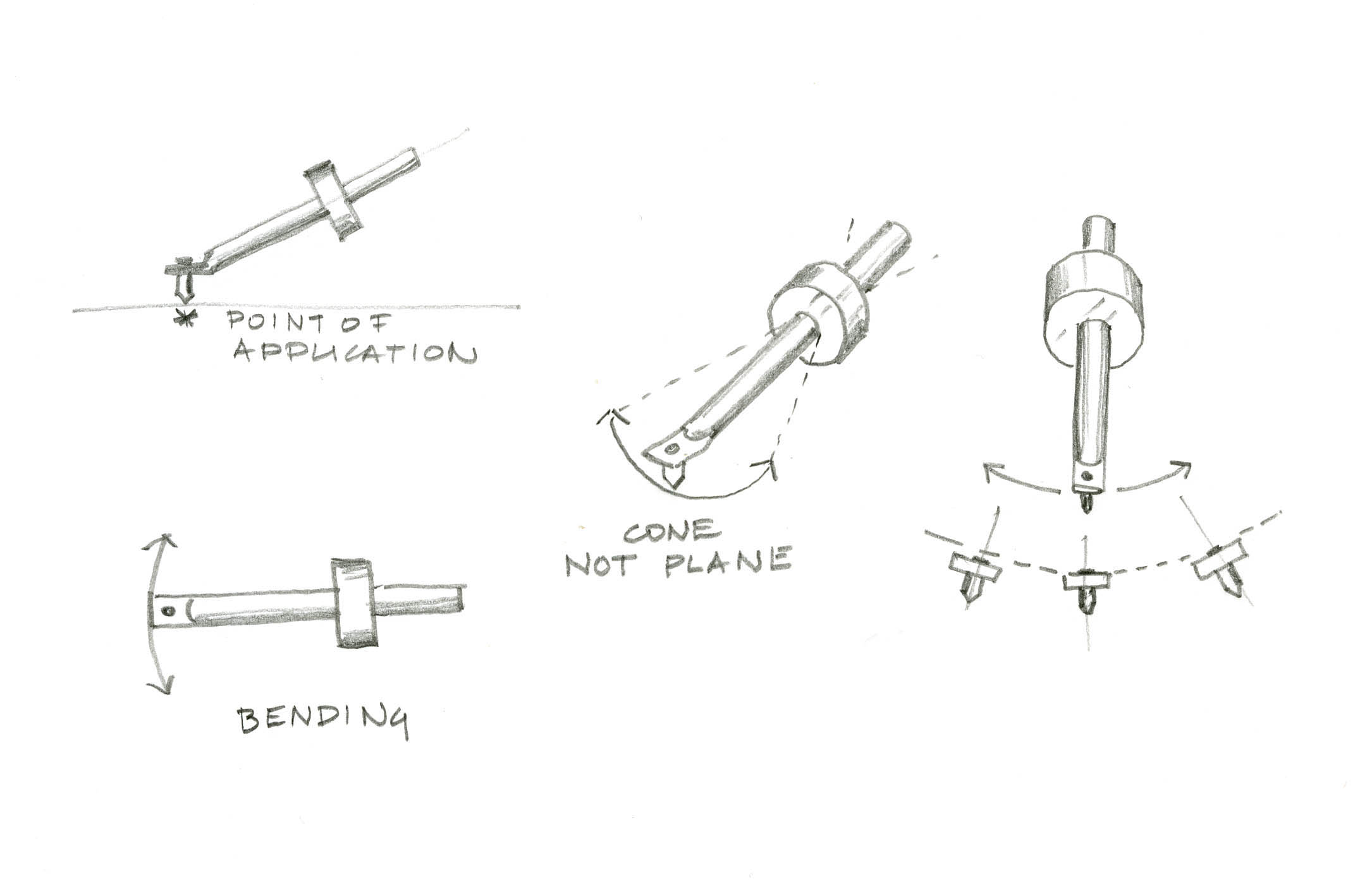

3 dimensional warps and azimuth
Hi all,
When considering warps we tend to look at them in a 2 dimensional manner, only really looking parallel to the groove, and how this effect VTA. In reality warps are 3 dimensional, they not ony slope up and down parallel to the groove but also slope perpendicular to the groove. Warps not only effect VTA but also effect azimuth.
When I measured my random selection of records I only measured parallel to the groove so regrettably didn't get any data as to the slope of the record surface perpendicular to the groove. I think that the average slope of the record surface is probably going to be similar for VTA and azimuth but the maximum amount of slope for azimuth is probably higher than the maximum slope for VTA. As I said I haven't actually measured this so I may be wrong. With VTA the average slope up is equal to the average slope down. However with azimuth the average slope tends to be towards the centre of the record. For this reason perfect azimuth alignment will tend to require the cartridge to be ever so slightly twisted counterclockwise. What is certain is that warps effect azimuth.
The alignment of the stylus with the groove consists of 3 parameters, LTA, VTA, and azimuth. Try and picture an idealized fine line stylus sitting in a groove. Now imagine misaligning the stylus in by a small amount for LTA. Do the same thing for VTA and azimuth. (I would have made a couple of diagrams to visually assist but I'm currently recovering from an operation and sitting at my computer is not comfortable) From this mental image you can probably see that azimuth misalignment will have the greatest effect and LTA the least effect. This holds up in my personal experience with the sonic effects of altering each of the alignment parameters.
As azimuth alignment is the most important it may seem odd to design an arm that doesn't have azimuth adjustment. There are 2 main reasons why this adjustment is often not included. The first is that a solidly attached headshell/armtube is more rigid and offers a more direct conduit for compression waves. The second is that making an adjuster that allows accurate fine movement to a fraction of a degree is difficult. Most adjusters simply rely on loosening the headshell/armtube and rotating by hand. Trying to do this to an accuracy of less than a couple of degrees is virtually impossible, just not good enough.
My method was to build the carriage as accurately as possible with no adjustment and zero azimuth, then clamp the record to minimize warps. Of course this cannot account for the accuracy of manufacture of my cartridge but it seems to work pretty well.
Now for an off topic observation that highlights another area where the common wisdom used by many manufacturers (and diyers) is often flawed.
Many manufacturers align their vertical bearing so that it is perpendicular to the groove/cantilever. A couple of examples are SME and Rega. These are the arms where the bearing yoke is not at 90° to the armtube but is twisted to match the offset angle. The idea is that as the cartridge moves up and down as it navigates a warp the cartridge remains parallel to the surface of the platter (laterally) and the azimuth angle won't change.
If the bearing yoke is at 90° to the armtube the cartridge will rotate ever so slightly counterclockwise as the arm raises resulting in an azimuth error. Seems reasonable.
However as warps are not 2 dimensional but are 3 dimensional this wisdom falls apart. As I mentioned earlier warps tend to slope more towards the centre of the record requiring the cartridge to be twisted slightly counterclockwise to compensate. Due to this the arm with the bearings at 90° to the armtube will actually have LOWER azimuth error than the arm with the bearings matching the offset angle. In fact twisting the bearings even further in the opposite direction to the offset angle will further reduce azimuth variation due to warps. The ideal angle will be dependent upon the actual average slope of the warps and has to account for variation in the thickness of records. My rough calculations (based on guesstimates of the angle) would suggest an angle of 15-20°. If I discount variation in record thickness this angle could be as much as 45°. Of course with a perfectly flat record this angle would make no difference. Unfortunately as the perceived wisdom is so ingrained in the hi-fi press any manufacturers aligning their bearings in such a manner would get a rough ride. End of off topic.
