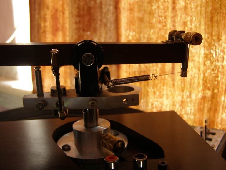

Niffy, solution isn't complicated, based on plane geometry and physics, those you know better, than me. With my pivot spring arm there still is about 0,5 gramm difference of VTF between high and low on 1,5 mm warp, which I easily can reduce even more.

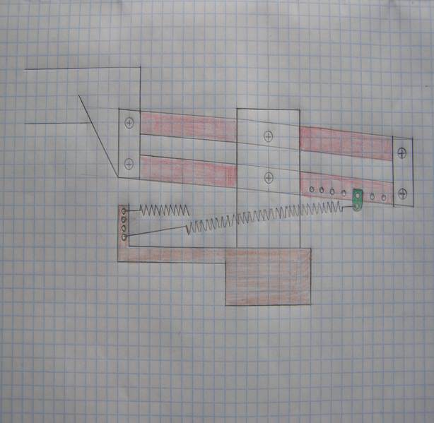

NOCD, In my arm, on warped records, while climbing up, VTF increases. If on plane record VTF is 1, 5 gr. , on the top of 1,5mm warp it is about 2gr. I can improve it further, and even tried to use king of tackle block (polyspast) for that purpose, which appeared to be a bad idea. Difference of leverage momentum should be enough.
The longer the spring, the less VTF varies. The less leverage a spring has as to a pivot point, the less VTF varies. Using proper leverage, it is possible to reach miniscule length of spring contraction-extension, and so, minimal variation of VTF. Long spring, positioned horizontally, closer to the pivot point serves that purpose well.
A good source of different springs to scavenge, are older, purely mechanically controlled cassette decks.
It can be seen on my picture, that there are multiple holes on both ends of spring attachments, to choose variable leverage.
Walter, I was trying to understand the differences between your measures and Niffy's model: if the large increase in the VTF calculated by Niffy could be compensated by the inclination of the spring in your arm but, as you say, it is not so.
I'm checking how to apply (extremized) it in the parallelogram, but in it still does not convince me.
Thanks for these hints - carlo
NOCD, you are on a right track. Almost all of your variants from two last posts are close to aim. IMO, we may consider, as acceptable , if VTF varies 10%-20% while stylus climbing 2mm warps. On a good record it will be considerably less.
As to polyspast, it appeared as unnecessarily complicated solution, with additional friction and time delay. Proper leverage will do it alone. We don't need a belt fed pocket pistol, are we?😀

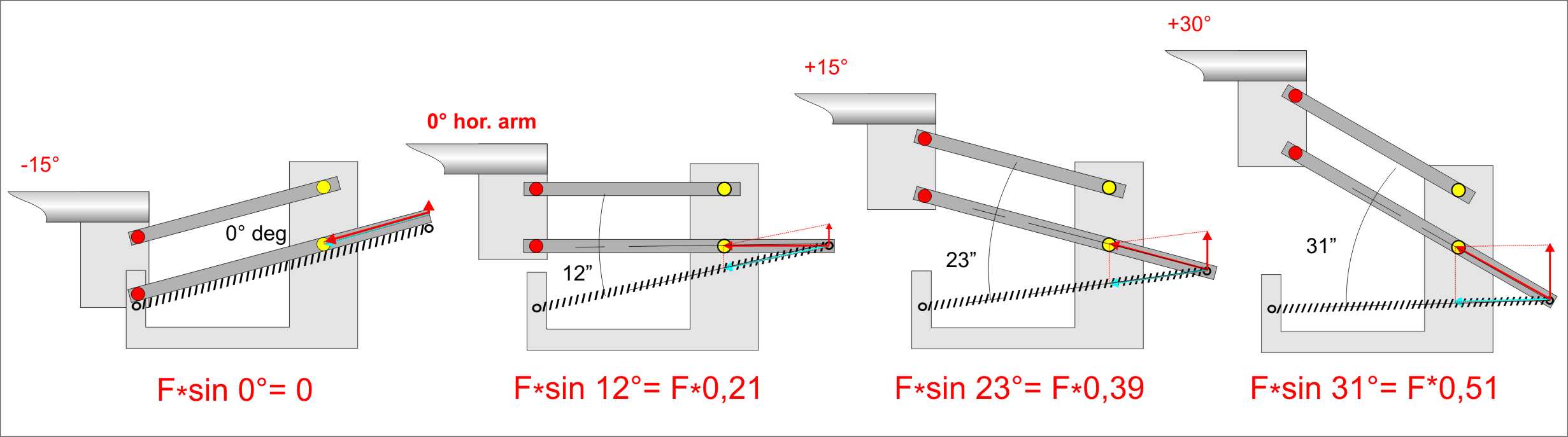

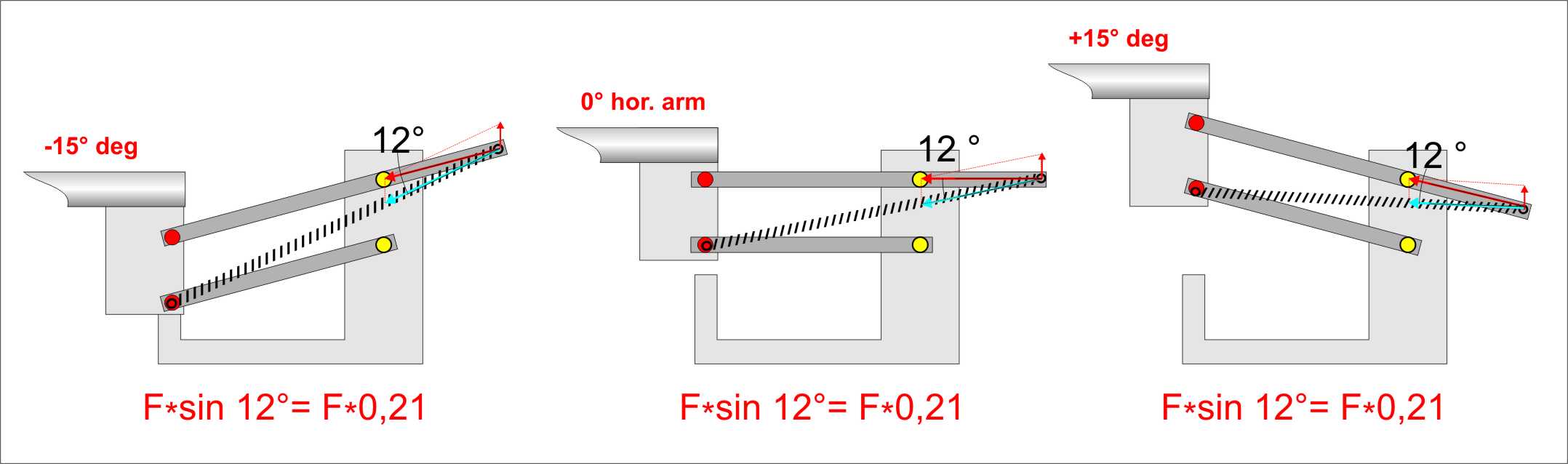

No, only the second. #2448
See the forces breakdown in the first one #2447: at -15 ° there is completely no balance (zero spring force), while at + 15 ° it goes up to 40%. Relevant variation and, furthermore, the sin alfa function is sinusoidal, non-linear.
The second one may work very well, weight always balanced in every position. At least on lamps (a Luxo seats on my table since 40 years),
But there are even cons:
1 - the spring exerts on the bearings a force of 5 times of which must balance; and if the lever is half of the other, for a mass (rail + cart + cartridge) = 50 gr is doubled to a 5N - Huge spring.
2 - getting the right spring: it's true what you say about decks, but I love my Teac C2X, and I'll never hurt it, because it still sounds great, playing memories of the past. I am scavenging Amazon and RS: many measures except useful data (strength).
Anyway it seems promising and I want to go deeper: part making stopped.
carlo

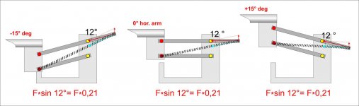

Keep kicking that box to pieces. (Niffy)
Just add a rubber band ... the "Luxo lamp" solution #2448 seems to work fine, Walter: the balance remains constant in all positions.
Now let's find the damn right spring...
ciao - Carlo

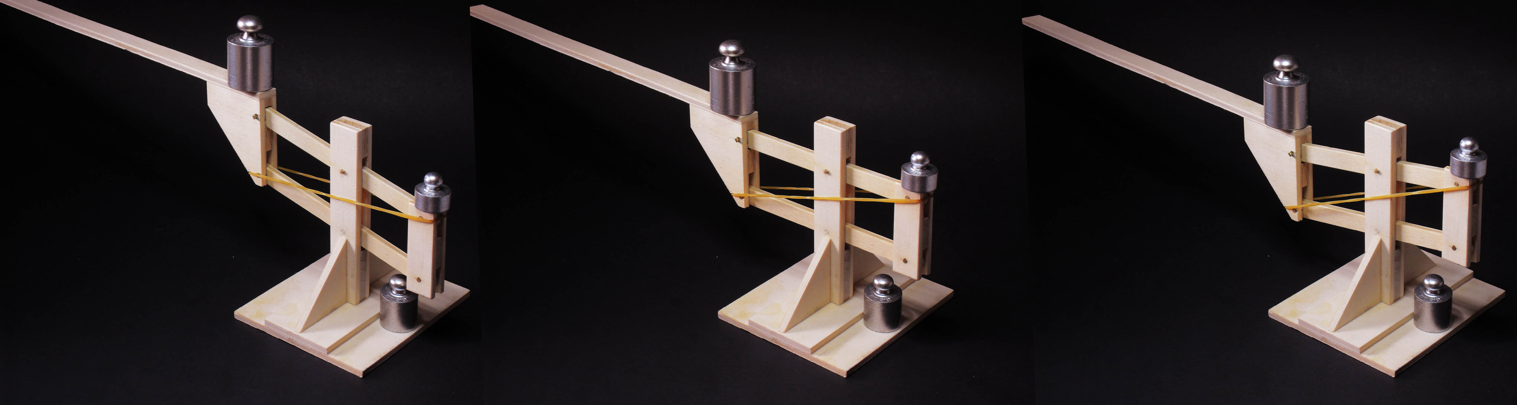

No. just 4 (#2435 #2440) are too much for my taste.
That was only the wooden mock up of the parallelogram: being sensible to 1/2 gr good for quick check. What is difficult is to calculate and find the right spring.
Here the rubber band was too weak and + 20 grams were needed to balance 100 gr.
carlo
