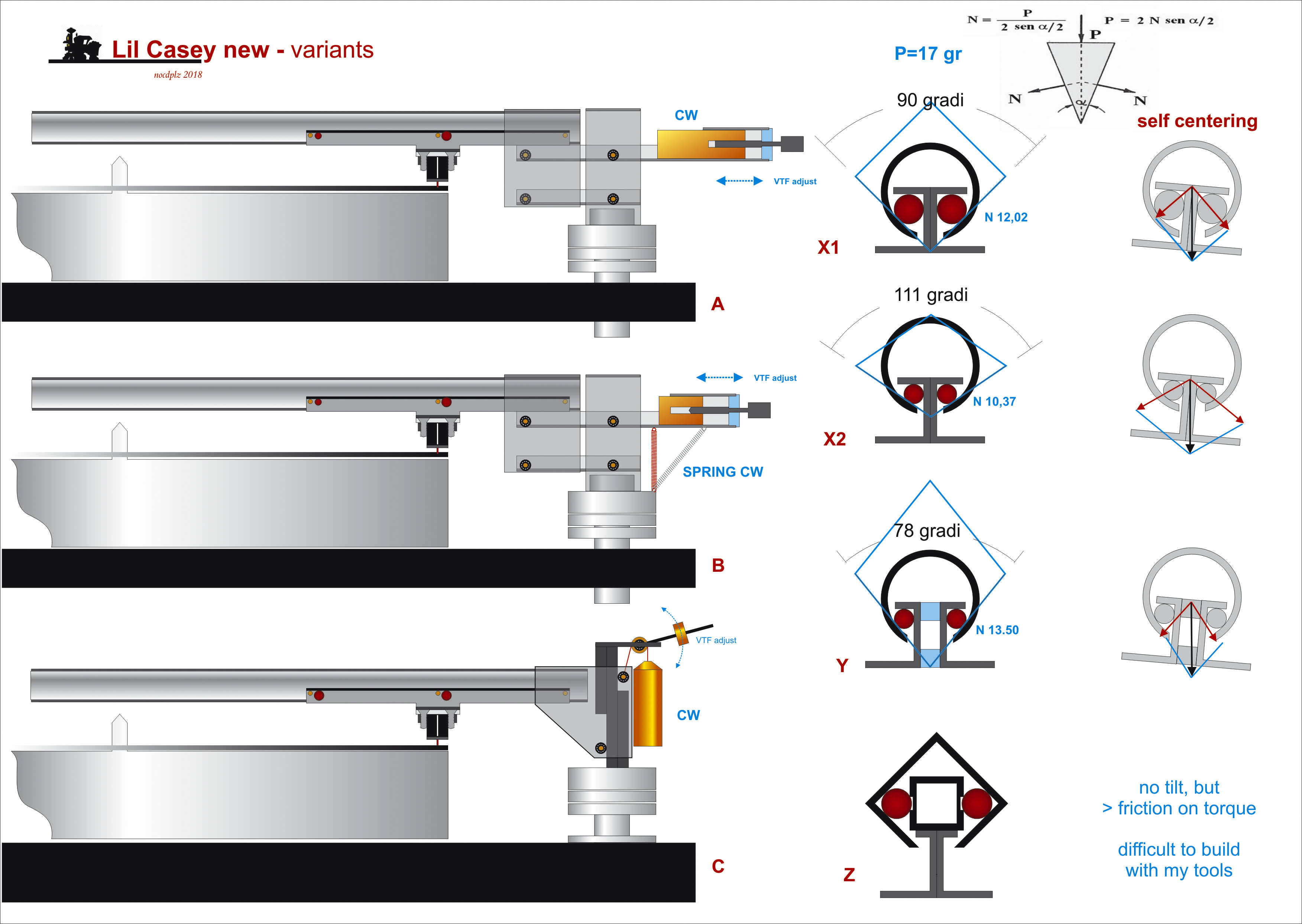

Niffy, it is true. If the spring is short, and act closer to vertical, VTF will vary a lot (pic. 1). If the spring is long, positioned horizontally, and closer to horizontal bearing, VTF will be very close to constant, even with bad warps. That's why Garrard engineers extended spring up to the front, over the bearing(pic. 2)
Actually, I'm thinking about the linear arm design with spring counterbalance for a long time, and I see some interesting solutions. The main obstacle (in my case) is precise and expensive machining.

During the WE I would like to make parts to test the cart or parallelogram, but which parts? I involve you all in my doubts.

Walter - I'm studying the springs: hard work with few remaining neurons and zeroed memories of physics. But I still fear that the spring plays some role, with its potential energy.

Directdriver, I like the arm in your picture. IMO, it is the best design among the air pump actions, and it seems as it doesn't need to be changed. The only thing I would change to make it more compact and user friendly, is to extend the arm itself. Also, possibly it will work with of much smaller diameter (and so, lighter) air guided horizontal tube (maybe made of arrow?- thy are rigid and light).

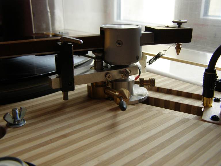

Nocdplz, my own experiments with spring counterbalance showed, that it works very well, tracking is excellent, better on big warps, than of regular arms. I can't put here the whole physical explanations, together with calculations, because they were published in Russian by one of prominent Soviet designers of hi-fi equipment, named Anatoliy Lihnicky. For me it is too complicated to put a translation here.With springs it is crucial to completely get rid of the counterweight, and not combine. Actually, combined arms will work, as gravitational arms do, but they will loose the main advantage in: descearing inertia, changing center of mass location (it is the main difference and advantage), and bearing chatter will come back too.
Spring has it's own resonance, but it can be easily suppressed, if needed.
Just think about travelling waves and spring reverb effect units used by musicians. Thorens spring suspension turntables have foam damping inserts, just as an example of damping. In our case a loose cotton wool insert would probably do.
@Carlo: referring to your drawings, it is not possible to support the balls on three points, because it prevents them rotating. You have to support them on their opposite poles.
Walter - Spring CW - I am also convinced that they work as, or even better than others: what does not convince me is that calculation of the eff. mass with that spreadsheet (but calculating by hand you get about the same results in much more time) applying a mass = 0 (2 grams was the minimum).

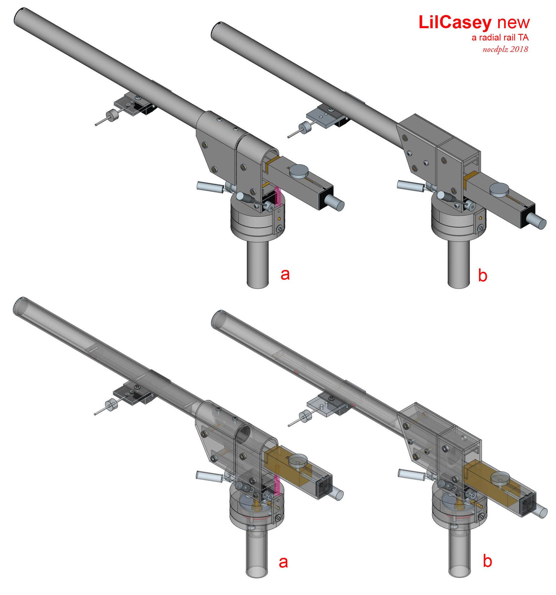

Radial rail TA
It's beginning to seem something that can be built. Two versions, one with the rail above the parallelogram (A) the second in the middle (B). I'll try the first just for the need of a stylus-plinth distance >40mm. Both can be converted with few mods to the spring-counterweight version.
I'll make some parts, starting from the parallelogram, to get clearer ideas. Will it work? Unfortunately to know this it must be done. and with tight tolerances.
