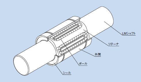

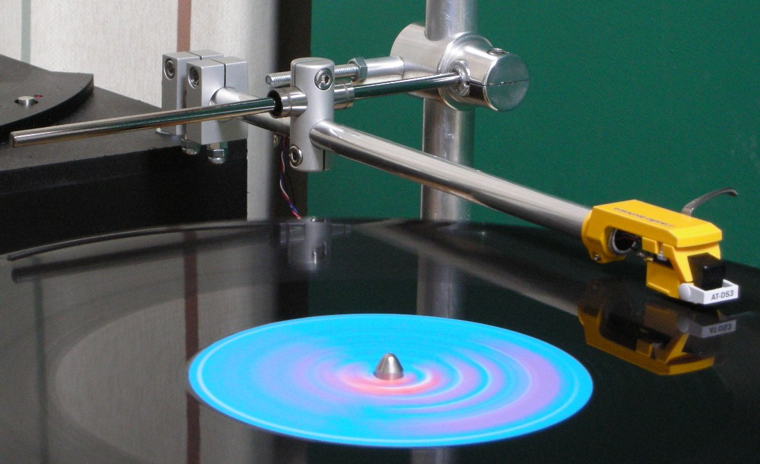

Hi to all. Forces, acting on the stylus are pushing, however, the same forces, acting on cantilever are pulling. Maybe, that is the reason, why all of them, applied on tonearm, are usually considered, as pulling.
Any opinions on using linear ball bearings, like that? I wonder, what are friction numbers there? On video it looks, like they are extremely small, and arm tracking on warped and eccentric records is excellent.

Linear bearing have way too much friction. You can play records, but I bet the cantilever will not last very long. I know a guy who made one and admitted he had to give a slight tilt downward of the arm toward the label. This guys Denon 103D was ruined in a few weeks.
Walter: recirculating balls may be good for CNC or 3D not here, cause all the balls have to recirculate along a small radius, and this brings frictions and chattering. Imho only jewels and non recirculating balls are really viable, with precision radial bearings just at limit.
