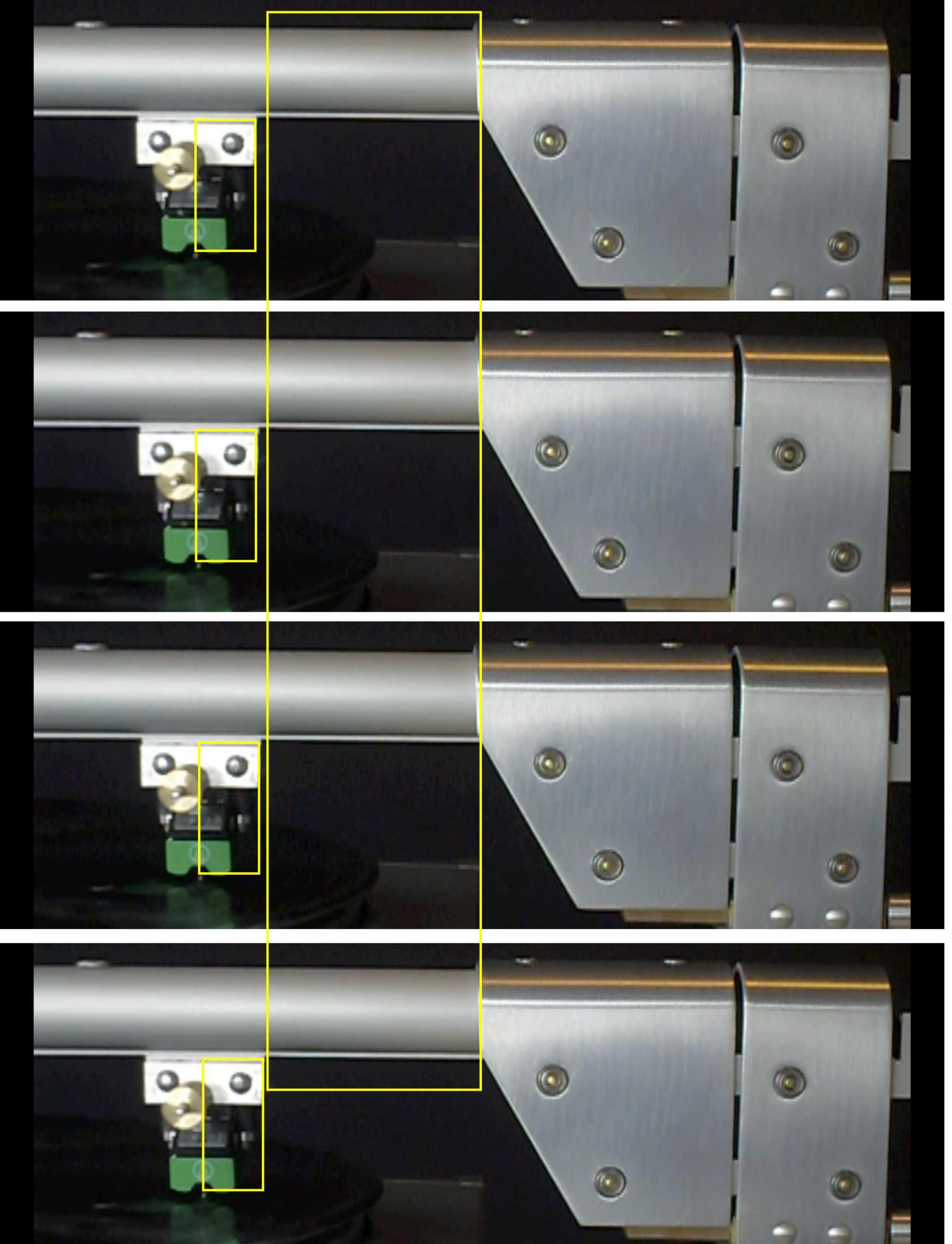

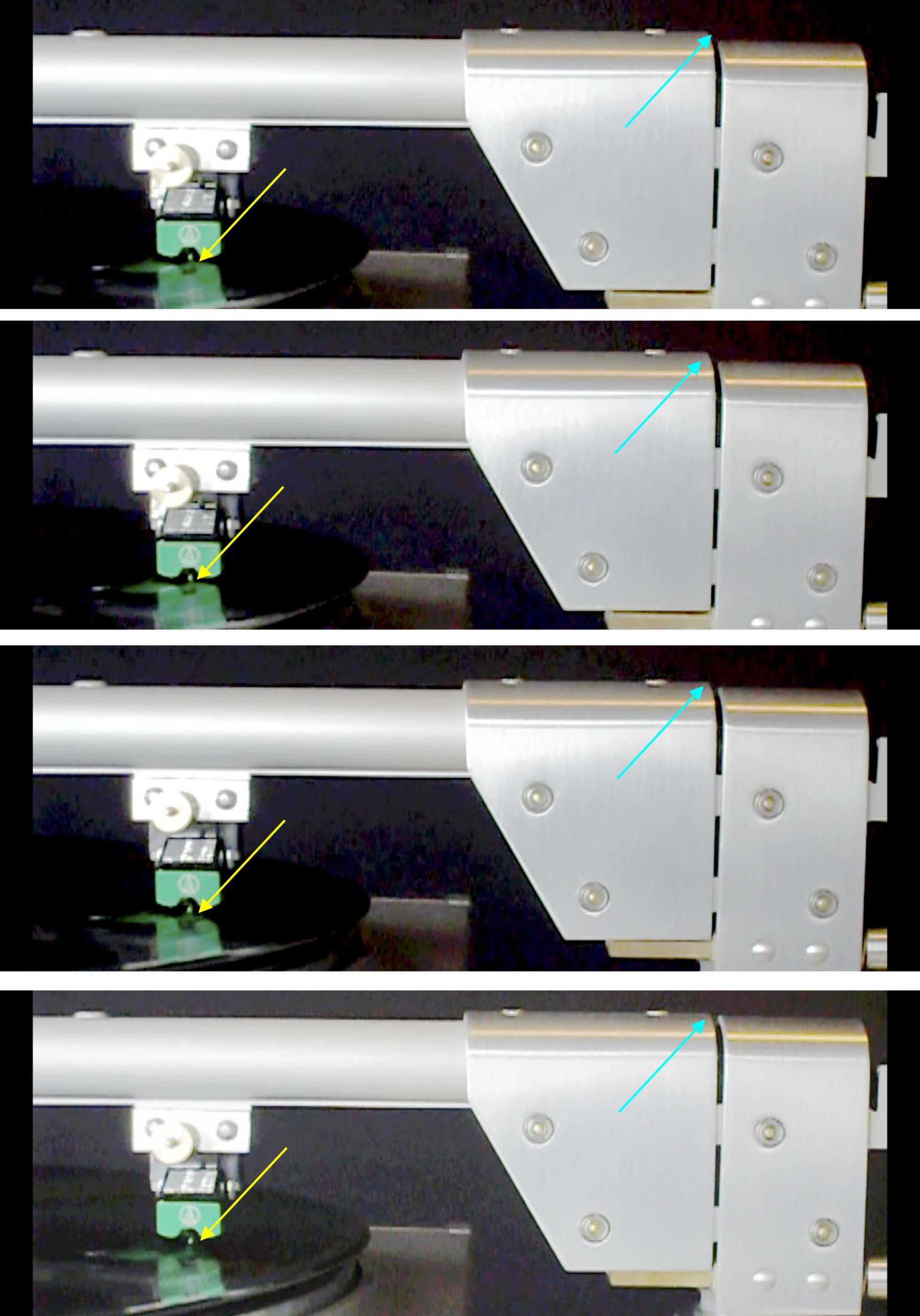

Sorry guys,
The severe sideways flexing of the stylus in the ECC video more than negates any positive benefit of linear tracking that you are trying to achieve.
In the WARP video the arm linkage bottoms out before the warp bottoms out so that the stylus loses contact with the groove. To make the demonstration fair, the arm height needs to be lowered so the cartridge/stylus 'rides' the full height of the warp.
Also, in the WARP video it is evident that the cartridge 'rocks' fore and aft as it makes contact with the groove. Unwanted motion along the groove causes pitch instability, which can be quite audible.

Thanks for the deep observations, Ray.
I know I'm trying to follow a difficult (or wrong) road and it's easy not to see the faults of one's own creatures. Not seeing with a 10x macroscope what you see on those low resolution files worried me, so I enlarged and cleared some frames and, damn: I continue to see just a small bending on +-1,5 mm eccentricity (I saw worse on old low compliance pivoted ) and to see the stylus into the groove on warps. (attachments)
When it plays, the cart trace without problems on eccentricities, while on the vertical articulation there are still visible problems, and I have to reach a mass similar at least to an old 12" SME.
But maybe I have bad references, can you link me videos of passive linears without these problems? usually they show everything except the stylus.

Mass issues aside, a low compliance cartridge will show less sideways deflection of the cantilever, but that does not mean the problem went away. Even if you no longer see the effects on the cantilever, the sideways forces are still there and rob effective VTF from one groove wall or the other depending on which direction the eccentricity is going.I still think, that it needs low compliance cartridge, as it is definitely not an ultra-low mass tonearm. I suspect, it will work very well with Denon DL-103 or EMT TSD-15 kind of cartridges.

Sorry, no links. If it's any consolation to you, I'm not aware of a passive linear that doesn't have this problem to some extent. I have not observed all passive linears in action but IMO, as a retired engineer, passive linear designs are inherently plaqued by bearing friction/stick-tion.
