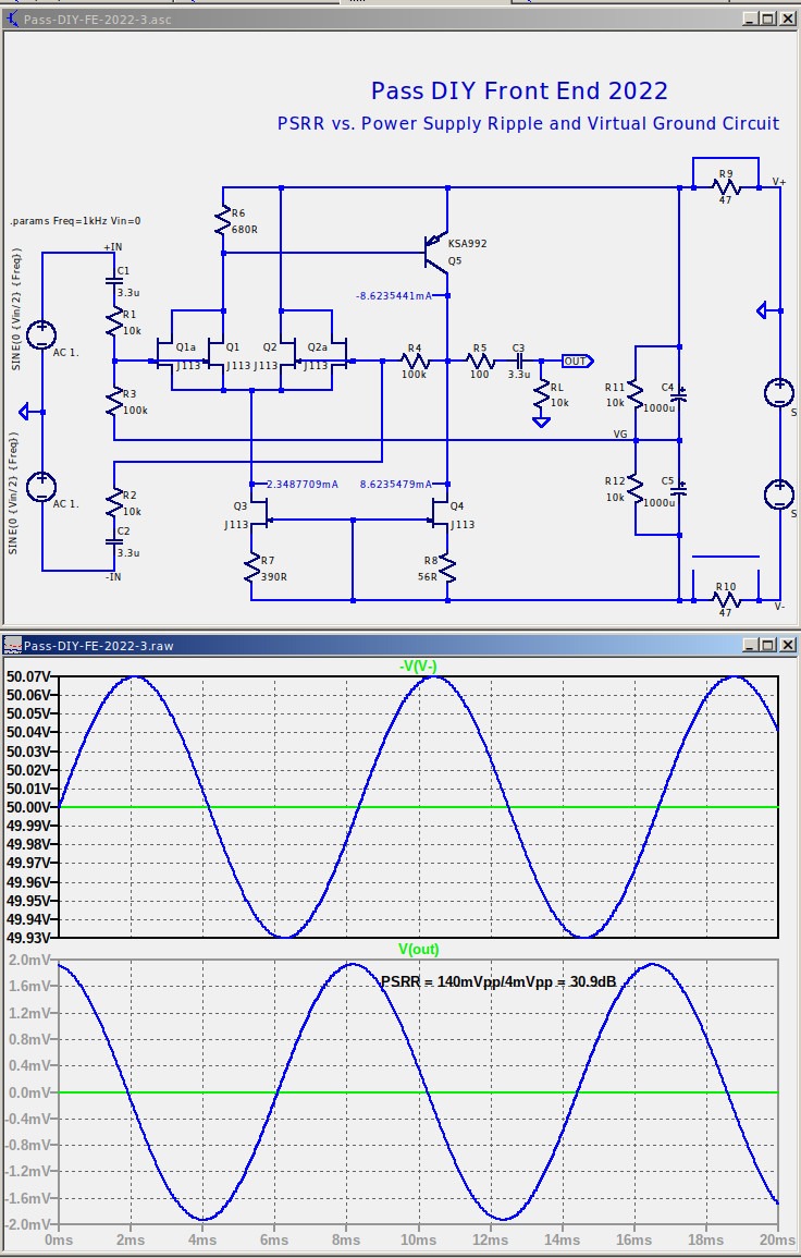

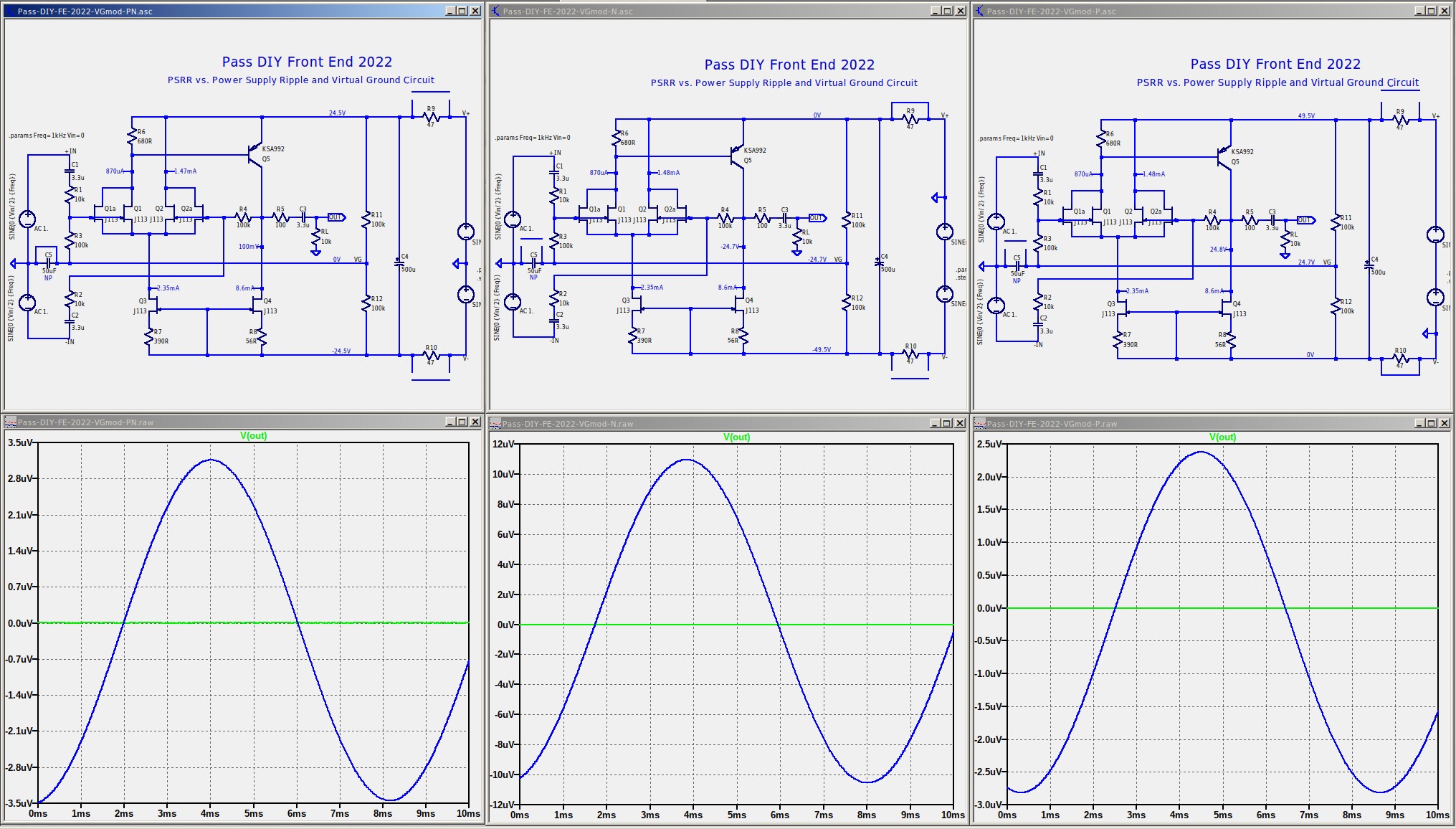

I have noticed that the virtual ground circuit (C4, C5, R11, R12) can be is "noisy" when either V+ or V- is used as the ground reference and there is significant power supply ripple. For example, either of the PFET or NFET based mu follower follower (MUFF) output stages have very good power supply rejection ratios, allowing a single-ended linear supply with 140mV peak-peak ripple. One might wish to use the same supply with the Pass DIY 2022 Front End, rather than using a pair of separate supplies.
The first image shows the output from the DIY2022 FE when the inputs are shorted, and the power supply has either no ripple (green) or 140mV p-p ripple (blue). The output has about no ripple (green) or 4mV p-p ripple (blue).
The primary reason for this is that the virtual ground circuit is acting as a 50:50 voltage divider between the filtered positive and negative rails, thus VG is modulated by 1/2 the voltage between the filtered rails. The second image shows that the signal on VG is added to the output of the FE.

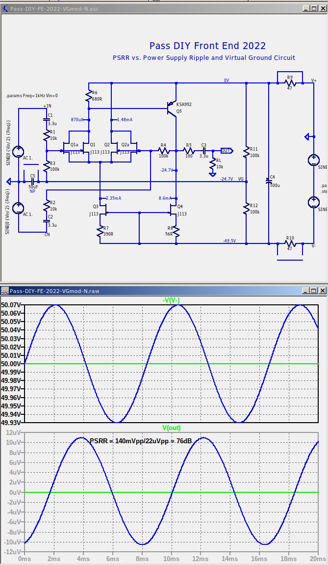

The third image shows a simple modification to the virtual ground circuit that fixes this issue. The virtual ground DC level is derived from the R11/R12 voltage divider, but the AC component is derived from the external ground, used by the power supplies and the OS stage. The output ripple has been reduced from 4mV p-p to about 21uV p-p.
The fourth image is a collage of three configurations: V+/Gnd/V-, Gnd/V-, V+/Gnd, selected by where gnd attached to the power supplies, and which jumper is used across R9, R10, or C5.

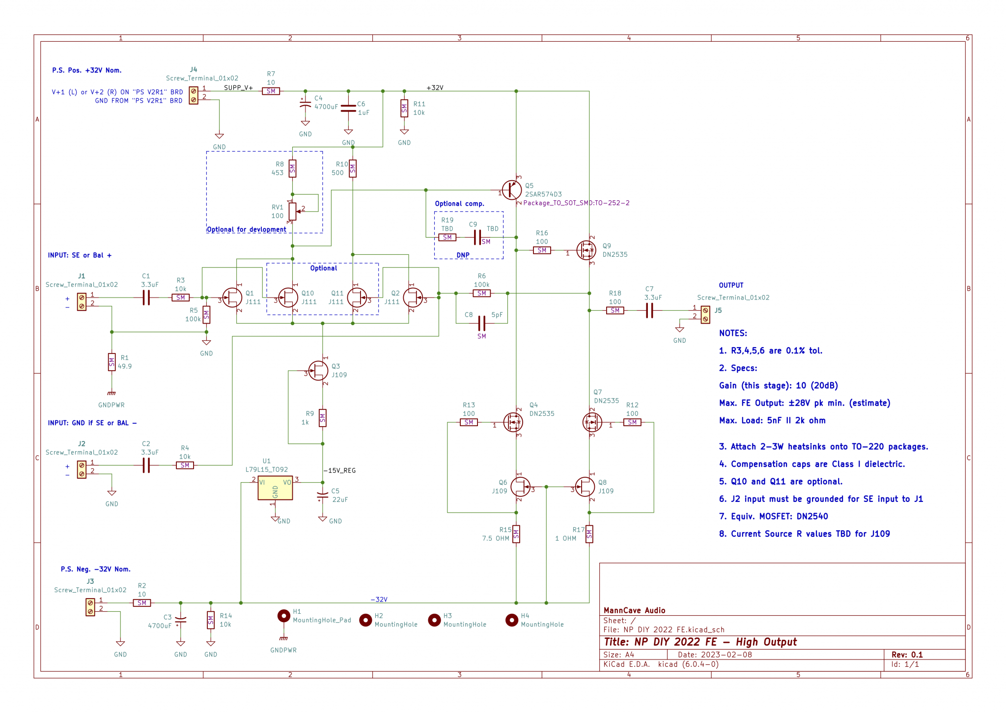

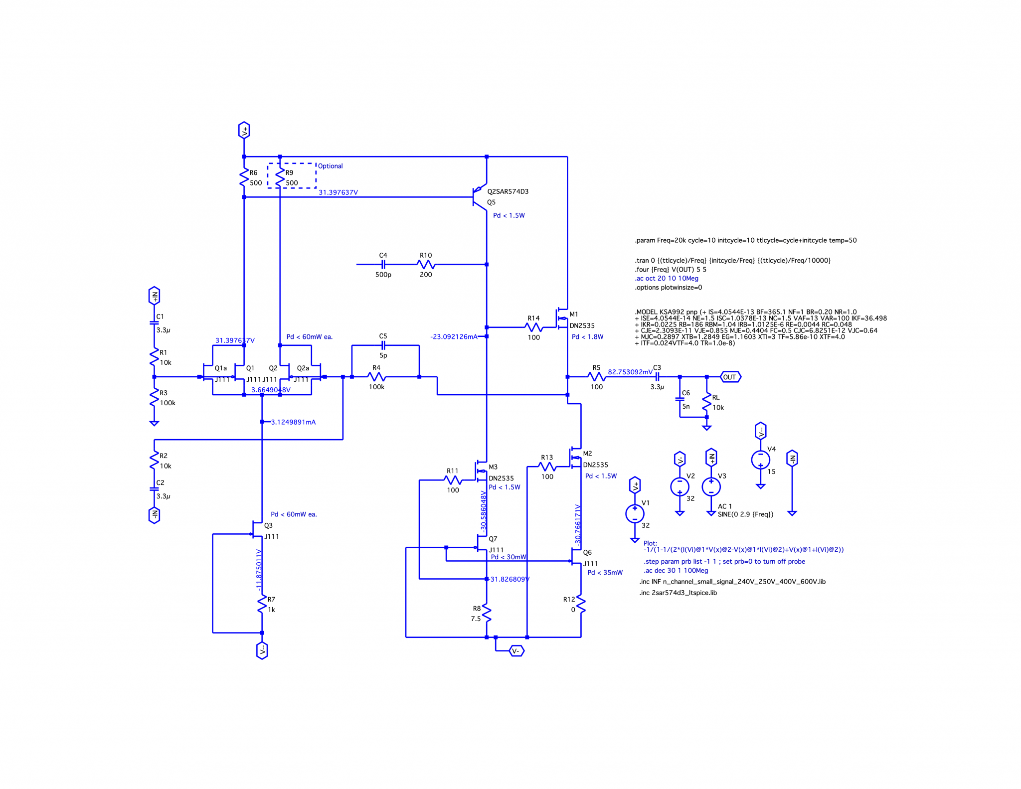

I've been working on a higher voltage (±32V rail) version of this circuit that could maybe drive a SIT OS, and the following is where I am. Caveats:
1) For dissipation, replaced PNP with a ROHM 2SAR574D3 in an SMD package, which should be hand solderable. It's still a cheap and available part.
2) A buffer stage was added to drive a capacitive load. LTSpice shows lower limit 2kohm II 5000pF. (Will this drive Tokin THF-51S?)
3) Current sources are modified for dissipation and quiescent currents of 3mA, 23mA, and 24mA, in the three legs, L-R. These were tweaked with LTSpice. I think J109s will be better than J111s there, but I'm too lazy to find J109 Spice parameters (so ASC file shows J111).
4) J111s were chosen over J113 because I have a large stash of them, but I've since purchased a few J113 which could be used instead.
5) I don't expect items 3 and 4 above to affect performance much, but I fully acknowledge items 1 and 2 will alter the performance of the original circuit.
I've purchased parts, but have not soldered anything yet. BOM cost is about $38/channel, mostly due to the filter caps which I chose as polypro types (27.5mm pins) at about $2.65 each (qty 10). The MOSFETs cost about the same as the terminal blocks ($1.60 ea.). Of course if I do a PCB layout, the larger caps will drive up the cost due to the extra real estate they'll occupy.
Thoughts?

First time I've ever seen a 1.0 ohm resistor used as source degeneration in a constant current source (R17). Dropping, what, sub-60 millivolts? Yowzers.
That's just a placeholder, sorry. No resistor there produced the reasonable current that looked good for LTSpice, but I figure I'll need some value. Pretend it's whatever value that works (for 24mA, says simulation).
Reactions: Extreme_Boky

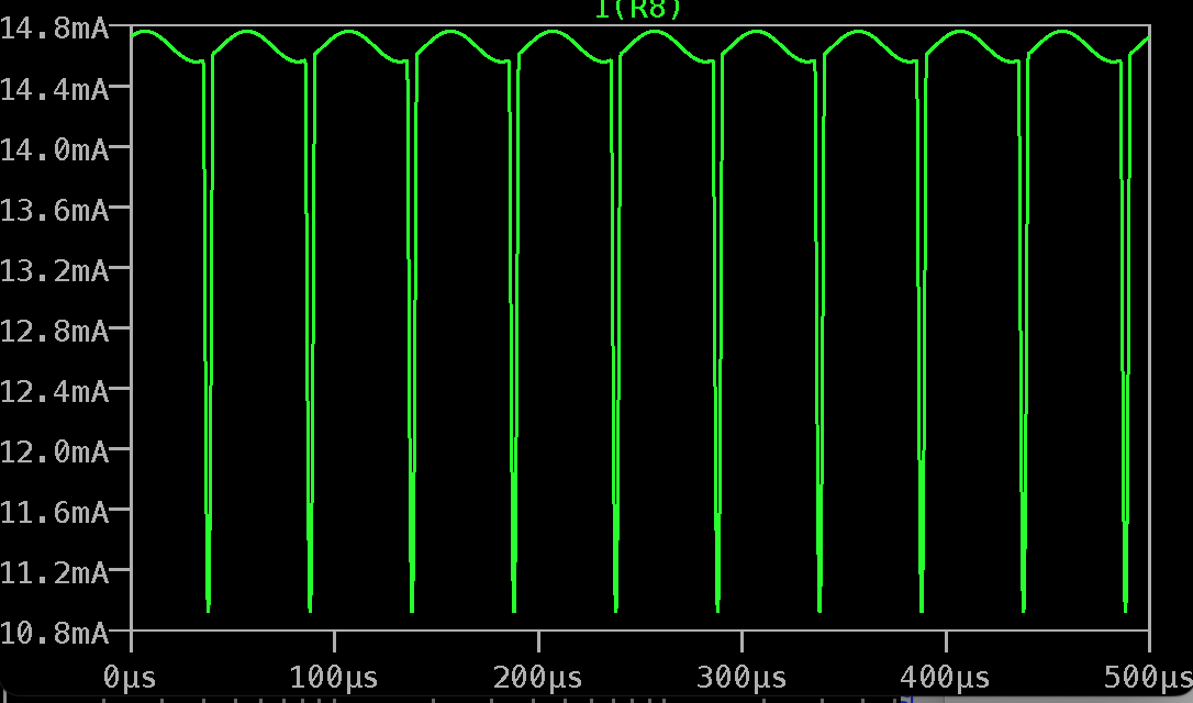

With the buffer state, the 2nd stage (Q5, M3, Q7) is driving the very light load of the buffer M1 compared to driving the SIT of the OS and can be have a bias current in the 6ma-10ma range, such as in the DIY FE.
I thought so too, and that might turn out to be true. But with less than 23mA in that leg and the capacitive load, for some reason I'm getting this kind of stuff (here with 15mA-ish):

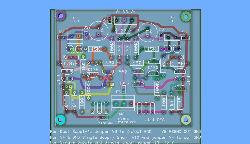

Added a follower like in the diyopamp.pdf figure 14
So J111 CCS, K170 LTP , KSA992 & KSC2690 follower with CCS
elana silmicII from ACA for input caps
added trimpot for LTP CSS (not sure if it does any good)
Jumpers for single or dual supply's
jumpers for bal or single inputs
~3ma for ftend
~9ma for A992
~15ma for C2690
seems to work good, tested into 10kR/1nF load

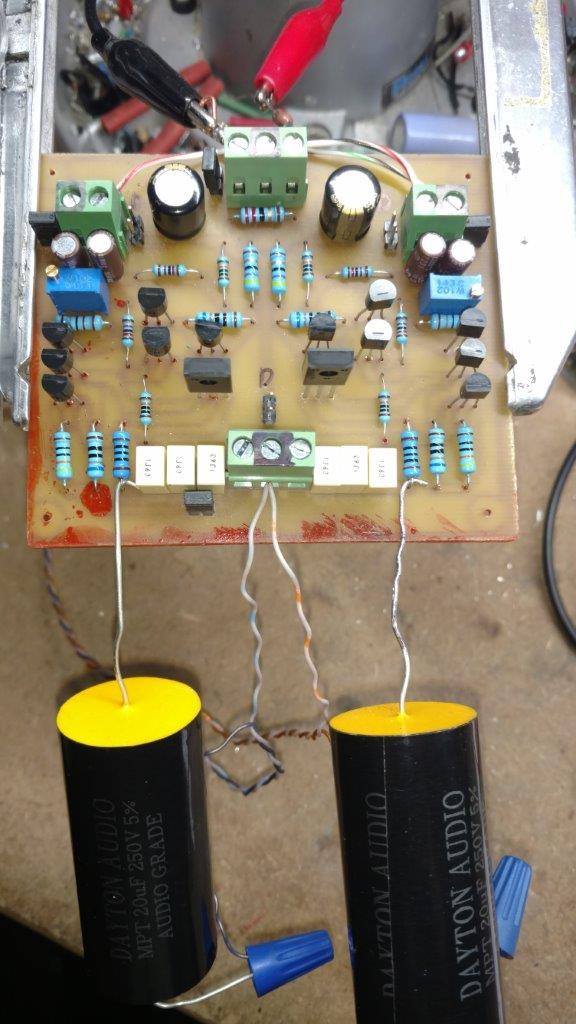

and tested into 50R phones
