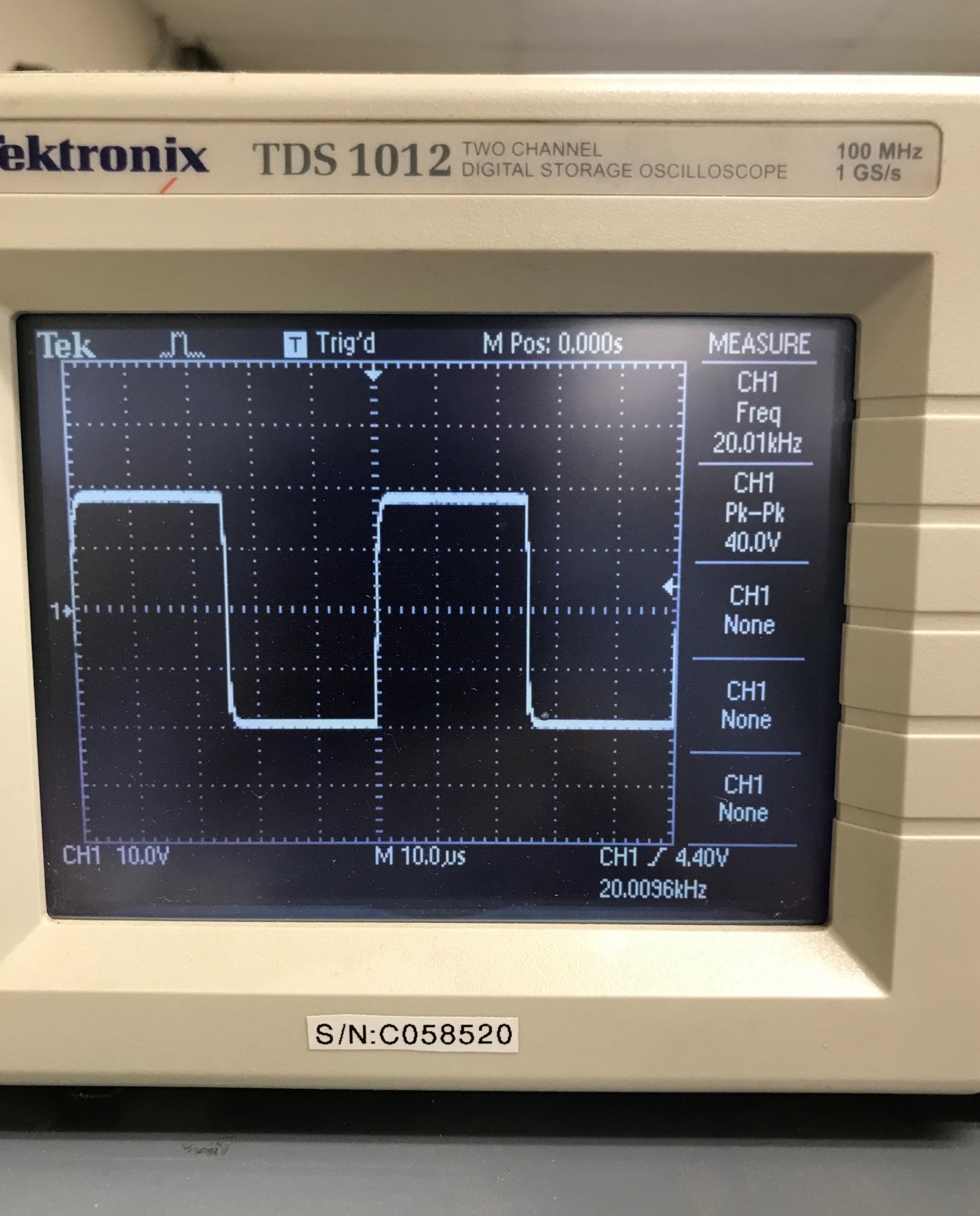

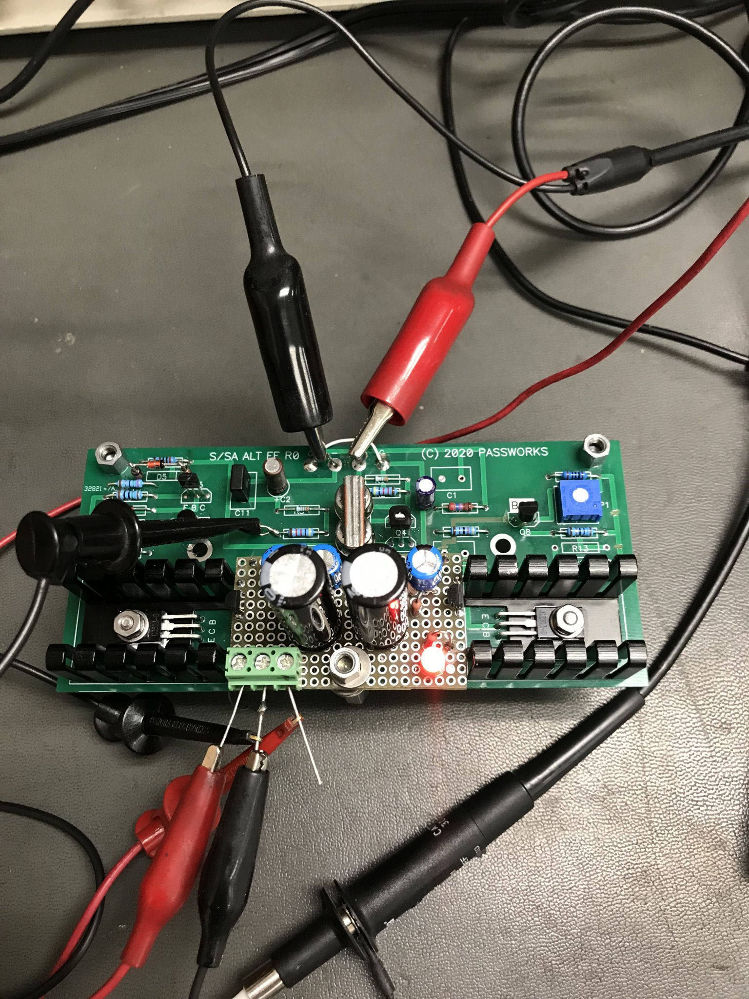

First channel complete of my extensively modified Stasis FE. Hacked in a third stage to have a single-ended emitter follower with CCS, for a nice low output impedance and good drive capability (transformer drive, not headphones). So first stage is mostly stock except a quad of tightly matched K170's rather than a pair, current is ~5mA through those. Custom made thermal cap for good output DC offset behavior. Second stage VAS uses KSA992 / KSC1845, ~10mA or so. Output stage consists of KSC3503's, set for 45mA. Compensation is a 10pF cap across the feedback resistor, and the same series resistor / cap combination that Wayne used on the BA2018 (on base of the 992). I set the gain at 5.5. That double decker input board is a 2-pole cap multiplier, or "transistor enhanced filter"... whatever. Values chosen for fast response rather than maximum ripple rejection. Just wanted to try something different than a simple RC filter for isolation, and had just enough room to do it. PSRR inherent in the FE itself I just consider gravy, I guess. Measurement shown is with 25V rails (limit of my Agilent tracking lab supply), negative input grounded, driving a 600 ohm load. Seems stable, and turn on / turn off behavior looks good. Rock solid DC offset. Should be able to DC couple this no problem. Haven't played music yet, just staring at sines and squares... and goats...
I did the same thing with the circuit I posted in #409. Tested it on bench yesterday and just a few minutes ago tested the output follower part separately, as my distortion had almost doubled from ~0.15% to ~0.3% with the entire circuit. It was still low at the PNP collector, so I suspected just a noisy board. The separate test of the follower today confirmed it was not the problem.First channel complete of my extensively modified Stasis FE. Hacked in a third stage to have a single-ended emitter follower with CCS, for a nice low output impedance and good drive capability (transformer drive, not headphones). ...
I'm thinking I'll start a PCB layout.
EDIT: BTW, the LTSpice waveforms like the one in #413 were showing incipient clipping. Raising the rails or lower the signal are the first things that easily clear things up. More work was needed.

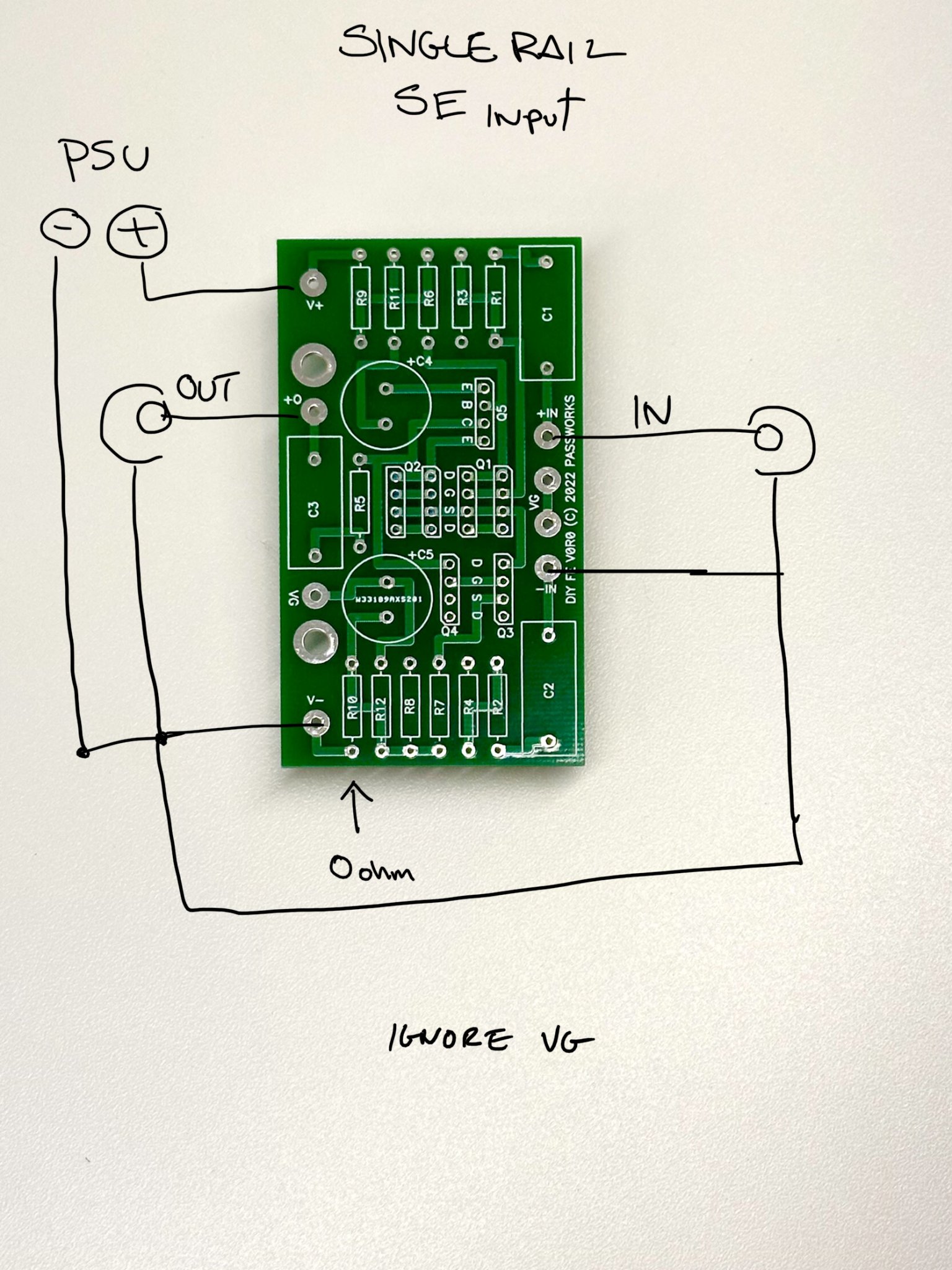

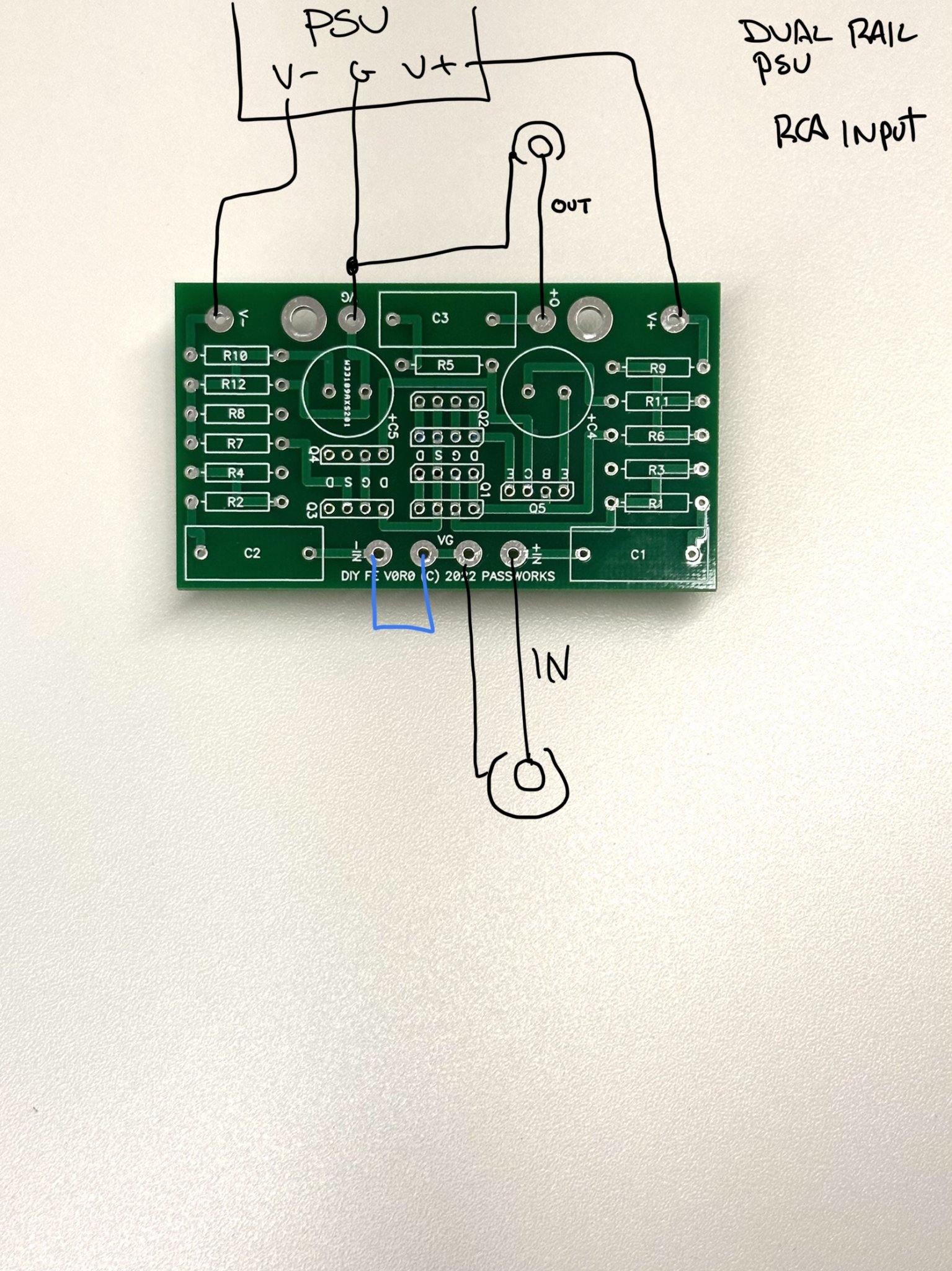

Ok, a couple of quick notes as these are going to be hitting the hands of builders very soon….
Using a single-rail PSU (for example 0-24V) has the following connections;
PSU 24V to V+
PSU 0V (ground), Input signal ground, output signal ground, and -IN all connect to V-
R10 is jumper
Ignore VG
Bipolar PSU is straightforward and is shown/discussed in Nelson’s article.
PSU V+ to pcb V+
PSU Ground to pcb VG
PSU V- to pcb V-
Input + to +IN
Input ground to VG
Output+ from +O
Output ground from VG
Jumper -IN to VG
Here‘s a chart if you want to play with gain - (Gain is simply R4/R2 and R3/R1)
R1 and R2 remain 10K
R3 and R4 you can adjust as shown.
For unity gain (0, I.E., a buffer), make R3 R4 10K. The amplifier is unity gain stable.
A gain of 10 (20db) is quite a lot for a preamp… if you are using this with typical sources into an amp that has some gain, you will likely find 20db to be too much. Reducing the gain has the advantage of decreasing the noise and giving you more useable potentiometer range. Most users should try lower gain settings. Of course, if you have a follower amp (F4, MoFo, Theseus Mosfet by itself, etc…) then stock gain is what you’ll want. The stock gain drives a MoFo wonderfully, and sounds excellent.

@JeyDee There is no advantage or disadvantage using whichever PSU configuration you want - the circuit was made with flexibility in mind, so can be used however you want and/or need. Bipolar, single-rail, and even single-rail positive ground if you have that (rare, but not unknown) use case.
