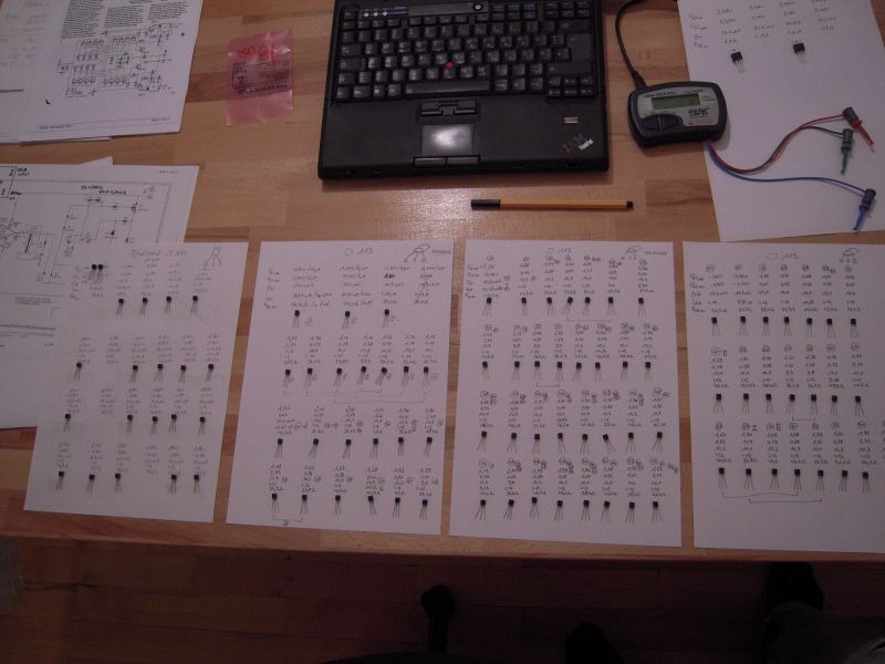

Well (this time) followed the guide: https://diyaudiostore.com/pages/jfet-matching-informationHow did you do that?
and yes mine are 80 +
I buy from mouser and however many it takes to get discount so usually 100
then sort onto tape and retest before using.
looking for the closest match I have. No extraordinary effort.
( my projects have all signed a DNR)

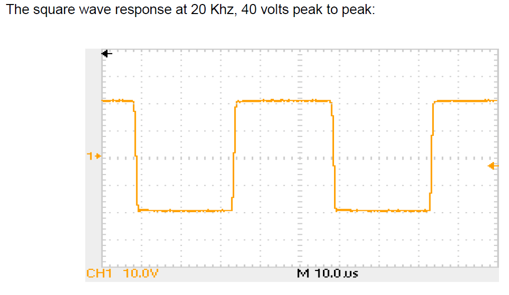

Where did I get "slew rate > 30V/usec" ? From page 4 of Nelson's pdf:

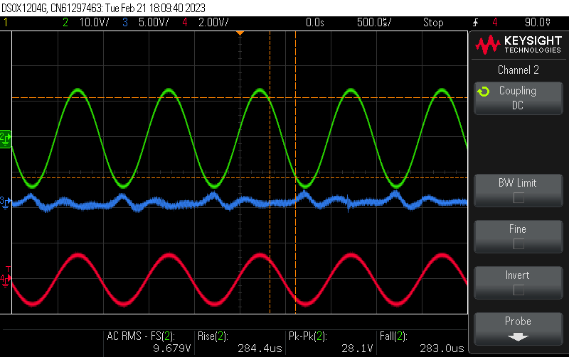

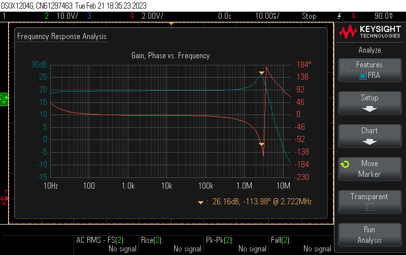

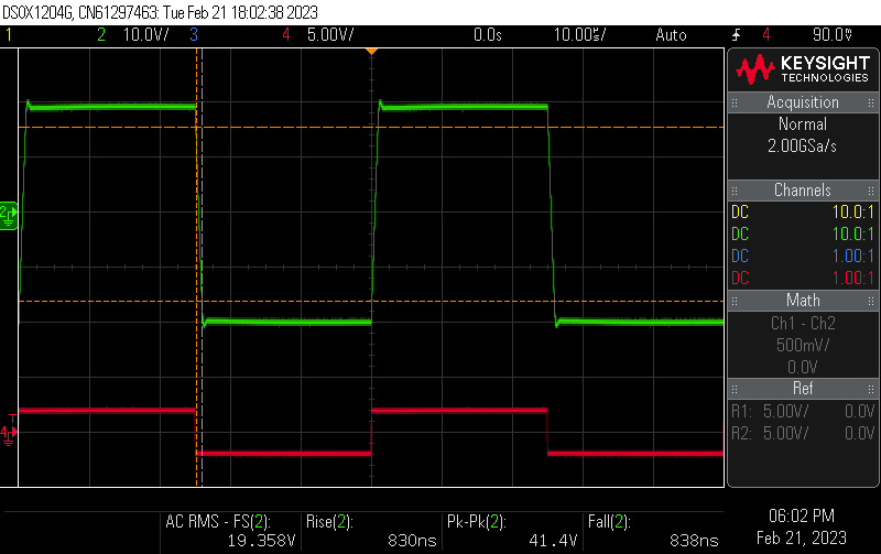

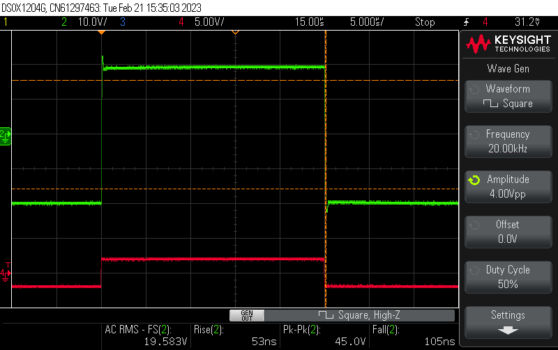

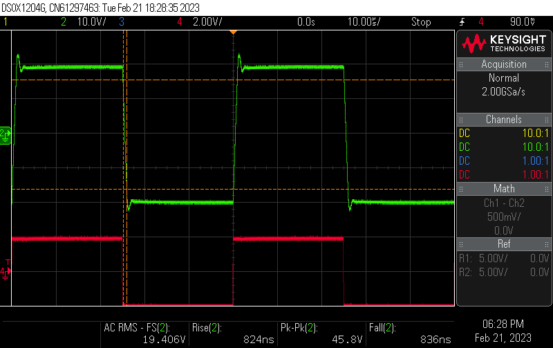

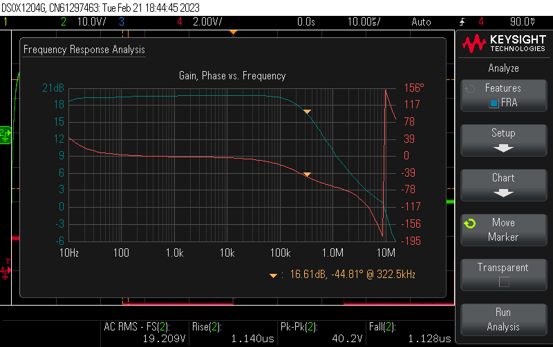

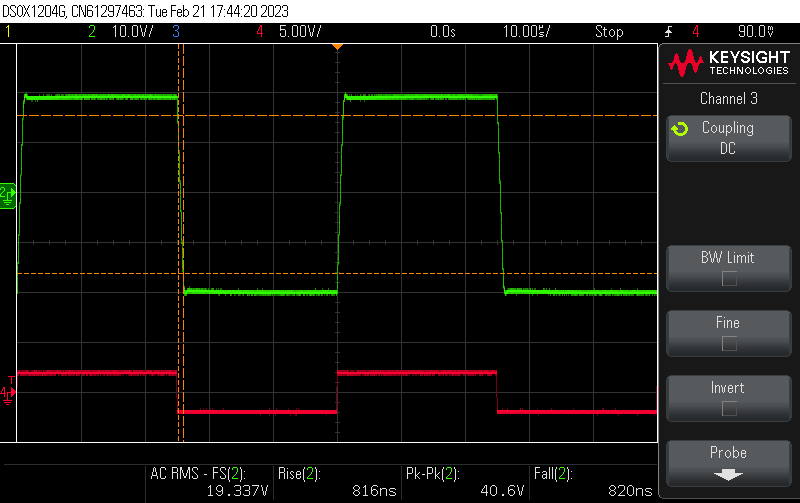

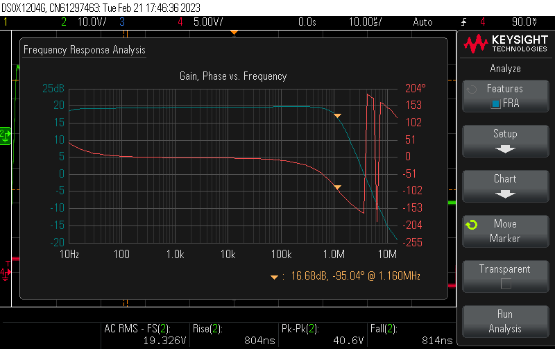

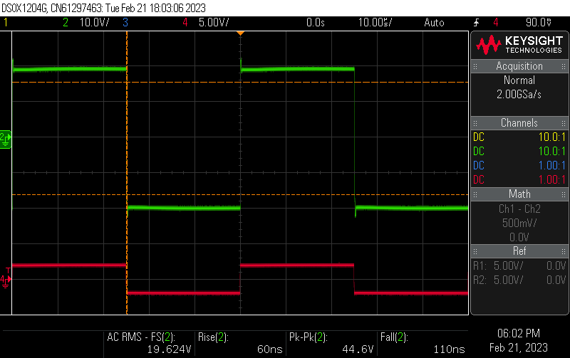

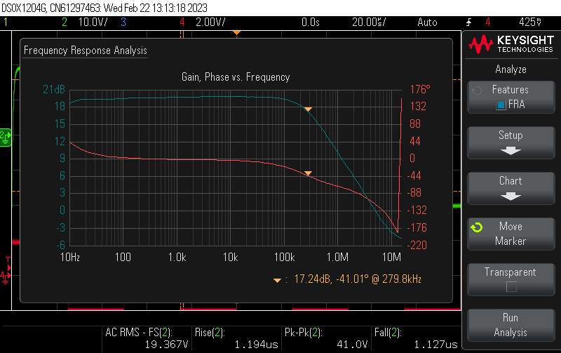

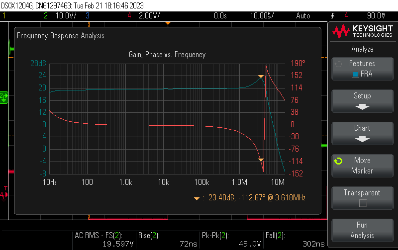

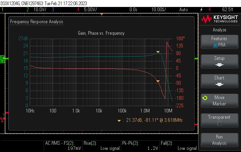

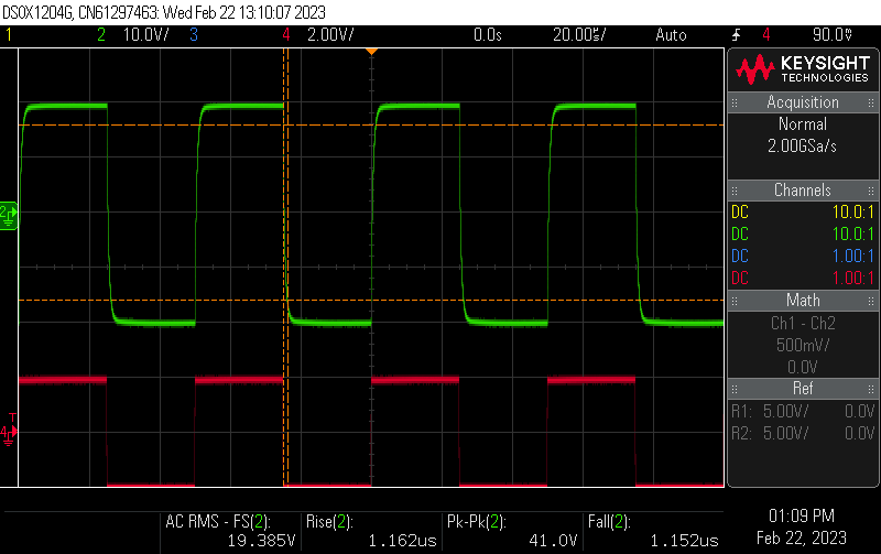

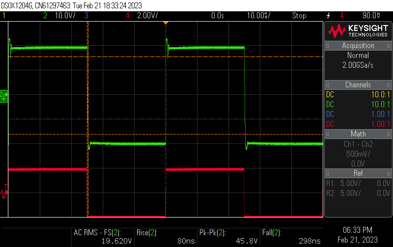

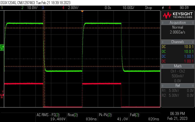

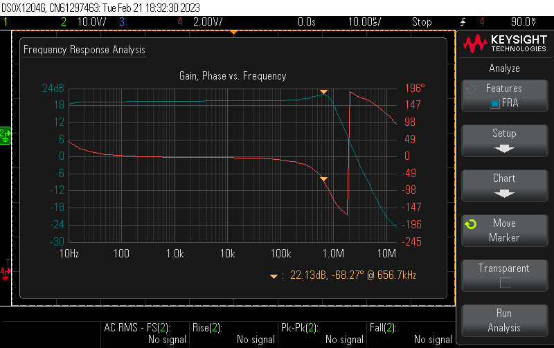

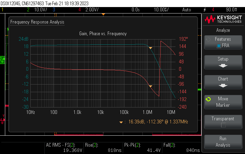

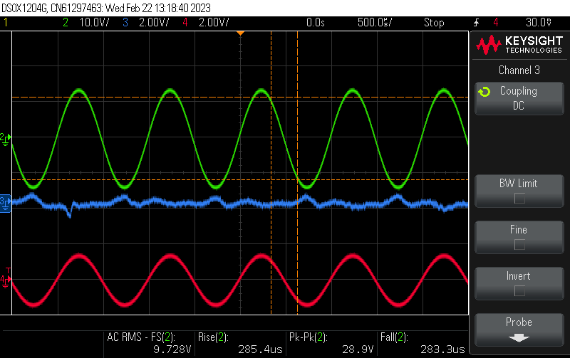

I built this circuit, as designed except for CCS values, and tested J111, J113, JFE2140, and LSK170 in single pairs in the diff slot (LTP). (I didn't have a second set of transistor sockets on the board to run four parts). The current sources were J111. For all LTP parts the current through both diff legs (total) was close to 3.5mA (2.2k ohm resistor). The PNP bias current varied from 7.9mA (with J113 and JFE2140) to 9.1 and 9.9mA (J111 and LSK170). The inverting output of the LTP employed a 100 ohm pot. in series with a 360 ohm resistor, and later I tried 680 ohm there with the 100 ohms. So I could vary that resistance from 360 to 780 ohms.
Surprisingly, the position of the pot mattered little. The current through each leg of LTP was always imbalanced, but the KSA992 always biased (~0.6V) and I could scarcely tell any performance differences from 'scope photos or THD values.
I needed to add some compensation to improve square wave response, shown here with 40V pk-pk square waves. J111 and J113 benefitted from 44pF in parallel with the KSA992, base-to-collector. The JFE2140 had the largest HF peak and seemed to benefit best from a 5pF feedback cap, which was also the best way to improve response with the LSK170s. Compensation could be better optimized, I'm sure, and some of the peaking and noise issues were probably with my test rig.
So, of note are the best square waves and frequency responses I could obtain, as shown in the photos here.

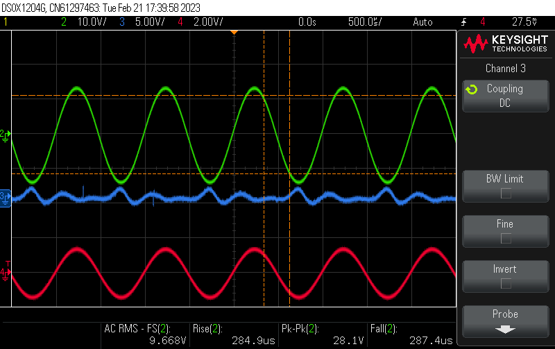

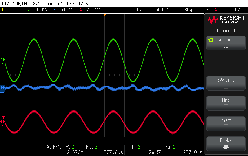

Secondly, the best THD results were obtained with a 10V output (~9.7V rms). At 1V output, the noise looks just random, but at this 10V output level, you can see the distortion waveforms in the blues traces with the 1kHz fundamental notched out.
The THD values were as follows for each pair of LTP devices, as measured by my HP 8903B Audio Analyzer:
J111: 0.021%
J113: 0.020%
JFE2140: 0.012%
LSK170: 0.0065%
Other than high frequency response differences, the two Fairchild parts exhibited about equal THD. The TI part almost half of that. And the LSK170, almost half that again(!).
I hope this provides some useful new data.
J111: 0.021%
J113: 0.020%
JFE2140: 0.012%
LSK170: 0.0065%

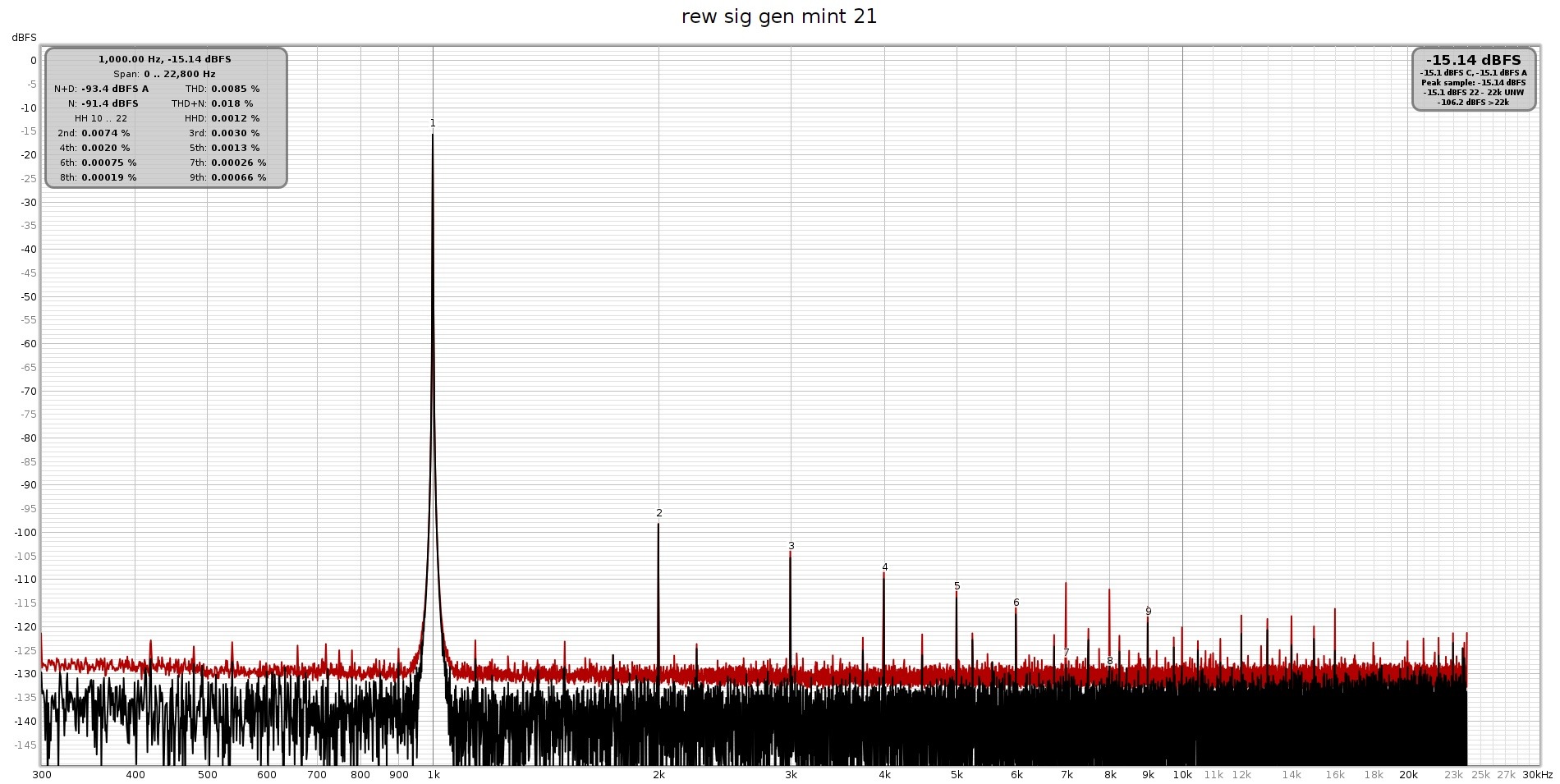

ZM said (something like) "it should be required to learn to use soundcard for distortion,
for entrance to papaland" best I remember....
So Ok here is proof I tried....
found a How to thread by xrk971
May be useless but seems to correlate to what I hear and other plots.
Done on Linux Mint 21 with X-fi usb card
2022 ft end with follower
