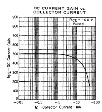

Seems the A992 @ 9mA is just right to produce neg phase H2, other part will require other operating point to have intended H2 phase.
Good morning indra1,
I think so too. The ONSEMI KSA992 seems to be happy at around 9mA. Perhaps a kind of 'sweet spot' for this device?
https://www.firstwatt.com/pdf/art_sweet_spot.pdf
But if anybody wants to experiment with this beutiful circuit and other active devices, there is a lot to do and find out.
I can say, that it sounds really great in its original configuration of Mr. Pass.
If anybody wants to experiment and wants to have some kind of 'special fun' (perhaps frustration) - go for it!
Cheers
Dirk
