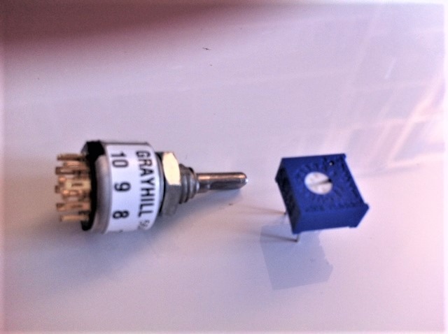

Brian, have a look at the dimensions of the switch / drawing from Grayhill, you will understand...
Even soldering Cat6 cable is quite a zen-experience, at least for me, and that is just 3 stereo inputs and one stereo output, all without ground, makes 8 tiny lugs to solder (with 2 inside at the middle!)...all packed within what is it, perhaps less than 1cm2?
Says IMHO a lot about our very modest Jim and his very real soldering skills

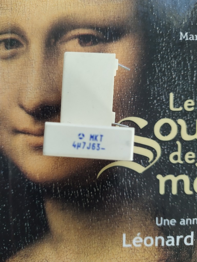

P. S. The caps, I intend to use these ones:
On the downside, I have only two pieces, but then...
As it is going to be single in-single out, I will use some bipolar 4.7 uF for the grounded input. The output may "skip the cap" since it is going to be connected to a MoFo (which has its input cap already, I will just remove the bleeder resistor) and Voilà! 🙂
