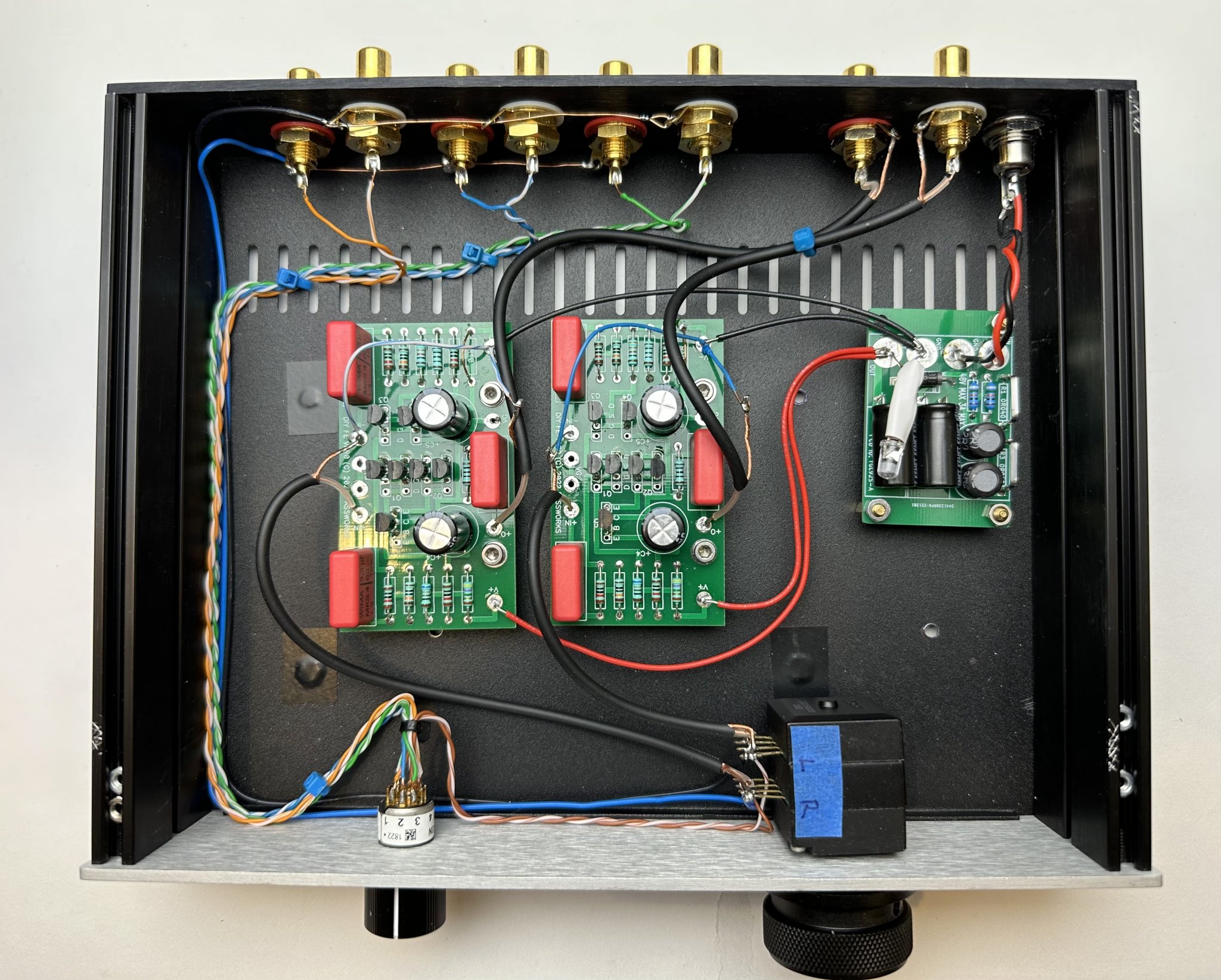

Been quite busy around here, but hooked up the boards properly for a single supply.
PSU is 0-24V, gain is stock (10).
The important points to notice are -
-V is used as ground
VG (“virtual ground”) is unused
Signal ground, both input and output, must be attached to the -V ground.
-IN attached to -V ground
R10 is jumper
This works great and drives my MoFo to very loud levels, it sounds fantastic!

Looks great!
Quick question - What type of wire are you using to connect the board output to the output jacks?

Very beautiful, congratulations! I'm just now noticing the LED floating above your SMPS filter PCB, which illuminates the chassis interior and makes the ventilation slots emit a diffused and sexy glow. Fantastic idea.
Would be interesting to hear some voltage output specs from the completed project. We can speculate on how close the output is to the Rails, but it would be nice to hear.

Thanks!Mogami 2330
Follow-up question - Why use the shielded cable for the input and output to/from the board, but the the connections from inputs to selector to attenuator are twisted pair?
