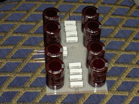

I'm still waiting for my sinks from conrad in oz but I have made progress on the ps.
BTW I beleive there are some polarity issues on the ps drawing you produced hugz. Specifically I'm not sure if the caps are shown with reverse polarity and the lhs positive out maybe coming from the wrong side of the 1R resistor bank????
I hope to use this matrix board method for the amp modules..its nearly as much fun as p2p with valves....
Regards
Ed

vitalstates said:BTW I beleive there are some polarity issues on the ps drawing you produced hugz. Specifically I'm not sure if the caps are shown with reverse polarity and the lhs positive out maybe coming from the wrong side of the 1R resistor bank????
Regards
Ed
Eep you're right. the cap polarity was just a mistake in my drawing, but one of my channels was wired wrong :/ Thanks for pointing that out! I think it helped with my noise issues 🙂 the drawing's been fixed
